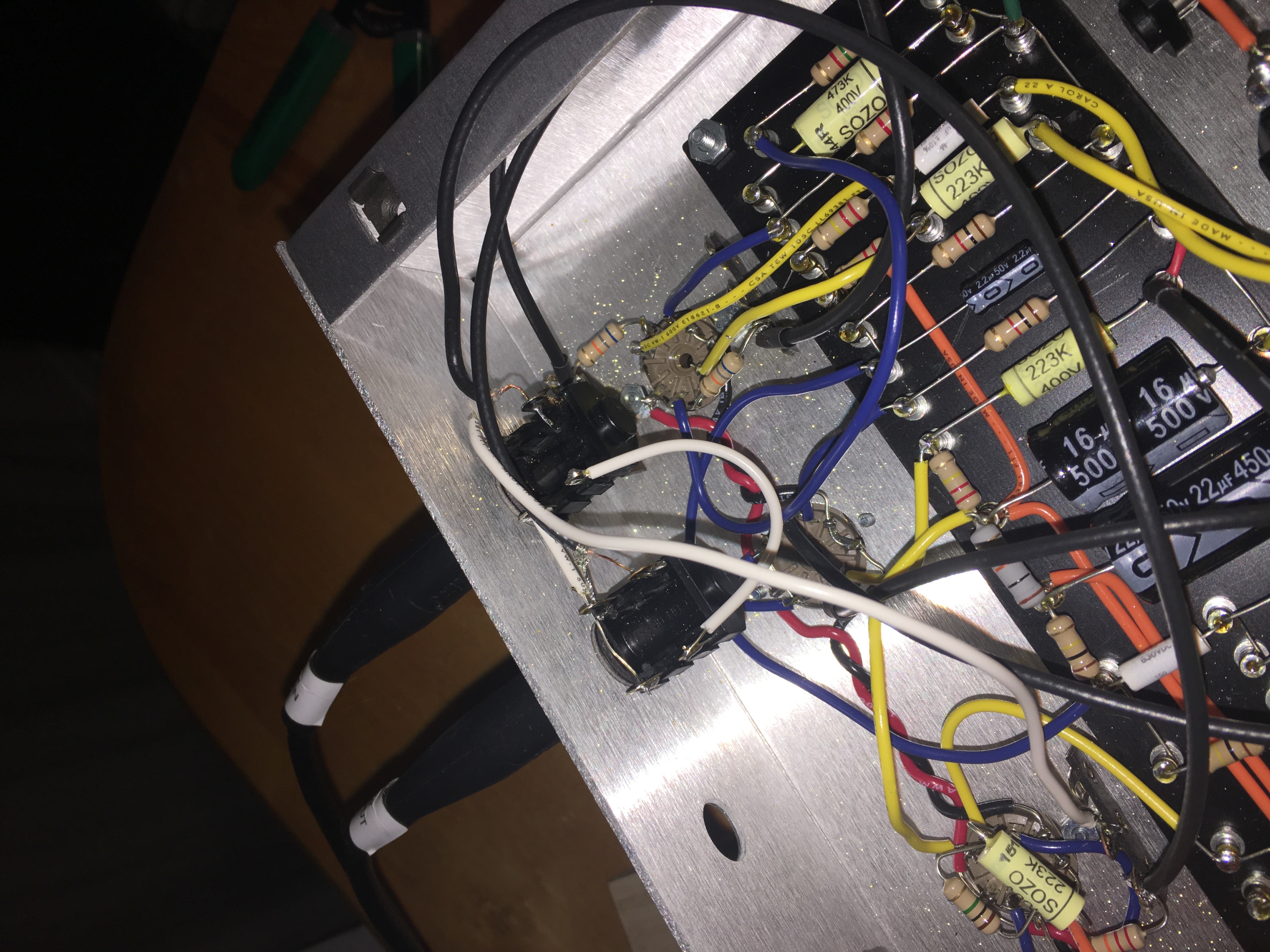

Just hooked the loop, From SEND to Master Volume middle pin and RETURN to terminal strip shared with R17 22K
but forgot to remove the existing wire from MV-pin2 to R17 on the terminal strip !!! Double feed CARNAGE!!! lol.
Now without the previous wire it's working like magic!!!
Thanks Stephen
PostPosted: Sat Jan 07, 2017 10:29 pm
How about a picture!!
PostPosted: Sat Jan 07, 2017 10:53 pm
Joined: Sun Oct 09, 2016 12:23 pm
Posts: 23
I did drill 2 more holes just in case I wanted to upgrade for the OD footswitch... (once I'm done with my OD problems...)
