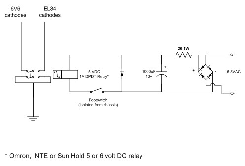

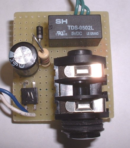

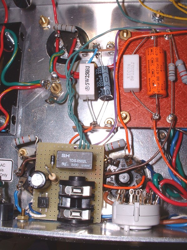

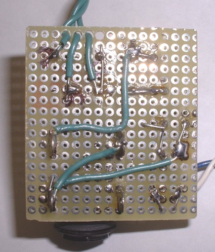

Changed things around a bit.
Gave both sets of tubes their own RC pair and now I am swithcing the ground sides of each with a foot switched DPDT relay I made up.
I am getting a click when it switches tho which I didn't expect. :x
