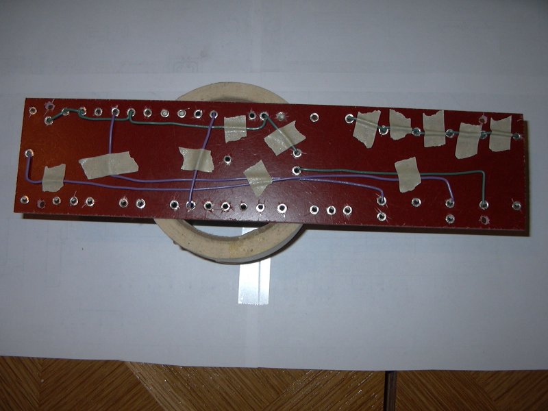

Here's my wife building the board. Don't tell her I put her pic up here - I'll be shot!
She taped all of the jumper wires to hold them in place until she got all the components
connected to each eyelet, then soldered each once.

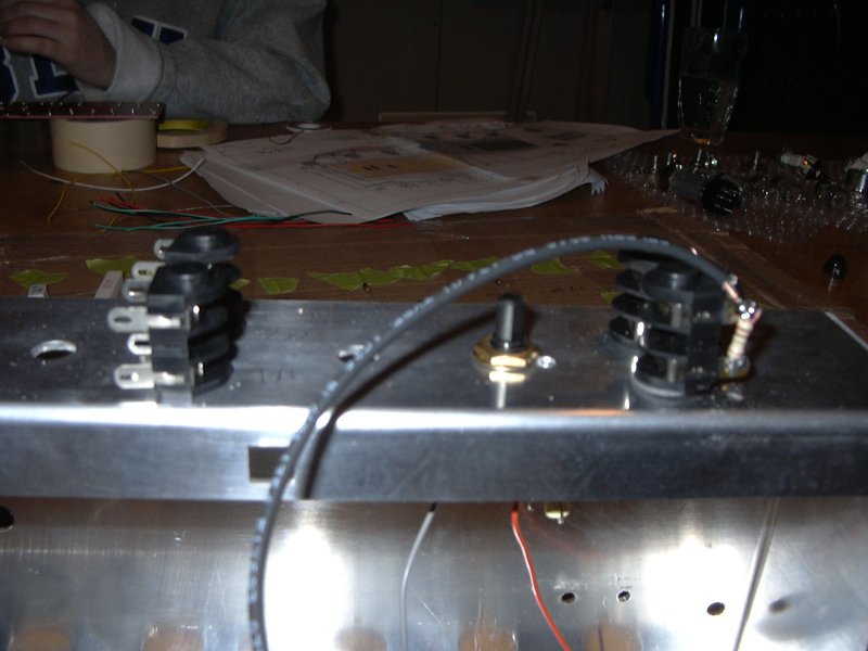

Then, I worked on the input Jacks. I mounted both to the outside of the chassis, marked "Hi" and
"Lo" so I wouldn't get mixed up and wired 'em up.

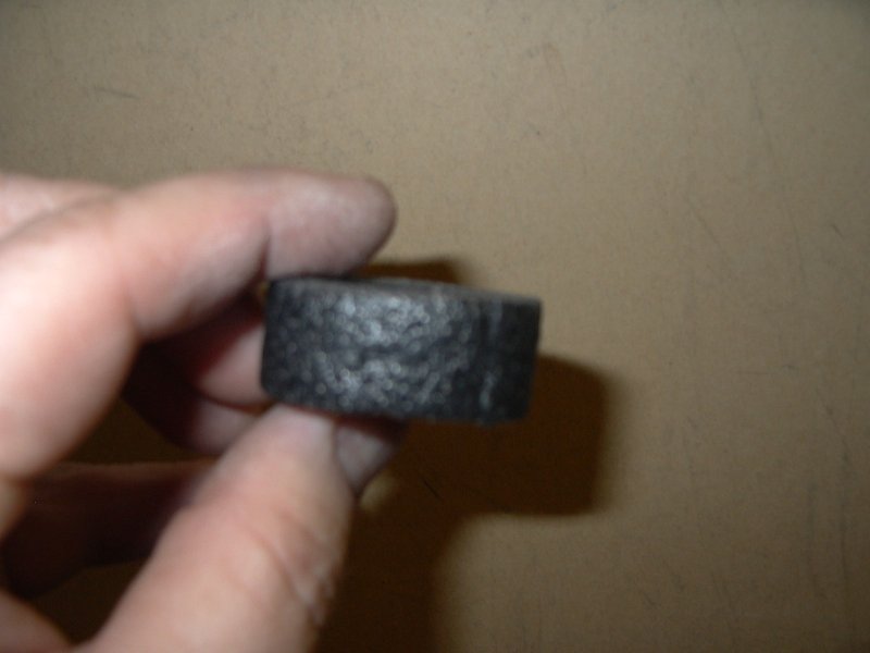

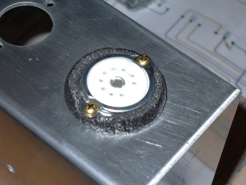

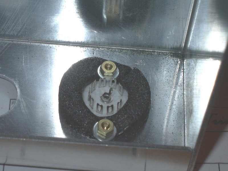

Then I did the suspension thing for the EF-86. Because the tube is reputed to be suceptable to
the vibrations when in a combo, this is recommended. I don't know how this will work, but I
thunk of it myself. I used one of those foam water pipe insulators, cut about an 2.5 cm piece,
then half way down, cut a groove to fit over the chassis to pad both sides and the screws.

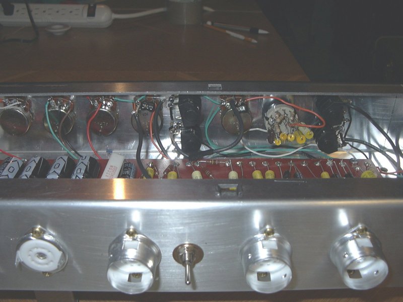

Here it is in the chassis.
And from the inside:

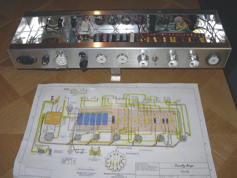

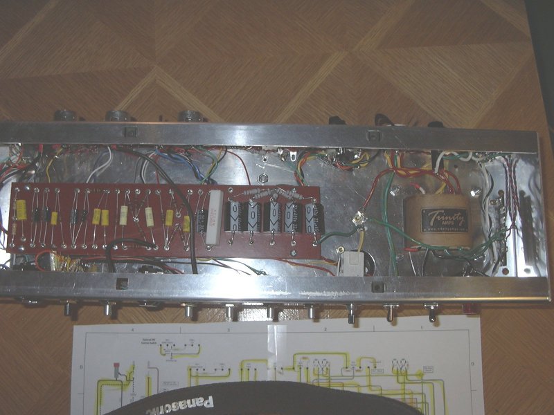

Here's the completed chassis. As I mentioned, not the neatest build out there, but it worked first crank! I'll neaten everything up a bit now that she fires.
Here is the front with the layout I printed off the forum documentation page with the continuity test highlights.
And from the socket side.
You can see the "Crunch and Munch" switch, which I considered mounting on the front mounted the existing hole on the back, to preserve the look of the front.

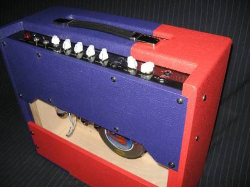

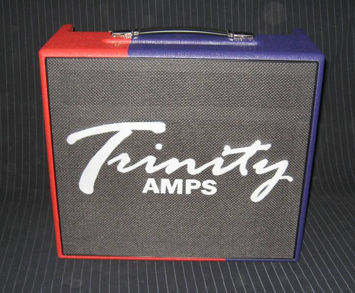

I was fortunate, since I know coco personally, to actually collaborate with him on this design. He told me the the type of cabinet he had in mind and I photoshopped up the design. We worked on the cabinet in two sessions. The first was to (to use the American Chopper terms) "mock it up". The second for completion
Once the first session was done, coco built up the grille cloth on the baffle and I took it home and made a stencil of an enlarged Trinity Amps logo and sprayed it on there with my airbrush.
Once I returned the adorned baffle to coco, we booked this past Thursday to finish the job, and I went to Trinity HQ to work on the tolexing and completion. We took over 200 pictures of the process, which I'll leave coco to post, so here she is:
and the back and control panel.
As you can see, this is not a traditional looking amp. I was looking to do something unique and with coco's help (Let's be honest, his leadership), it turned out just as I planned. So you see what it looks like.

I know of the reputation of the EF86 as detailed in my earlier post in this thread, so was anxious to see if my foam mounting rig would work as I had designed to dampen the vibrations. Additionally coco put a couple of O-Rings on tube to add to the damping.
Well, yesterday I got to find out how it would work. I turned the amp up to max volume and had my wife play and felt the EF86 and I am happy to report that the tube was completely isolated from the cabinet vibrations.
