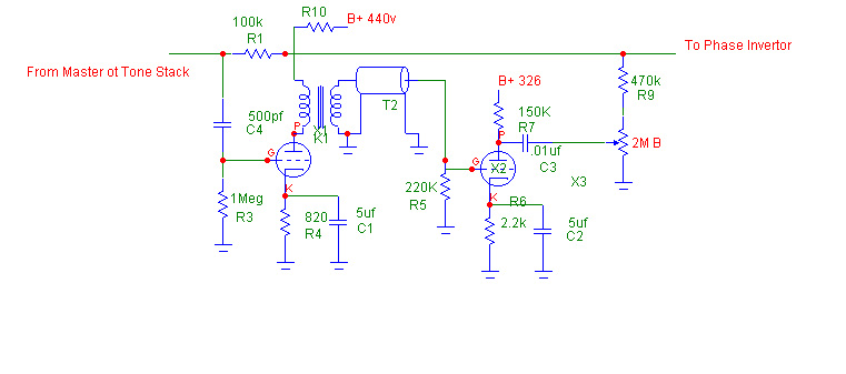

Update 1: Ordered my TC15 Kit!
Update 2: found some old threads with Kurtlives' reverb circuit. It looks similar to the Fender derived one above.
Would love to hear from anyone who has tried the Kurtlives circuit, how it turned out, any tips or suggestions, what components you used.
Schematic attached below.
I don't see where he says what kind of tubes these are.
Maybe there is a code for tubes on schematics that I don't know how to read?
It looks like he's got his RCA jacks grounded on both sides of the tank - so I am guessing this means it goes with a reverb tank that's insulated on the input and output sides?
