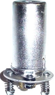

 Post subject: Re: Tube down TC15 Build
PostPosted: Tue Oct 22, 2013 10:53 pm
Look this over. http://www.guitargear.net.au/discussion ... ic=37811.0
Also:
https://taweber.powweb.com/store/chassis/chord2.html
Scroll down a bit, the part you want is listed as "9 pin shock mount".
Look at the pic, you can build your own. The socket itself is mounted to its own little sub-chassis with rubber grommets then the sub-chassis (really just an oversized washer) is mounted to the main chassis with springs on the mounting bolts. There's a lot of wiggle room in the assembly, that's what keeps the EF86 quiet.
You could mount the socket to a small square of sheet metal then suspend the square of sheet metal under the main chassis with four little springs.

I like the idea of mechanical suspension and other attempts have obviously failed at least with new production tubes (which I've spent enough money on already).
Stephen, that product is right up my alley as far as designing my own. The combination of springs which can be tensioned to suit and some small hydraulic o-rings for screw isolation can't hurt. I'll see what I can come up with.
