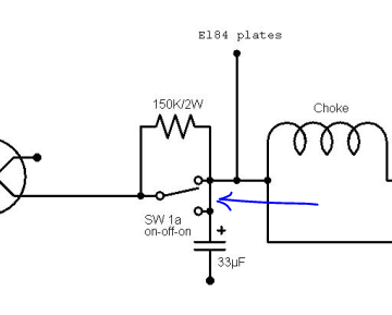

well, the problem was to have the same switch do both.
But I think a dpdt could do it in a way that just shorts out either the choke or the 1k5 resistor.
I've attached a schematic - let me know if it seems alright.
Regards.
Anders

The connection between the poles on sw1a makes the switch irrelevant. Either position gets you the same circuit.

PostPosted: Thu Apr 25, 2013 2:14 pm
Must be an error (the drawing equivalent of a typo).

arjepsen wants to use one switch to select whether the choke or the 1k5 resistor is in series with the rectifier and also switch the amp in and out of standby. It's a dpdt switch with a center off position. The amp would be in standby in the center position. In the other two positions the amp would run with either the choke or the 1k5 resistor in series with the rectifier.
The poles on the b section either short out the 1k5 resistor or the choke, effectively placing one or the other in series with the rectifier.
Meanwhile the poles on the a section both have to do the same thing which is to connect the rectifier to the rest of the power supply. But in the center position there will be no connection and the amp will be in standby.
arjepsen, your circuit is will work and it's a good efficient way to do the switching. Stephen says you don't need the 150k resistor in standby, Merlin says you do. You'll have to decide which way works best.

Posts: 126
Ah....I wasn't visualizing the null position on the switch. Thanks for the correction & sorry to confuse the issue.
