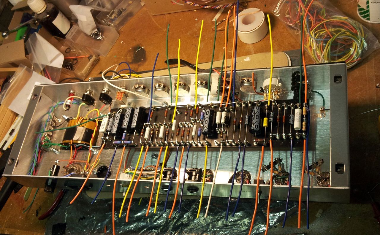

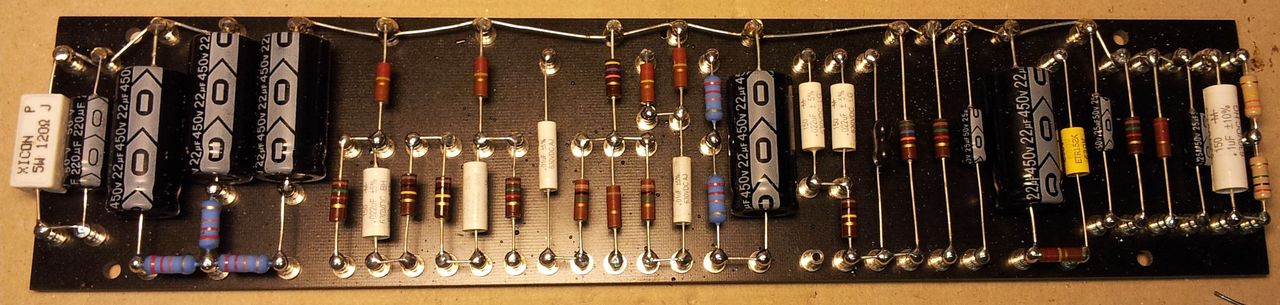

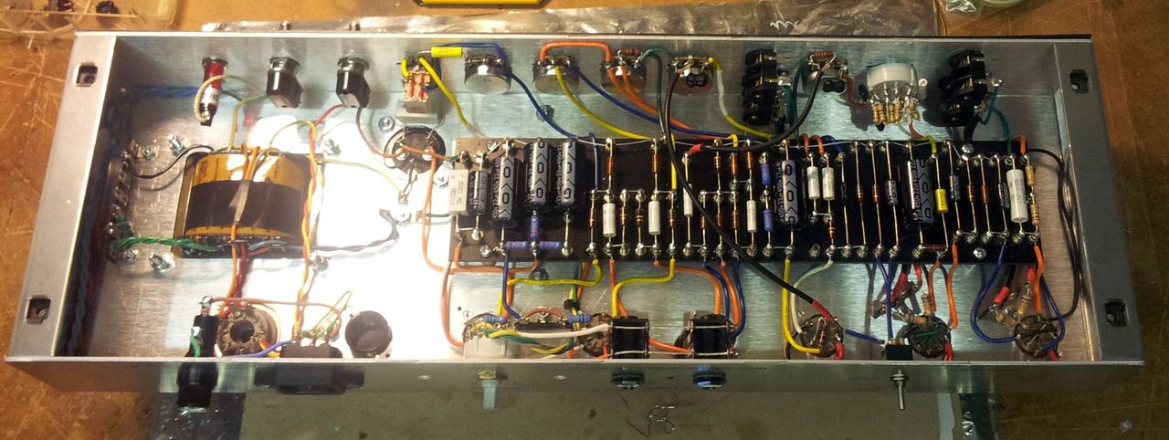

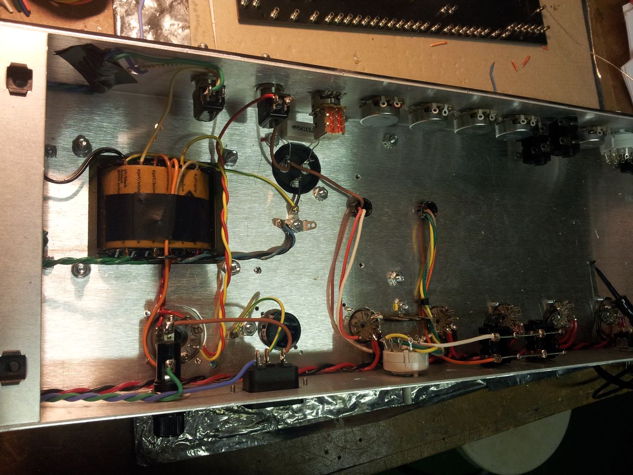

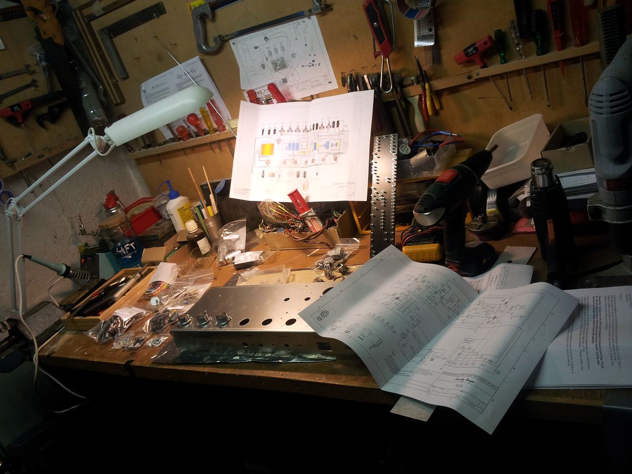

hey guys,
i ordered the tc-15 kit in the late of the january. after a long delivery, i finished the kit in a couple of days... ;)
today, i gonna crack this beauty in the jam session...more to follow!
thanky you very much stephen and your team for this beauty!
cheers raffa

PostPosted: Tue Apr 23, 2013 12:29 am
That's a pretty neat build. Lets us know how it performs.
