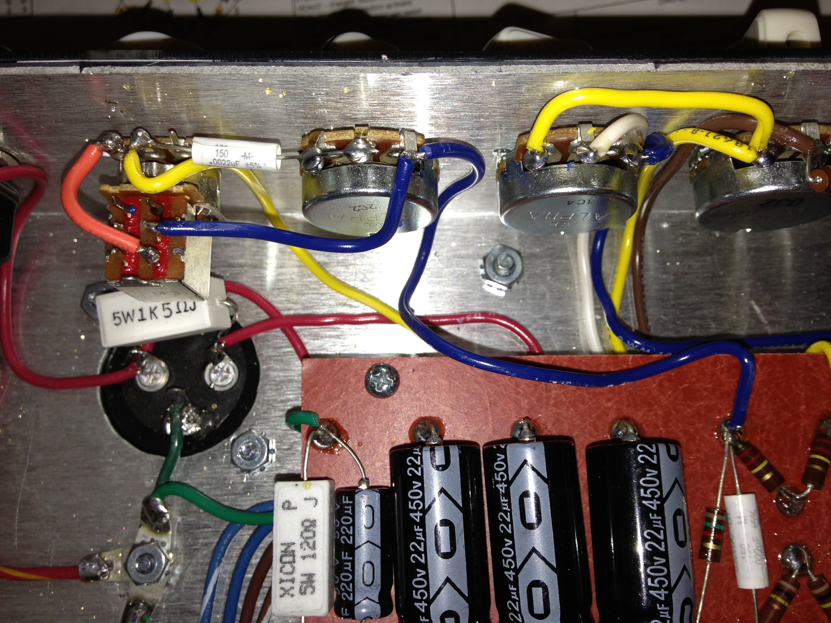

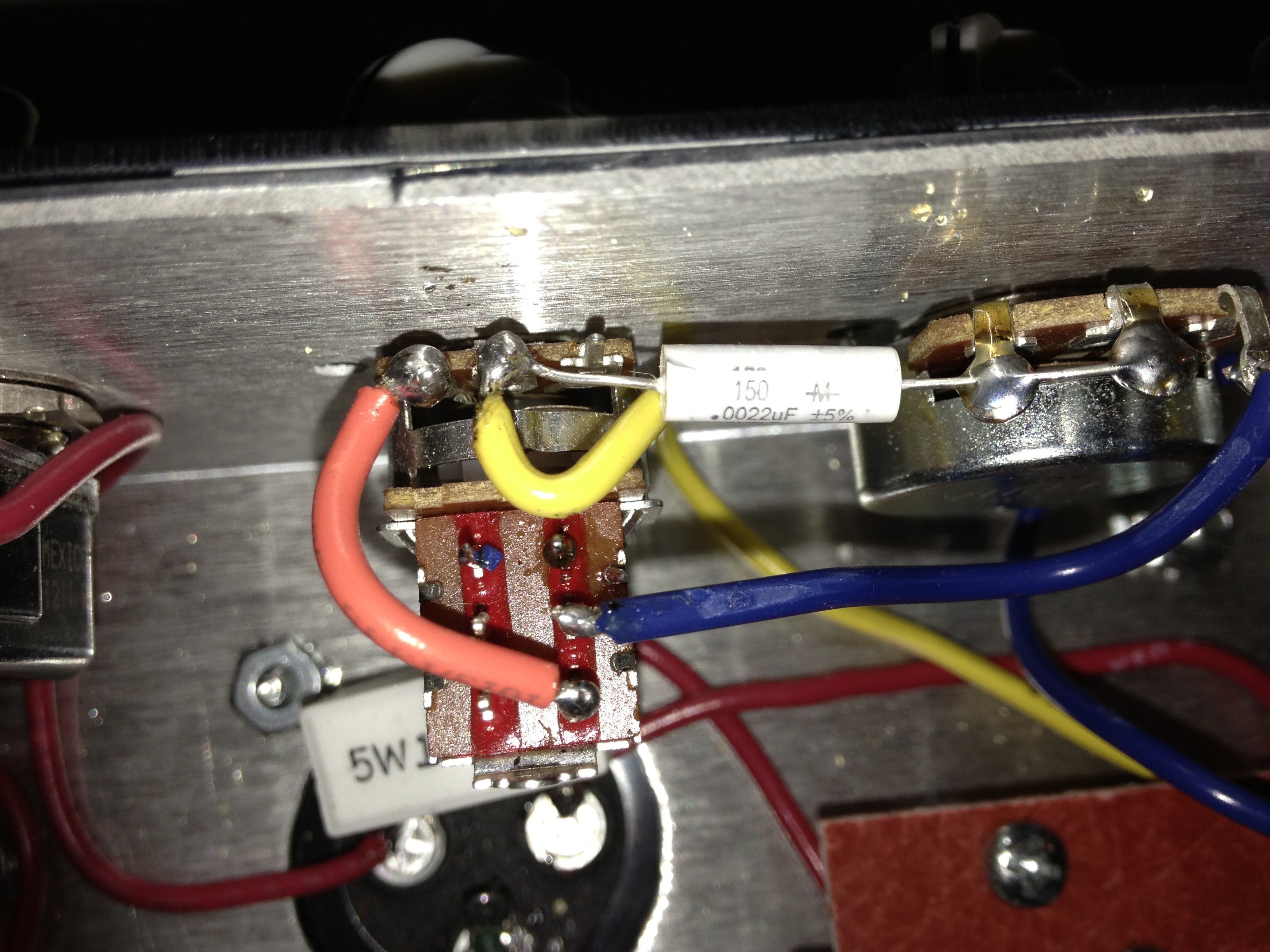

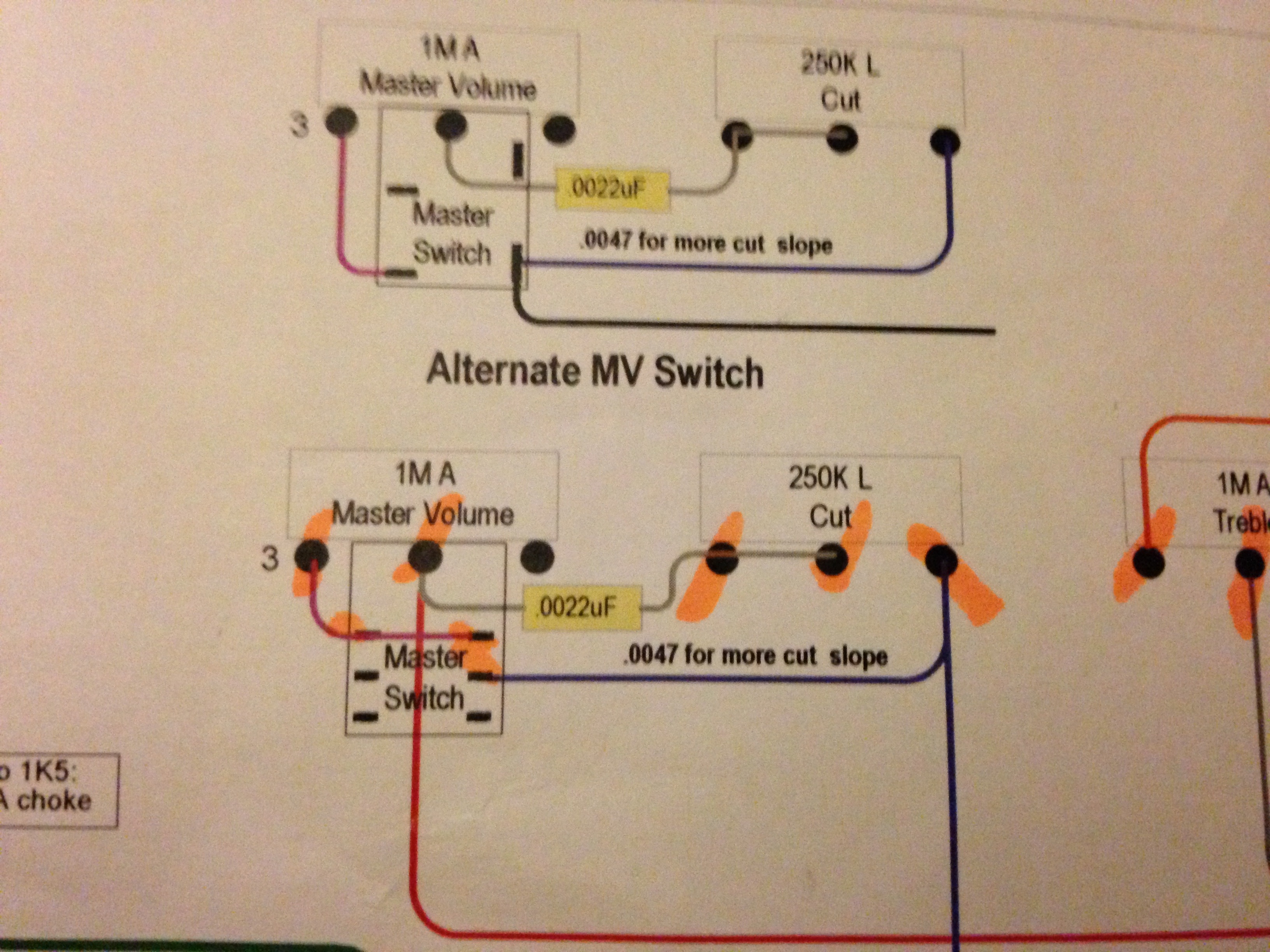

I have attached a photo of my master volume build and the layout i'm following. In this arrangement the cut does not work with the master volume engaged (pot pulled). it does work with with out (pot down).

Just throwing things at the wall but the first thing I'd do is just unmount the pots from the chassis and check without the pots touching chassis. Next I'd take that blue jumper and get it hooked to where the orange wire from the switch part of the pot attaches right at the pot terminal. That would make a temporary switch bypass (as if knob MV was engaged all the time) to see if it is switch.
I'm not sure if it matters if the yellow and blue going to the 220k resistors makes a difference which ones they go to but it wouldn't take much to switch the yellow and blue wires at the pots around just to see. Someone jump in if this is bad!
I don't know how to check the cap jumping from MV to Cut pot but basically there is the two wires going to the board to isolate the circuit. Other than that the whole Master circuit contains a 250K Liner cut pot, a 1M MV pot, a switch and a cap. If I knew how to test the cap I could probably figure out how to test each component individually as my chassis is still open on the bench and everything works fine!

If you want to, you can disconnect all leads from the switch and check continuity . There are two sets of poles so if one set is for some reason bad, use the other side. Look at the schematic and you'll see how this is designed to work and see if you can sort it out for the schematic as well. Sometimes that sorts out a wiring problem you overlook.
The cut is just across C9 and C19 and tied to the switch for convenience only.

Ok, let me take a look at this. Go back to the schematic, the cut is always in the circuit. It is across C9 and C19. So, just to make it work, check that the wires from those two .022uf caps go direct to the cut pot. Trace the circuit from there.

OK I have followed you instructions. All appears to be connected correctly. See Pics.
C9 is connected to pin 3 of the cut pot.
C19 is bridged across pins 1 & 3 before connecting to the pin 2 of the MV
Pin 1 of MV is also connected to pin 6 of the MV switch because i wanted to reverse the switch action (cut problem either way).
Any ideas?
