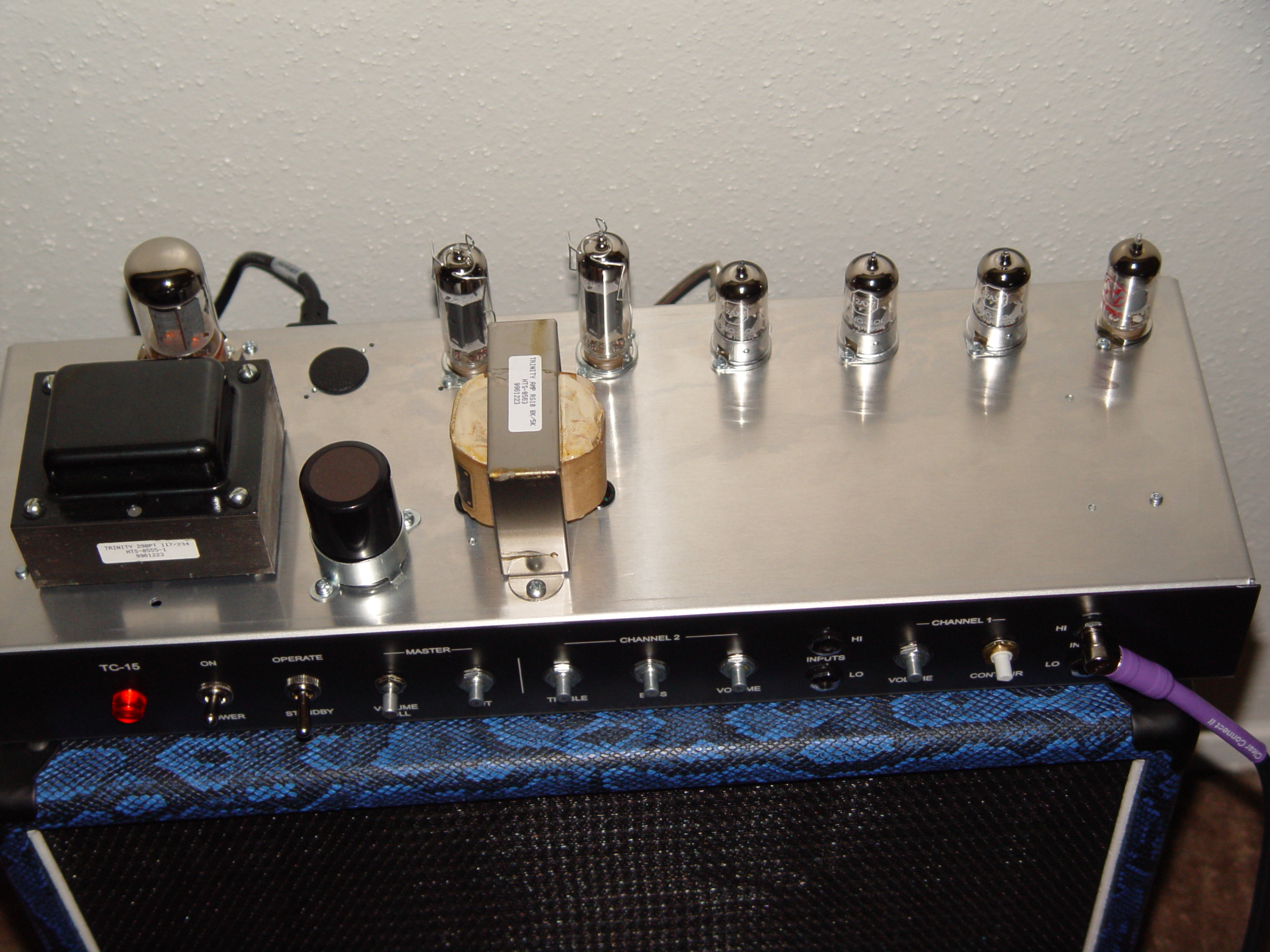

Just finished my TC-15 build and it sounds amazing! Still need to do some voltage checks, but I am very happy with the tone! I will be starting work on a head cabinet for it soon!

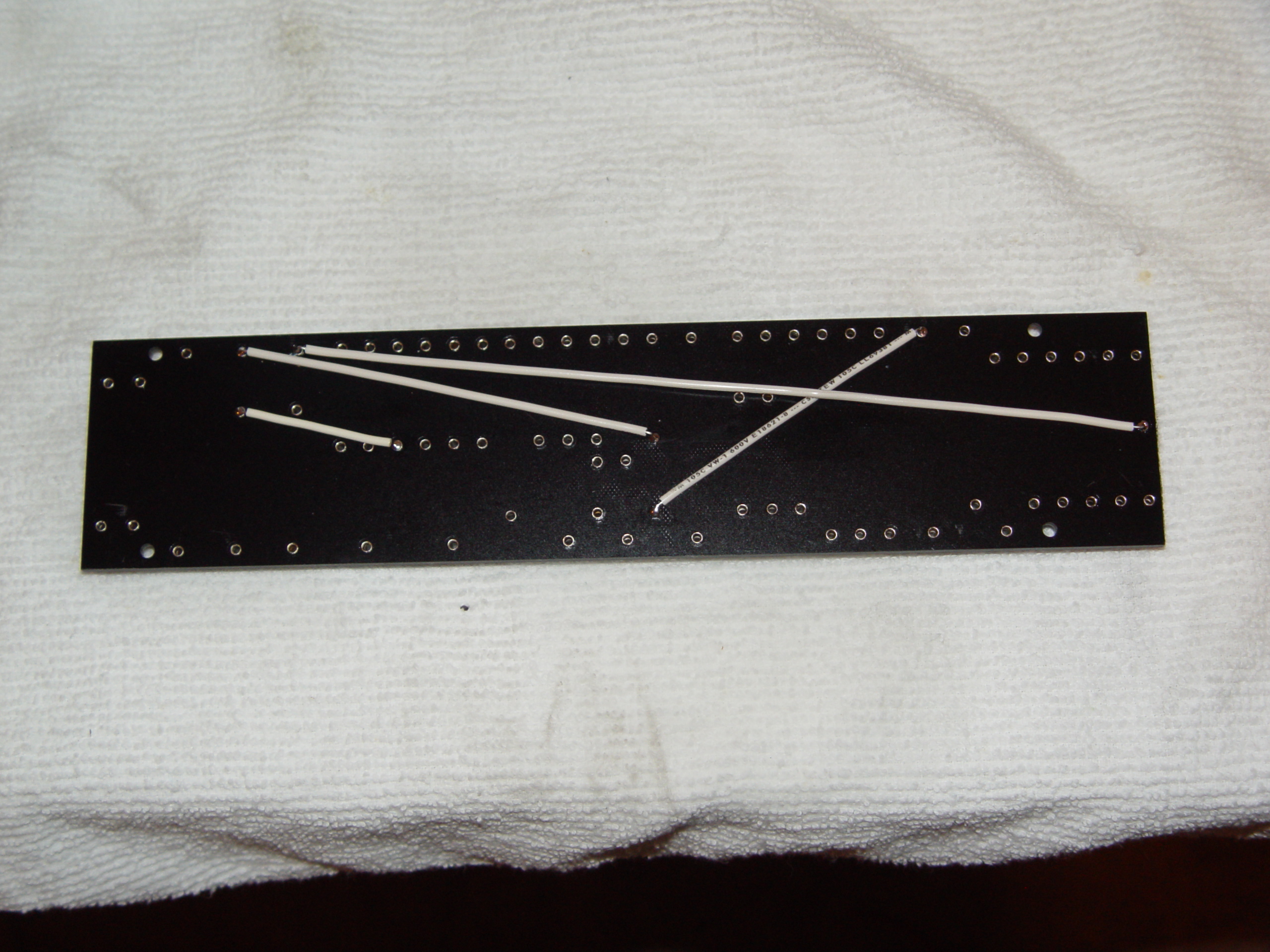

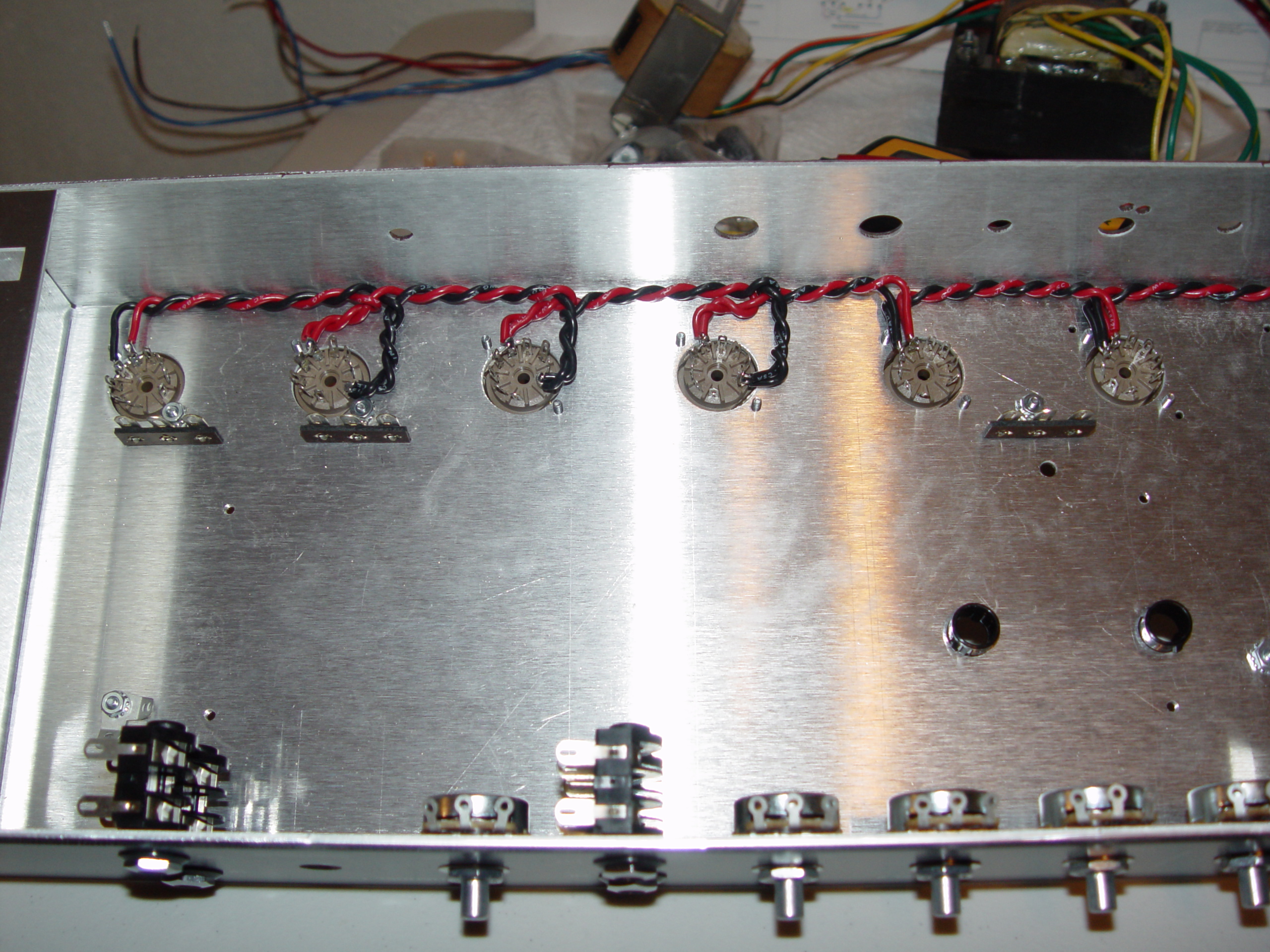

Next up was heater wiring. I have never used solid core wire but really like the way it stays put once it is soldered. Makes lead dress much easier!

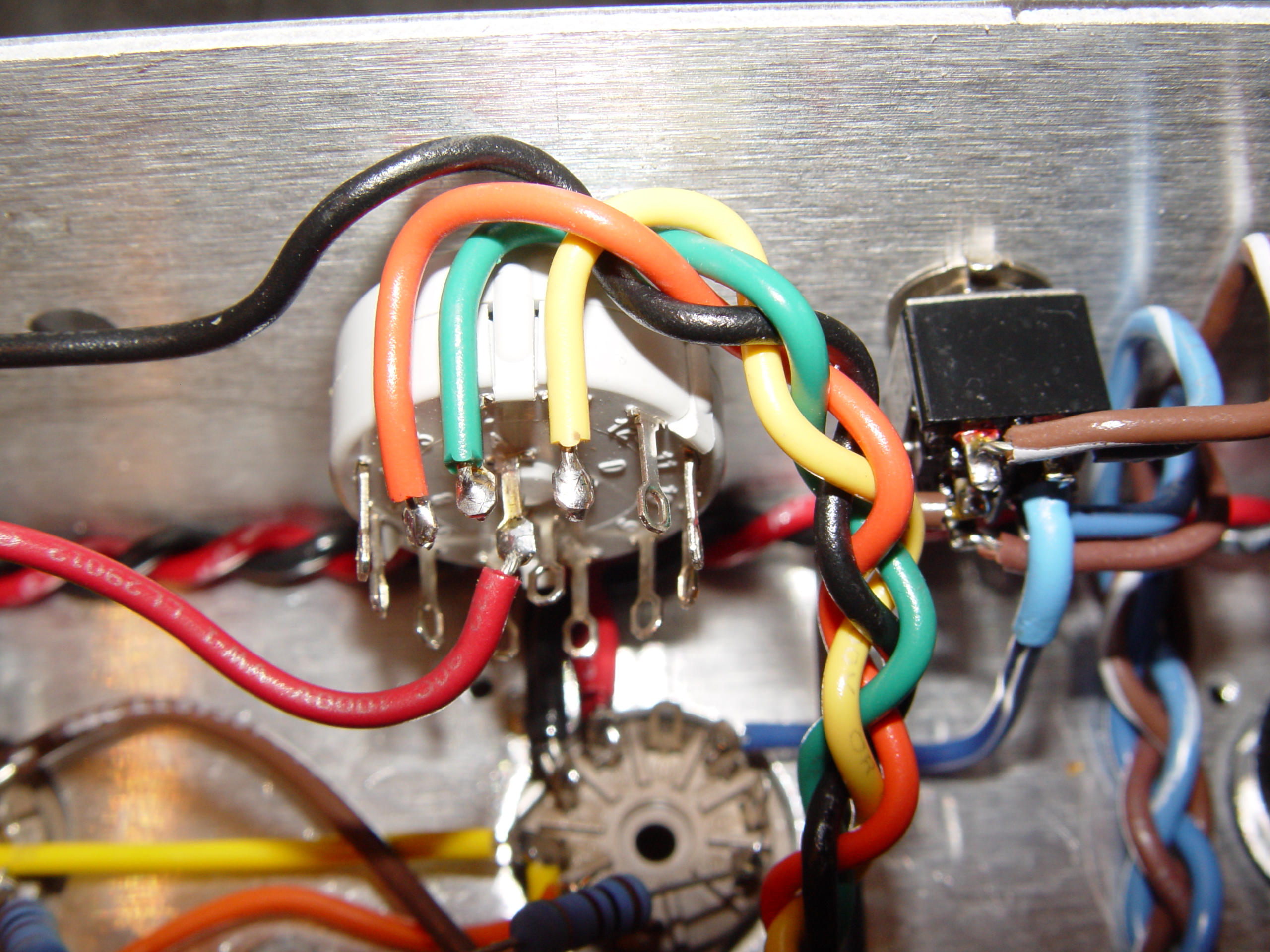

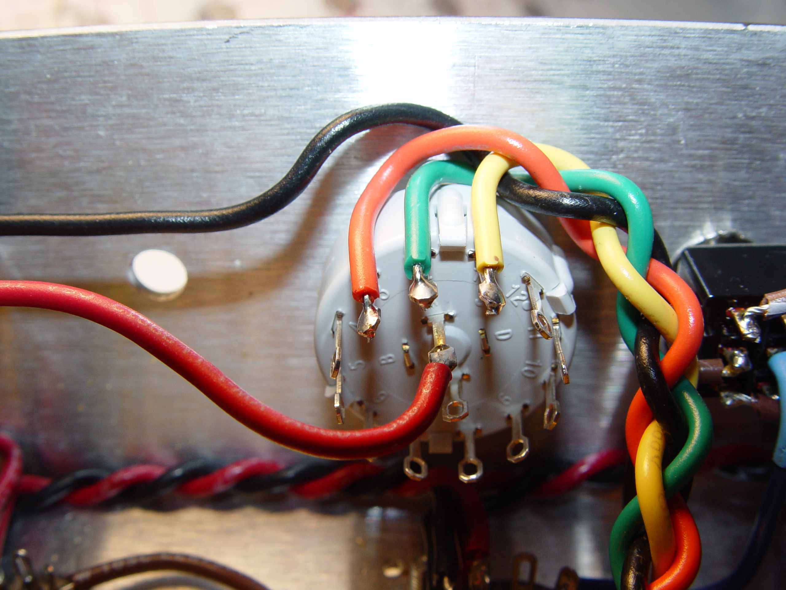

One of the biggest challenges for me was the contour switch. Really wanted this to look and function correctly!

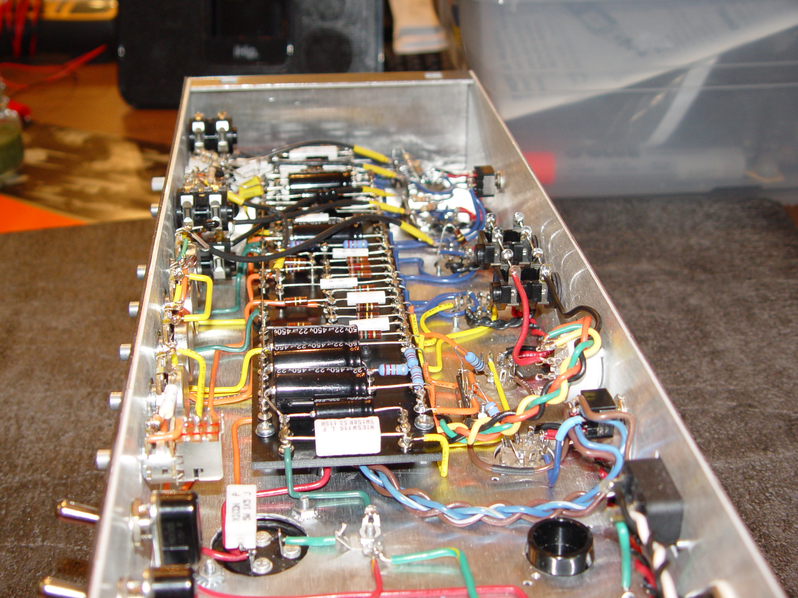

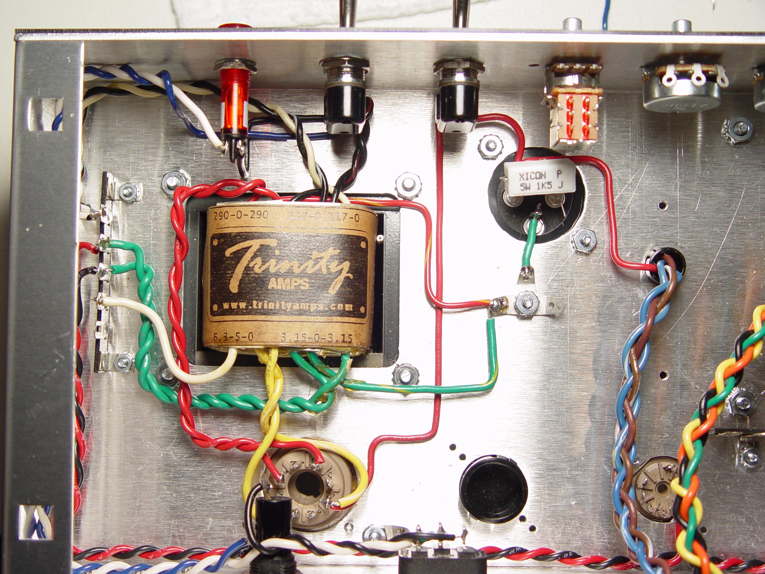

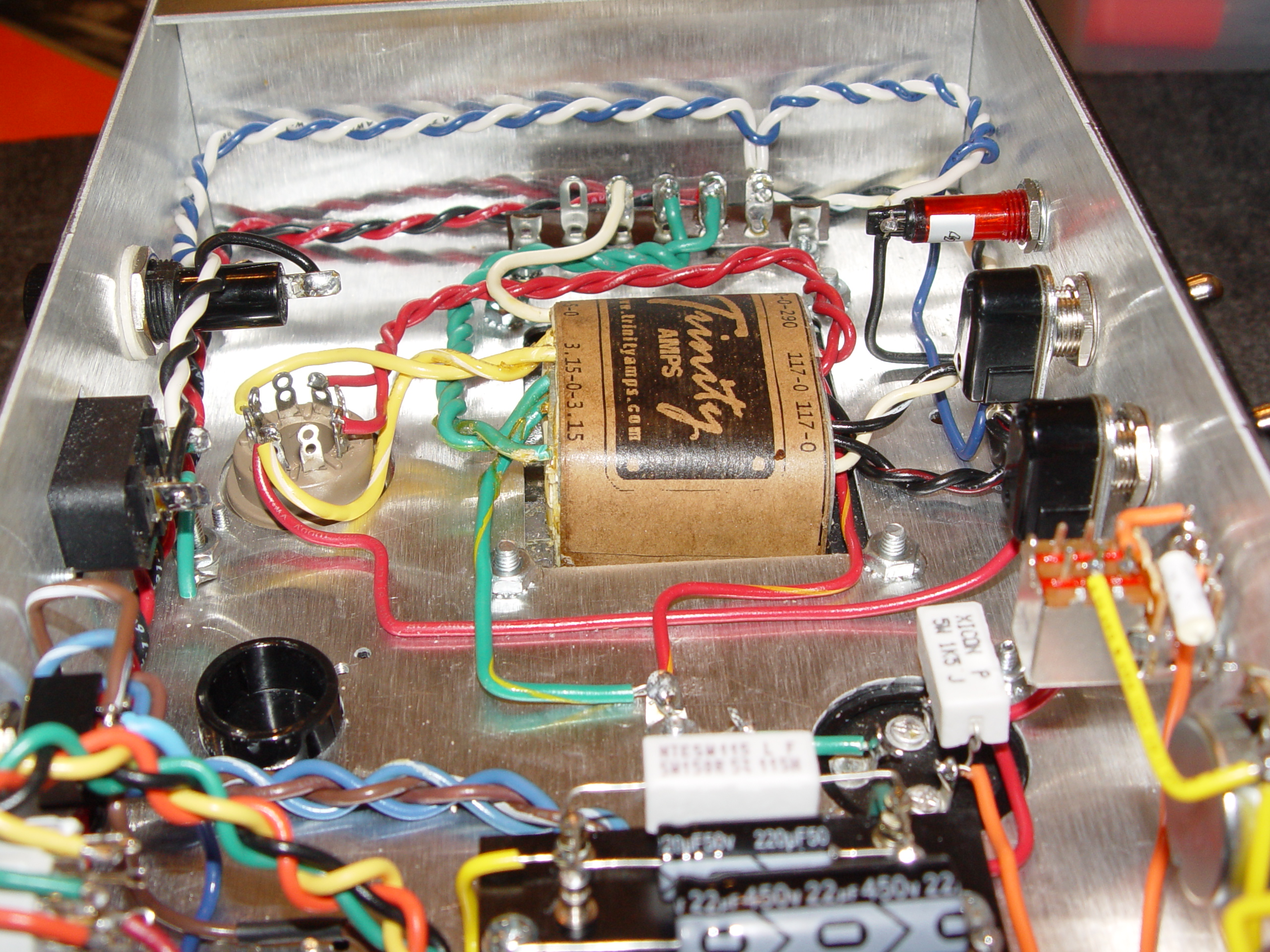

Next was the line cord, fuse holder, power/standby/ and PT!
Tried to keep lead dress nice and neat!

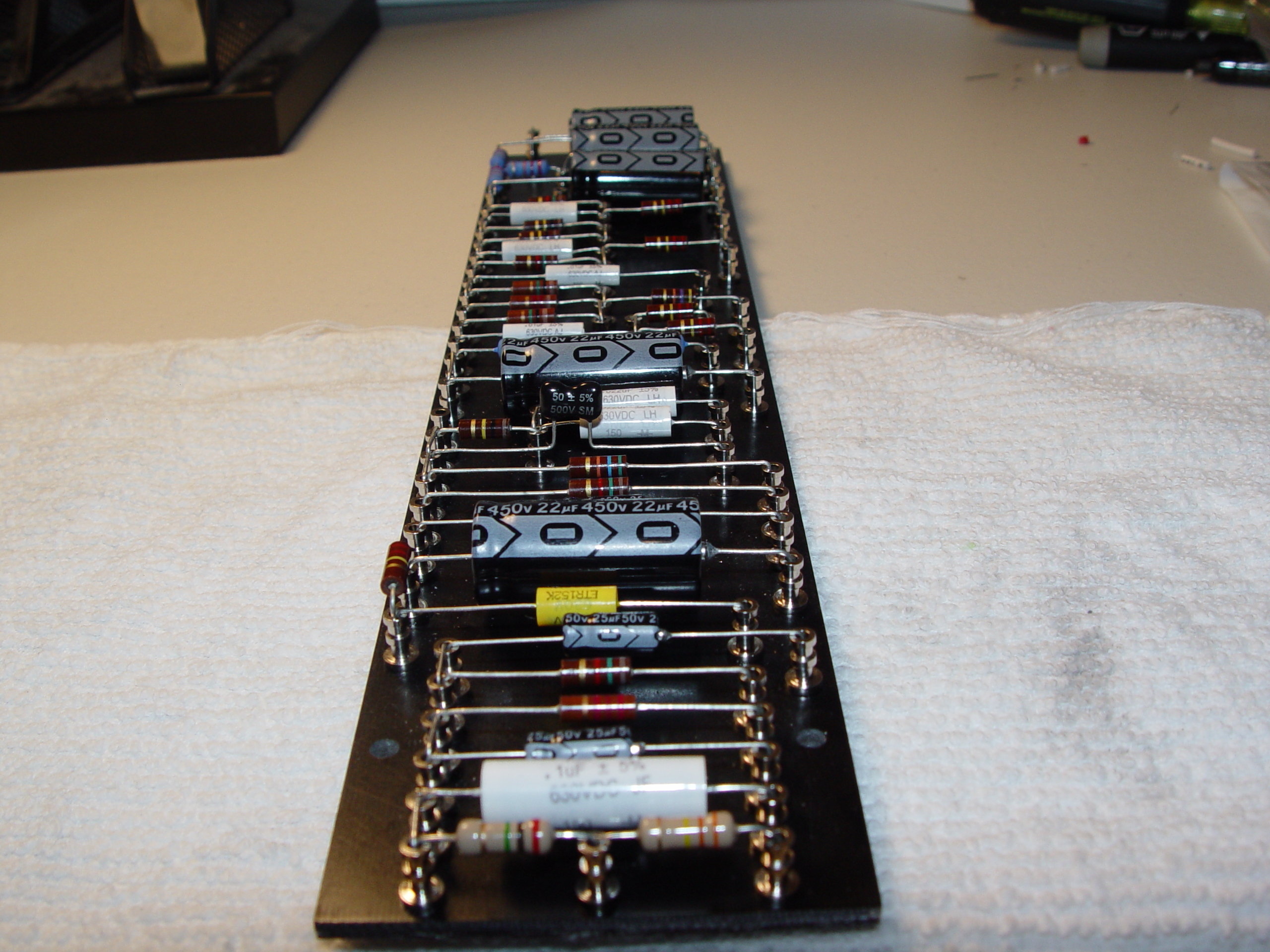

Back side of the board.

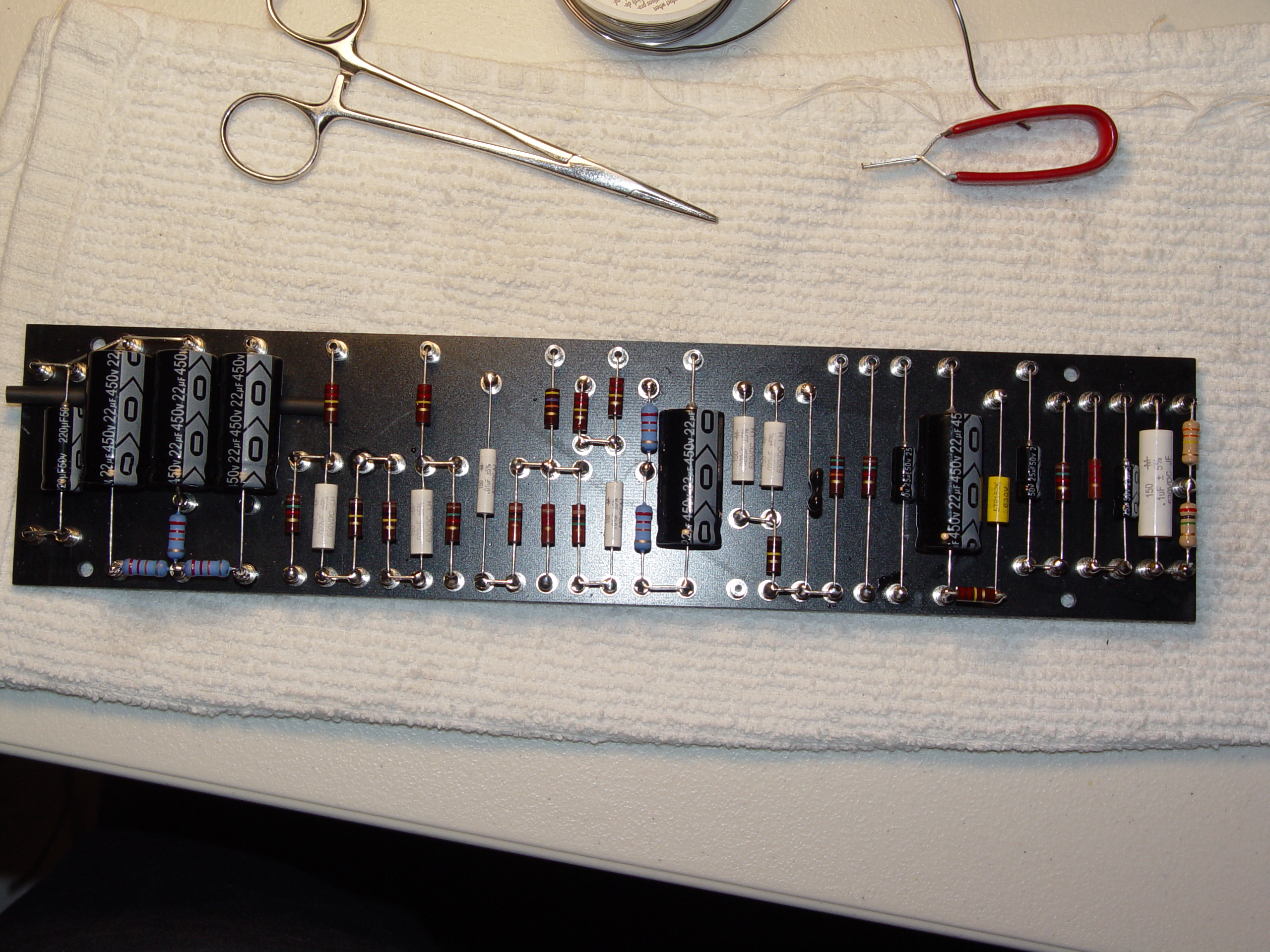

Laying out the components on the board.

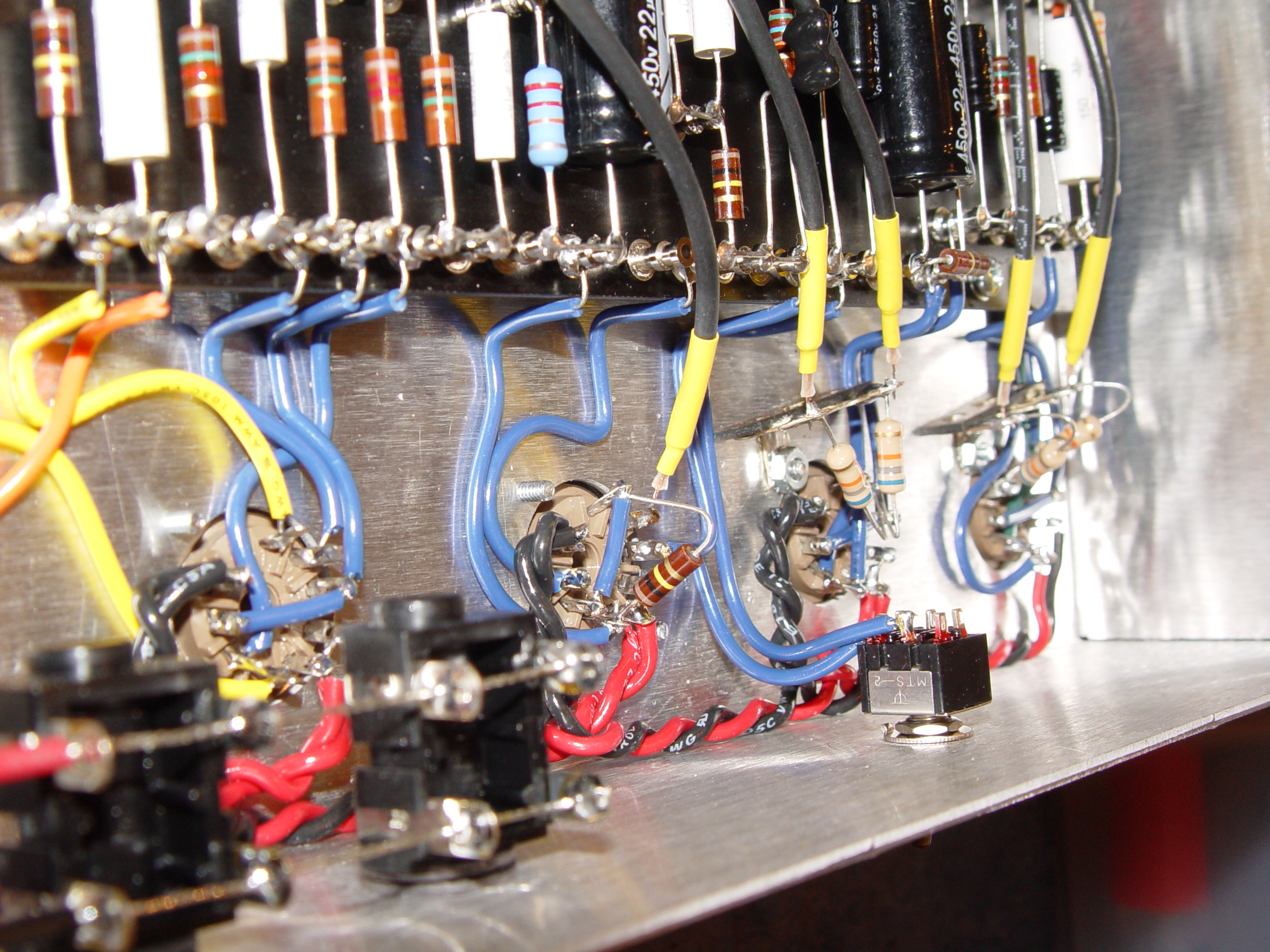

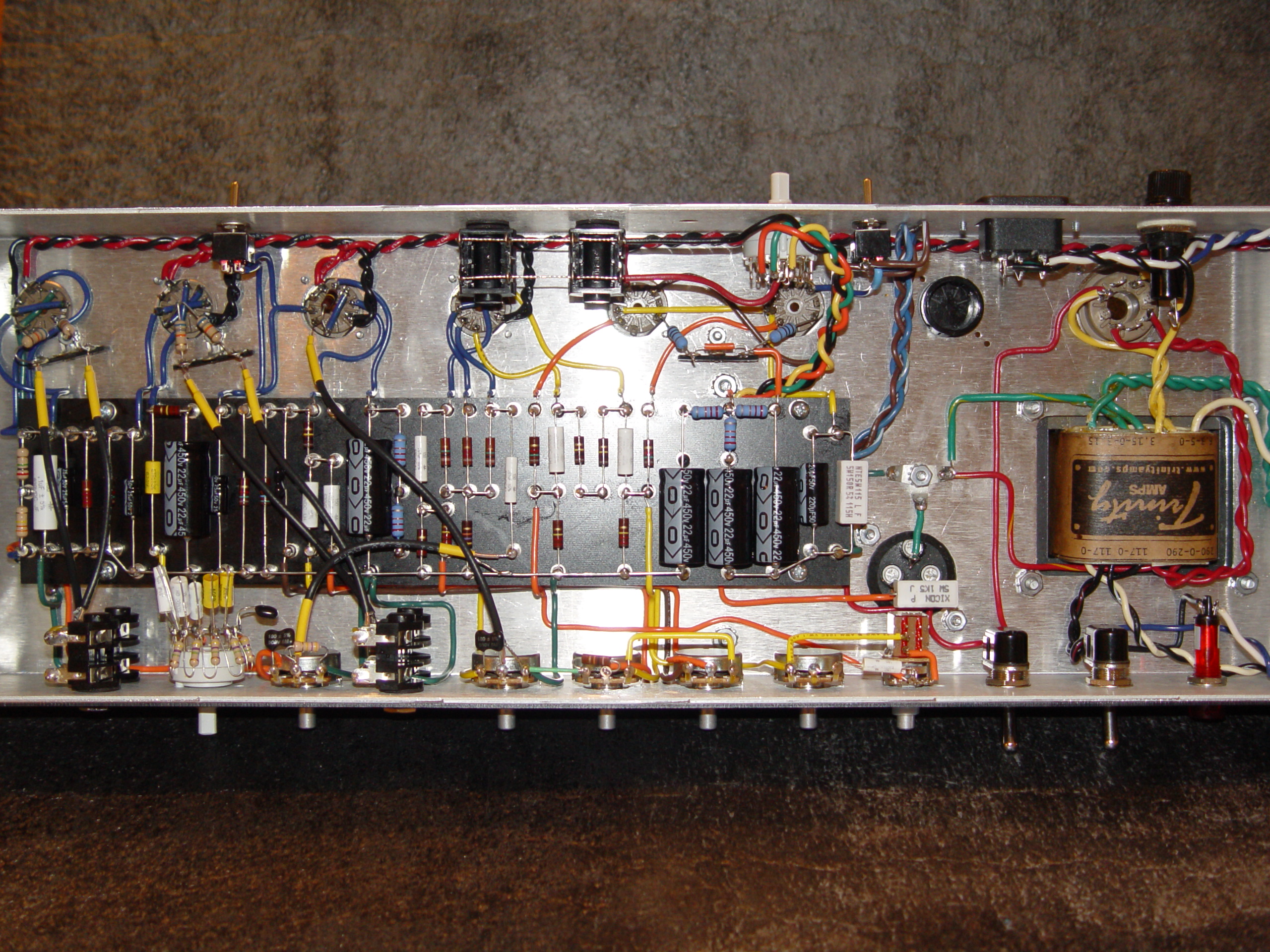

Final set of pictures. the build went together really well. The instructions were great. If I had to ask for anything, it would be a few more inches of shielded cable! There was enough in the kit but not enough if you made a mistake!
