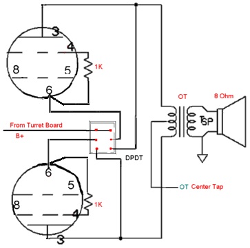

I still have to complete the half power switch, but do not have resistors on hand.

Glad it all worked out and you like it. We'll get you the new MV and sort out the half power option you wanted.
Here is a basic half power switch. You basically switch in/out the 100R resistors included in the kit, with a DPDT 5A switch. In the pic below, the 1K resistors are 100R in the TC15.
