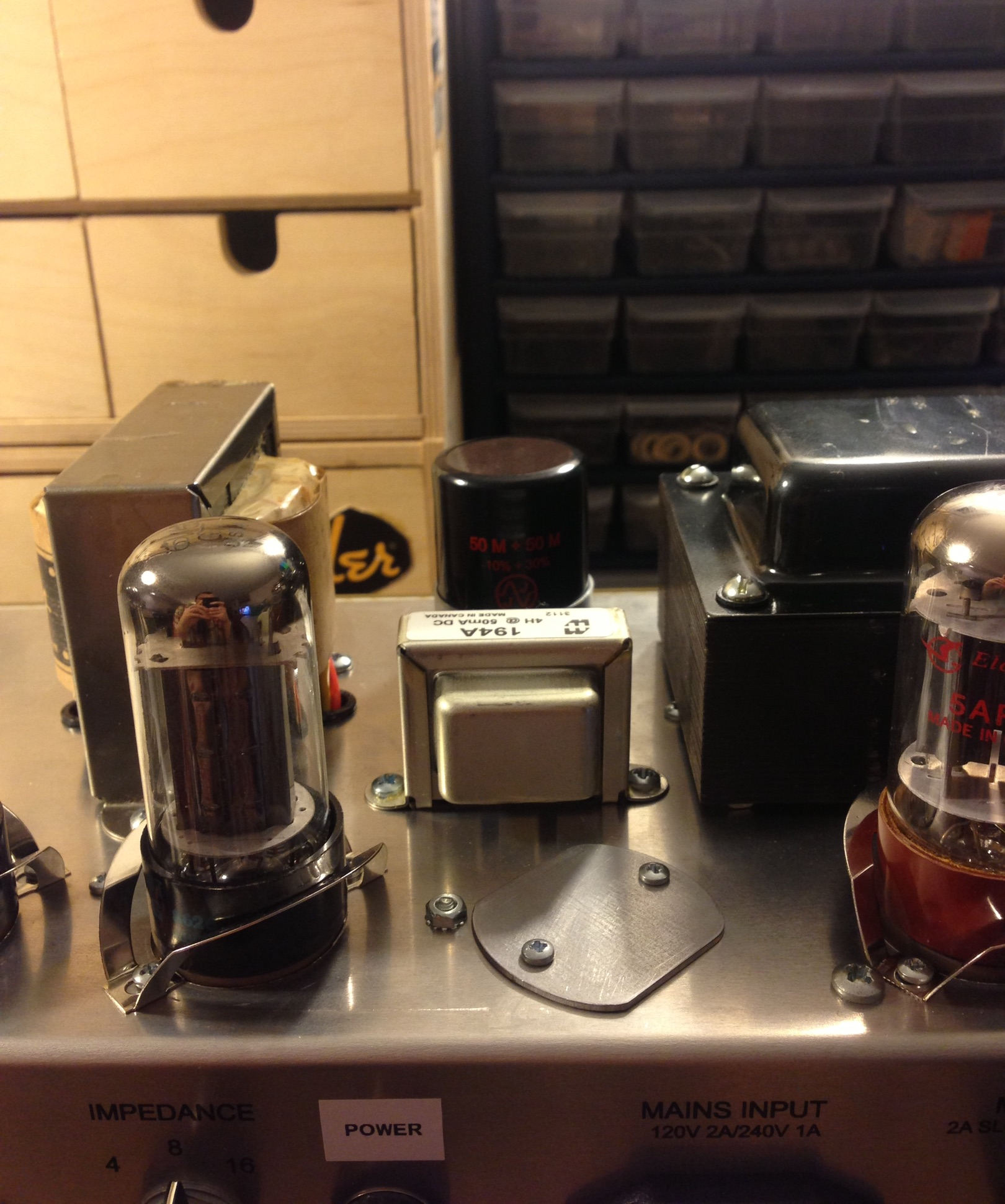

What kind of choke is that, it looks huge?
I’ve added chokes to 18Ws and TC-15s and usually used the 50mA Hammond chokes.
See attached pic for my 18W choke placement. No noise

Bigger equals stiffer. Not better, not worse, just different. 100 mA is well over what you nee, as mentioned 50 mA would be fine. I would try it without moving your output transformer if you could and see if it causes any extra noise.
