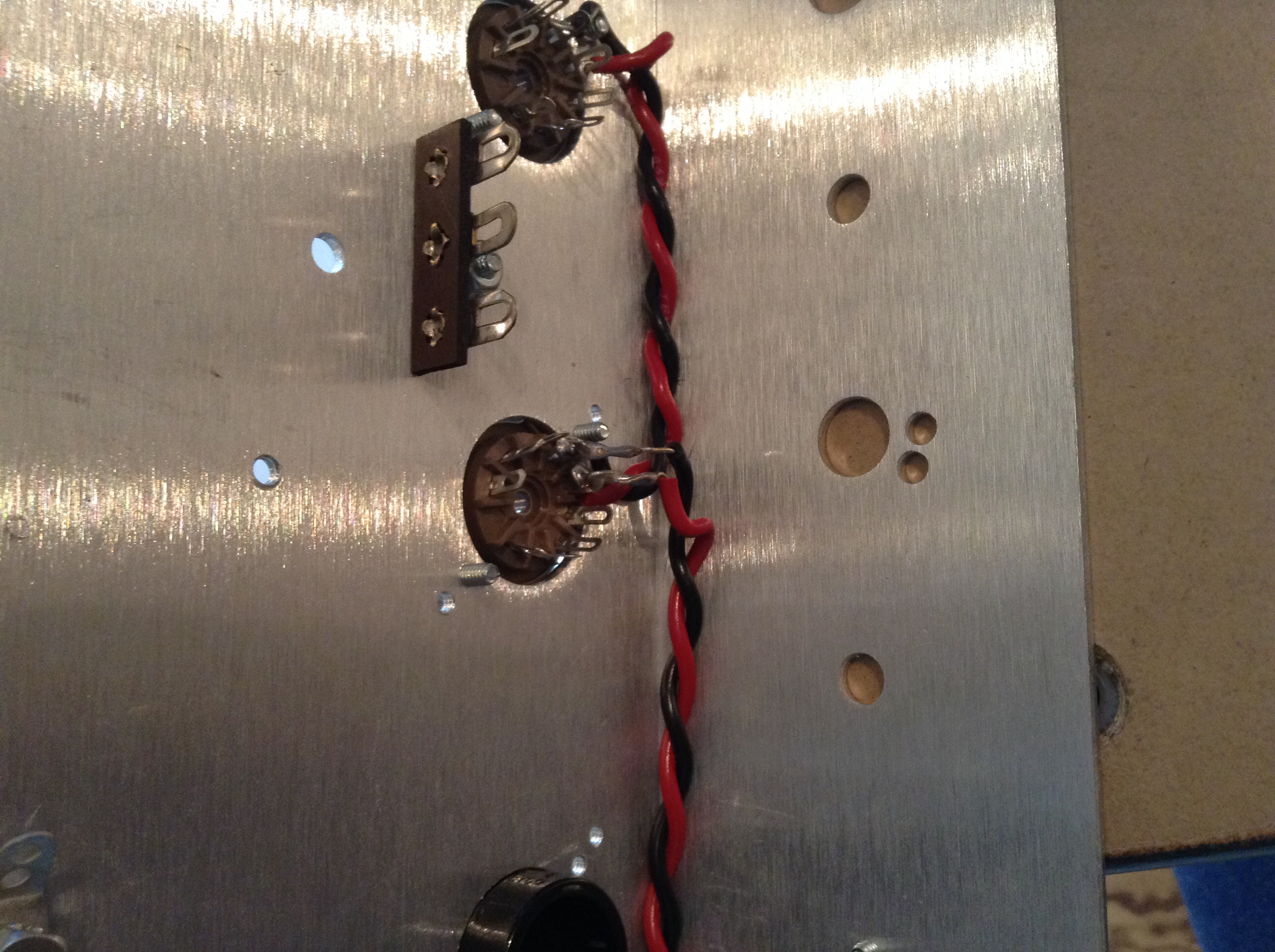

Think I stripped a bit too much on this first one. Will it cause issues? Pic attached...
PostPosted: Wed Oct 28, 2015 4:13 pm
Yeah too much exposed wire. You're going to get a short.
PostPosted: Thu Oct 29, 2015 7:33 pm
Joined: Tue Oct 20, 2015 11:37 pm
Thanks - how about covering with electrical tape?
PostPosted: Thu Oct 29, 2015 10:46 pm
No
Redo the wiring
Electrical tape doesn't belong in tube amps.
