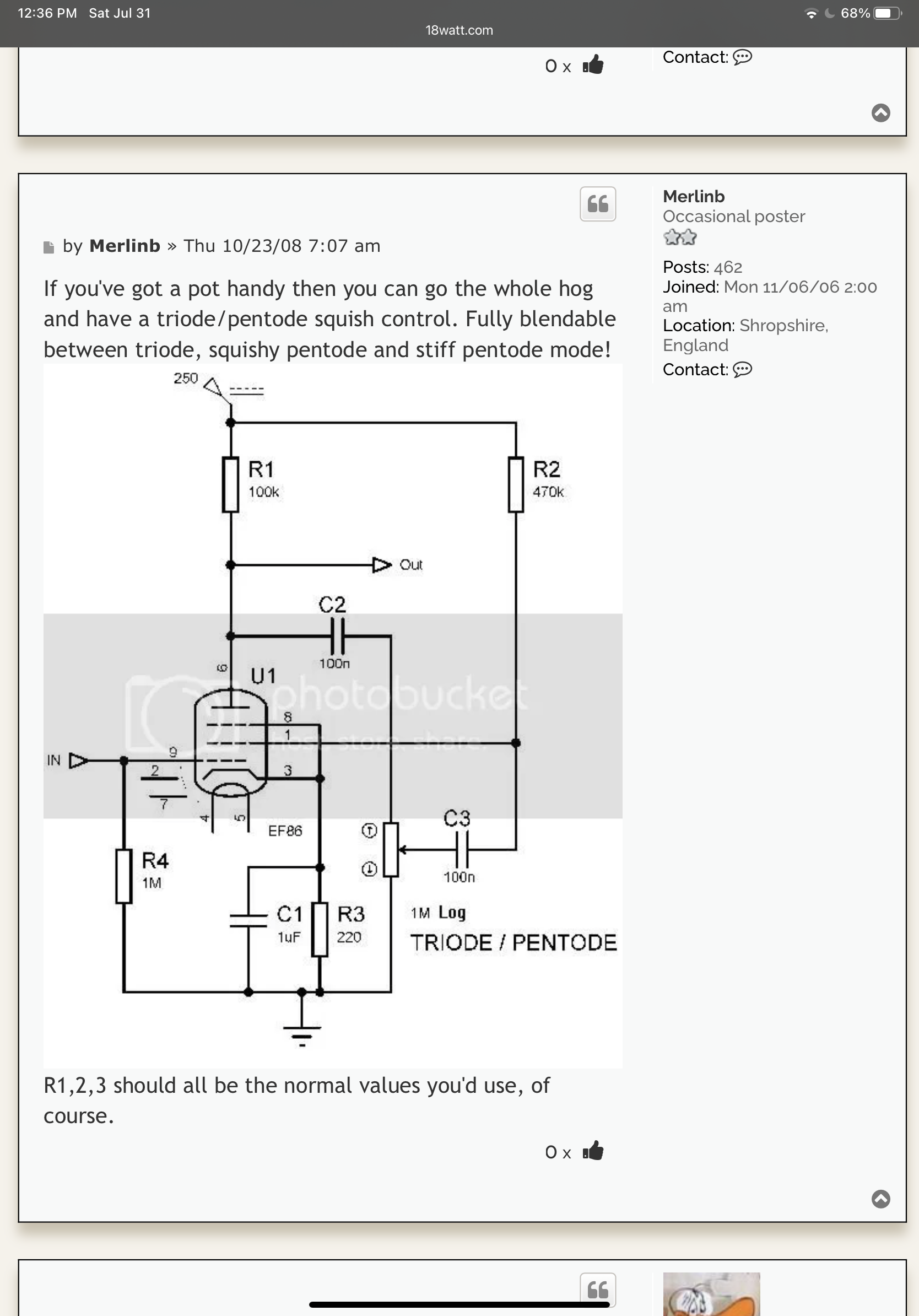

PostPosted: Sat Jul 31, 2021 12:41 pm
I did the squish/morph mod using the spare 1meg pot. It really helped tame the gain and harshness and adds a nice compression. Photo is from the discussion on the 18watt forum.
