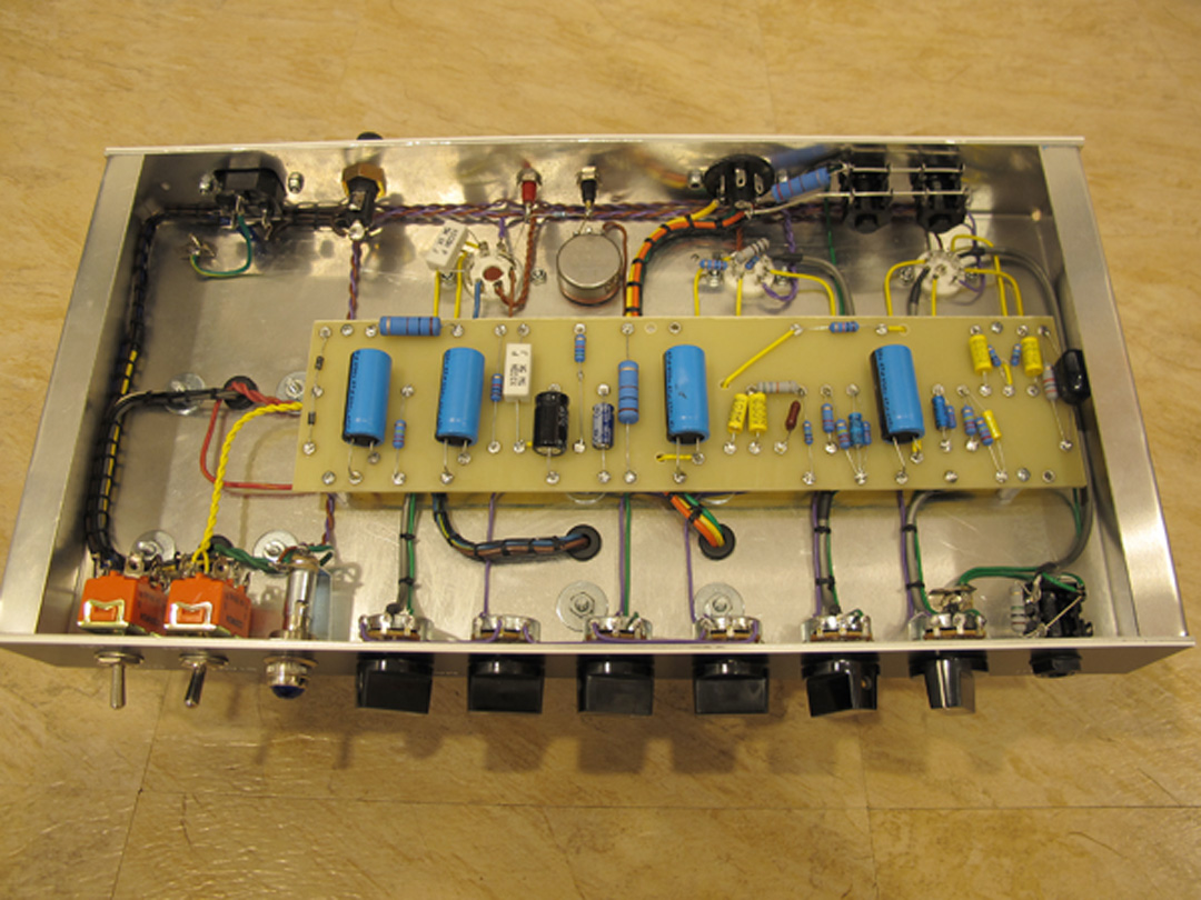

Great looking build so far. You can't be too neat when it comes to wiring and keeping the insulation good as close to the joint as possible. It can be tricky some times to do that without melting the insulation.
Good organization, too. I never thought of using styrofoam and masking tape to keep the resistors sorted and handy during a build. You learn something new every day!
Nice wire braiding. I have never tried doing that. I usually use cable lacing to keep transformer and ac wires under control. Something like this:
It's not my TC-15, it's an amp I built later but it shows the technique. You can also use nylon cable ties and that's what I did on my TC-15.
