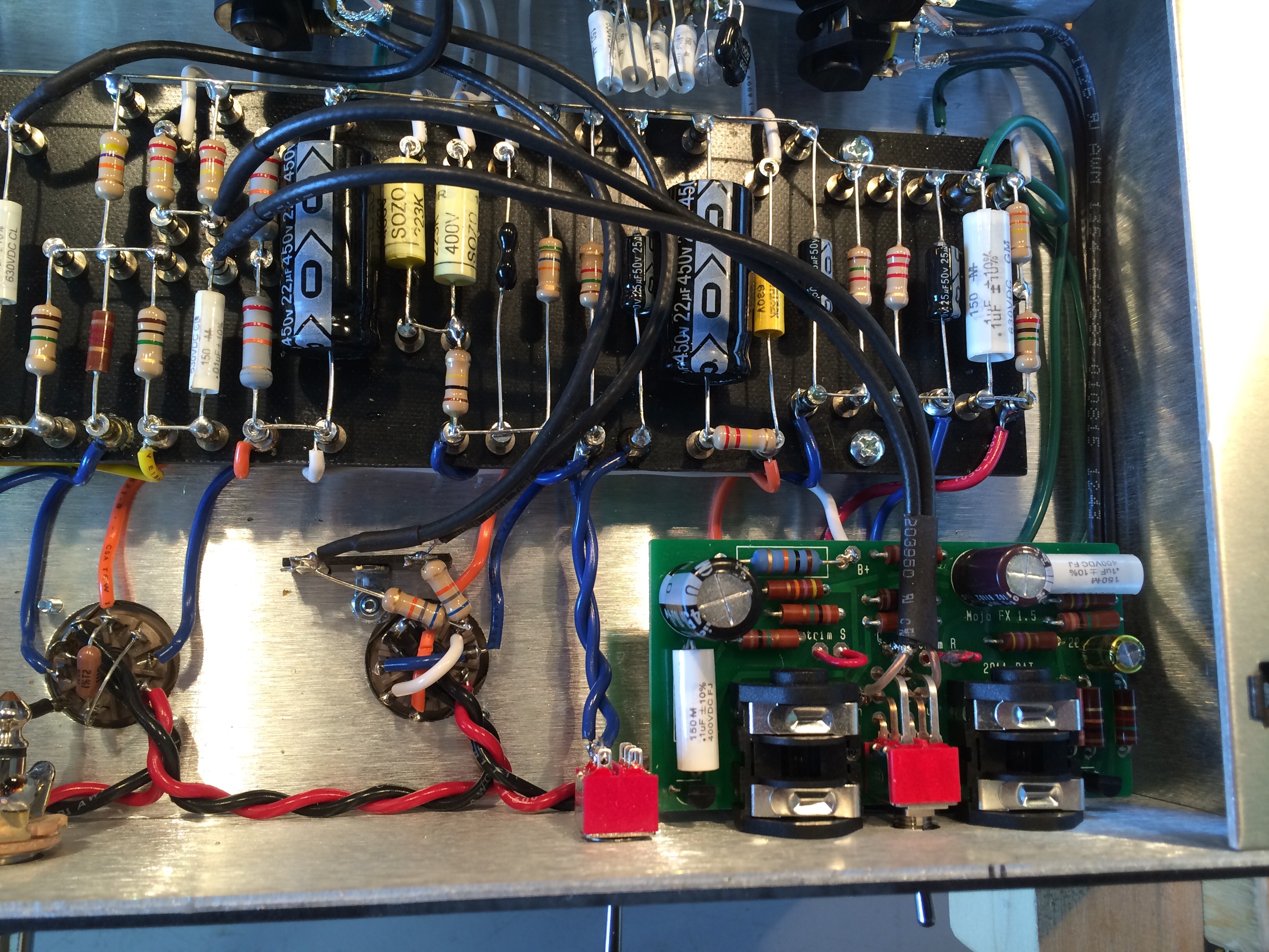

Here is a picture of a TC15 with a Mojo effect loop installed.
It comes on channel 2 just after the 220K divider.
Power comes via same pream filter stage as the PI via the white wire from the 22uf filter cap.
Green ground to preamp ground.
Shielded cables used and were grounded on PCB board
Split the connection and run the Send and Return coax between the 220K and coupling cap as per picture.
We found the Mojo loop, which uses carbon comp resistors, to be noisy but otherwise it worked very well. Let is know how your works out. The Ironspunds installation looks more complicated than the Mojo.

Thanks Stephen! Your picture definitely helps! I see exactly where I need to insert the audio send and return.
Since the power section PCB is separated from the audio signal PCB (per Ironsounds recommendation), I might get my B+ from the 2nd 22uf power cap and ground to the 3 point power ground. But then again grounding might be best at the preamp because of the send/return coax wire ground will ultimately ground with the power section of the PCB. :hmmm:
I'll do a bit more reading up, which, is all part of the fun!
