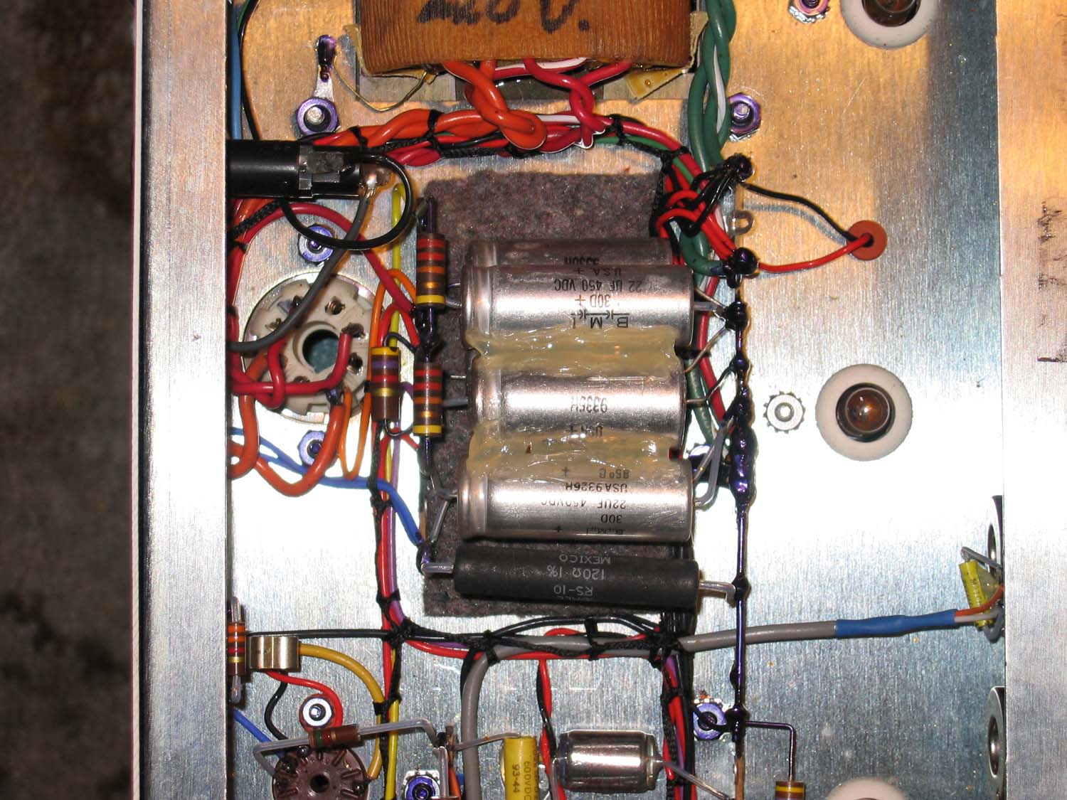

I decided to revisit my Lightning build and was looking on the net and found this gut shot. It clearly shows the 4.7K resistor feeding the CF stage. It also looks like 5 filter caps with the 250uf cathode cap buried in there somewhere. So it looks like Nik is replicating this version. One thing I did to mine that really brought the tone together was add a shared 1K 5W feeding the 100R screen resistors, this got the screen voltage under control a little better. So maybe I'll try the 4.7K value again and see how it sounds.
