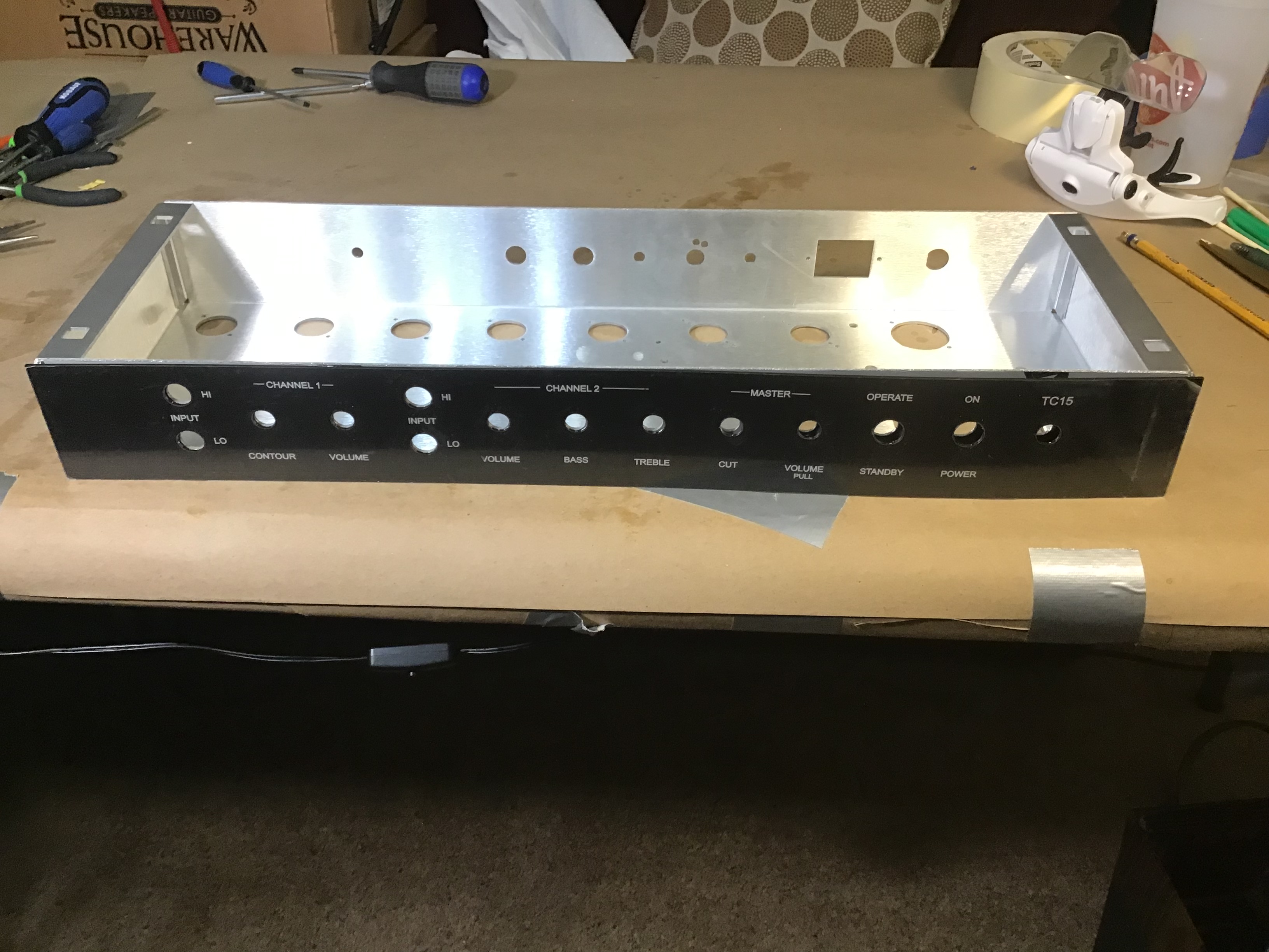

Just got my TC15 kit and the chassis and faceplate orientation is different than the TC pictured on page 18 of the builders guide. The picture shows the tubes and transformers facing down and my chassis and faceplate show the tubes and transformers on top. Are there different chassis es for a head and a combo? What am I missing?

I think I have the chassis made for the combo because the chassis I have won't work on the head cabinets I am seeing for the TC15. I don't really mind because I want it in a combo set up anyway, just wondering.

The back (bottom) of the amp should face the back of the cabinet and be covered by a panel (panel will probably have holes or mesh in it for ventilation). Tip the amp on back edge and I think you'll see how it works.

In my opinion, you have the correct TC15 chassis orientation. The tubes and transformers can be located on the top or bottom of the chassis, depending on whether you have a combo amp or an amp head. wordle unlimited
