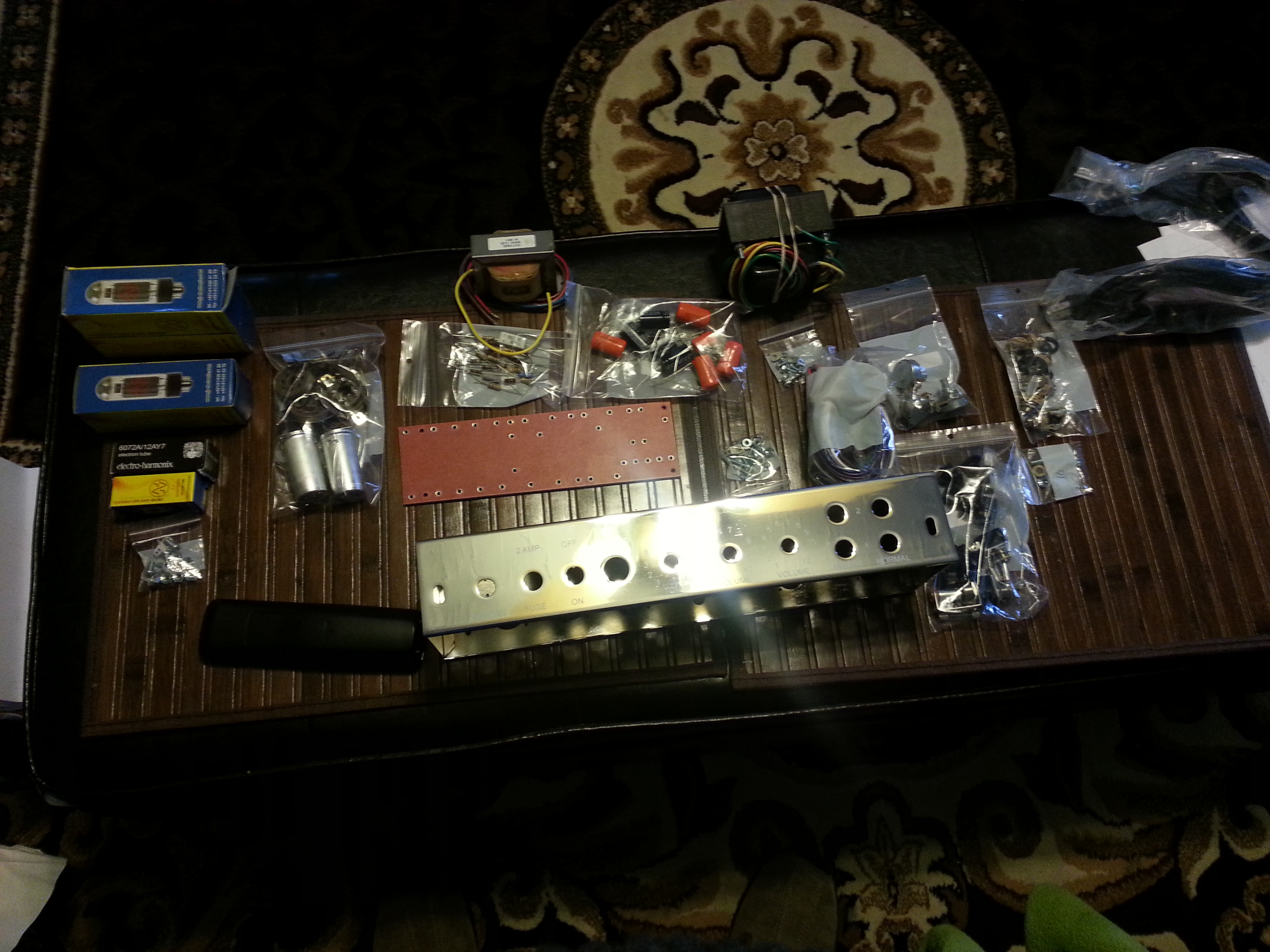

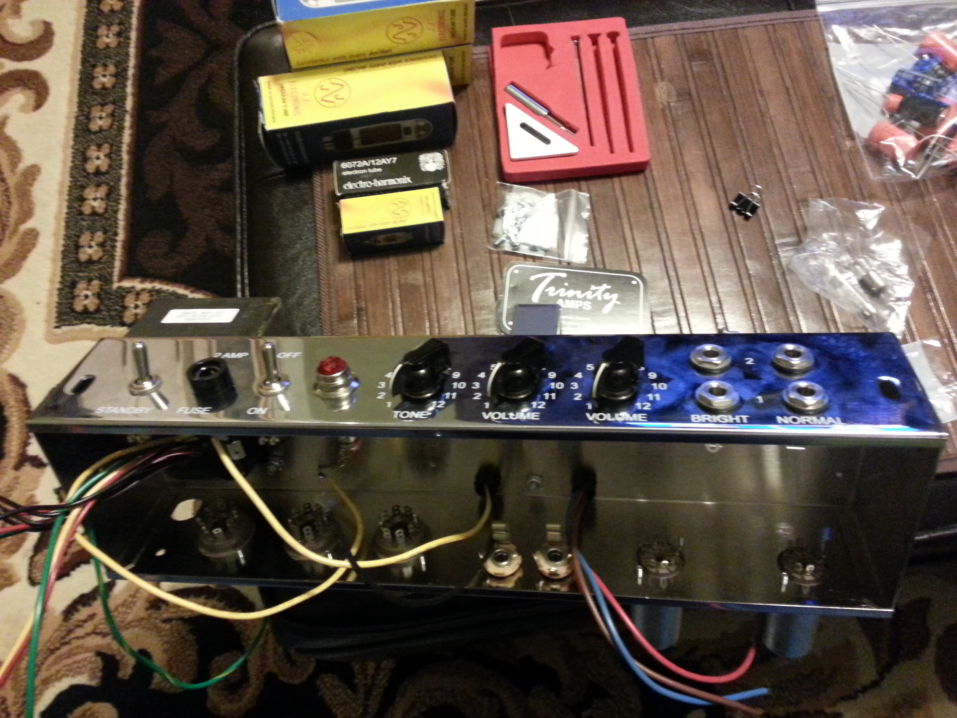

5E3 TRINITY TWEED AMP BUILD (oct/22/12)

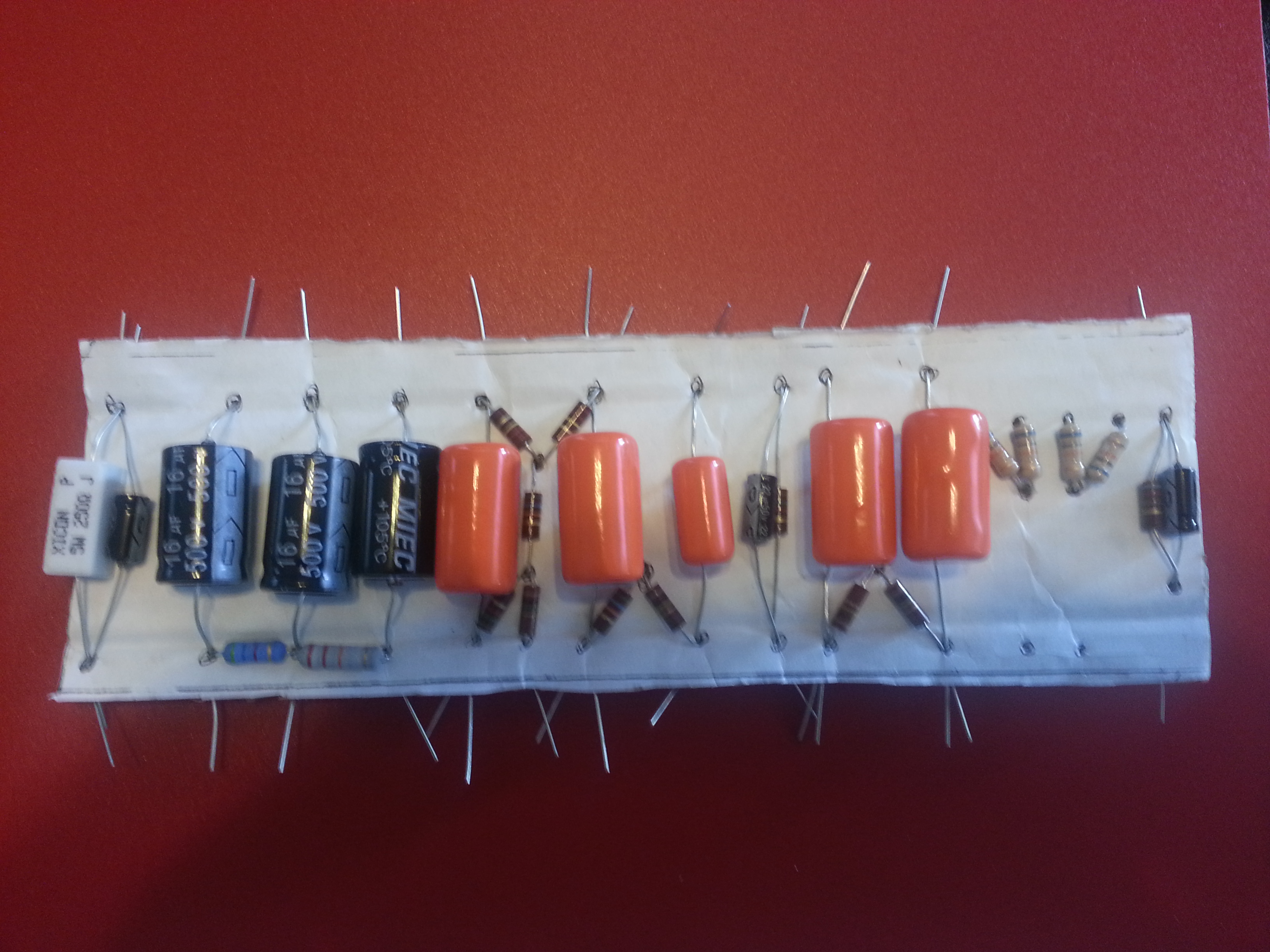

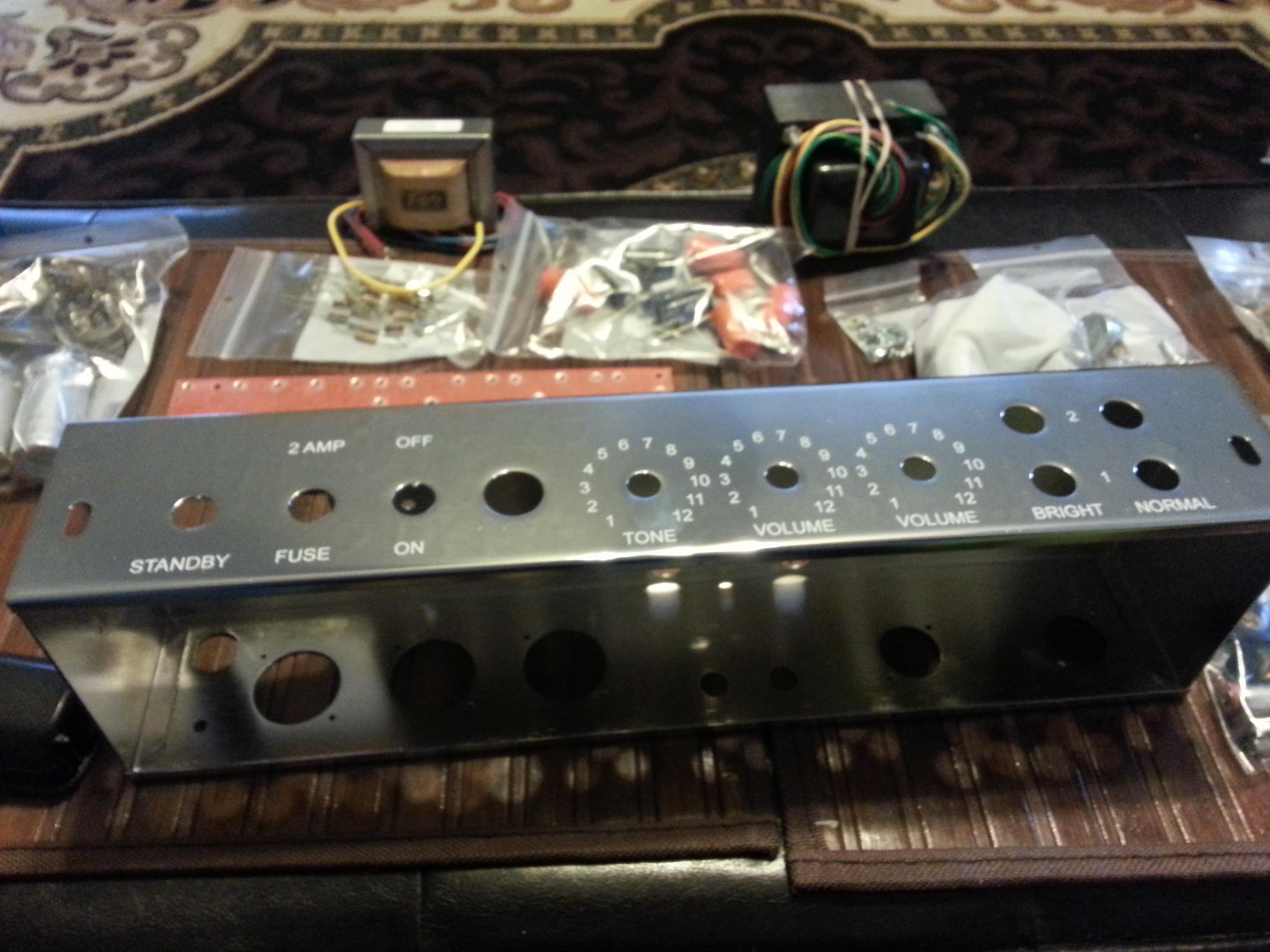

amp came to day checked all the parts
looks like every thing is here...read all night.

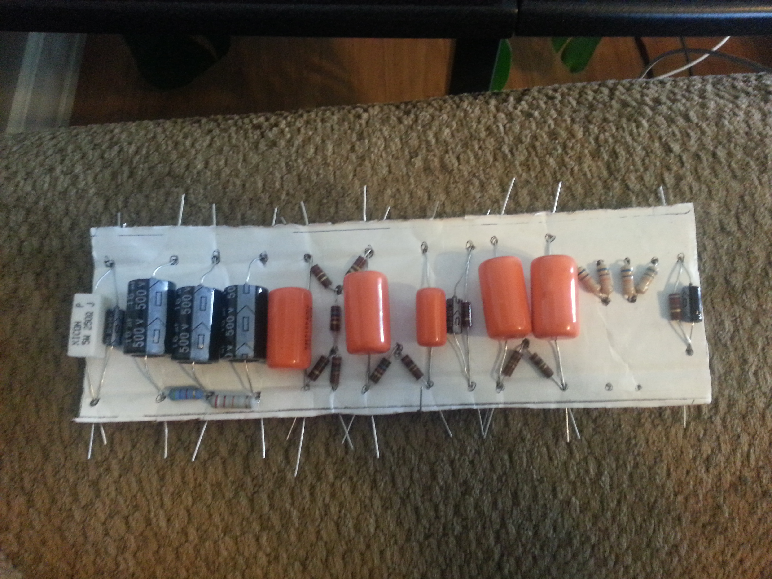

oct/23/12
read most of last night , started putting her together today.
one step at a time .

Finely got it rite :shock: I hope ;; it looks good

One of your filter caps is backwards!
PostPosted: Thu Oct 25, 2012 12:13 pm
Posts: 204
Location: Vancouver BC
Actually,there are 3 backwards,the small 25uf on the far left and the 3rd 16uf and the middle 25 uf, if I'm not mistaken.

thanks guys i have it now caps flow north south do the resisters have a inline flow
PostPosted: Sat Oct 27, 2012 9:49 am
Posts: 141
Your resistors are not polarity sensitive.
PostPosted: Sat Oct 27, 2012 12:03 pm
Caps look good now. The rest are'nt polarized. Practive your soldering and get a good hot, shiny solder joint. Very important. 25W iron, .032" flux core solder.

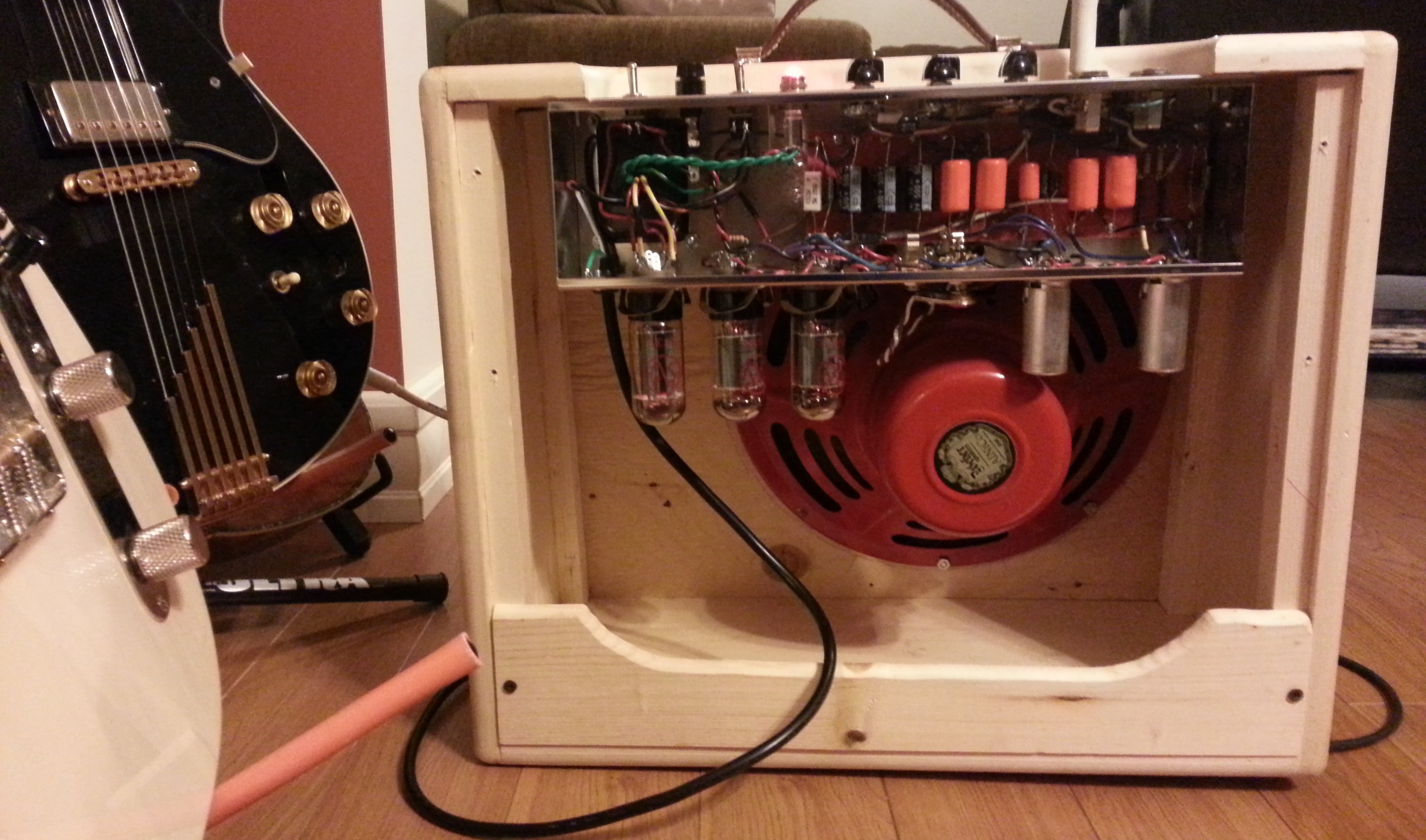

heres where im at today picked up my tools yesterday 15 hr of work and !!!
PostPosted: Tue Oct 30, 2012 7:41 pm
Looks good. And a healthy snack to boot!!
Keep it neat and it will be fine! Short wires!

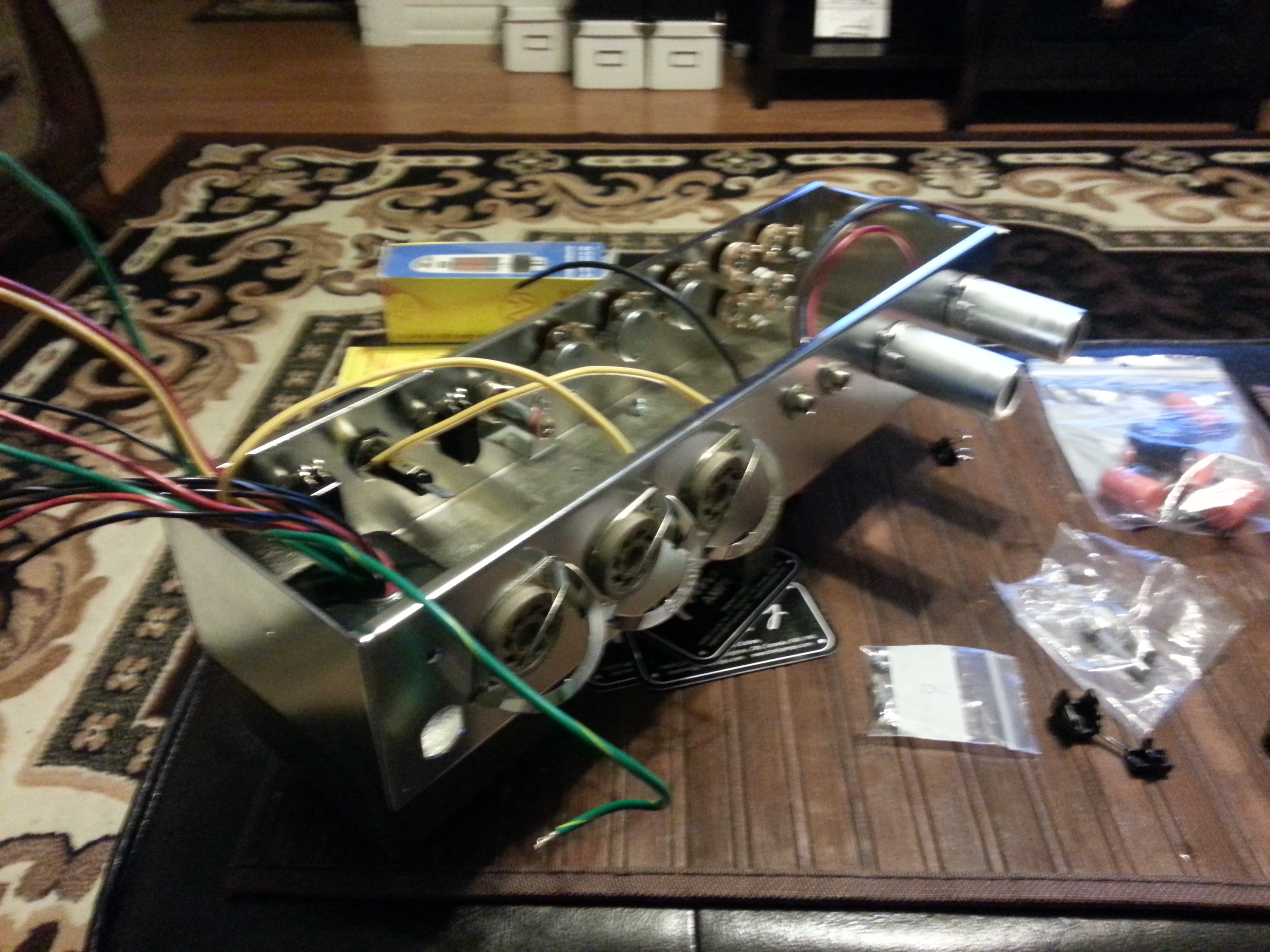

well i dont know ... im going to chase the wiring down at least 2 more time just to make sure im
tired and more tired ;;;
good night

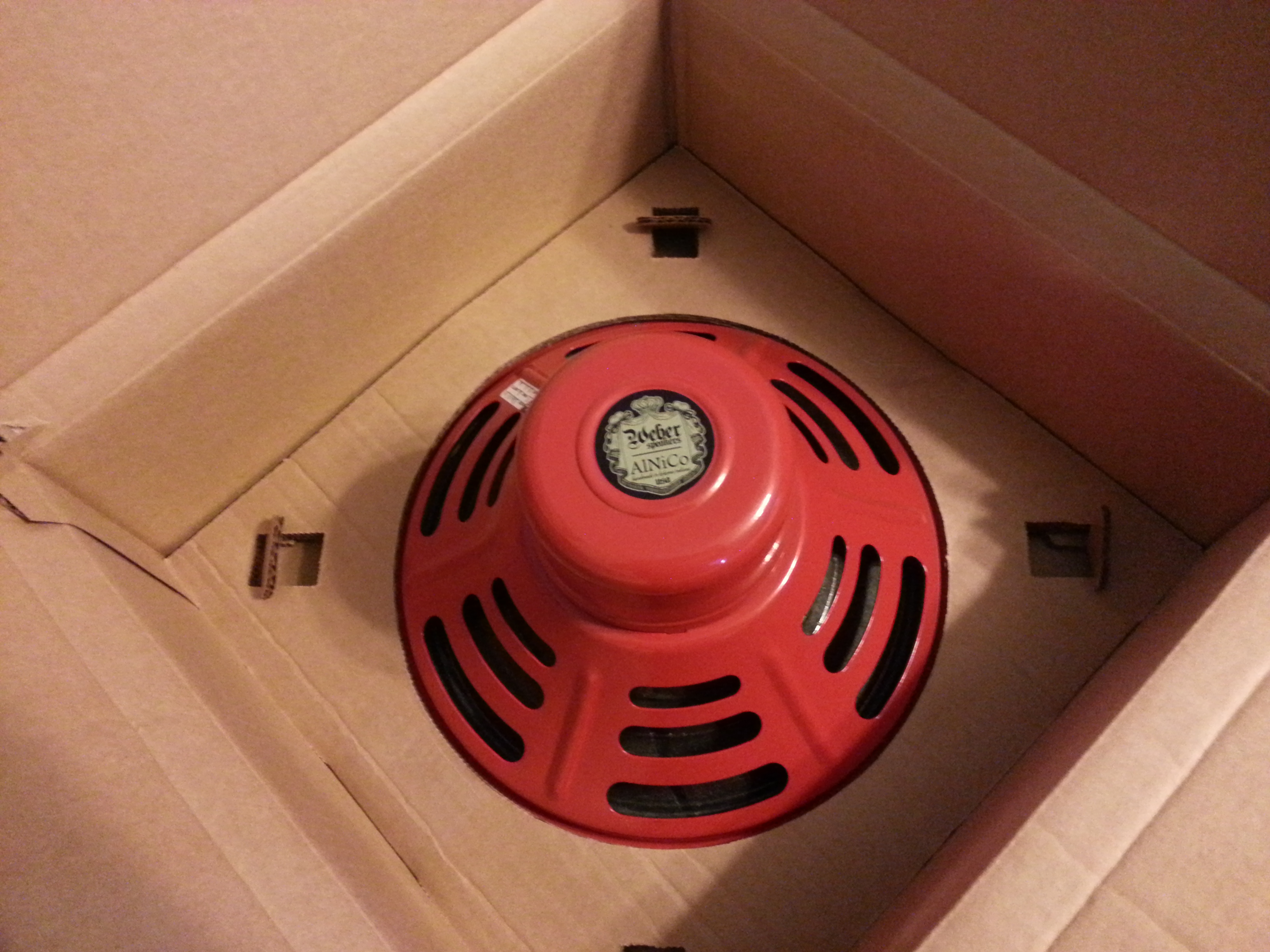

PostPosted: Mon Nov 12, 2012 10:28 pm
Joined: Thu Aug 23, 2012 12:20 pm
Posts: 12
well the speaker UPSed in today. Holy cow its beautiful its a 12A125.A alnico ,, WOW !!!!
i have to finish the cab, have all the hardware ,tweed ,and grill cloth ,,,
have had the amp tested ;; a few small errors but shes fine and quite ! he told the wires were
to short to ;; he showed me some of his amps and how to do it right ;; hes a service rep for a kit
company , ran into him at a guitar shop where i live showing the guys that work there his latest,
a jtm 45 head . my new best friend !!!

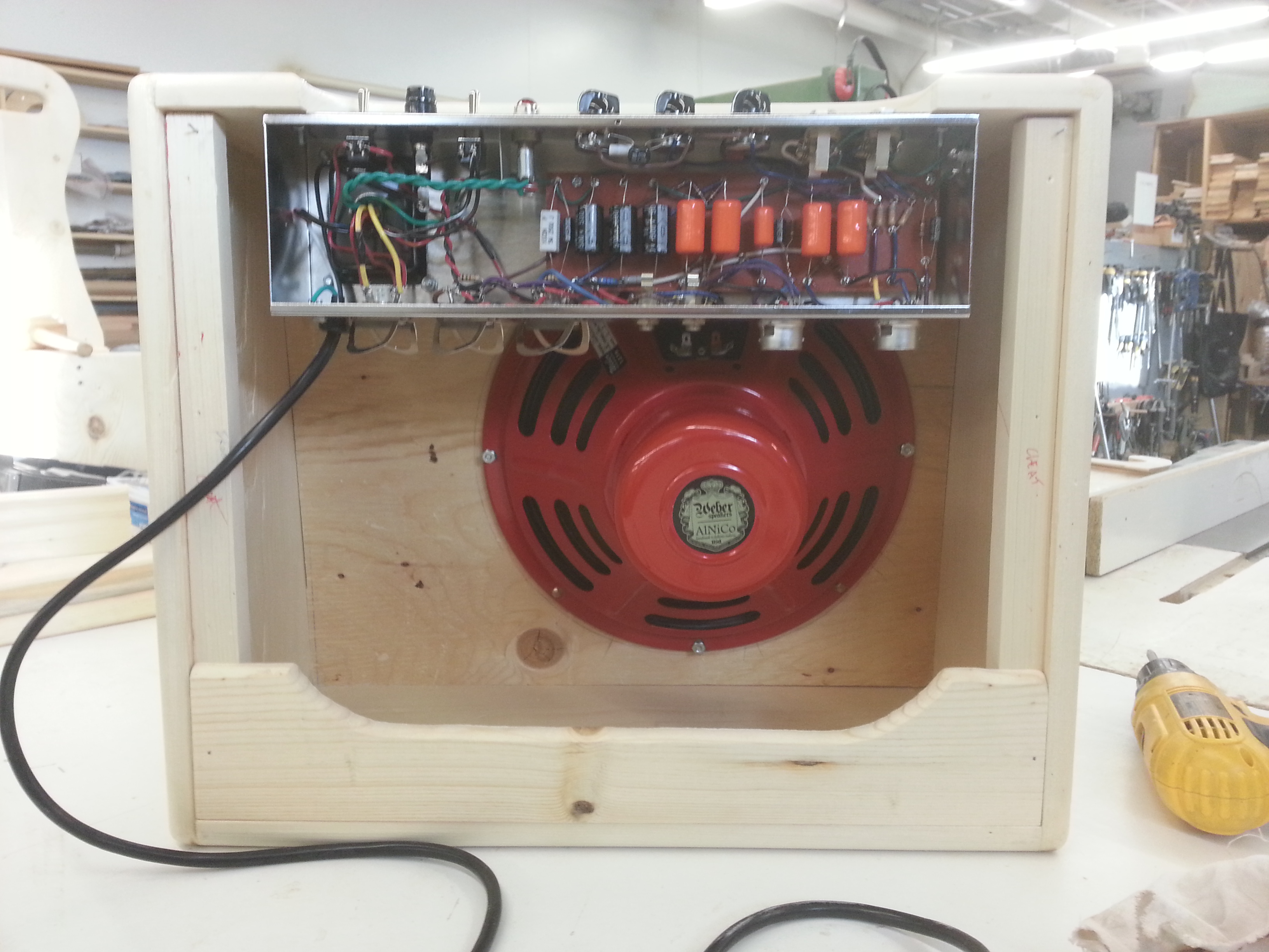

PostPosted: Fri Dec 14, 2012 1:08 am
Posts: 12

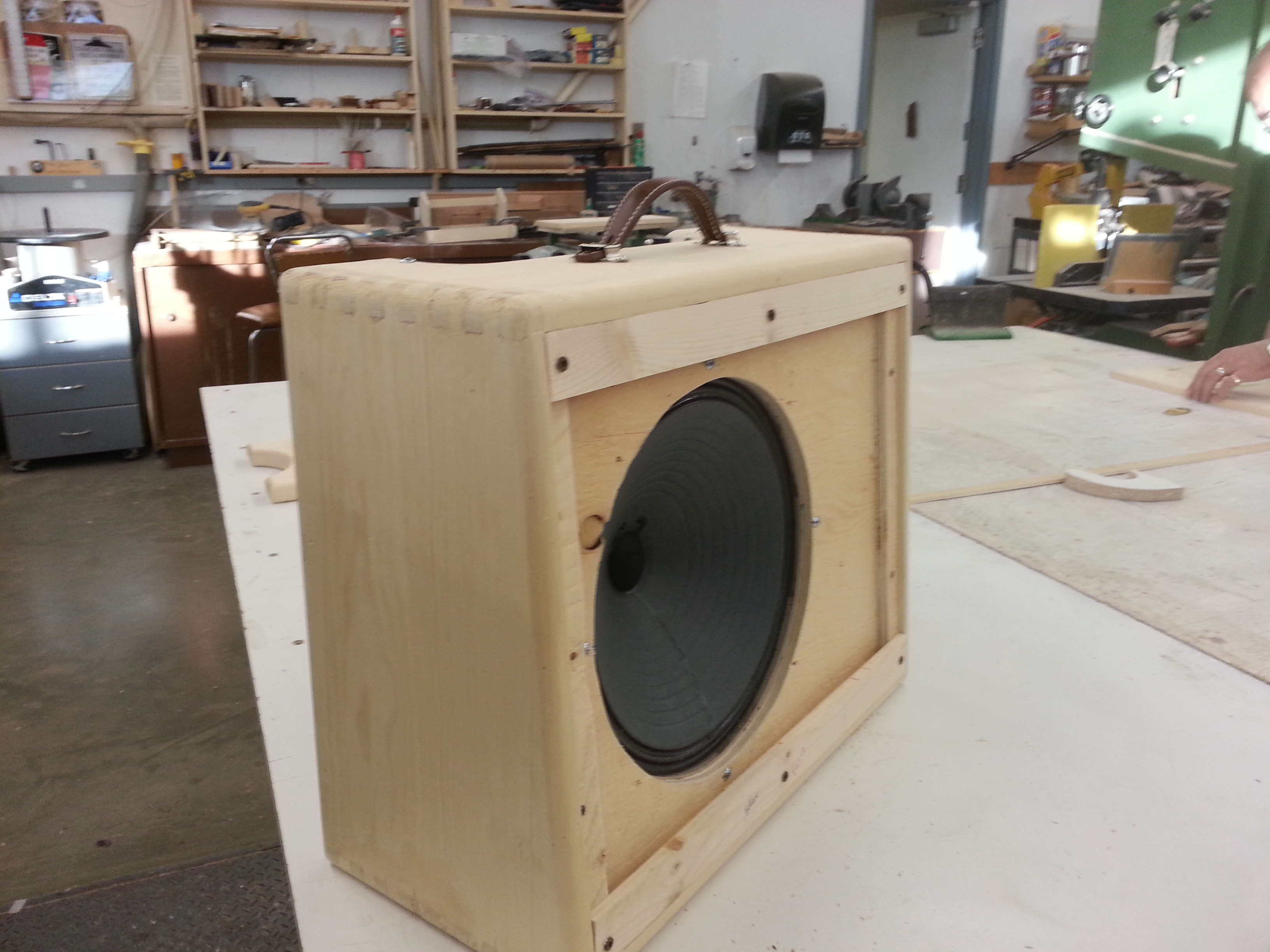

ive been away but have made some progress
PostPosted: Fri Dec 14, 2012 1:15 am
Posts: 12

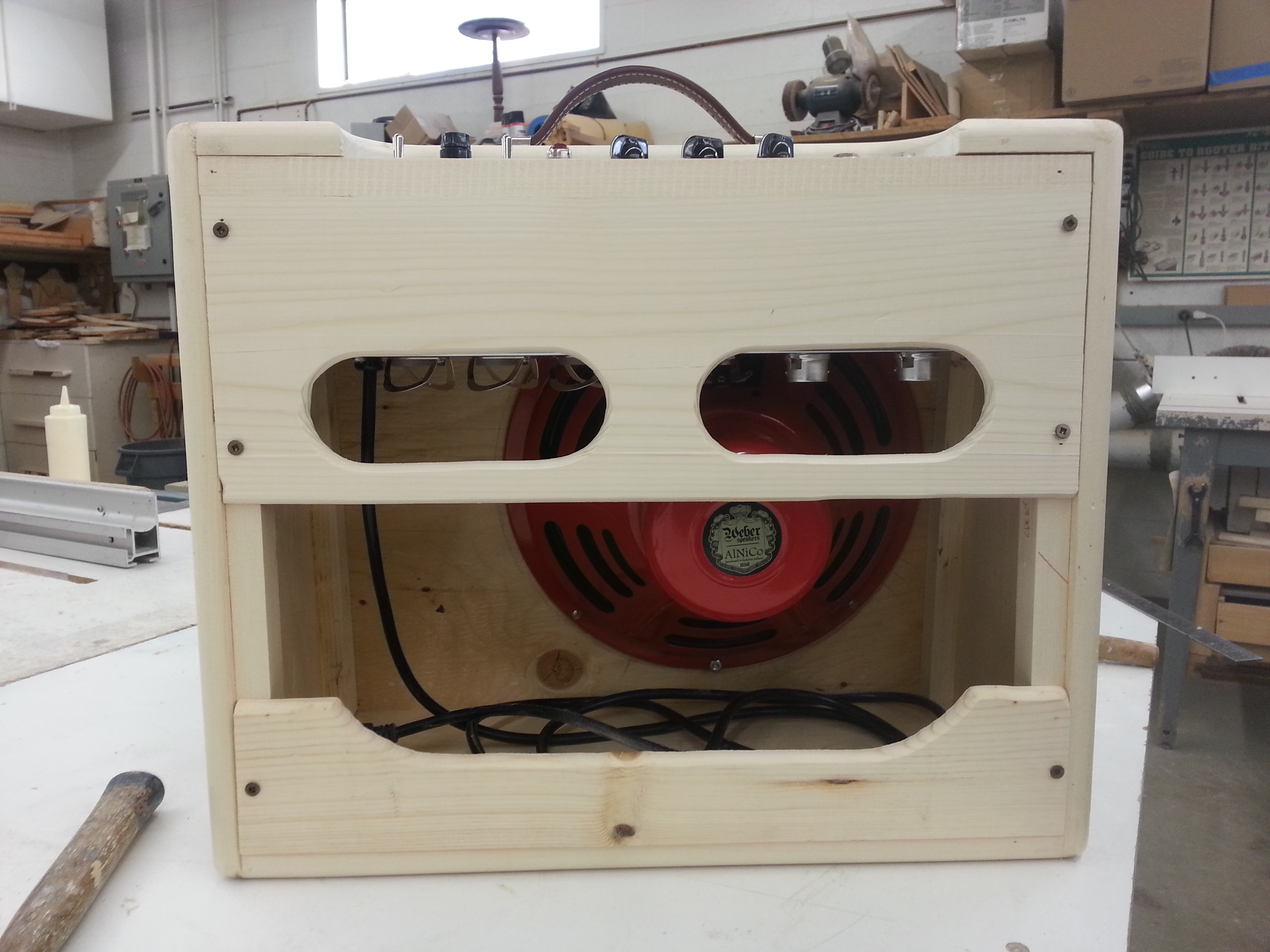

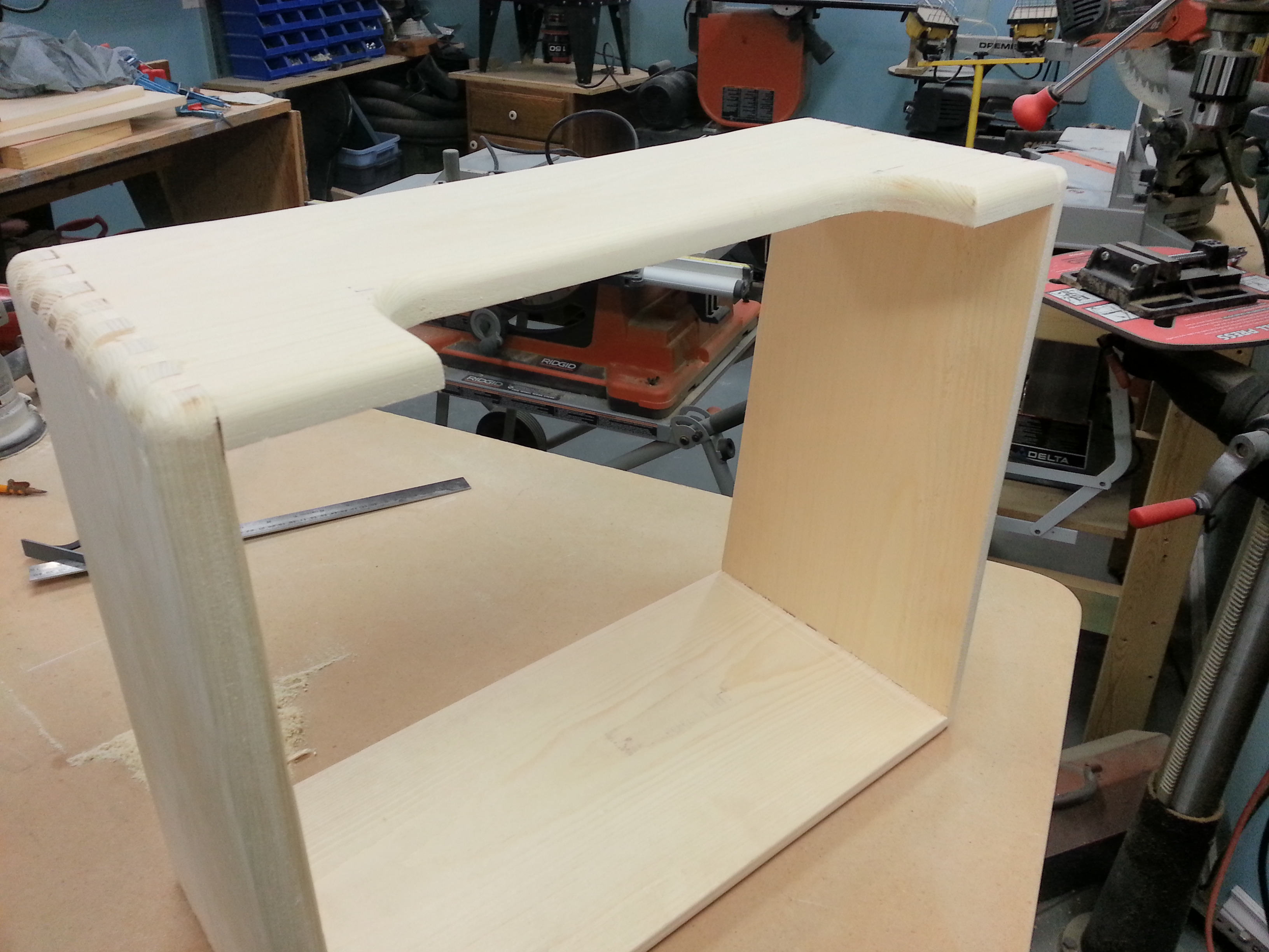

Some more pics I am going to make another cab made lots of mistakes its just time and 20 bucks for a pine board .. dose not look bad in pics but it is bad !!

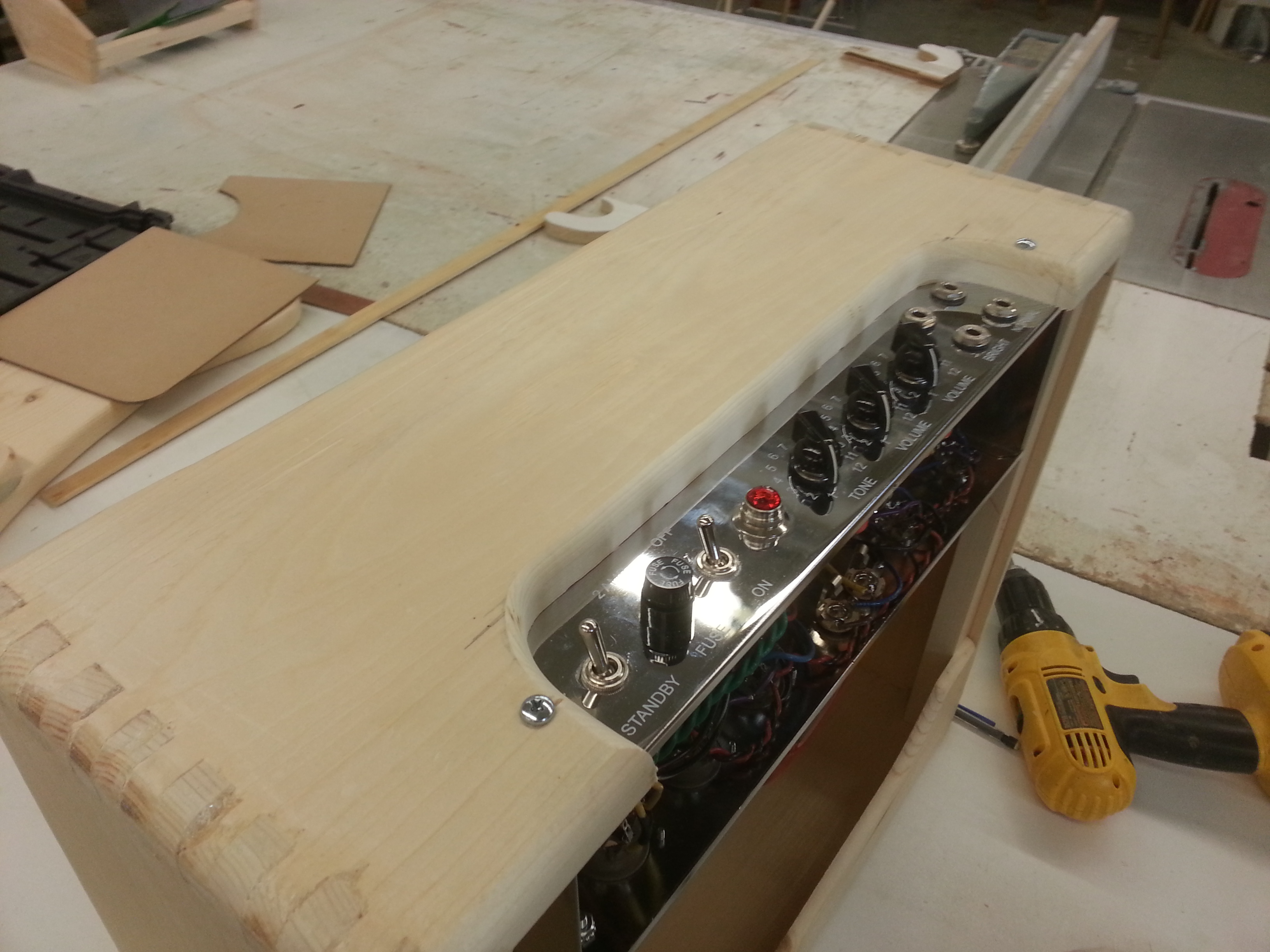

File comment: ts alive !!!!!!!!!!and dose not have a loud harsh hummm !! its has a great chime to it, just a hint of bravado and great volume driven overdrive vhen you dig in

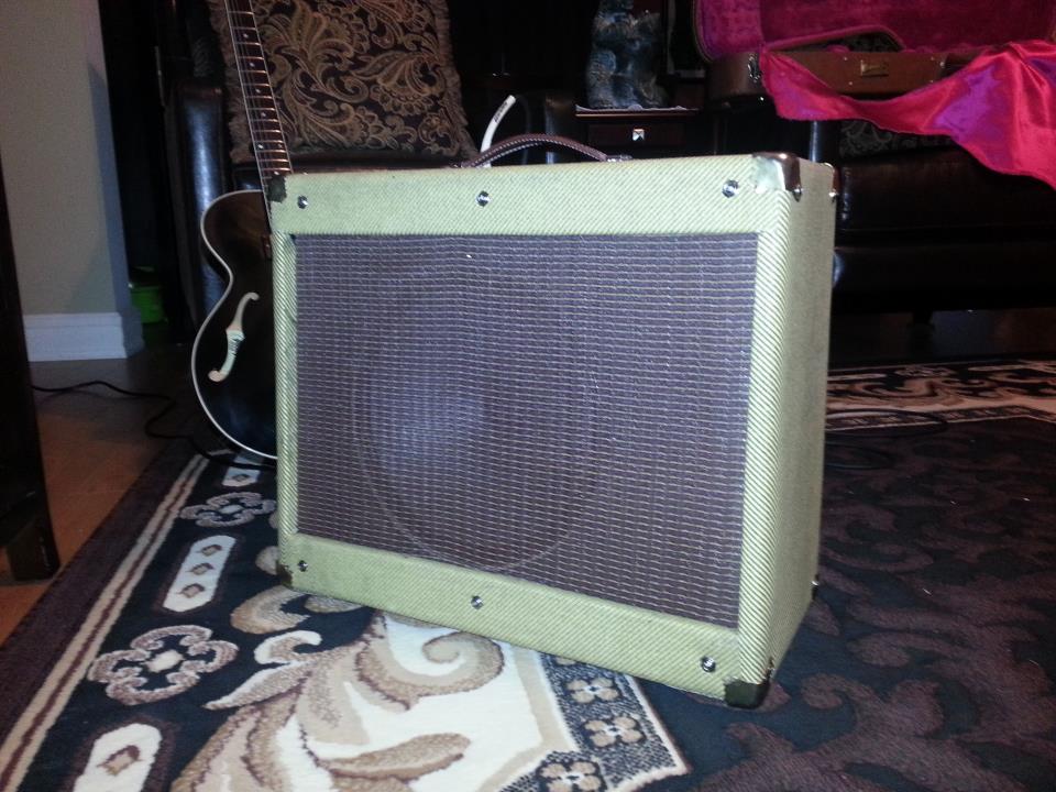

PostPosted: Wed Jan 30, 2013 2:18 am
Posts: 12

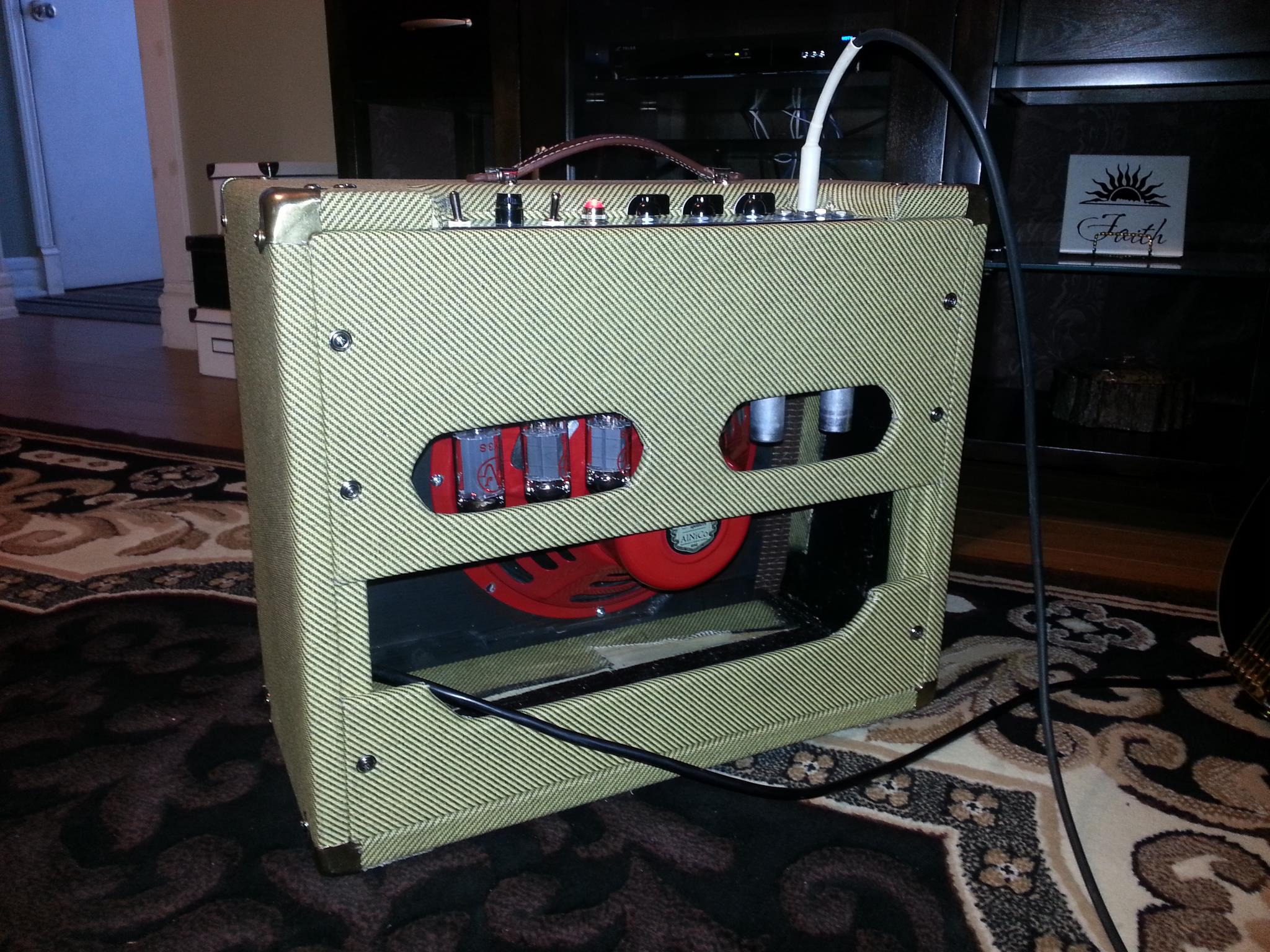

i got the tweed done to day .. i will never build my own cabinet again .. next time i will buy one !!!
the good thing is that it looks more like a 50 year old closet find..witch is kinda cool
PostPosted: Wed Jan 30, 2013 3:36 am
Posts: 40
That looks pretty good! Well done! My cab should be done this week too, then I can take my tweed for walkies :D
PostPosted: Wed Jan 30, 2013 2:29 pm
Tweeding takes about twice as long to do as Tolex. And people wonder why it should cost more!
There is a pretty good tutorial on this forum on doing it on a tweed style cabinet
http://www.trinityamps.com/phpbb/viewtopic.php?f=11&t=2938
