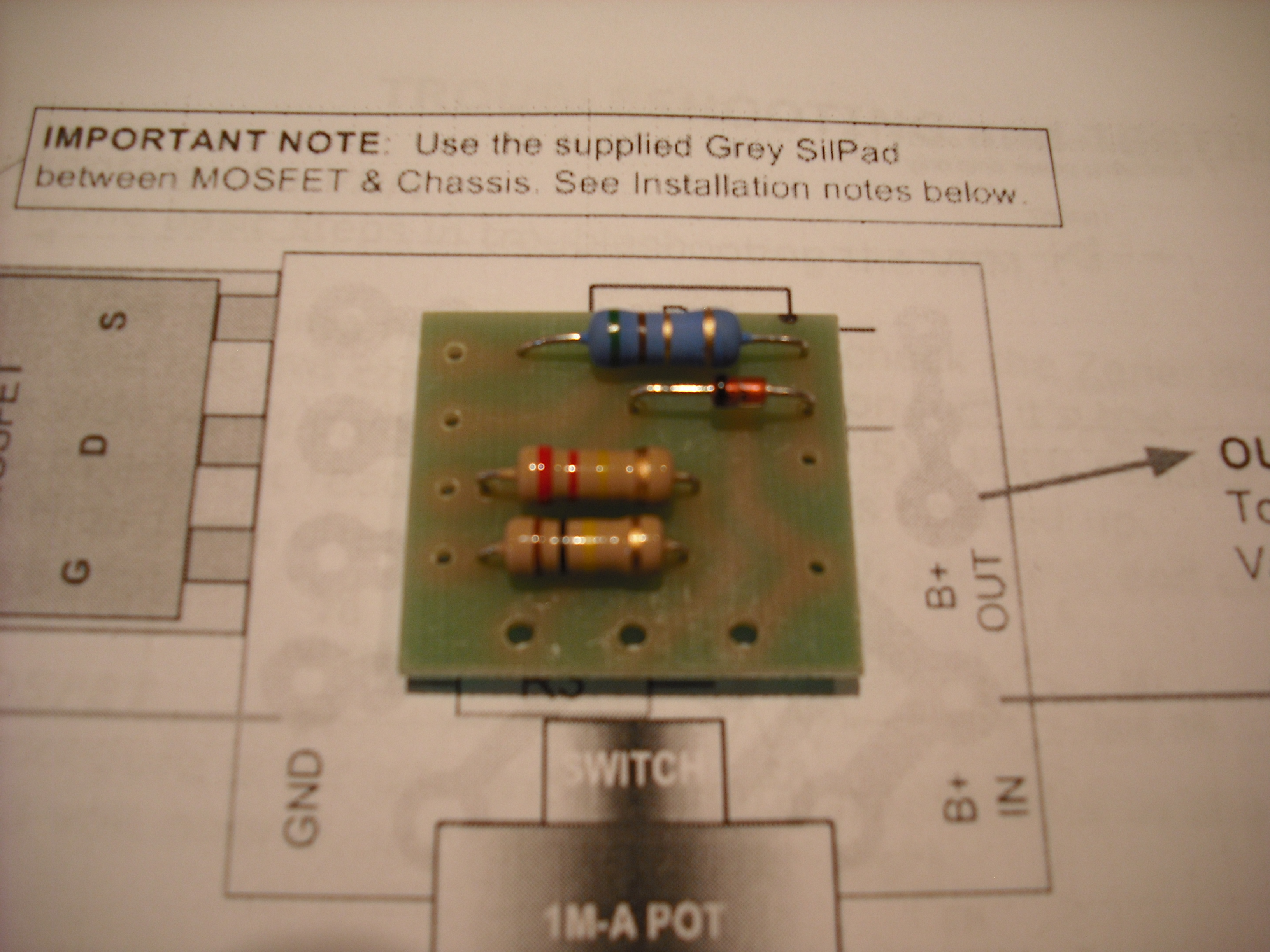

Solder up the VRM :

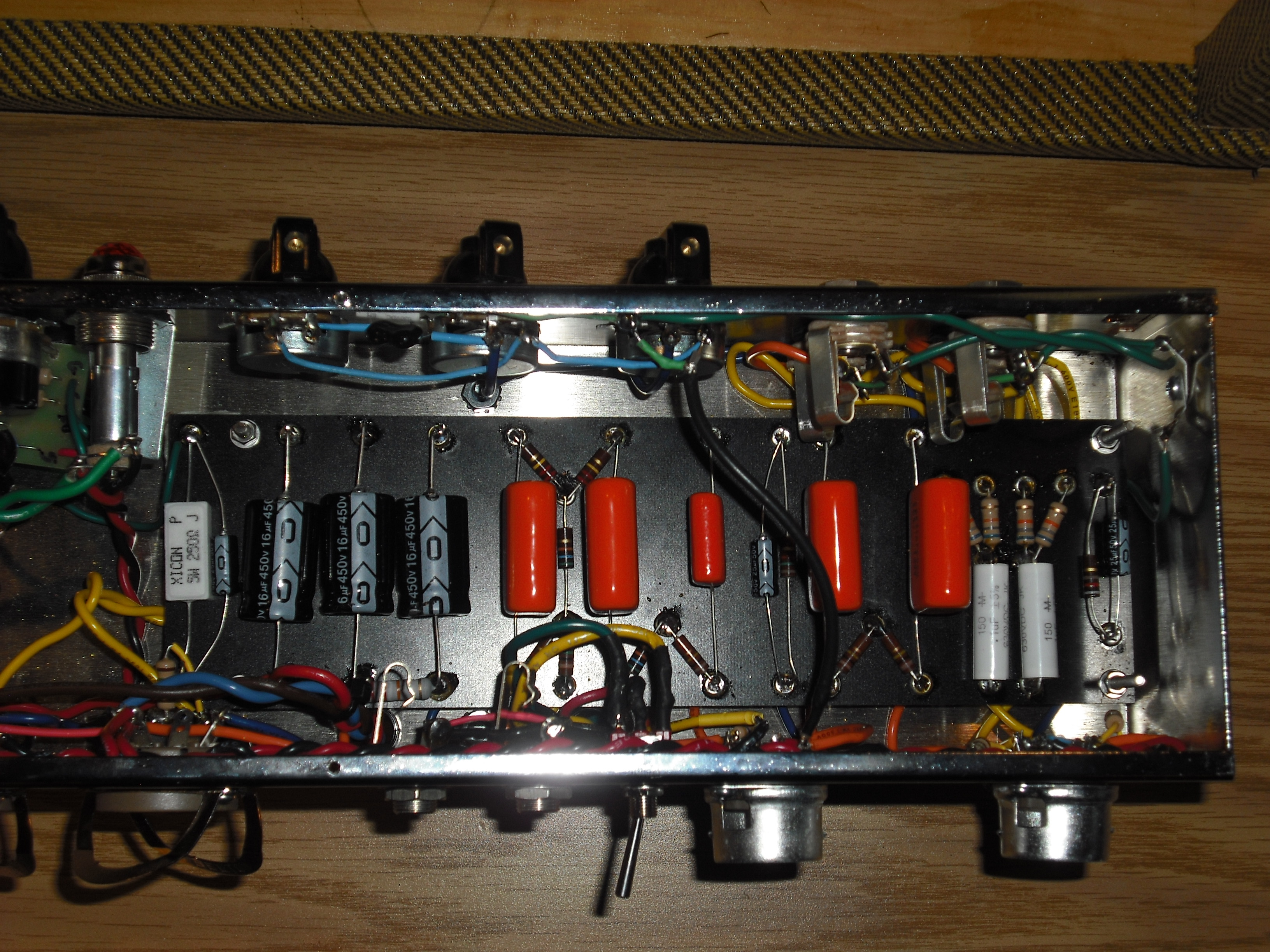

Build up the Board and Fly Wires :

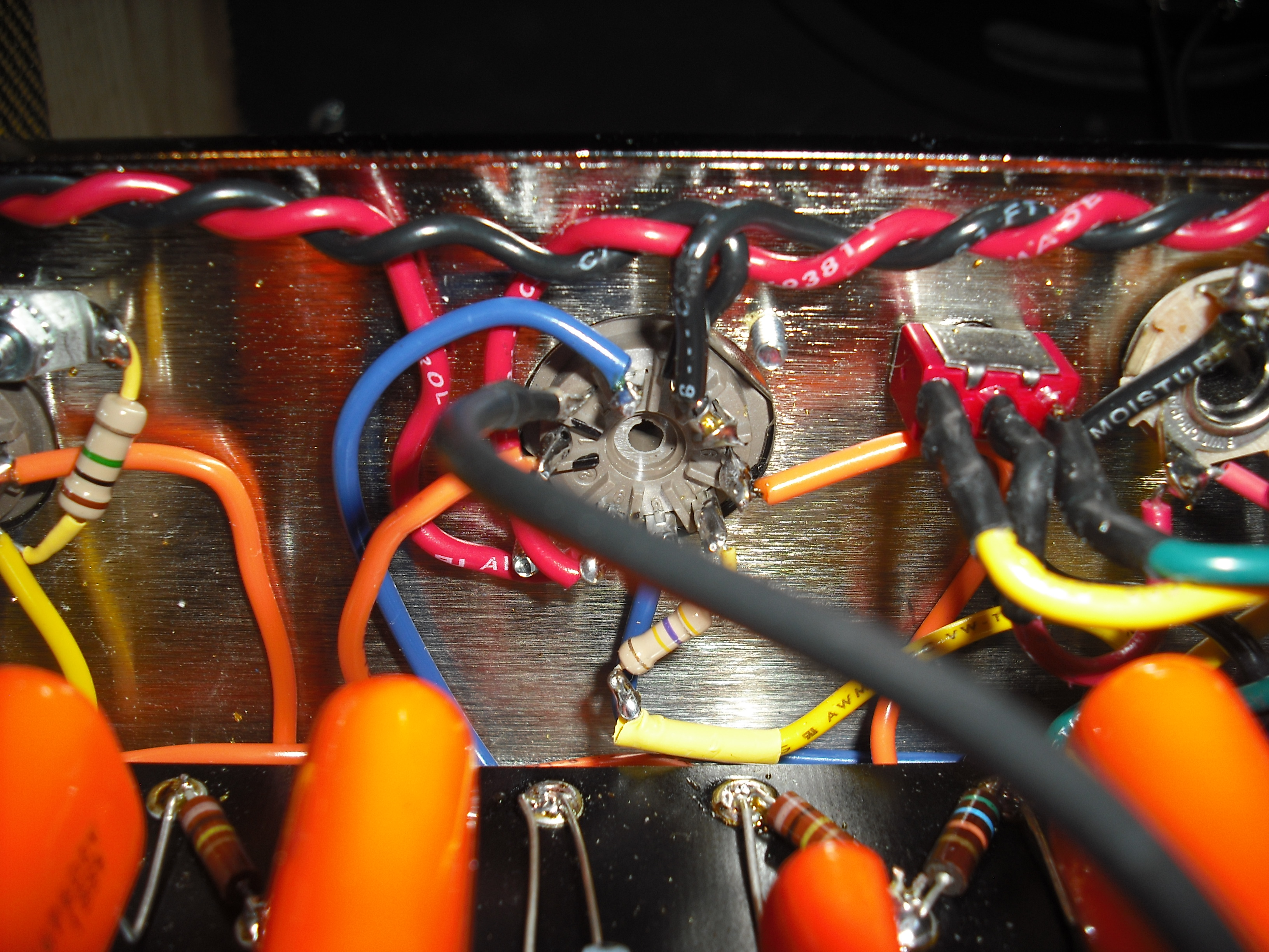

V1 :

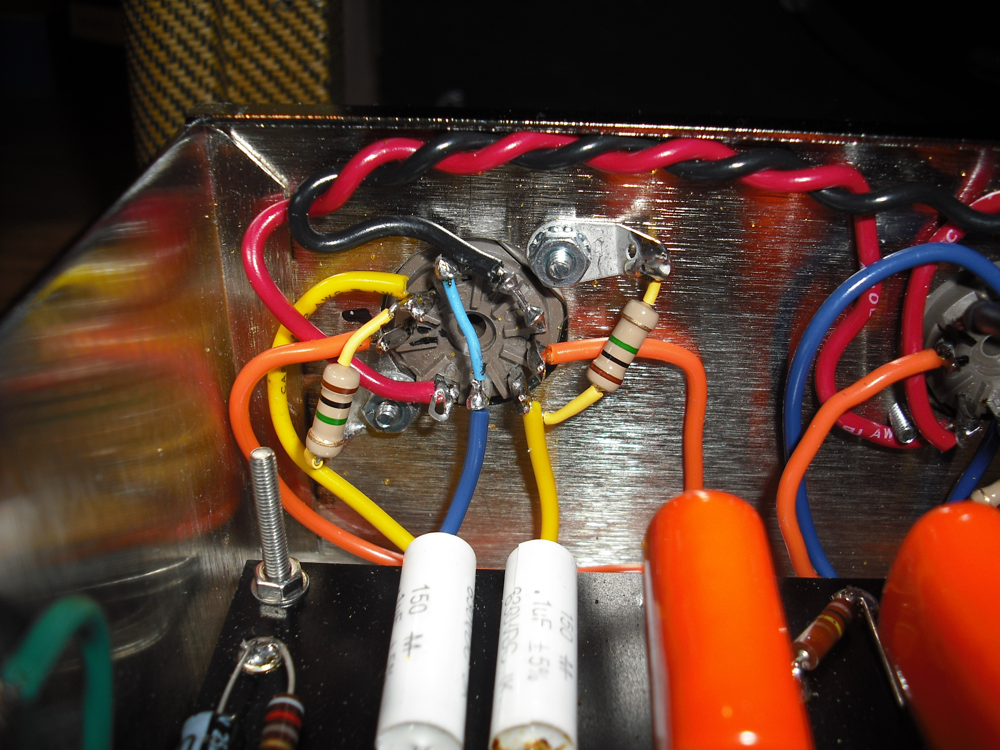

V2 :

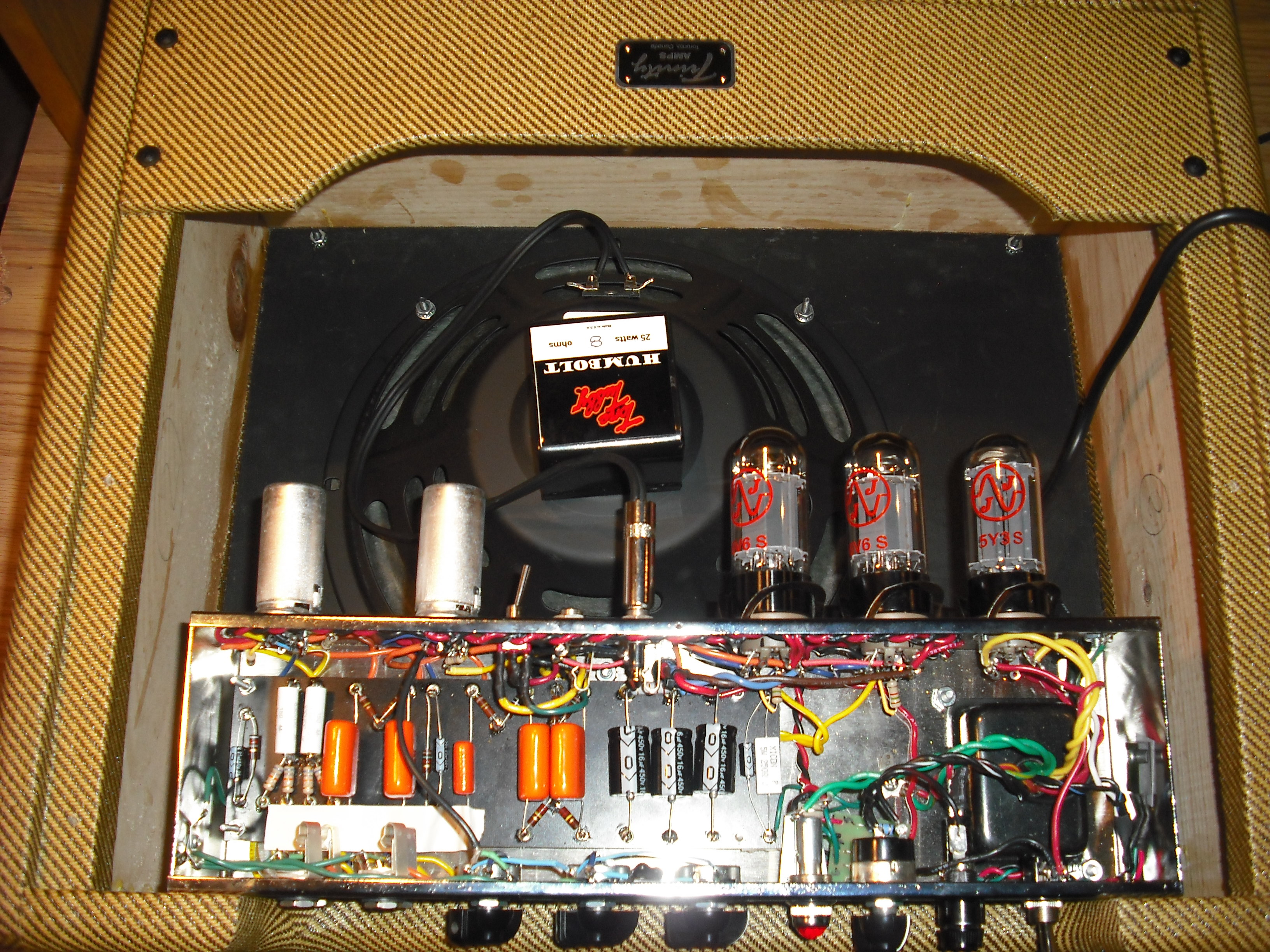

V5 : (NOTE - i and the red wire on the wrong pin and found out during my final inspection before power up - i am not sure if this would have caused any issues or not...

Install in cabinet :

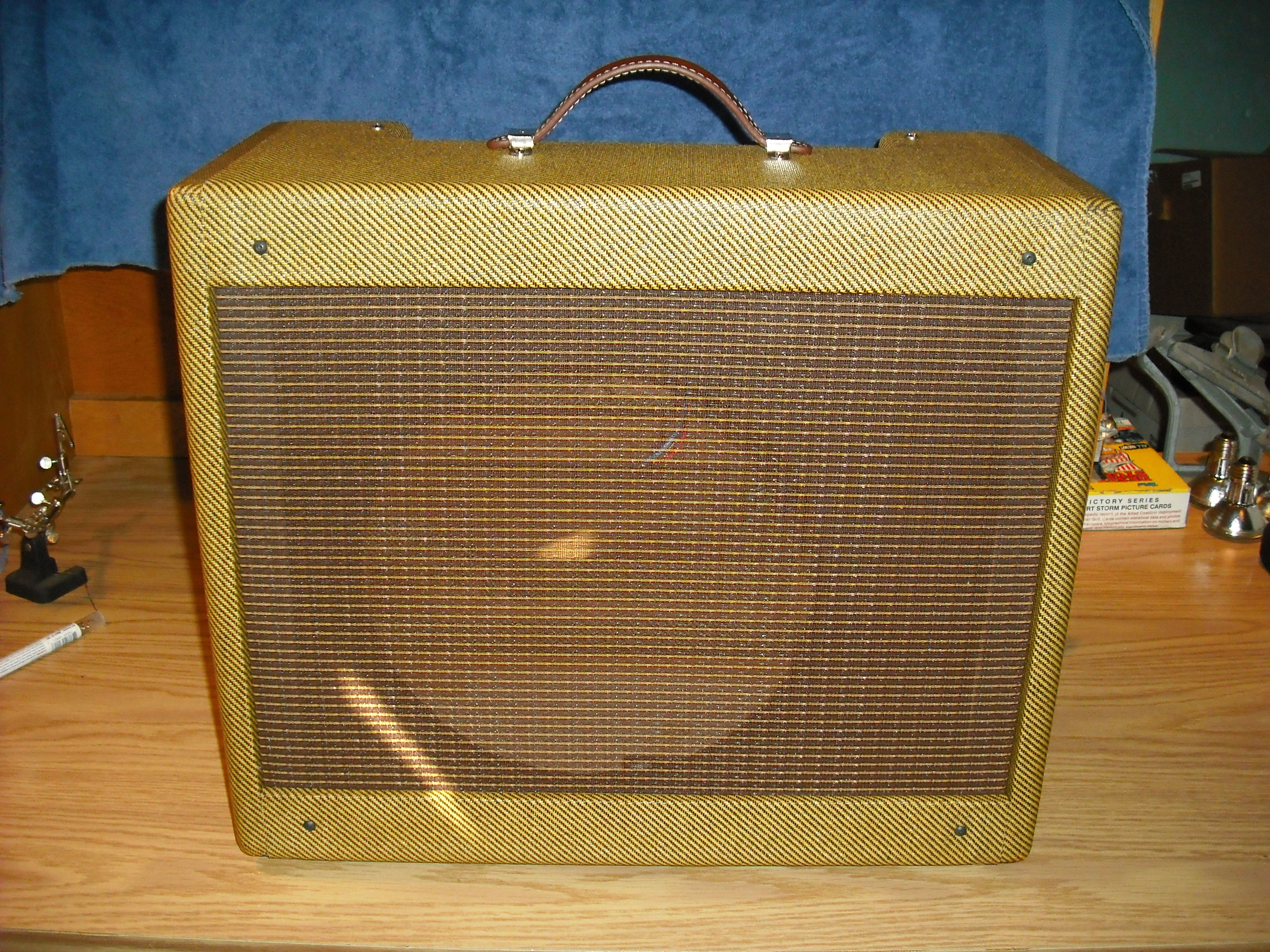

Final Pictures :

Nicely built. Looks great . How about that Tone Tubby Low Watt speaker, impressions?
 Post subject: Re: Tweed With VRM
PostPosted: Thu May 15, 2014 10:44 pm
Posts: 49
I am very impressed with the speaker and Connie is really happy with the VRM...
