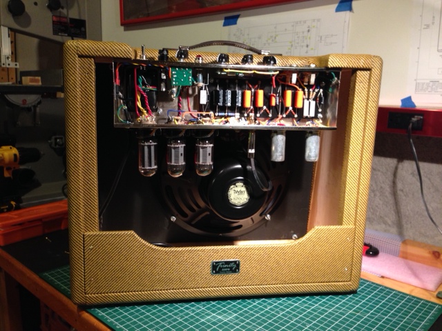

Building a 5e3 Tweed amp has been on my to do list for years. Thought about attending the Tramp building workshop Stephen hosted a couple of years ago but I couldn't make it happen. Recently I saw Trinity Amps featured on Kim Mitchell's "Guitar Picks" show on AUXTV; that pushed me over the edge and I placed an order. Living in the GTA made picking up my Trinity Tweed kit, Tweed cabinet and VRM kit from Stephen in Brighton, ON a relatively short drive. While I was waiting for my tweed cabinet to be built I read every Trinity Tweed related post on this forum.
I'm not an experienced amp builder. However I did assemble a David Hafler DH-101 preamp kit back in highschool; and maintained some soldering skills building Cigar Box guitars; and I know the difference between a resistor and a capacitor due to the Heathkit Junior Electronics Lab I got for Christmas when I was 11 years old. I took my time building this amp, methodically following the Trinity Builder's Guide, which was great. After completing the power up procedure in the builder's guide my amp fired up perfectly the first time. I'm totally thrilled with the end result. The amp sounds great and I have to put my head close to the speaker to hear any sort of hiss or hum.
I though I'd share my build pic's for future builders as I found the pic's posted by others on the forum so helpful (Thanks MitchM, ajmckay and Olivia)
Thanks Stephen for a great Tweed kit.

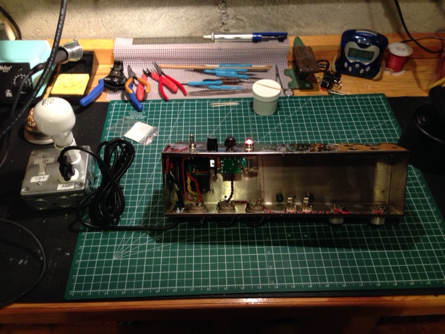

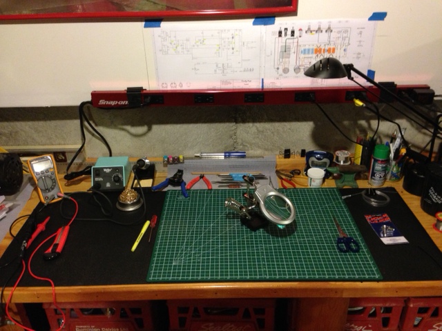

File comment: Setup my workbench for amp building. Bought a new soldering iron, the old one needed to be retired.

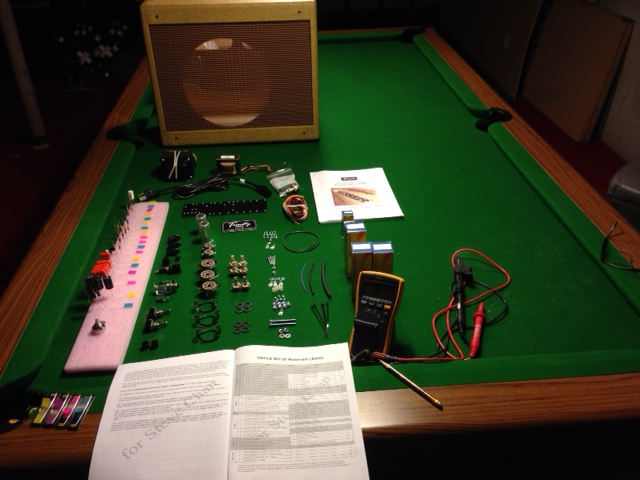

File comment: Did my BOM check. Was short a couple of pots which Stephen promptly shipped out to me.

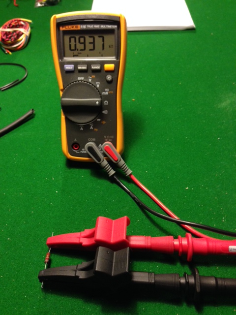

File comment: Measured and confirmed component values. One resistor was a bit off which Stephen replaced.

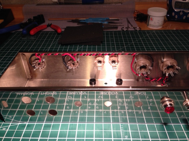

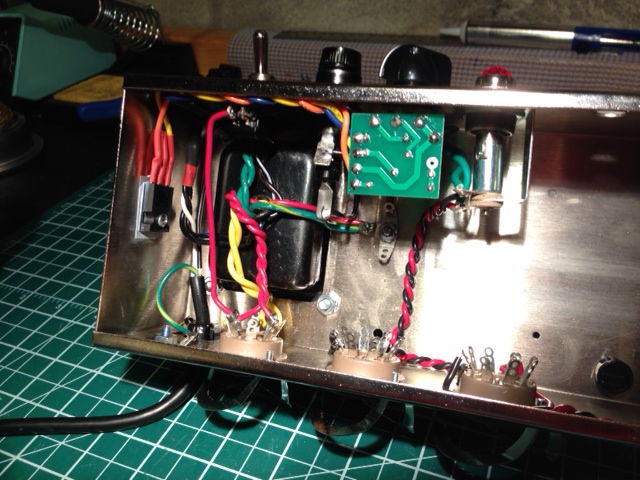

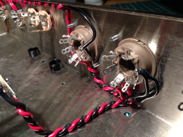

File comment: Intalled chassis hardware and wired the heaters under the chassis lip as neatly as possible.

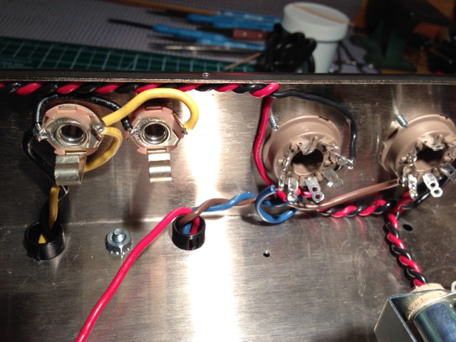

File comment: More heater wiring.

File comment: Checked that the power transformer was working properly using the dim bulb tester I built.

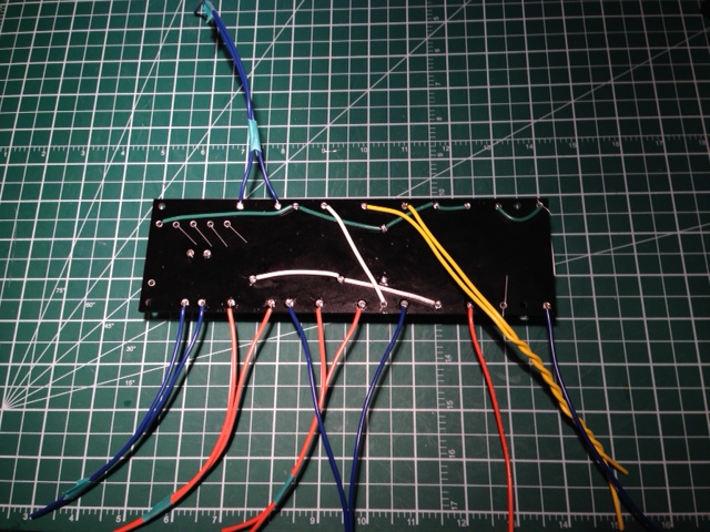

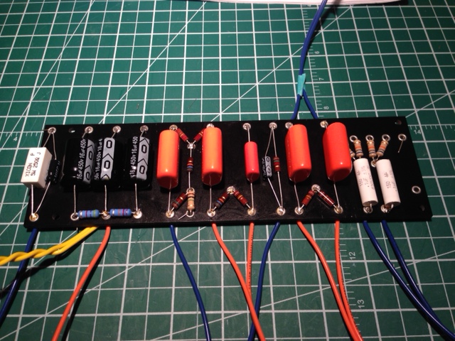

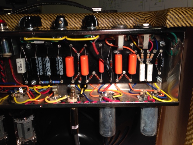

File comment: Wired the back of the eyelet board.

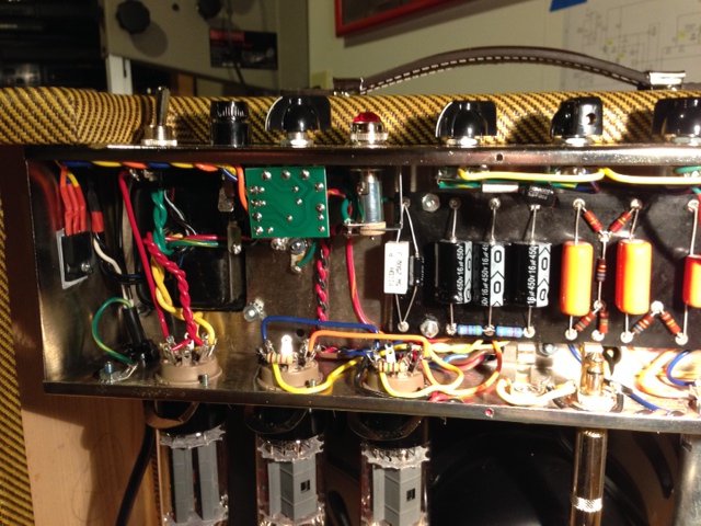

File comment: Install board components. Can you see my mistake where I installed a 1 meg film resistor instead of a 1 meg carbon resistor?

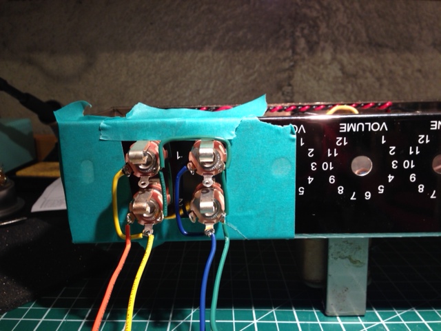

File comment: Wired the input jacks outside the chassis.
File comment: Completed amp installed into cabinet.

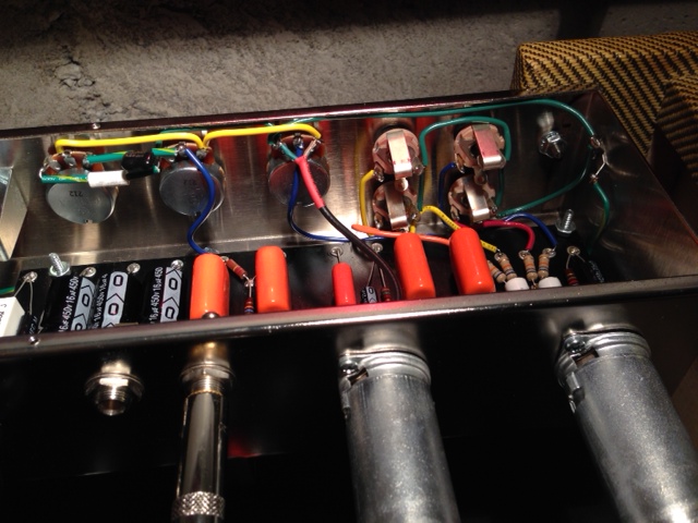

File comment: An amp guts shot.
File comment: Some more amp guts.
File comment: With a BBQ 12A125A speaker installed.
File comment: My Trinity Tweed in it's new home.

Awesome job...
Looks like you had a good time building it..
What was the thing that you found the most difficult?
And yes the 1M film really stands out...

For every hour I spent building I probably spent another 2 or 3 hours researching how other builders had done things and planning my approach. In my opinion the VRM/Mosfet wiring is the trickiest step. When I picked up my kit Stephen gave me gave some advice on soldering the power switch/pot to the VRM board. He suggested using component lead cutoffs as connecting pins to help solder the pot to the board, and that worked out really well.

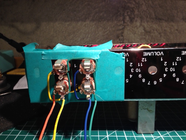

If I had a chance to do it over again I would solder the flying leads from the input jacks under the board instead of on top for a neater look.
Yes, in hindsight the 1m film resistor error stands out like a sore thumb! However when I was building it I just picked up the first 1m resistor I found and soldered it in. Thankfully the resistor leads were still long enough to install in the right location.
