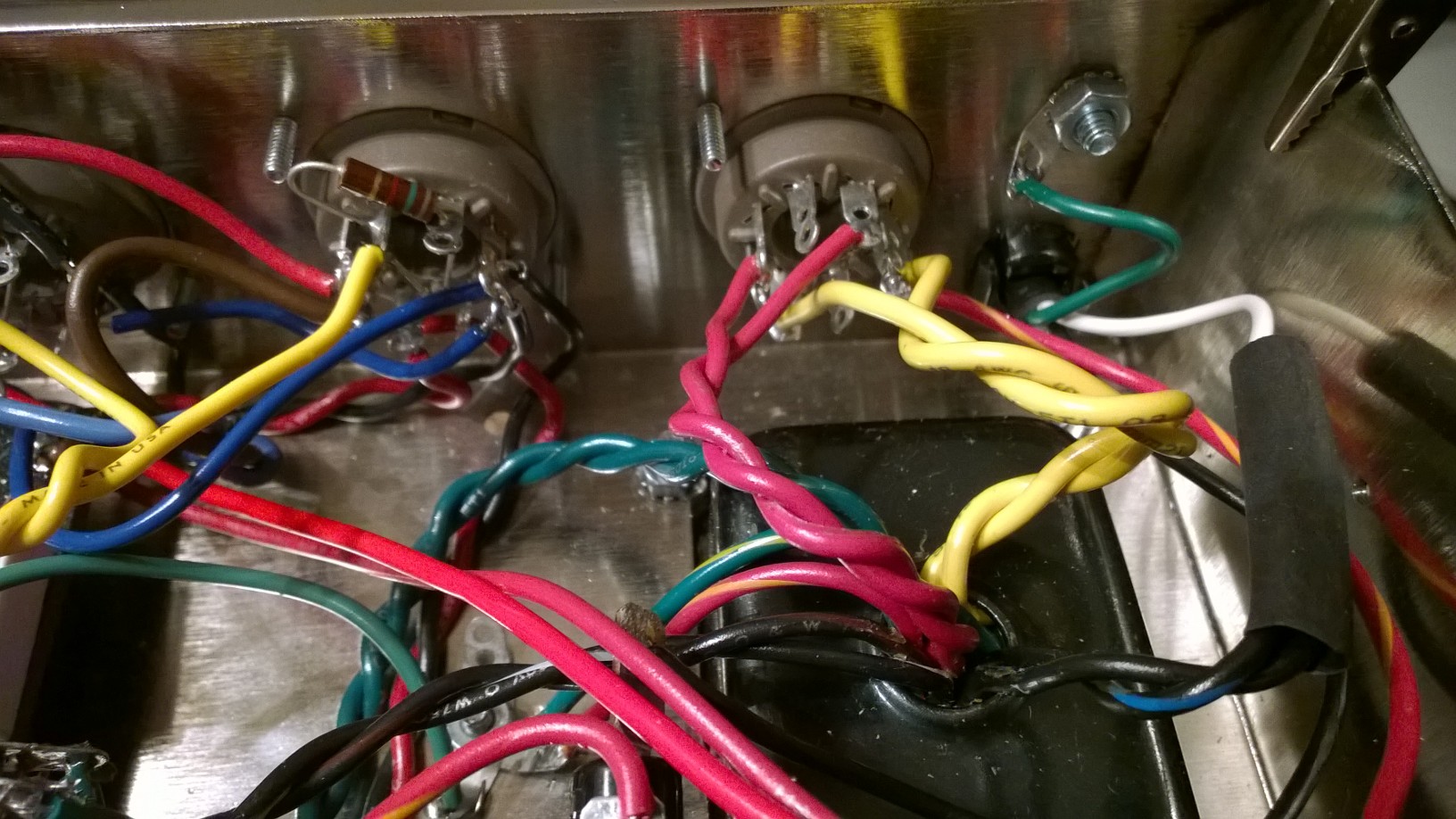

Just finished assembling a Tweed Deluxe amp kit. Turned it it on, no fire or smoke. I proceeded to do the initial voltage check. they don't seem right.
V5 pins 4 & 6, 362vac
pin 2, 5.65 vac
pin 8, 0 vac
V4 pin 2 & 7, 3.21vac
V3 pin 2 & 7, 3.21vac
V2 pin 4-5 & 9 3.21vac
V1 pin 4-5 & 9 3.21vac
Any suggestions?
Thanks,
Eric

Those voltages look OK if you are measuring from the pin to ground. The power transformer's 6.3 volt heater supply center tap is connected to ground so that's why you only see 3.2 VAC between each leg of the heater supply and ground.
You should see about 5 volts AC between pins 2 and 8 of V5. You should also see about 6.3 VAC between pins 2 and 7 on V3 and V4. And you should also see about 6.3 VAC between pins 4/5 and 9 on V1 and V2.
It's a good sign that you aren't getting any smoke! Does the amp work? How do the high DC voltages read?

I tested voltages with all of the tubes in place and a speaker load, of course. No sound from the speaker. Definitely have problems. Suggestions on where to go from here?
V1, 12AY7
Pin 1, 162V
Pin 3, 8.5V
Pin, 4-5-9, 6.1V
Pin 6, 162V
Pin 7, 0
Pin 8, 8.6V
V2, 12AX7
Pin 1, 100V
Pin 3, 1.0V
Pin, 4-5-9, 6.1V
Pin 6, 130V
Pin 7, 12.3V
Pin 8, 32V
V3, 6V6
Pin 2-7, 6.1V
Pin 3, 412V
Pin 4, 183V
Pin 8, 10V
V4, 6V6
Pin 2-7, 6.1V
Pin 3, 413V
Pin 4, 183V
Pin 8, 10V
The rectifier voltages are
Pin 2-8, 416V
Pin 4, 358V
Pin 6, 358V
On the board from left to right the voltages are, layout voltages listed parenthetically.
11.8V (22V)
190V (348V)
150V (255V)
41V (50V)
18V (18V)
109V (204V)
72V (158V)
1.12V (1.4V)
-149V (130V)
-149V (130V)
0V (2.0V)
 Post subject: Re: Voltage issues
PostPosted: Tue Mar 24, 2015 3:04 pm
Your voltages start going funny in the B+ chain after R22 (the 4.7k 2 watt resistor). None of the preamp tubes are getting the proper voltages at their anodes as the result. Check the voltage on both sides of R22. It should be full B+ (around 400 VDC) on one side and about 350 VDC on the other side. Make sure it's soldered in properly. Check for shorts and bad connections in that area and all over the whole amp. Also check that R22 is the proper value.
The voltage to the anodes of V3 and V4 looks OK, but their screen voltage is way too low for them to work properly. Again that's related to the problem around R22 so if you fix that everything should be fine.
