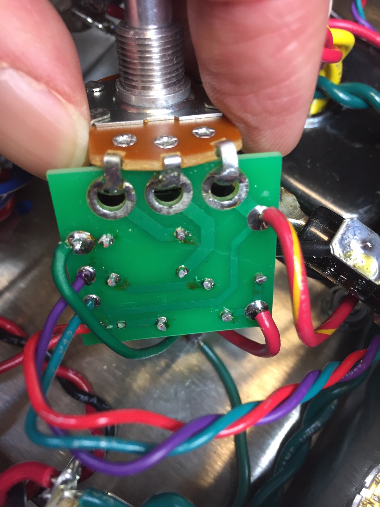

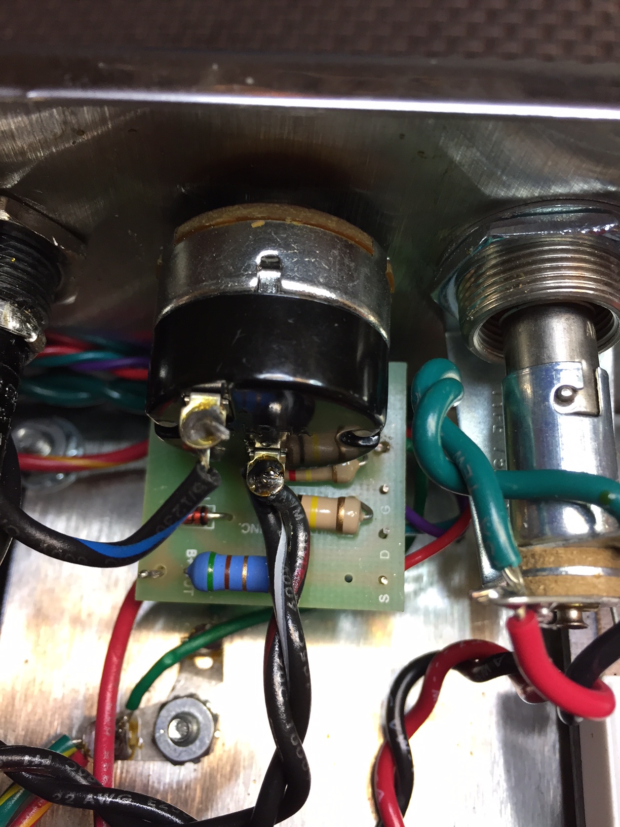

Thanks for the pictures. Very helpful. I just finished the install of the VRM. The amp works and sounds good. There is a more linear control on the volume controls...the amp used to hit "loud" by the time it was on 2. Both channels work and High and Low functions seem intact. I modified the inputs with the blocking capacitors and moved the 1M resistors directly to the tube grid. The VRM, however, doesn't seem to do anything. It turns the amp on, then there is no difference in volume or sound throughout the range of the adjustment. I have done what I can to check my connections but can't find where I've gone wrong. I'll attach a few pictures in case there's something visibly and obvious that I've messed up. Thanks for any help you can provide.

PostPosted: Sat Jan 07, 2017 11:09 pm
Does the voltage change when you turn the VRM?
Check the connections to the little PCB.

Hello,
Thanks for your quick reply.
The voltage at each rear lug on the VRM reads 33.5 volts and does not change as the pot is turned. I haven't taken things apart yet but I believe I made solid connections from the pot to the pcb. I carefully trimmed the lugs to make good mechanical contact before soldering and I checked continuity of these after making the connections. I've double checked my wire colours from the mosfet to the PCB and they seem to be correct.
