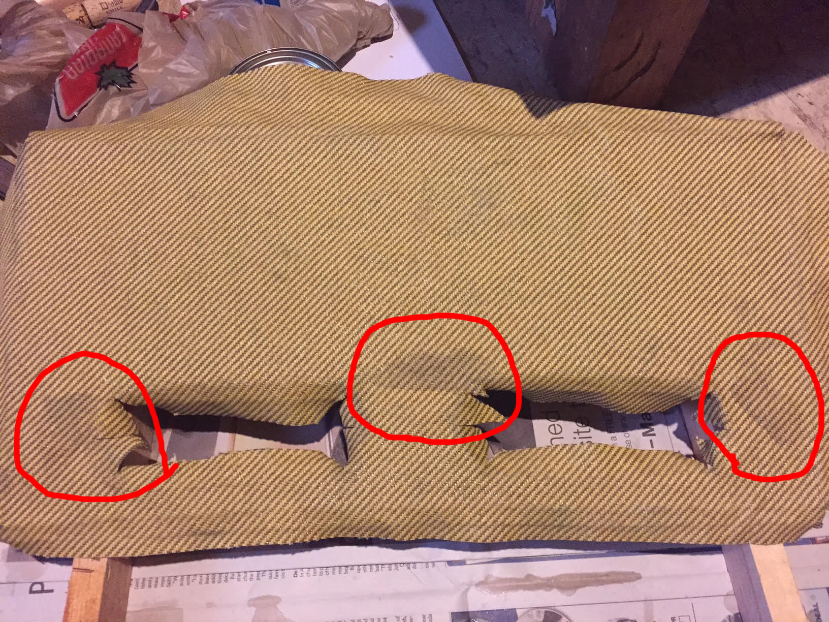

Thought I'd post a cautionary tale. Using contact cement on the cabinet and a LePage spray adhesive on the tweed I didn't put enough coats of contact cement on one of the plywood back panels (plywood absorbs a lot of contact cement) and it didn't adhere well. To repair the bad adherence I peeled half of the tweed back and applied more contact cement, unfortunately the liquid form of the contact cement soaked through the tweed in a couple of spots where I couldn't peel it back enough -- this stained.
I thought maybe the sealer would darken the tweed and even out the stains but it did not, so I once again removed the tweed from this back panel in order to redo it completely. I thought I'd post an image of the stains so folks can see what happens when adhesive (in this case contact cement) soaks through the tweed. This tweed has some sort of coating on the front, but no protective layer on the back as I've heard some do. Since I'm in Canada I got my tweed from nextgenguitars.ca. I'm not saying anything bad about this tweed, it just has to be handled correctly.

We use LePage solvent based contact cememt. One coat on cabinet and tweed. It soaks through in many cases BUT we let it dry for as long as possible before lacquering. A minimum of 3 days better 1 week or more.
You could try water based cement, but I have no experience with that and tweed.
When we apply the lacquer, forst one or two coats of clear, followed by one or two coats of our custom tinted lacquer.

So the parts that soak and leave discoloration lighten and disappear when fully dry? Or does your tinted lacquer even everything out? I guess I'm asking if you believe these stains would have disappeared in a couple of days.

PostPosted: Mon Apr 11, 2016 10:24 am
Yes, Initially they are dark but the vast majority of them disappear after letting it 'dry' for several days or a week.

Good to know. The stains on my black plate were of a spill severity, so I'd be amazed if they faded completely. I've already re-covered the part in any event.

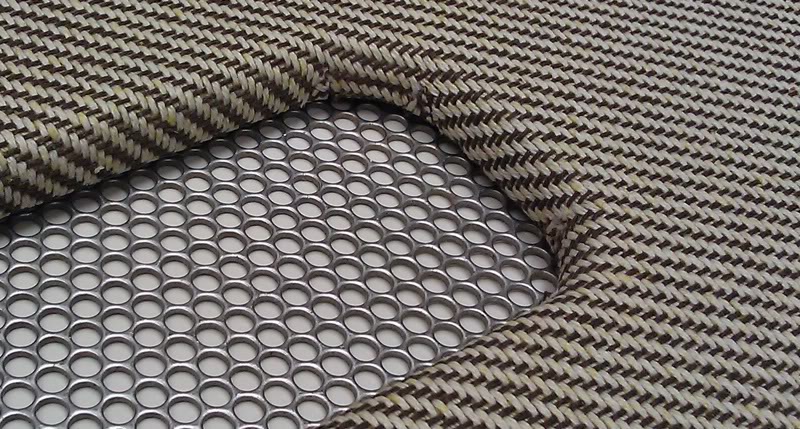

On another note, any idea where I can source this snazzy metal grill in Canada?
http://amparchives.com
PostPosted: Wed Apr 13, 2016 9:44 am
Nice grill but haven't seen that anywhere. I got some perforated steel at http://metalsupermarkets.com/store-finder/ a long time. ago. Expensive as I recall.
