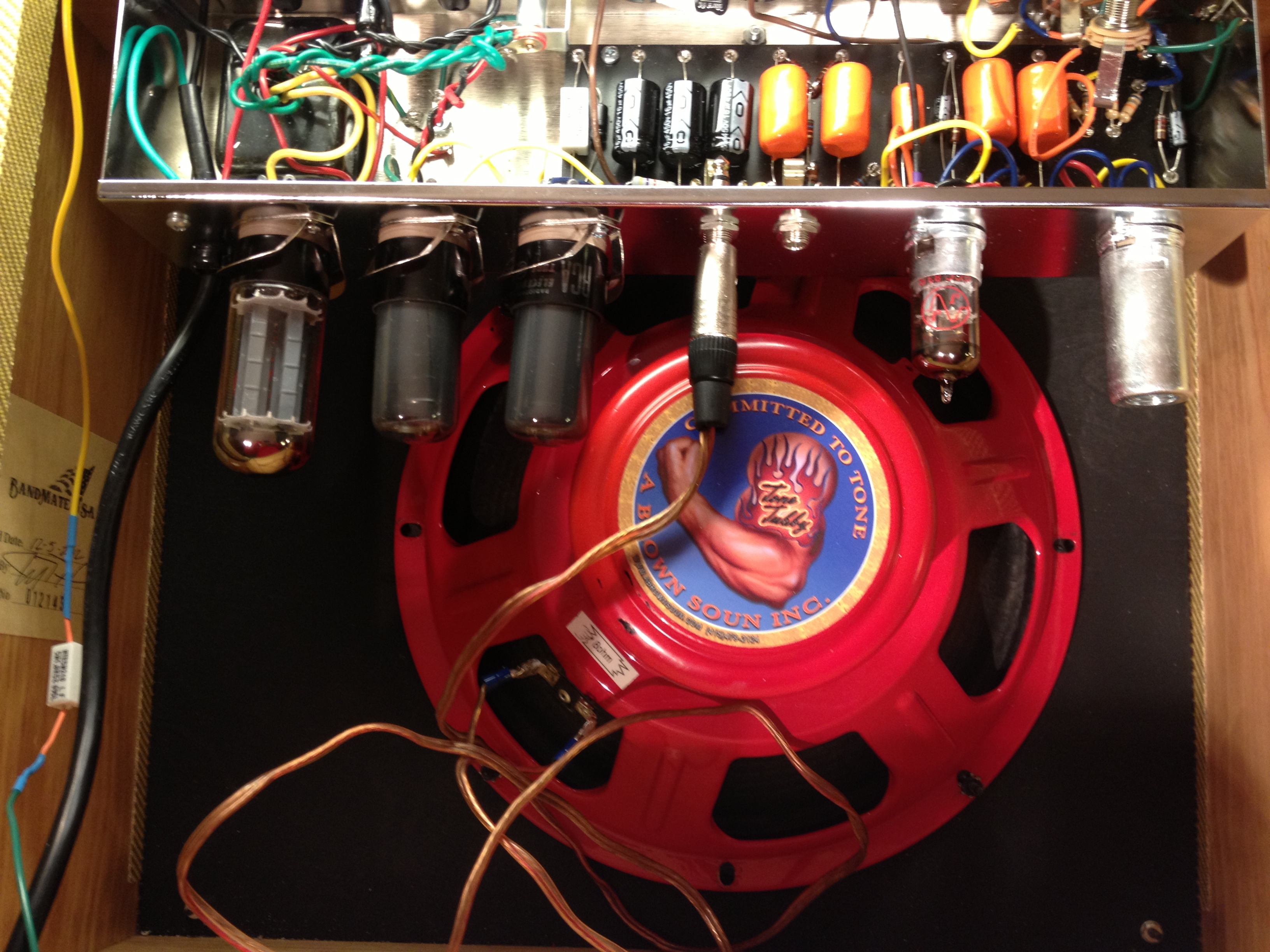

THE power JJs don’t clear the speaker. Vintage RCA do as they are so much smaller. Clearance with RCA about 1 mm; I’ve contacted the cab builder and he send me a new baffle.
The speaker plug is right against the speaker, I have bought a 90 degree plug to swap it out.

Here is the tight fit issue with a Tone Tubby the Chassis. NOS RCA fits just barely.
Replaced bent jack but haven't yet tested.

Waiting for a new baffle from the cabinet maker so that my big-assed Tone Tubby will clear the power tubes. I swapped out the straight speaker jack for one with a 90 degree bend so the jack should not interfere with the speaker.
