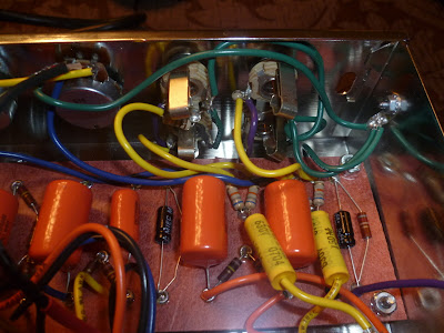

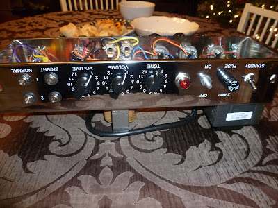

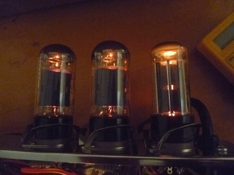

A few pics, the guitar is an Epiphone Special II, which is a les paul clone with simple electronics, like a Tele. The speaker is the TT Alnico 12".
You can just make out the DC blocking caps at the far end of the board acting as jumper from the 68K resistors to the inputs of V1. I mounted the VRM to the pot, and ran short jumpers to the MOSFET (they were around 1/2" long). I just need to get another chickenhead knob for the VRM pot. Any chance you could pop one in the mail for me? :roll:
I love the way the tubes glow.

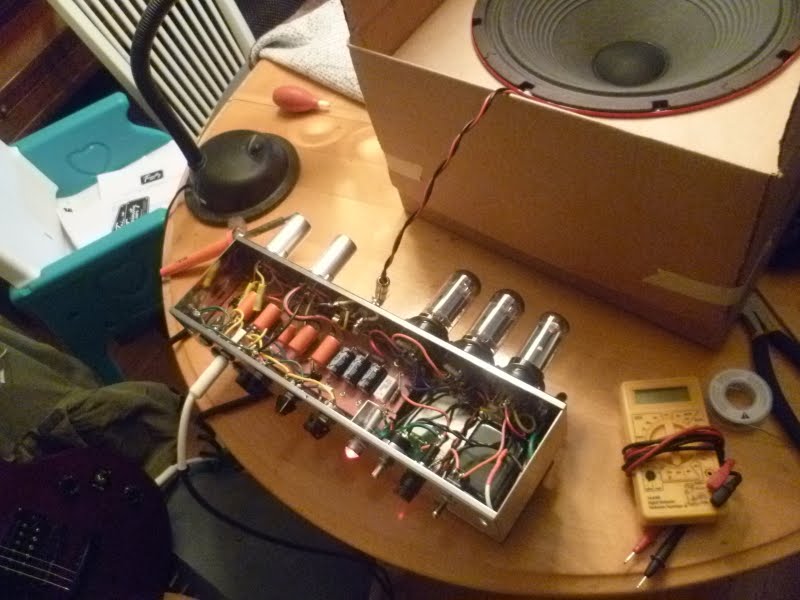

Ok, I got some more pics, feel free to tell me I screwed up if need be.
Hopefully I havn't made too many mistakes, it's my first tube amp. I've build a couple of stompboxes, and one Ruby practise amp (uses a LM386 chip and runs on a 9V battery, 1/2W, but good enough for practising).
