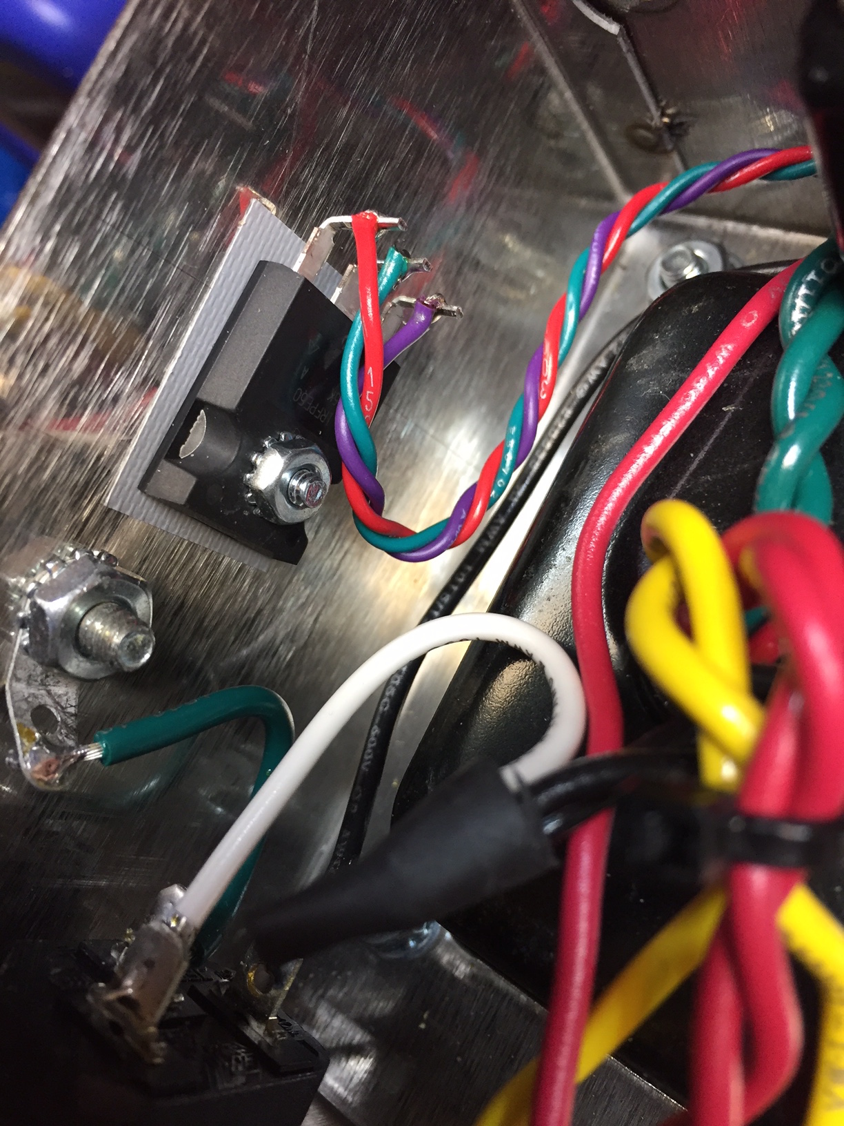

Here are some pictures. Used 3 different colored wires (twisted) to prevent confusing the connections and connected wires to board first. Ran the wires down and along the chassis, over to VRM MOSFET and connected the wire to proper connections on MOSFET.
