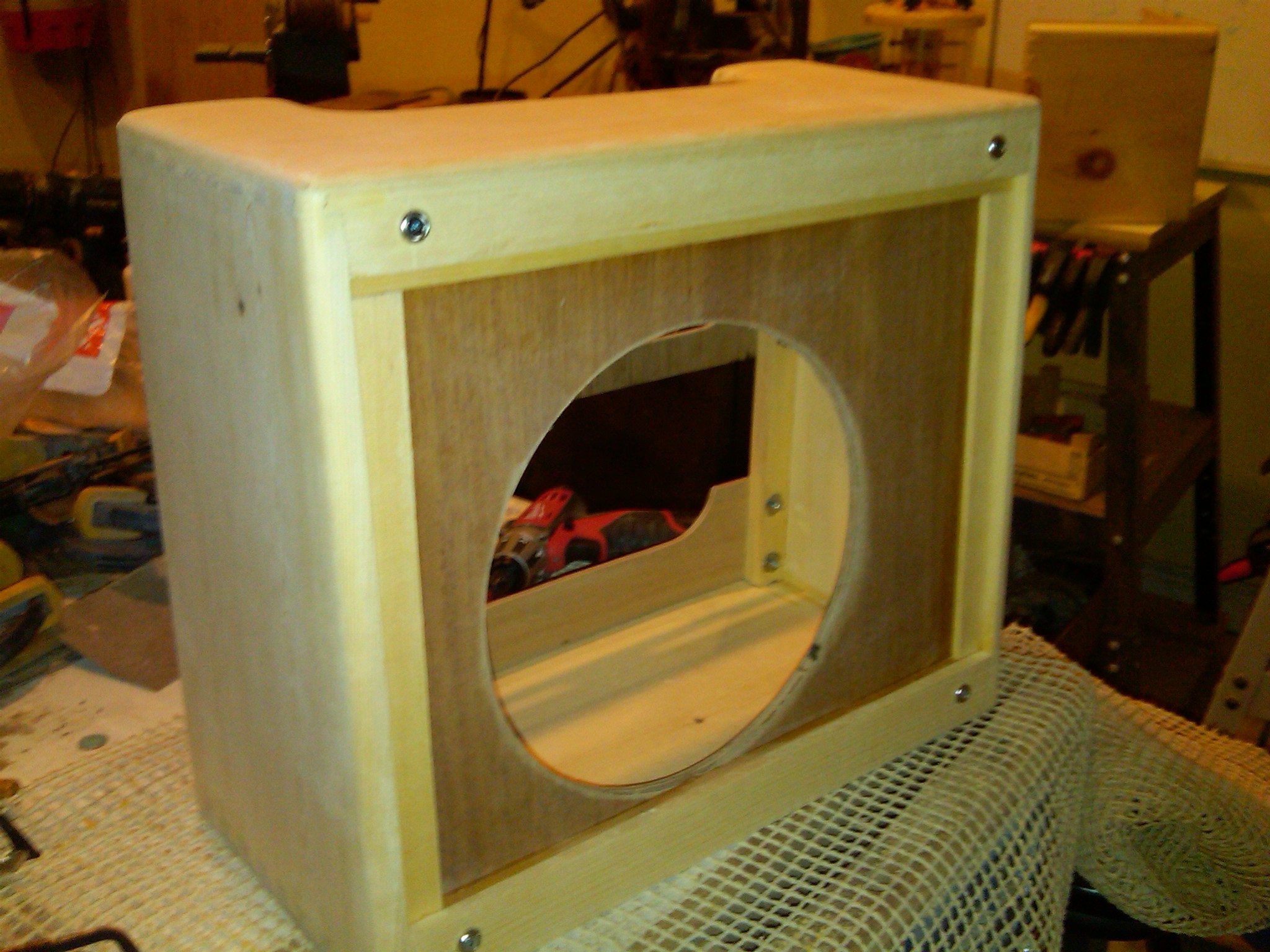

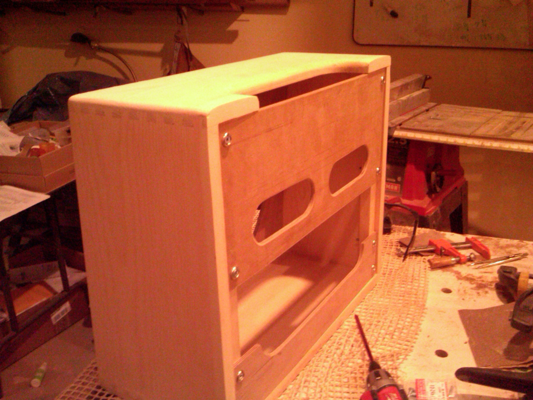

For what it is worth, here are the "naked" pictures of the cabinet. Excuse the photo quality... I took these with my phone.
Now all I need is the guts, and the covering..... Waiting on the postman for both of those.

Bruce, your cabinet looks great.
I am going to run the risk of possibly pissing you off by giving you a hint you surely do not need. Who doesn't hate that? All the same, this is a hint I didn't need, either, but still ran into trouble. And it's hard to tell from the angle of the cab in the second photo, but ... the back panels look pretty tight to the cabinet.
I left a generous 1/16" gap between the edges of the back panels and the cabinet, to allow for the tweed. Before gluing, I checked with two layers of fabric, all the way around each edge, and it was fine, and I added a bit for glue and finishing, but when I checked the covered back panels against the bare cabinet, there was not enough room - and out came the chisel. A real pain in the neck.
Maybe I needed to leave a full 1/8" gap? I wanted the panels really snug, to eliminate any possibility of buzzing, but I don't think they needed to be so closely fit. Anyway, just something to check and double-check, before you cover the back panels. Nice to get it right at this stage, where you can still trim the boards down, if you need to.

I have plenty of gap "width-wise" on the back panels for two layers of fabric.
I set the depth on the cleats with a 3/8" spacer. Given that the back panels are 1/4", that leaves me 1/8". I hope that allows enough for two layers of fabric, while still having the back panels slightly recessed to the sides.
If I did not leave enough for that, I'll break out the router and chisel.
