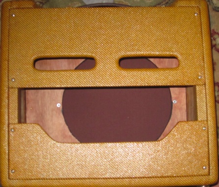

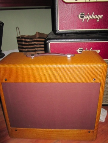

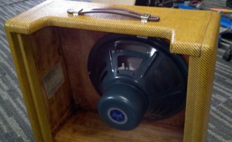

here are some pics of the cab I got. very cool if you ask me. I hadn't looked at it in a week but pulled it out earlier today. supposedly my kit gets mailed tomorrow :mrgreen:

also, stephen do you know have the dimensions for the chasis cut on the cab? It appears that since my cab was an exact copy of the original '54 the trinity chassis is slightly larger so I'm going to have to do some surgery on it to make everything fit nicely.
Chassis is 5" d, 14" w, 2.5" h . Tweed chassis we too shallow IMO anyway.
