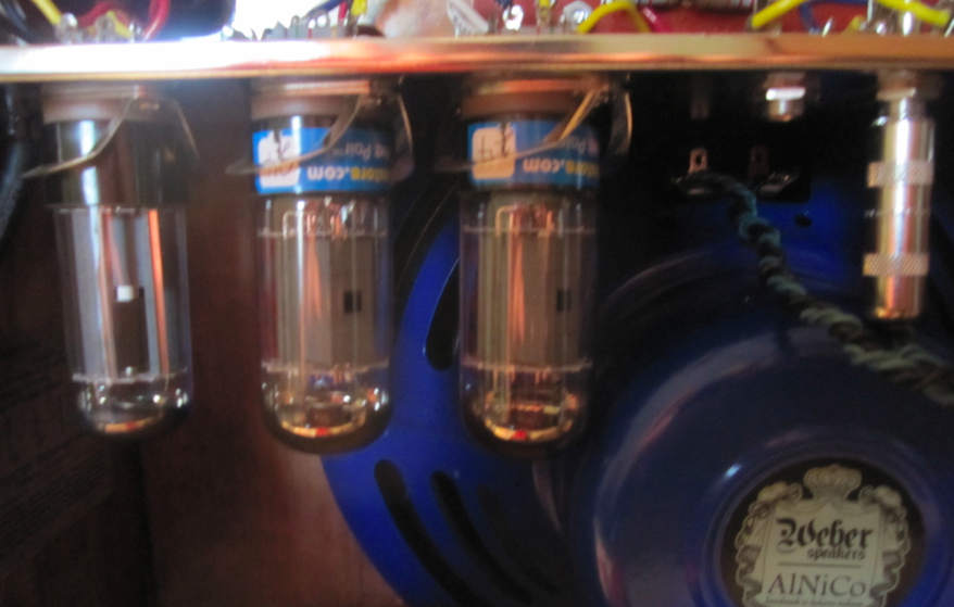

Ok so here's the situation:
A) I'm definitely getting frustrated and may have mucked myself up a bit.
B) I can not for the life of me get that stupid light bulb to fit. I have the right ones. Could I have possibly over soldered the connection and froze the mechanism?
C) When taking readings on my voltmeter I'm getting some weird things. (See photos)
D) So the cab I bought was modeled after a 5C3. I didn't think there would be a difference (because i didn't know what i was doing and I'm inexperienced) there was, and friend's dad helped me fit the chassis in this morning. Will the power tubes being that close to the speaker be a problem? (see photo)

You are going to have full B+ from the chassis to the rectifier if that's waht you are concerned about. If the tubes clear the speaker, you should be OK. As for fittng the bulb, I doubt it is a solder related problem. Are you getting 6.3 V across the light terminals? The fixture is spring loaded, so see if that is moving. Be sure to unplug & drain everything first.

Tubes close to the speaker are ok. Just don't let the two touch.
