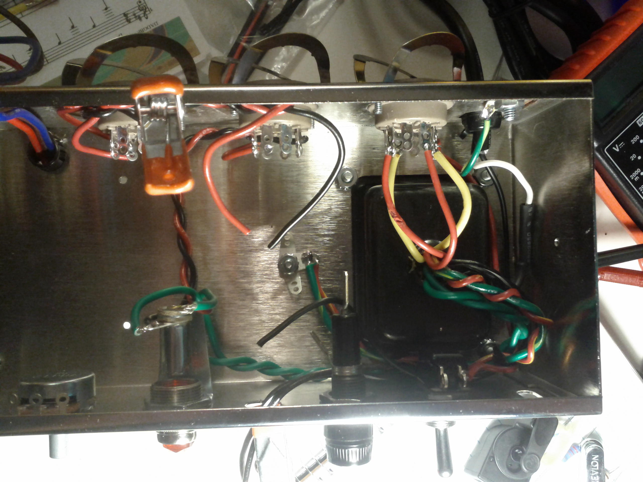

About to embark on my first Amp build. Kit arrived the day. A speedy delivery (thank you Stephen for all you help with making the decision.) I have started and have all the hardware installed and have laid out the heater wire. But when I reached the end I was about an inch shot of wire. No problem, I thought. But no one seems to sell 20 awg wire. I can find 18 and 22 but not 20. My question:
can I use the left over wire from the PT to finish off what I need? I just need about 5 - 6 inches to go from 6v6 to the next 6v6.
Thanks all

I'm surprised you don't have enough heater wire. Stephen usually provides more than enough wire with the kits. Check your heater runs and make sure they aren't too long.
You could use the PT wire if you have enough left over. The key thing is to twist it together tightly. Stranded wire like the PT uses won't twist together as well as solid core does. I would use some of the solid core wire instead if you only need a few inches. Check your lengths to make sure you have enough to go from the board to the tube sockets and controls, then see how much you have leftover.
Even though heaters only use 6.3 volts, for safety all wire in the amp should have insulation that's good to the highest voltage in the amp. You could use 22 gauge wire for the heaters. I do that with my scratch built amps. It has more than enough current carrying capacity. 18 gauge is too thick and hard to work with.

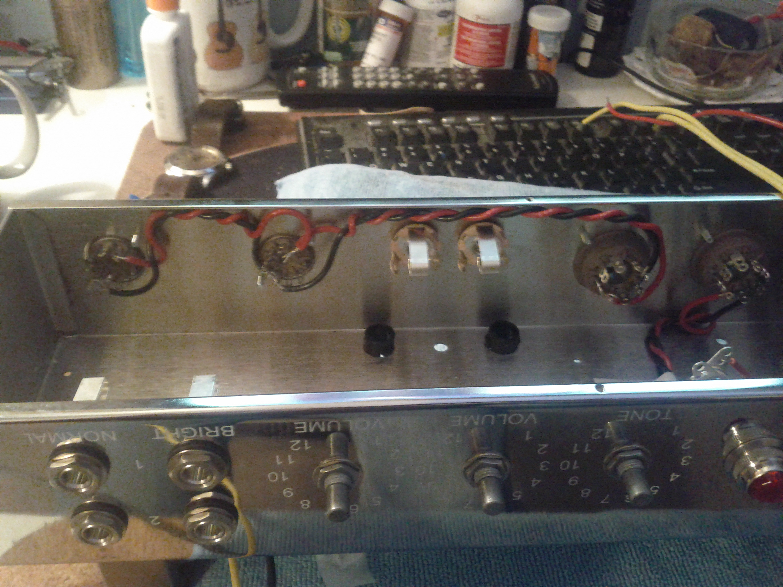

No, user error while cutting the wire. If its ok to use the left over wire from the PT, I'll finish it that way. I've attached a few pics of where I am curently at. just finished wiring up the PT

Looks good. Too bad about running short of the black and orange wire for the heaters.

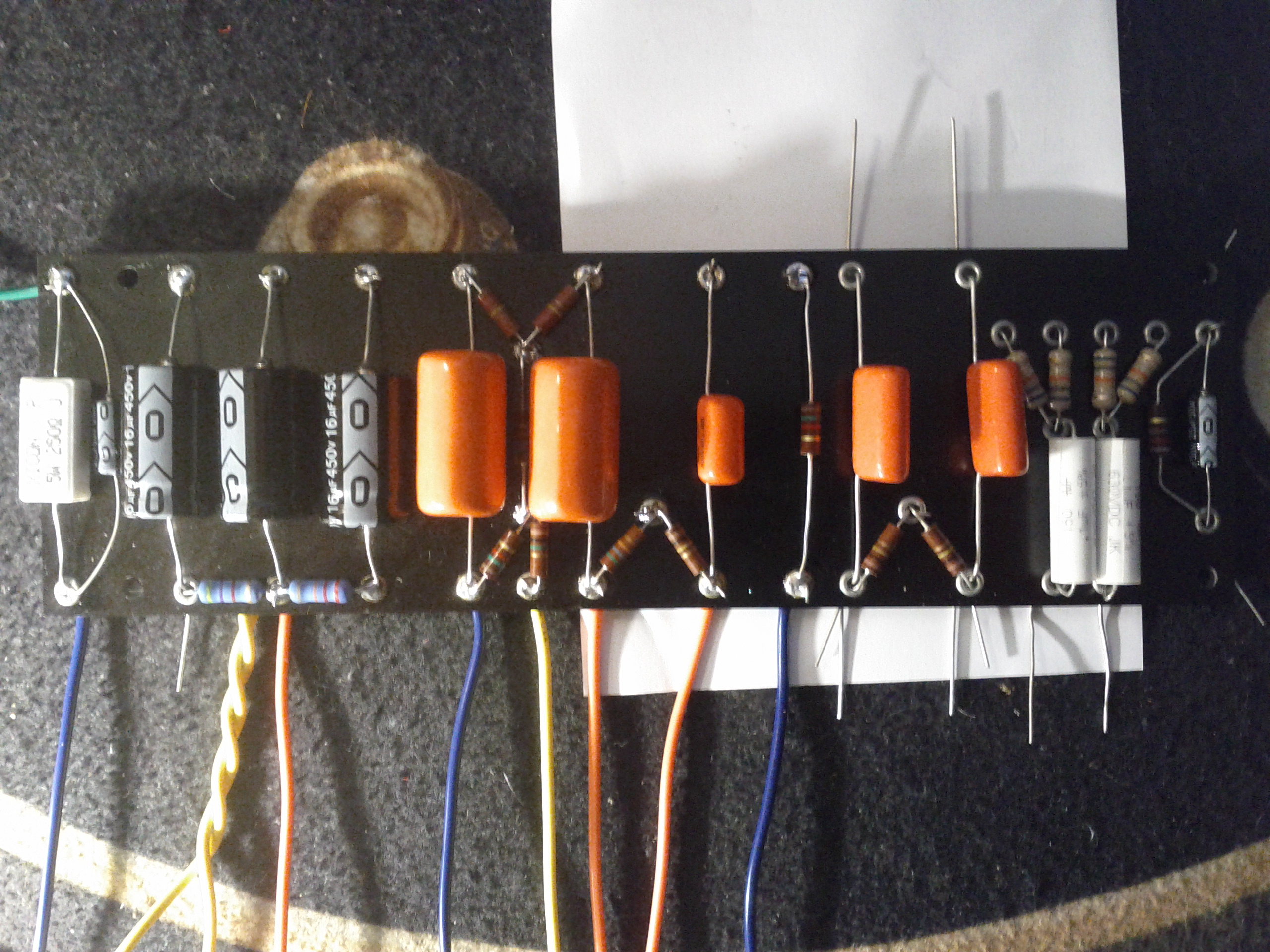

Moving along on the build. I finished wiring up the OT and PT. and am finishing up the board. I've included a picture below.
I have a quick question about VRM install. I want to ensure there is no polarity on the DC blocking caps before I solder into place.
Also, want to confirm that I am moving the 1m jack resisters to the tube grid on pin 2 & 7.
I am also doing the vol/tone mod which is evident by the .022 caps and the absense of C7.

Looks good
Yes, 1M grid leak right on the tube socket.

Sorry about the heater wire. You can twist any of the other wires together to form them just use two colors

No problem, Stephen. I used the red and black lef over pieces from the PT.

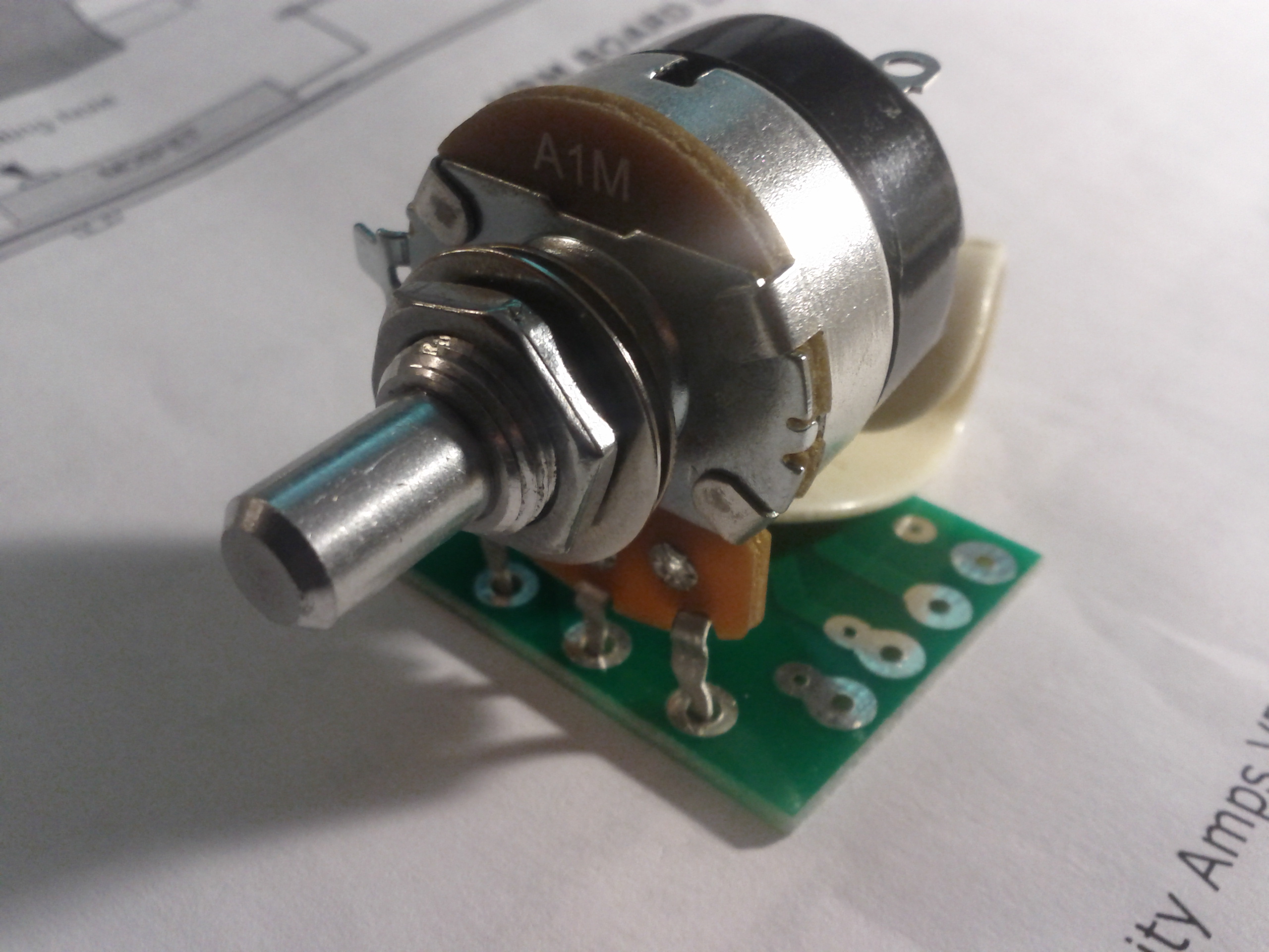

I am a little confused putting the pot onto the PCB for the VRM. Which of the two attached pics is correct?

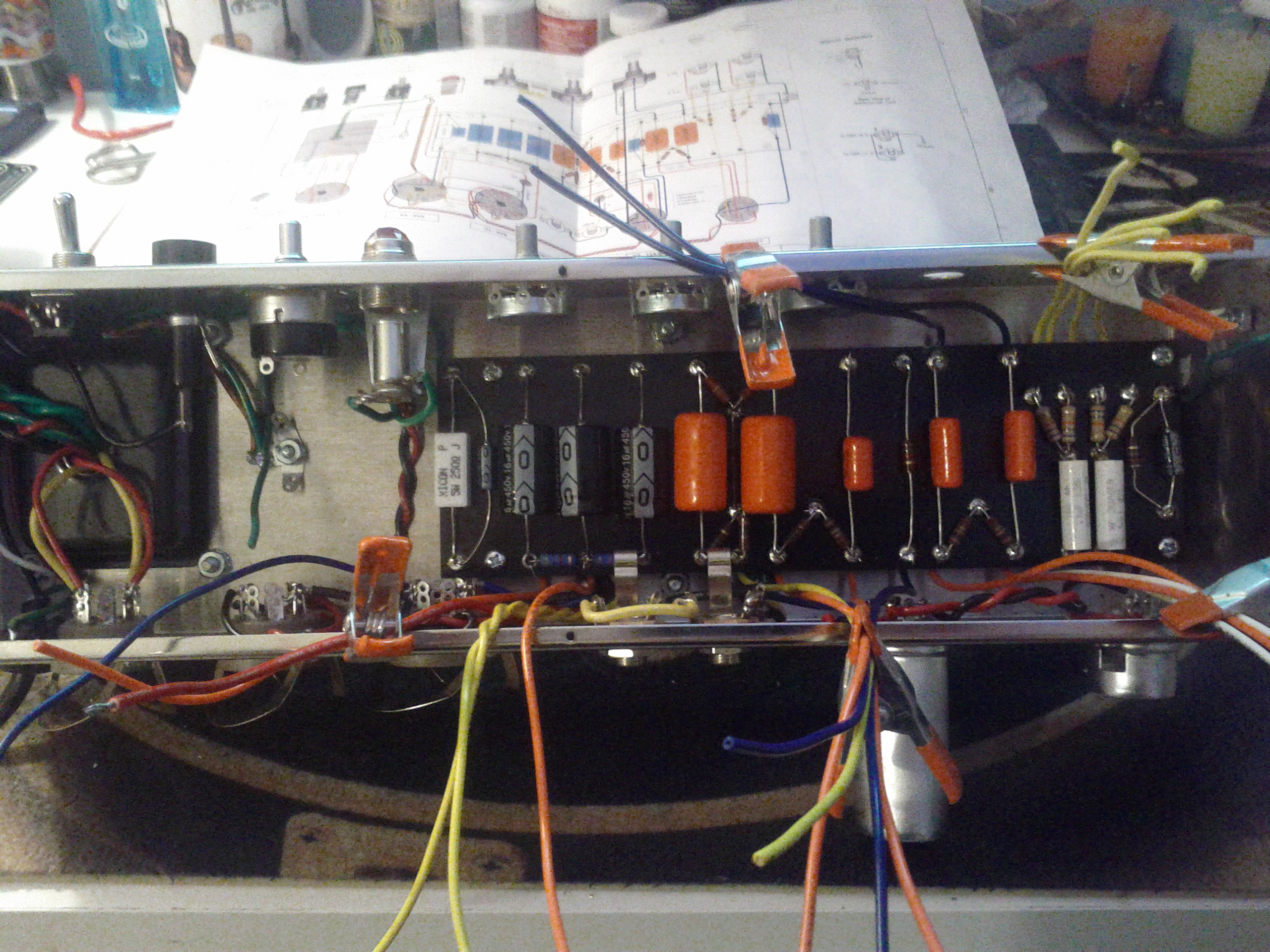

I also got the circuit board finished and installed into the chassis.
Thanks for any assistance.
File comment: shiny side of PCB
File comment: unfinished side of PCB
File comment: Board installed in Chassis
 Post subject: Re: Tweed - First Build
PostPosted: Sat Oct 19, 2013 12:28 am
Unfinished side up, as in the second picture.
