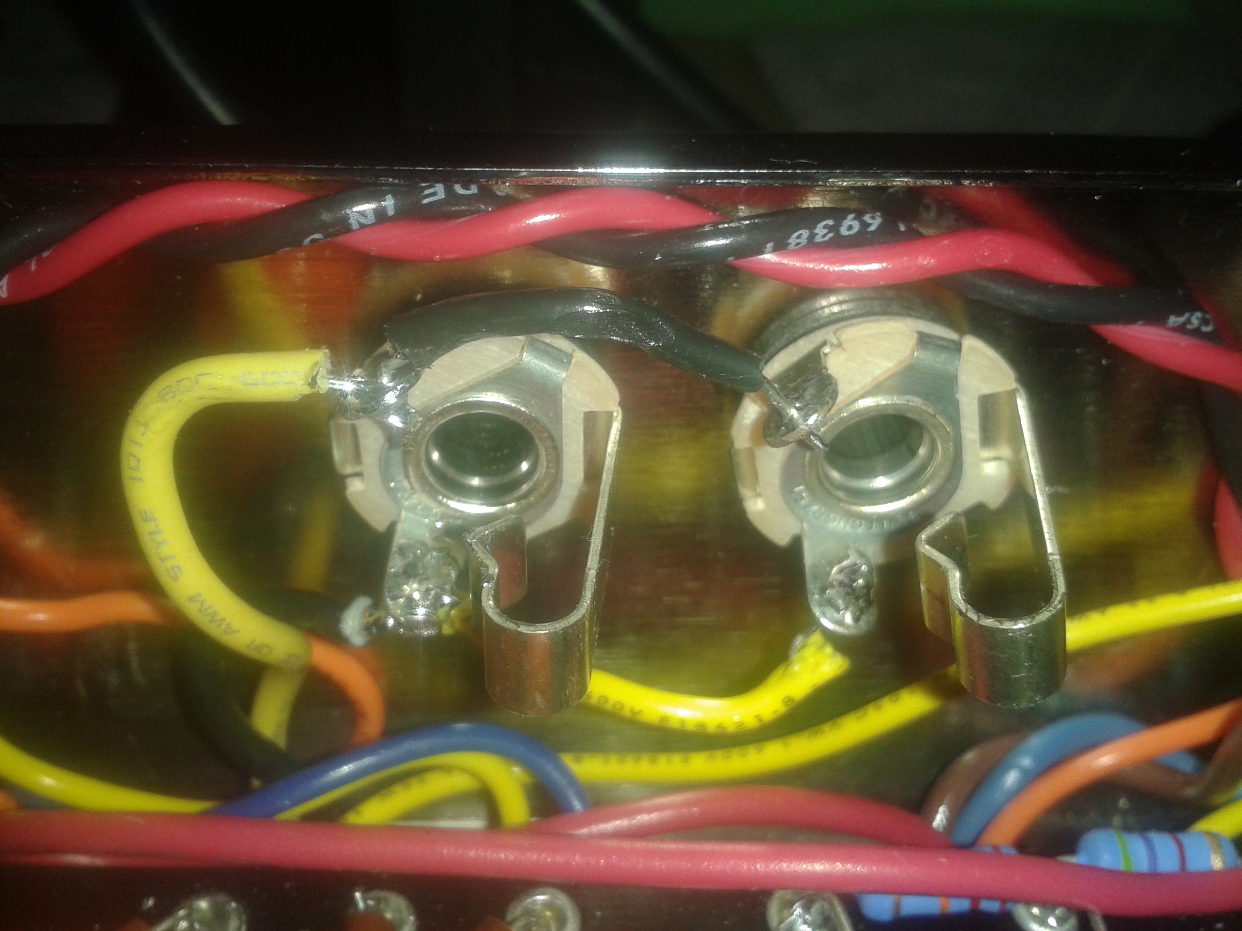

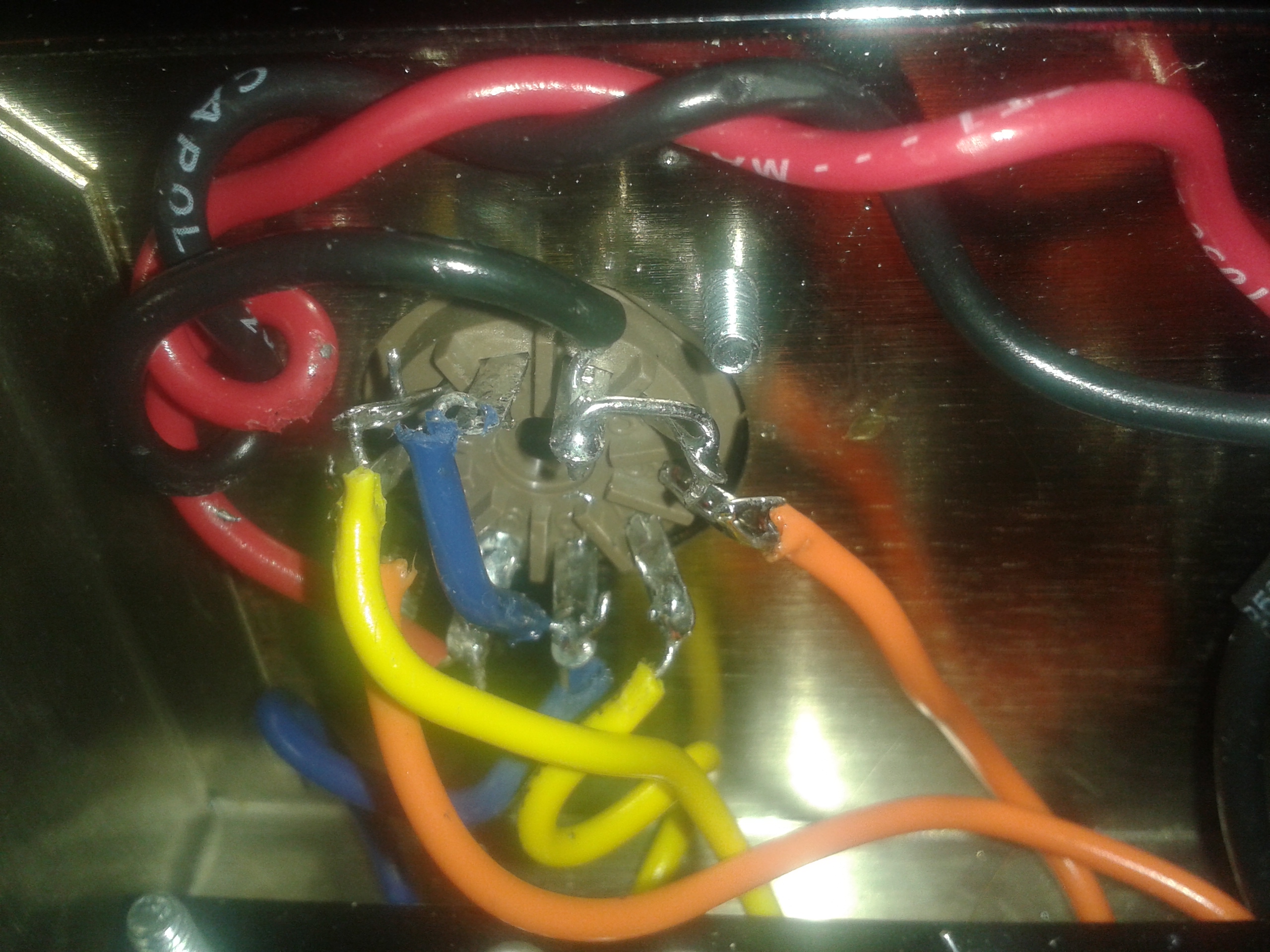

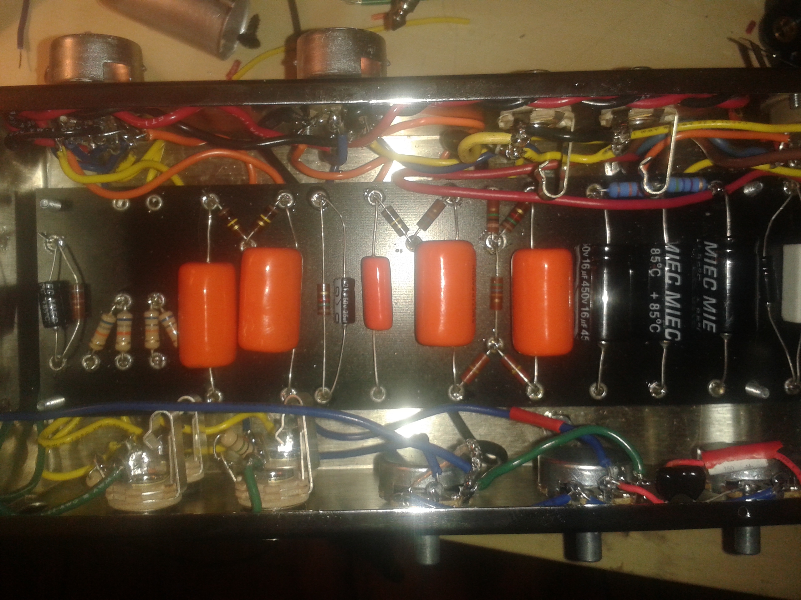

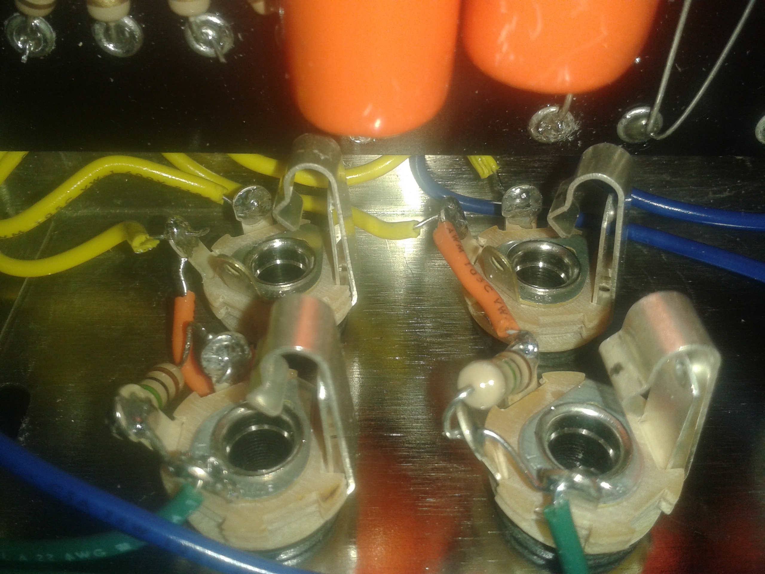

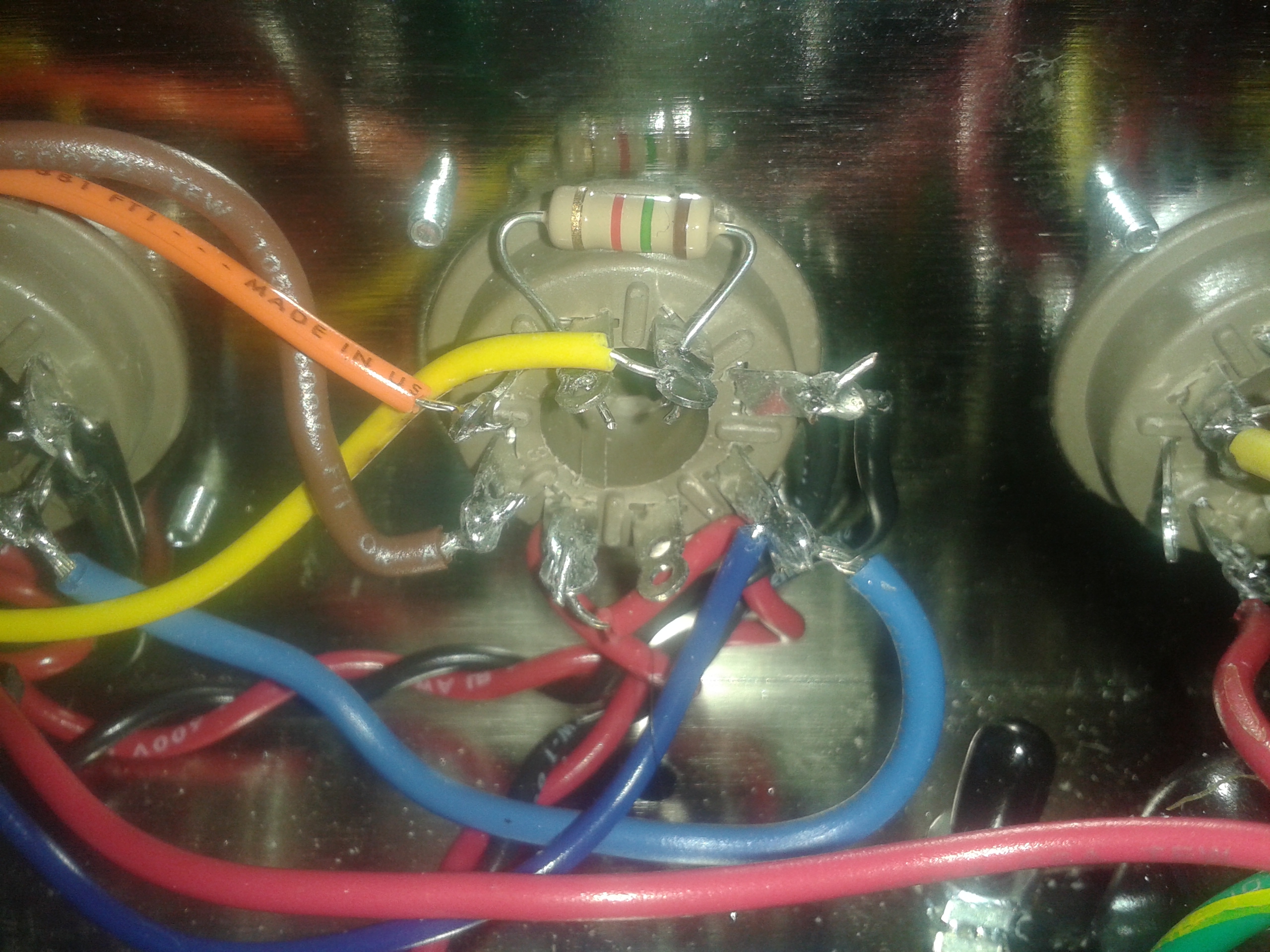

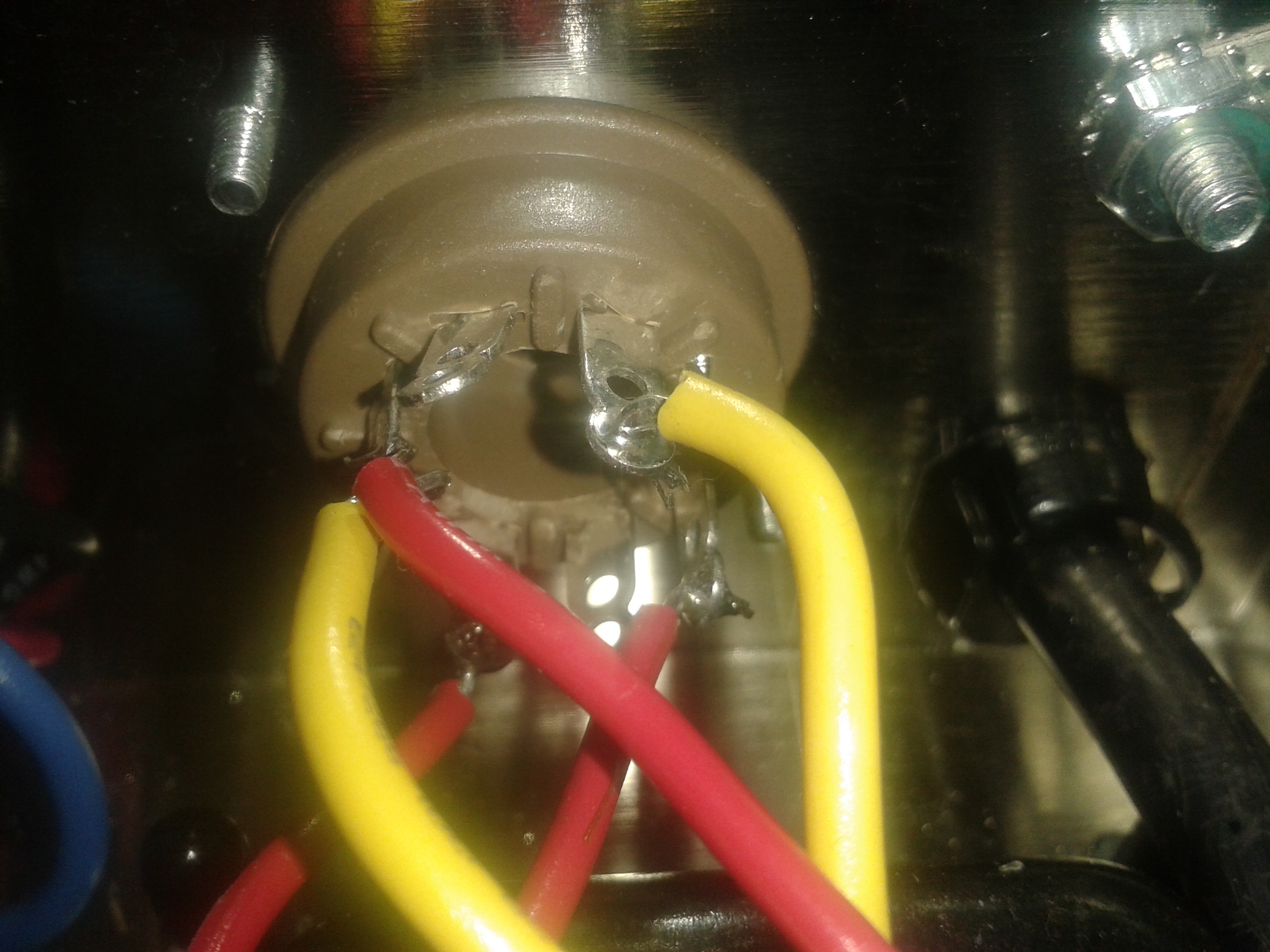

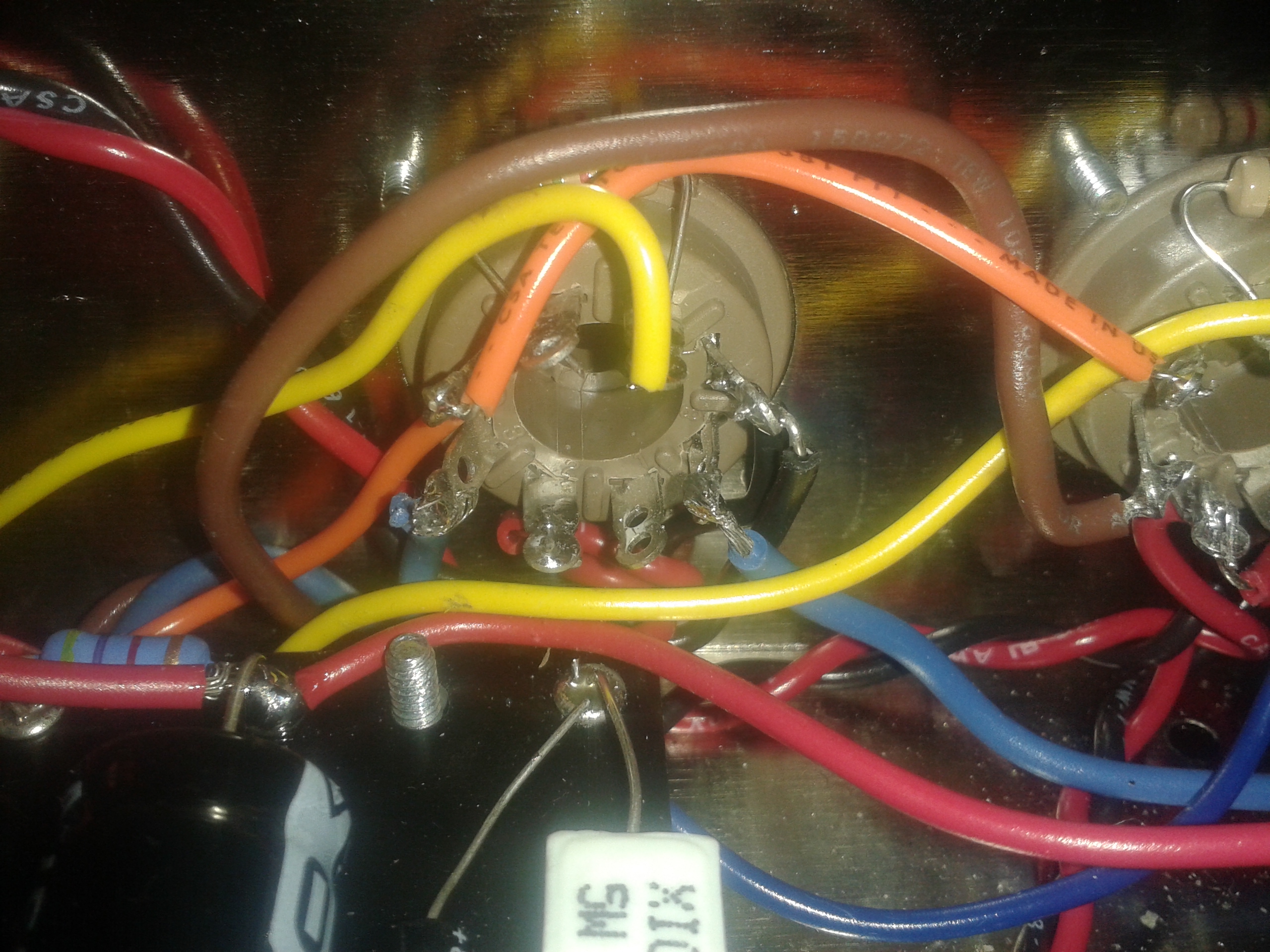

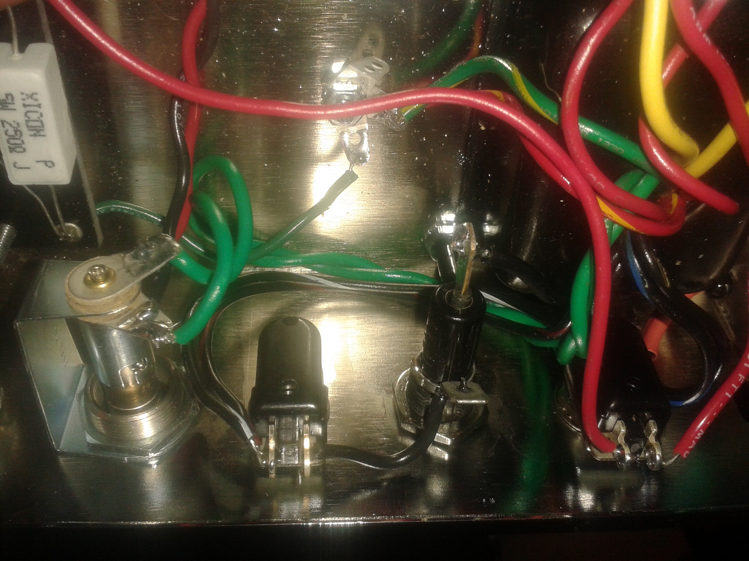

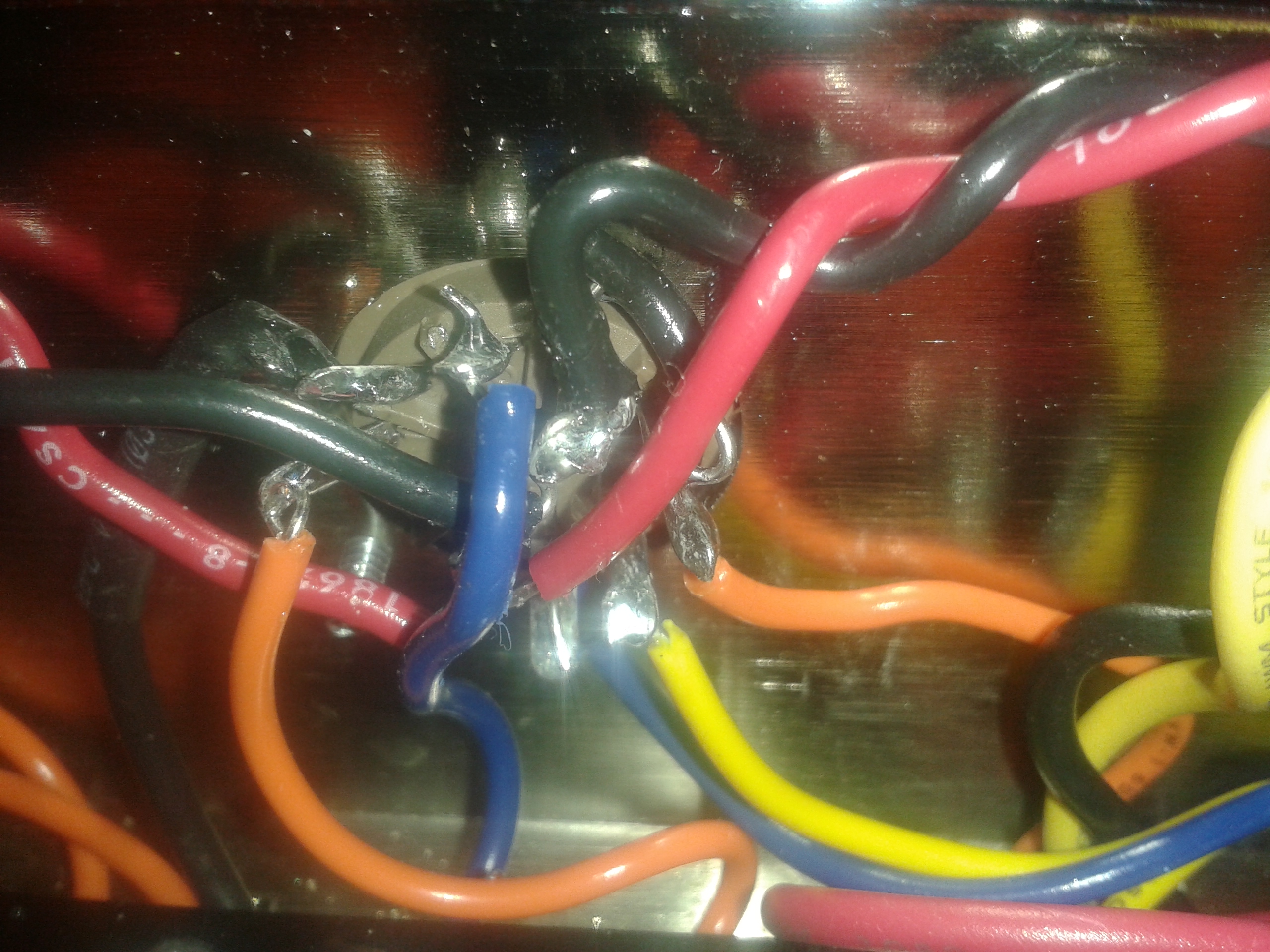

pics:

I see some solder joints that bear close inspection, particularly on V1, V3 and the input jacks.
My $.02,
Gene
