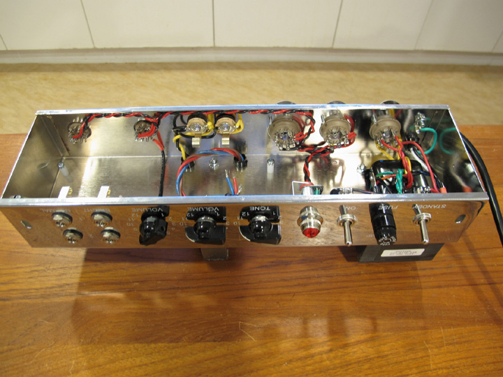

No, user error while cutting the wire. If its ok to use the left over wire from the PT, I'll finish it that way. I've attached a few pics of where I am curently at. just finished wiring up the PT

Looks good. Too bad about running short of the black and orange wire for the heaters.

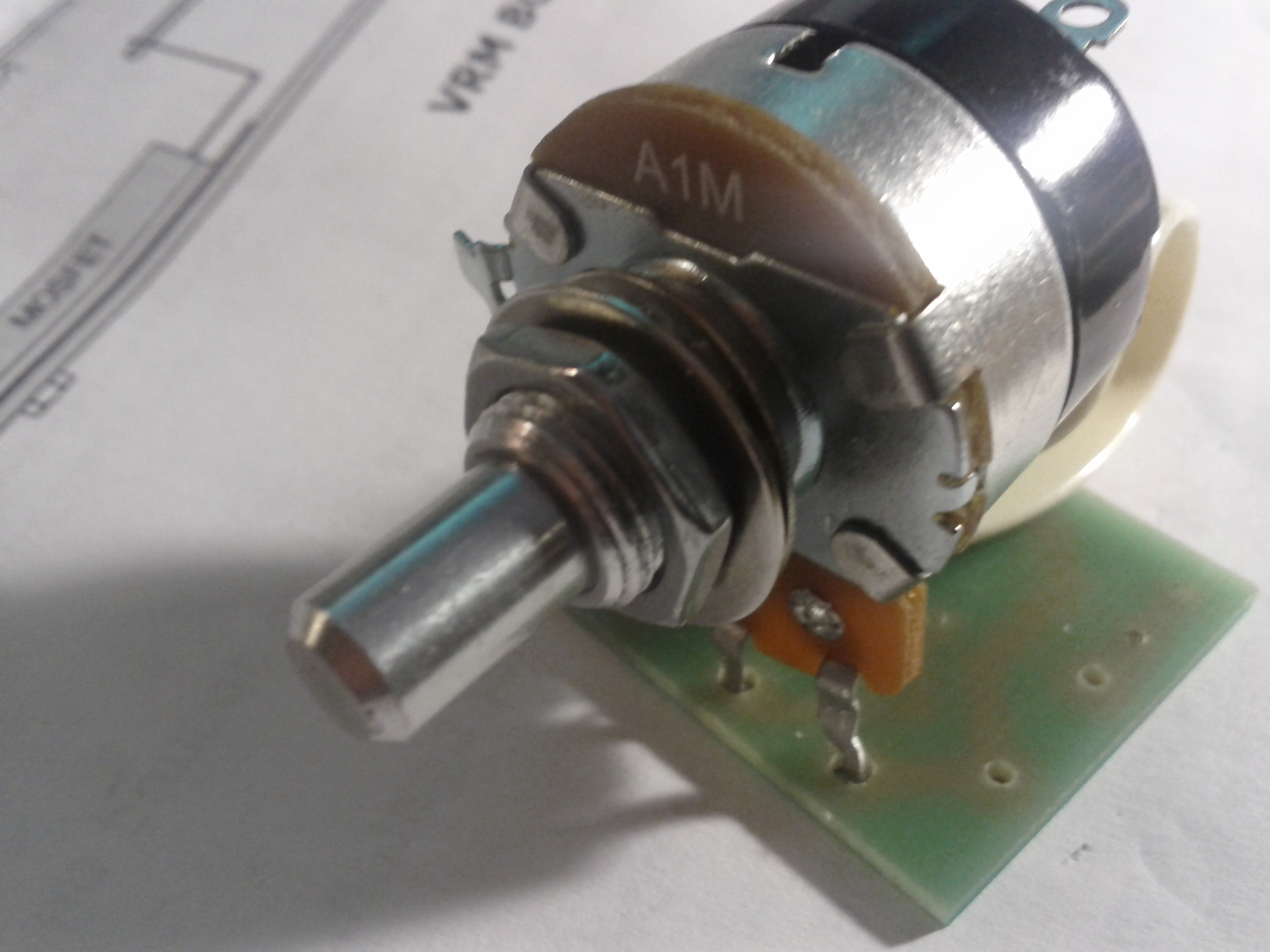

I am a little confused putting the pot onto the PCB for the VRM. Which of the two attached pics is correct?

File comment: shiny side of PCB
File comment: unfinished side of PCB

Unfinished side up, as in the second picture.

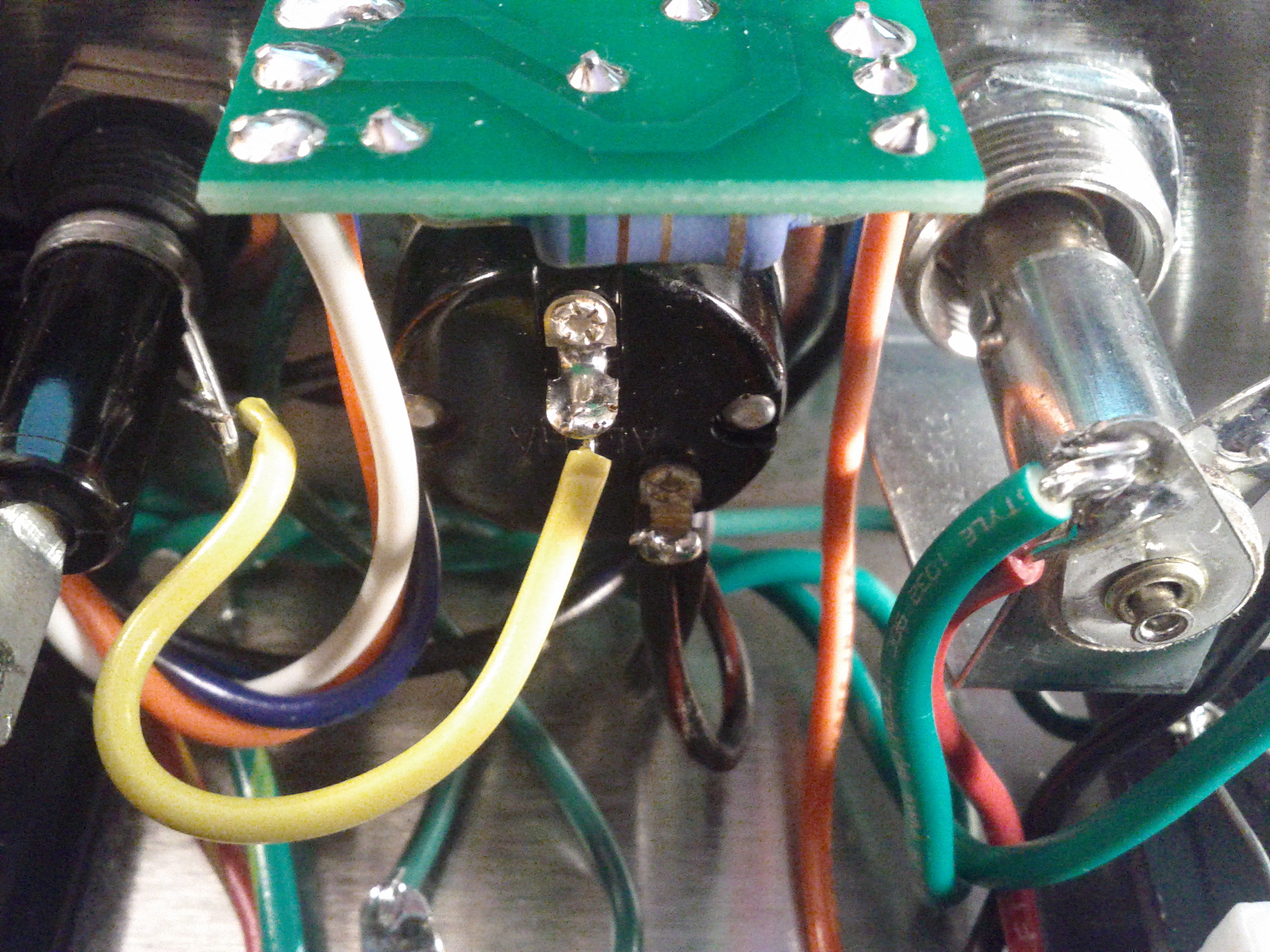

I have another question. I have just finished installing the VRM. I wired up the Pot but I'm not sure if I have the wires correct on the back.
The yellow wire is going to the fuse. Do I have this right or should I switch positions with the black/red and black/white on the bottom of the pot.

It doesn't matter. It's a switch and it has no polarity. What you have done will work.
