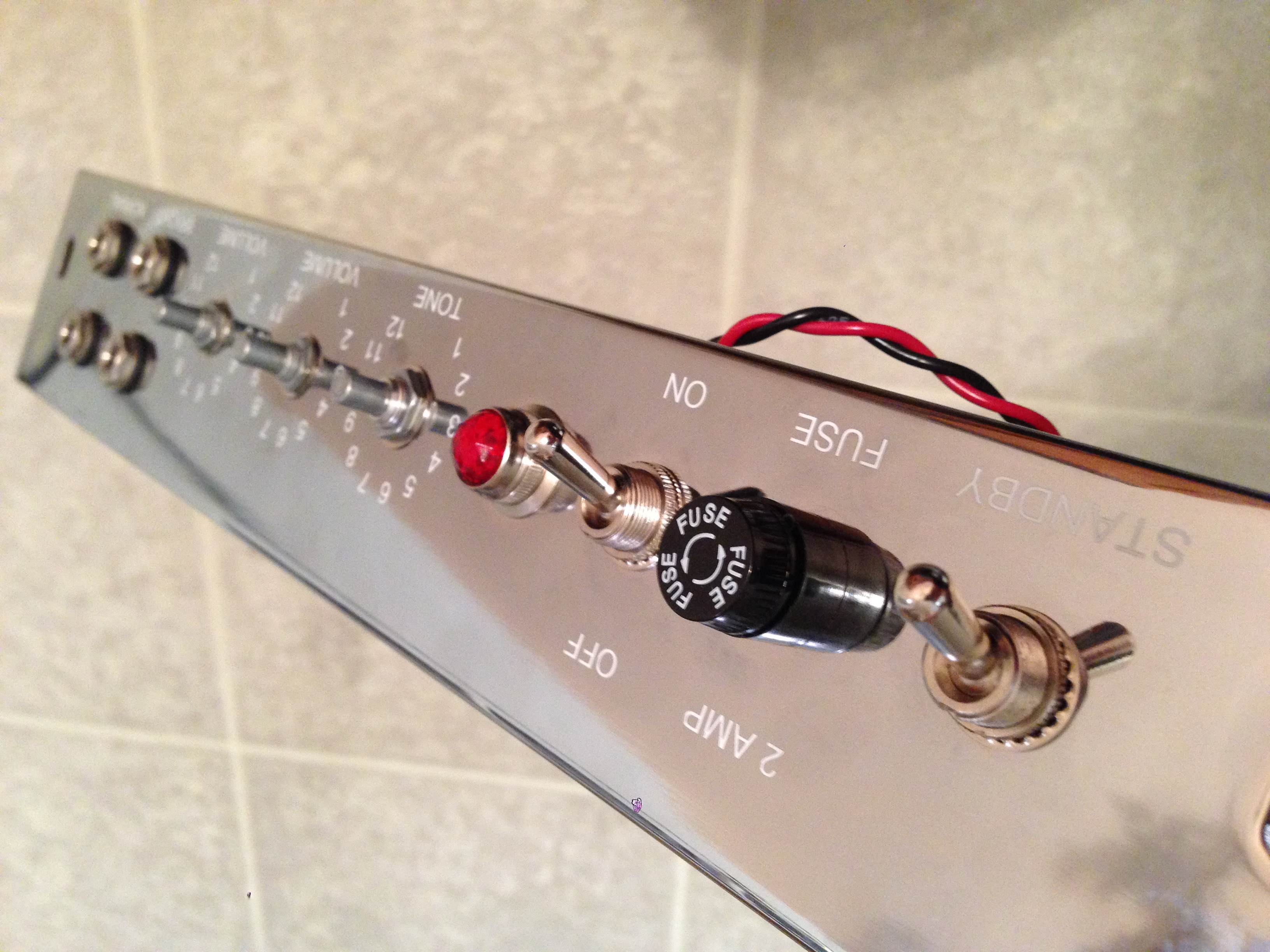

Starting my first amp build. I currently have and play through a 59 Bassman reissue, a Blues Junior, and an Egnater Rebel 20, so you can probably tell I like that Fender tone. So much so that if this amp works out, I'm likely to sell the Egnater (have never quite grown to like it as much as I expected) and replace it with the 5E3.
I've done lots of guitar wiring, including on-board active electronics and effects and even a pickup mixer (back in the 80s), and have done some limited stomp box wiring, but this is my first time working with tubes. I've never been a great solderer, but managed to get by. Fortunately, my son, fresh out of high school electronics electives, is a great solderer, and he's helping me out with this build.
I ordered a kit and cab from Stephen, and he sent it out once the cab was complete. After a shipping-related hiccup that resulted in a bent chassis, Stephen rushed me out a replacement just in time for xmas!
Some quick pics, and then some notes about my concerns/questions so far...
Front hardware:
File comment: Front hardware

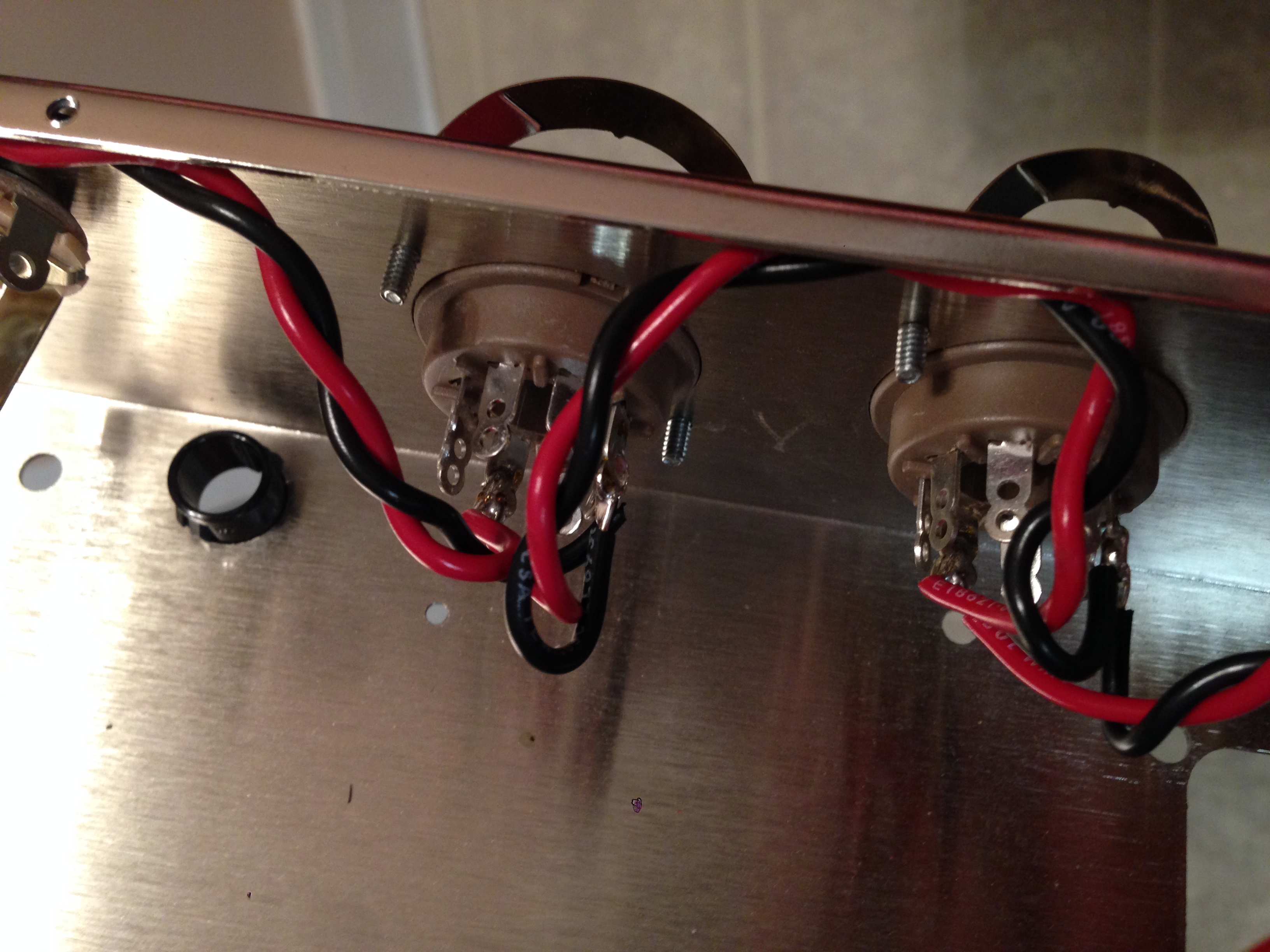

Back hardware:
File comment: Back hardware

Here are some pics for the heater wiring. We actually started from the "end" at V1 and traced in to the lamp, which seems to be opposite the recommended approach in the manual (seems like it wanted us to start at the lamp and go out from there to the power tube sockets, and thence to the preamps), but I figured it might be easier going the other direction. I know, second-guessing the docs is probably not a good first step, we'll see...
Starting with the preamp sockets:

I ran the twisted heater wires along the inside edge of the chassis, is that right? Wasn't sure where to put the run from the power tube sockets to the lamp, so I just let it hang in free space; worried that it will become a PITA to work around it later. Should I be running it along the front of the chassis (next to where the transformers will go)?

Another gotcha I discovered when installing the fuse: the fuse housing had broken during shipping, and I hadn't noticed until now. When I did my BOM check, I only glanced at the contents of that bag without taking everything out. Consequently, I had to go out on xmas eve on a quest to find any store that was open and had a 2A 250V fuse. I found a local guitar store, 15 minutes before they closed; woo-hoo!
The only other issue I ran into was that the pot shafts are very slippery, and I'm finding it near impossible to get the chicken head knobs to keep firmly in position. I've tightened down the set screws (one of the chicken heads had a _very_ stiff set screw!!! the other two were fine), but the knobs still turn past the stopping point, when given a bit of pressure. Perhaps I'll take a dremel to the shaft and try to score a hole or flattened area that the set screw and dig into, but before I do, has anyone else solved this problem?
I'm used to the pot shafts that have a flat side, which allows the set screw to sit on the flat side, from whence it cannot move.
PostPosted: Wed Dec 25, 2013 1:42 pm
Hello and Merry Christmas!
Your wiring looks really neat so far. Yes, you should tuck the heater wiring under the lip of the chassis. One thing I can suggest is you keep the heater wires close to the chassis all the way to the tube sockets rather than looping them up at the sockets as you have done. This will leave more room for the signal and high voltage wires and keep the heater wiring farther away from them.
Keeping the heater wiring close to the chassis and as far away from the other wiring as possible will keep hum to a minimum. I know Fender isn't overly concerned about this with their wiring but here's a chance to out do them!
I would also run the heater line from the pilot light to the power tubes more or less straight across but close to the chassis rather than up in the air.
Fair enough. I was able to adjust all of them except for V2, which looks like in order to snug it down more, I'd need to re-solder. I'm (probably foolishly) going to go ahead with the rest of the build, and see if I have any hum.
Good call! Done.
