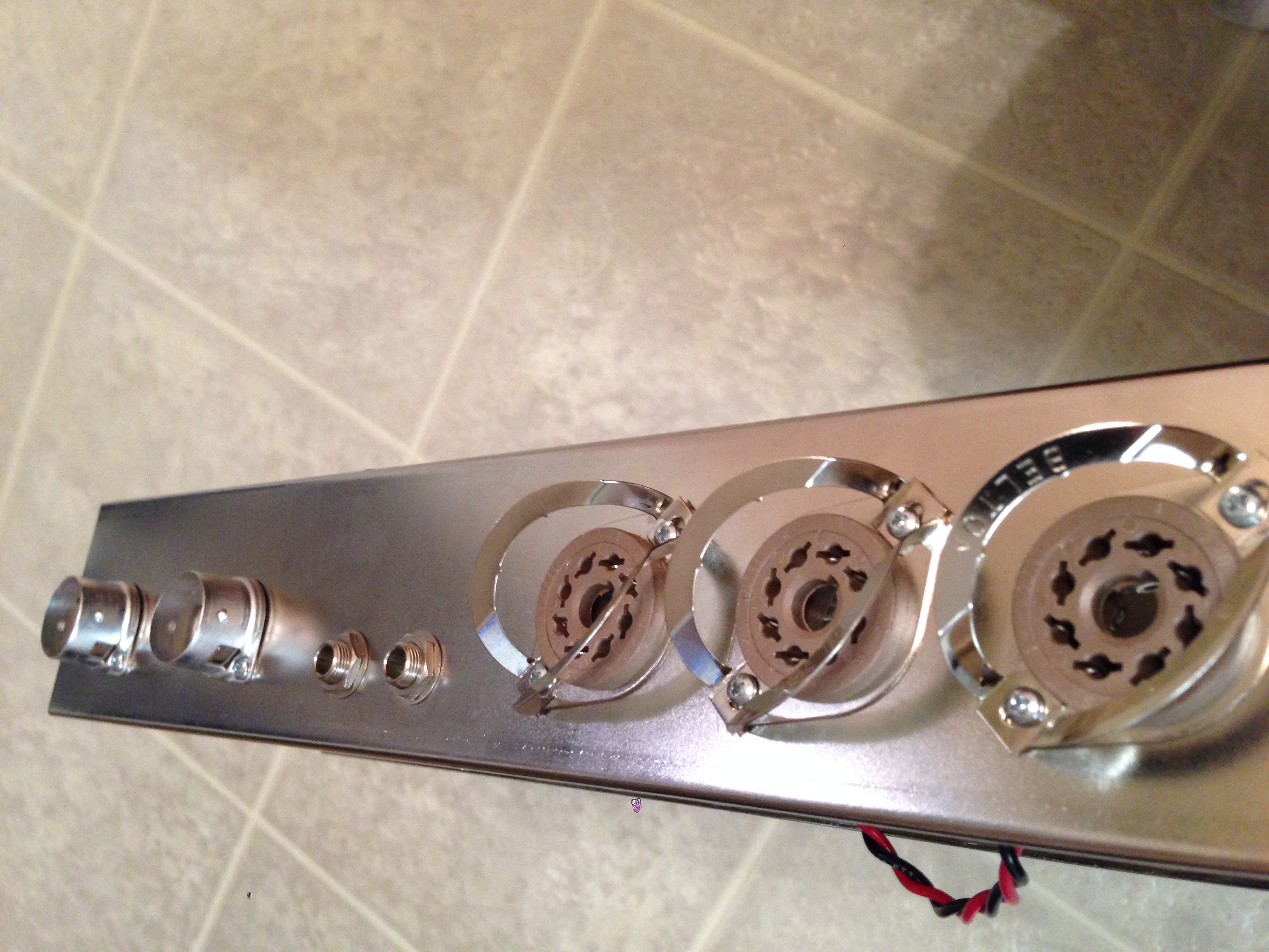

Starting my first amp build. I currently have and play through a 59 Bassman reissue, a Blues Junior, and an Egnater Rebel 20, so you can probably tell I like that Fender tone. So much so that if this amp works out, I'm likely to sell the Egnater (have never quite grown to like it as much as I expected) and replace it with the 5E3.
I've done lots of guitar wiring, including on-board active electronics and effects and even a pickup mixer (back in the 80s), and have done some limited stomp box wiring, but this is my first time working with tubes. I've never been a great solderer, but managed to get by. Fortunately, my son, fresh out of high school electronics electives, is a great solderer, and he's helping me out with this build.
I ordered a kit and cab from Stephen, and he sent it out once the cab was complete. After a shipping-related hiccup that resulted in a bent chassis, Stephen rushed me out a replacement just in time for xmas!
Some quick pics, and then some notes about my concerns/questions so far...
Front hardware:
File comment: Front hardware
Back hardware:
File comment: Back hardware

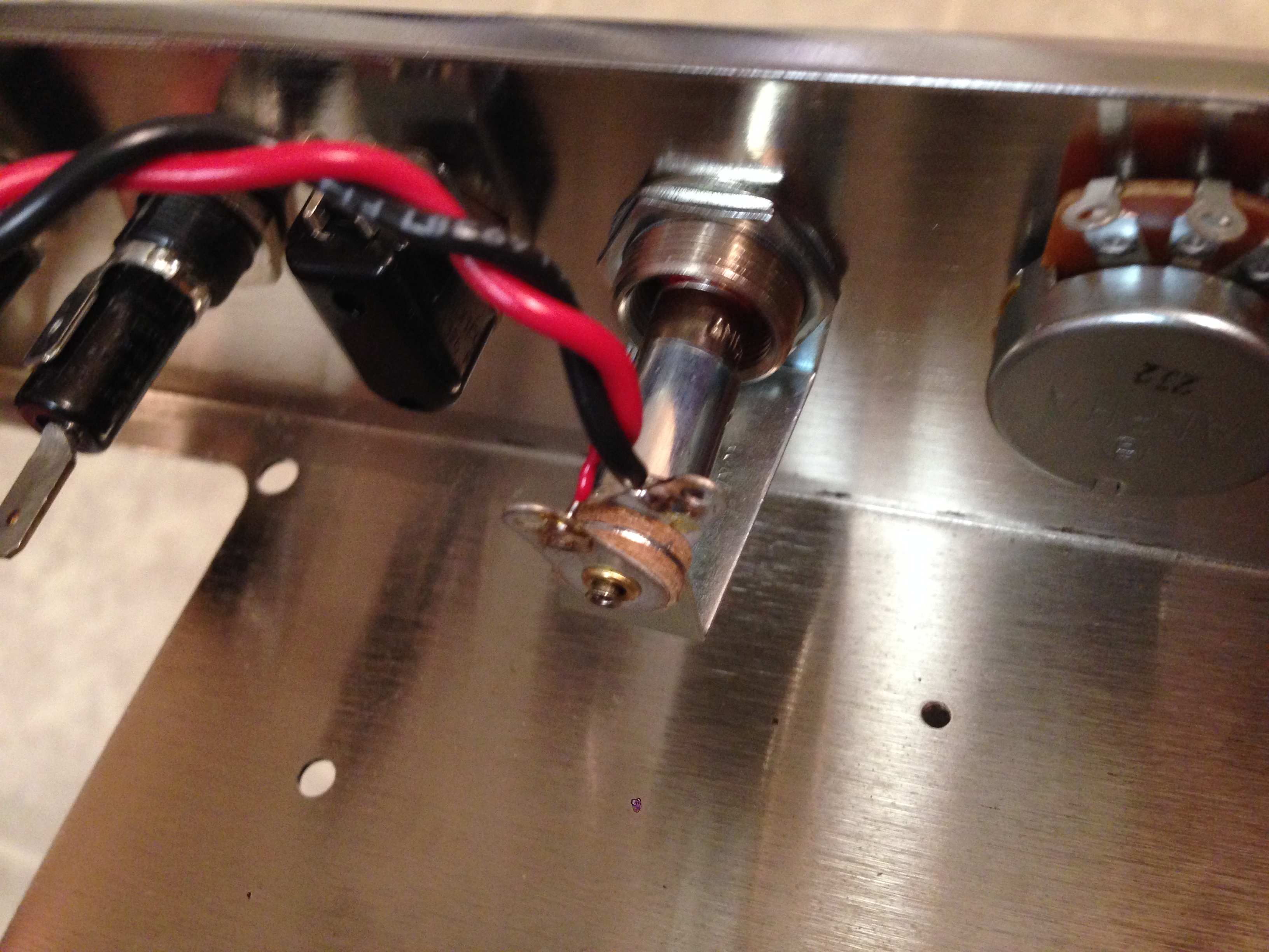

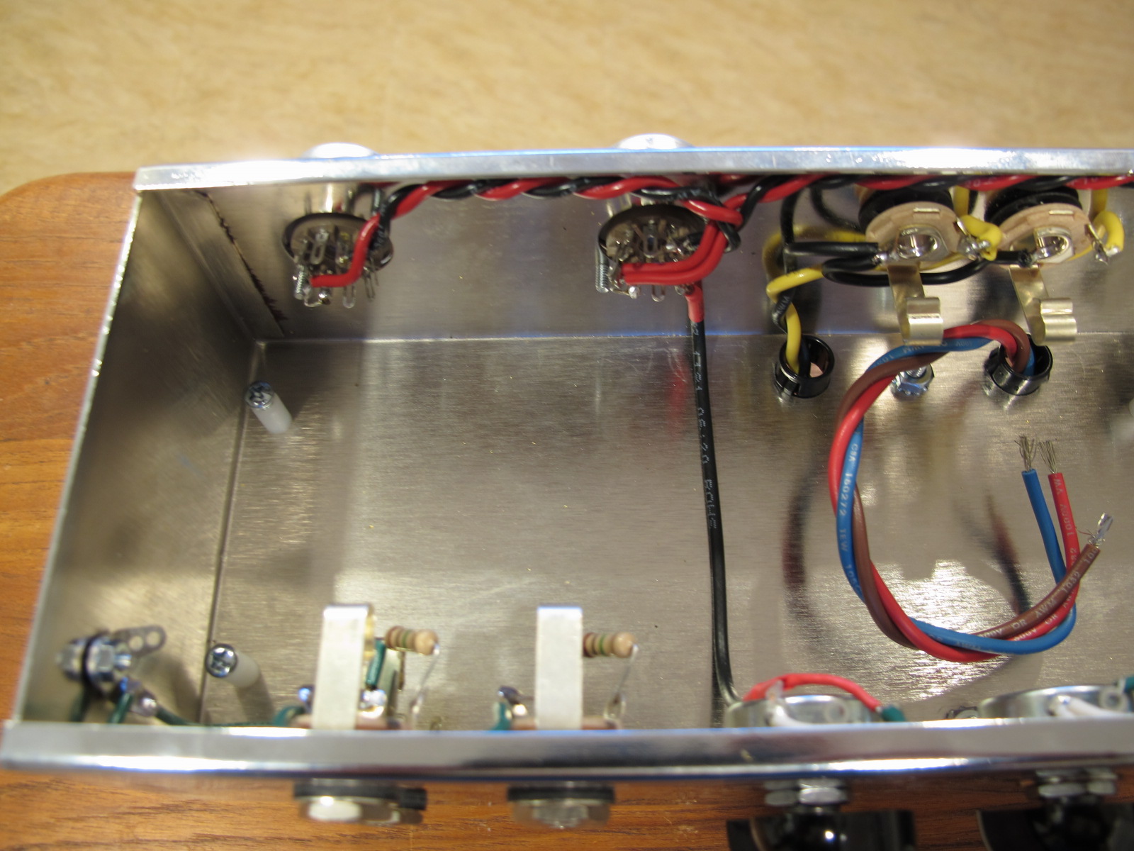

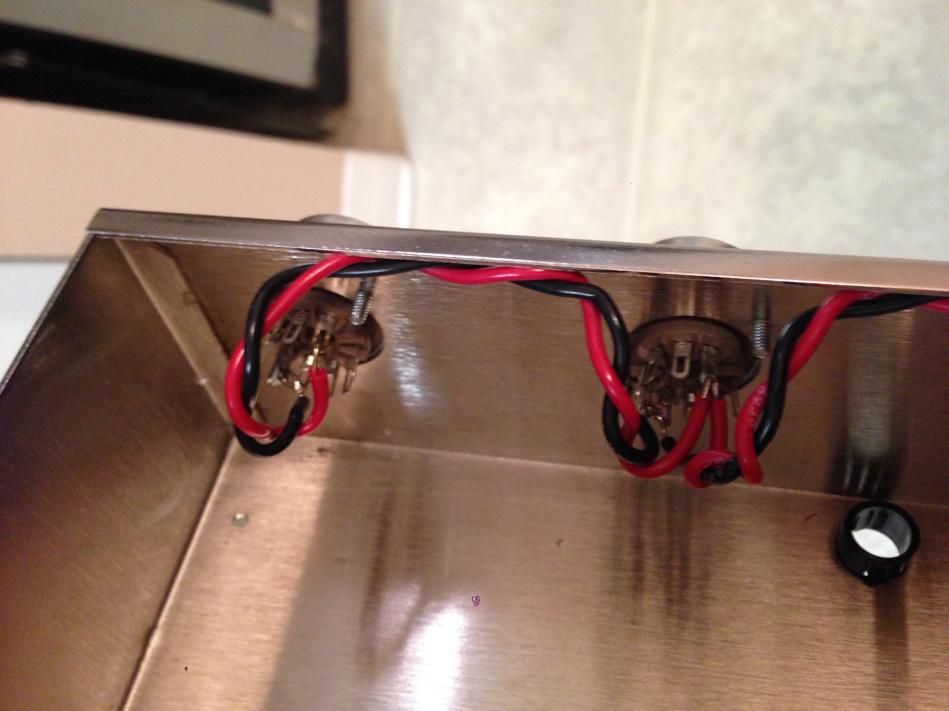

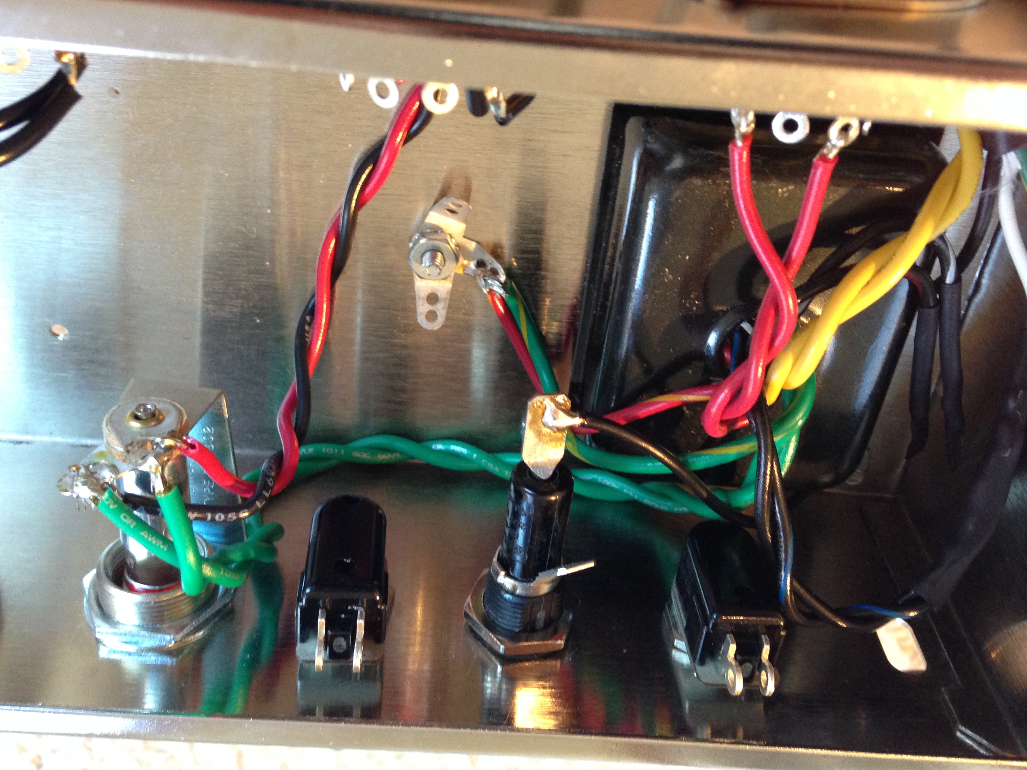

Here are some pics for the heater wiring. We actually started from the "end" at V1 and traced in to the lamp, which seems to be opposite the recommended approach in the manual (seems like it wanted us to start at the lamp and go out from there to the power tube sockets, and thence to the preamps), but I figured it might be easier going the other direction. I know, second-guessing the docs is probably not a good first step, we'll see...
Starting with the preamp sockets:
File comment: Preamp tube heaters
Working backwards through the power tubes:
File comment: Power amp tube heaters
And finally up to the lamp:
File comment: Heaters to lamp
I ran the twisted heater wires along the inside edge of the chassis, is that right? Wasn't sure where to put the run from the power tube sockets to the lamp, so I just let it hang in free space; worried that it will become a PITA to work around it later. Should I be running it along the front of the chassis (next to where the transformers will go)?

Your wiring looks really neat so far. Yes, you should tuck the heater wiring under the lip of the chassis. One thing I can suggest is you keep the heater wires close to the chassis all the way to the tube sockets rather than looping them up at the sockets as you have done. This will leave more room for the signal and high voltage wires and keep the heater wiring farther away from them.
Keeping the heater wiring close to the chassis and as far away from the other wiring as possible will keep hum to a minimum. I know Fender isn't overly concerned about this with their wiring but here's a chance to out do them!
I would also run the heater line from the pilot light to the power tubes more or less straight across but close to the chassis rather than up in the air.

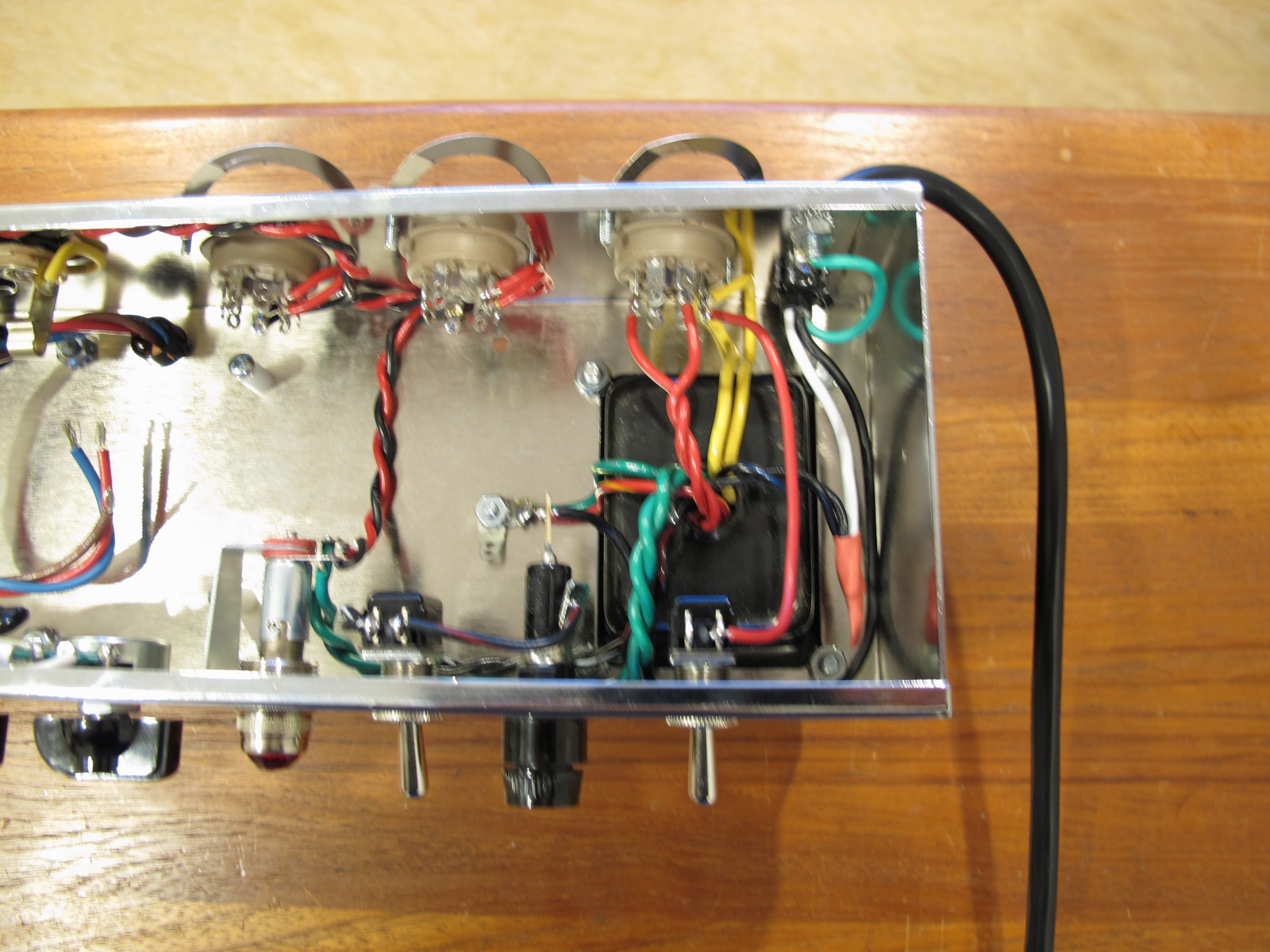

I've attached a couple of pictures of how I wired the heaters in my Tweed.

Fair enough. I was able to adjust all of them except for V2, which looks like in order to snug it down more, I'd need to re-solder. I'm (probably foolishly) going to go ahead with the rest of the build, and see if I have any hum.
Good call! Done.

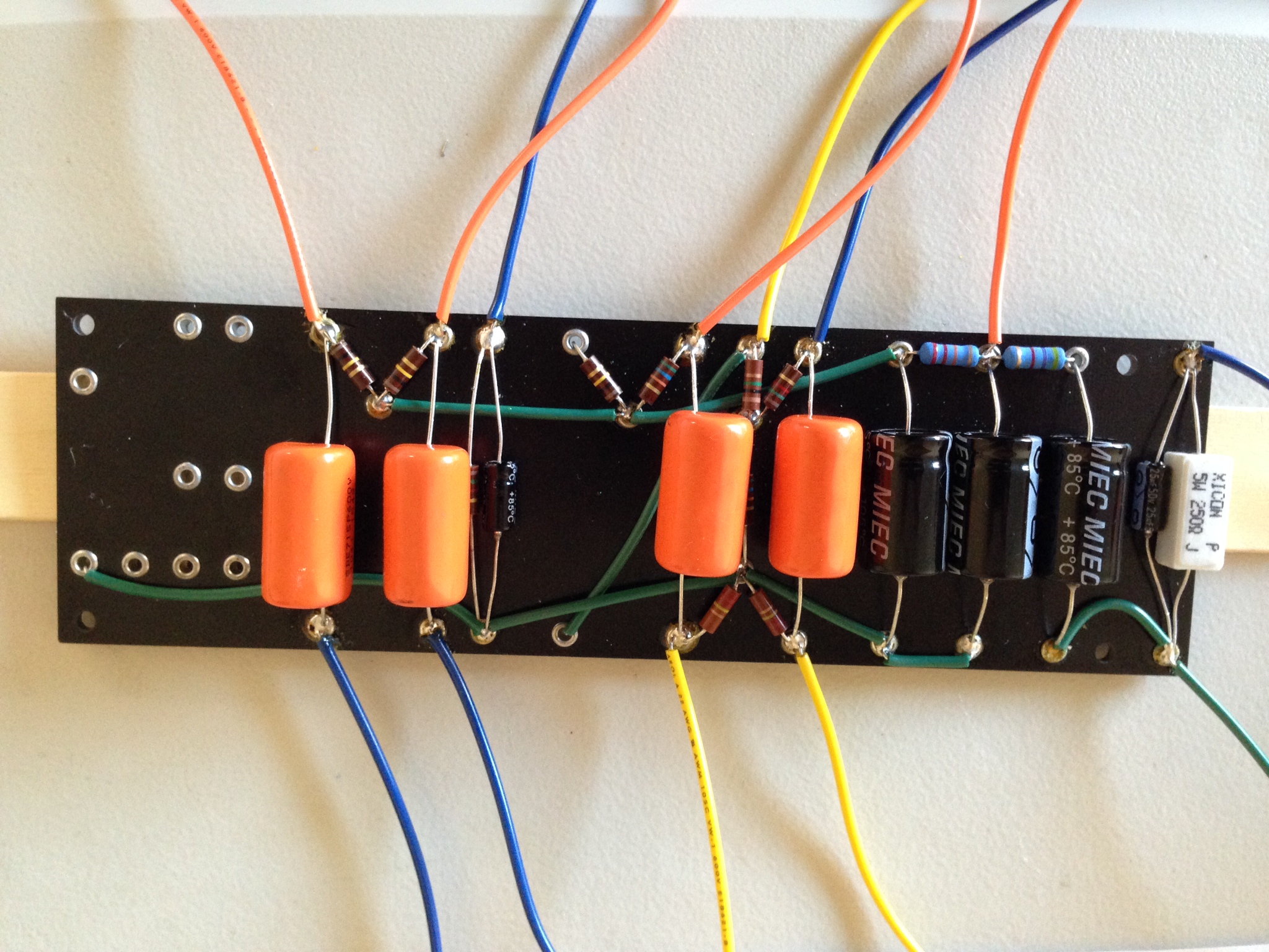

My son and I have been working steadily on the board. We have about 2/3 of the board finished now, with the notable exception of the .02µF orange drop cap (more on that in a bit). So far I'm pretty happy with the soldering we've done, except for one that I think we got too hot, as the 1 Mega-ohm resistor (which correctly measured 1M-ohm before install) now measures considerably higher at 1.48 Mega-ohms... :oops: So we may need to pull that one and get a new one and re-do that whole solder eyelet... What would cause an increase in resistance like this? Is it really possible that I "cooked" the resistor?
Anyway, here's the board as we have it so far:
File comment: Board progress...
Now, as to the .02µF cap, the reason we haven't wired that up yet is because the cap I have reads 2.22 nF. Now I know my math isn't great, but I'm pretty sure that would be .002µF, not .02µF... I double-read the layouts and the schematic, and it really does appear that it need a .02µF, so unless I'm missing something obvious, I was shipped the wrong cap... The markings on the cap show "SBE 715P 600V" on one line and "222J 0732" on the next line. If I'm reading that right, then the "222J" part means 22*100pF == 2200pF == 2.2nF == .0022µF, which is exactly what I'm reading with the multimeter, so it really does seem like I was shipped the wrong cap. When I went through and took inventory of the kit that was shipped to me against the BOM, I saw .022µF/600V, and saw the "22" and "600V" on the cap, and assumed it was right. I should have measured them all (although everything else other than the switch seems to have been right). I've notified Stephen, and hopefully he'll be patient with me...

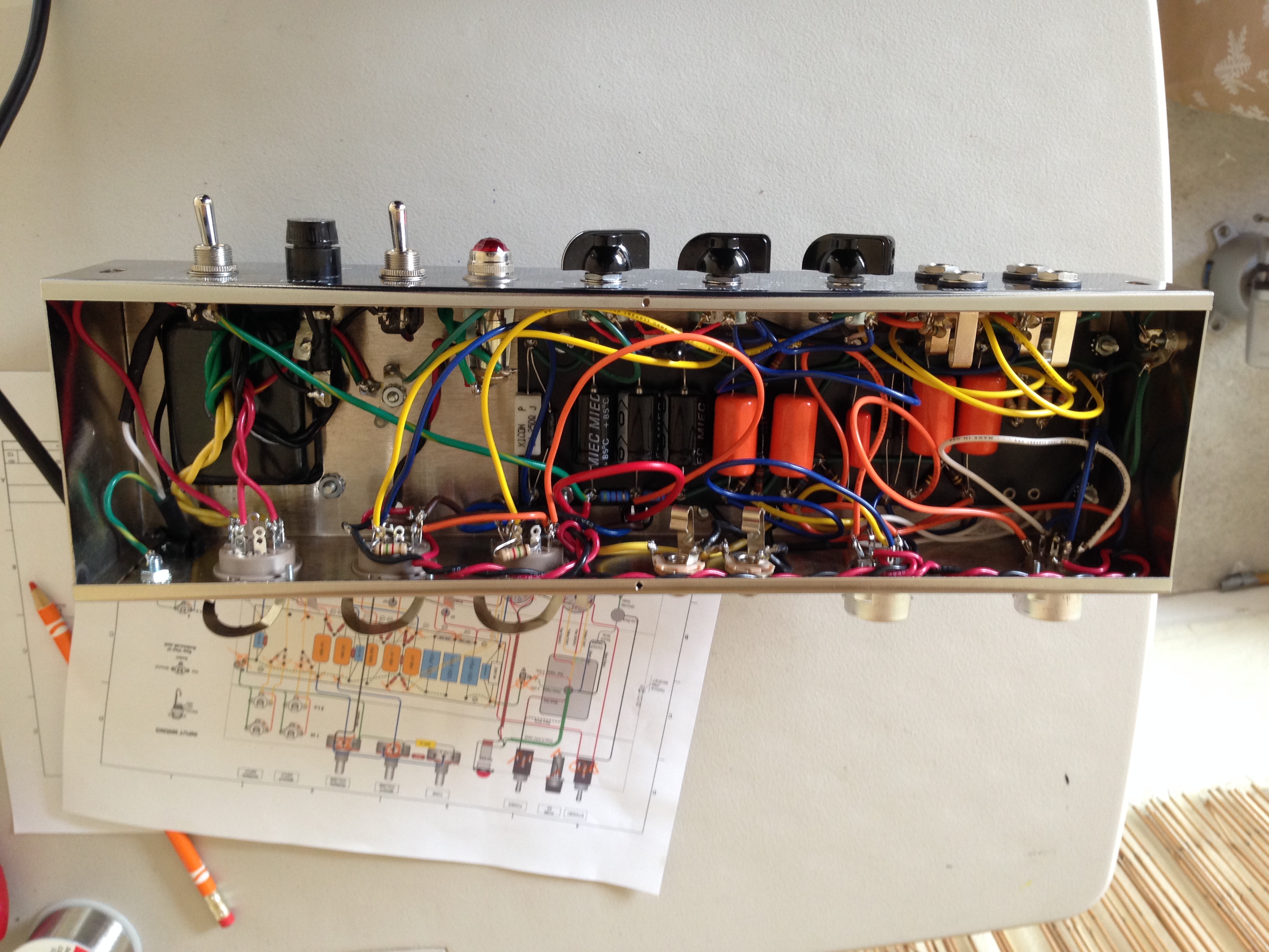

OK, completed all the soldering on the turret board, installed the board, and soldered all the wires into place, to the tubes, grounds, jacks, etc.
Doesn't look great, I know; I'm a big fan of "service loops", so there's a lot of stray wire hanging out. If this ends up being a problem, I can shorten them, but "for now" I'd rather know that pulling the board to check connections (again) will not be too bad a job.
