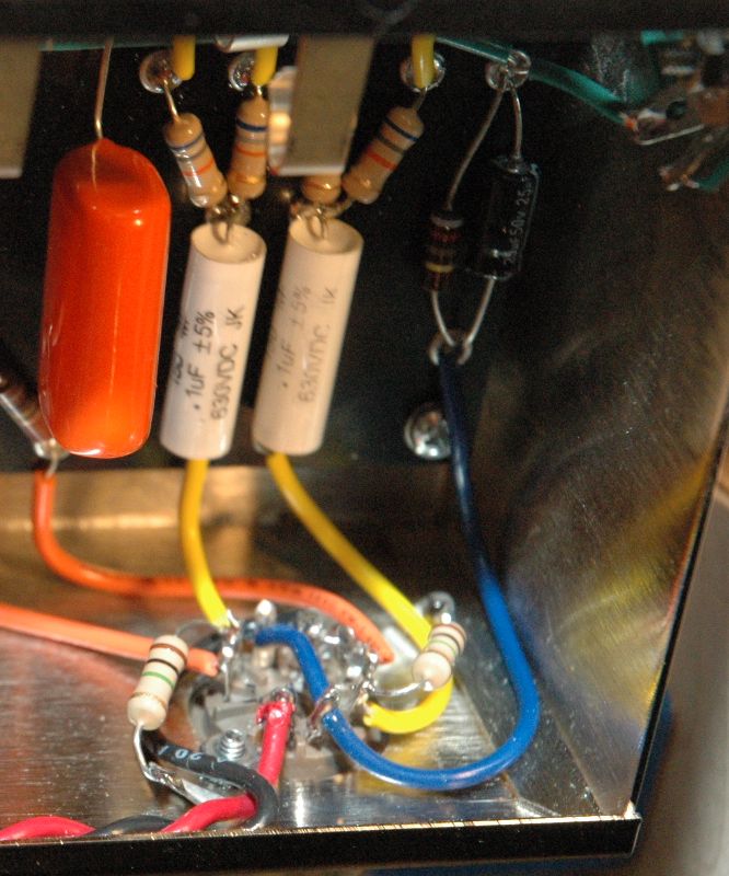

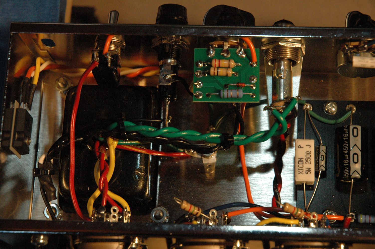

So I've got the VRM installed and it seems to be working. Plenty loud when full up and most definitely quiets down when lowered. I didn't write down the B+ voltages but I think 350-ish down to less than 100 (IIRC). My question is this - should the amp clean up at lower voltages? I would think that at lower voltages the amp would distort sooner, but I'm seeing the opposite. For example - to get the same breakup with the volume at 3-4, VRM full on I have to turn the volume up to 9-10 if the VRM is all the way down. Is that how it's supposed to work? Also the distortion at lower voltages seems a little...blatty? Hard to describe but it's not very smooth and I find myself picking a lot harder.

File comment: VRM install
File comment: Caps and 1M

Hey, I think I got it! While I was in there looking around I turned the amp off and back on, heard a bzzzap and there was the most lovely smell of electricity and fizzled dreams. :lol: I also saw some arcing on the VRM board on the B+ In terminal. I re-soldered the connection, checked all the voltages again and it's all good! The breakup level is consistent throughout the range of the VRM, and it sounds great!
