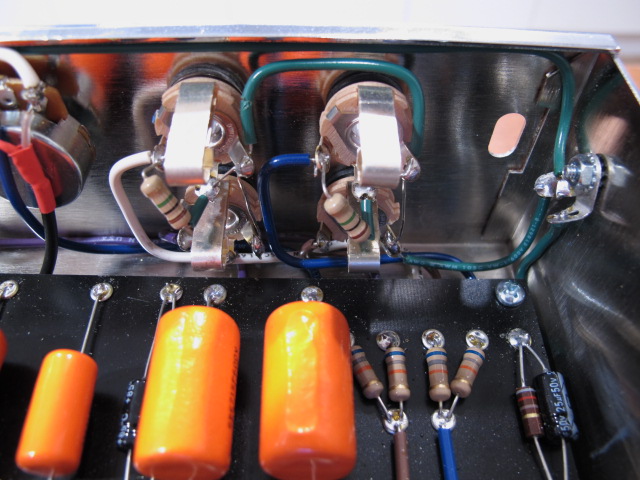

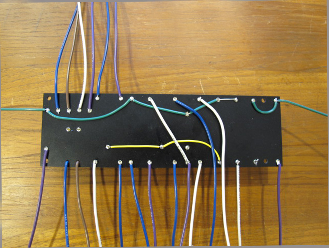

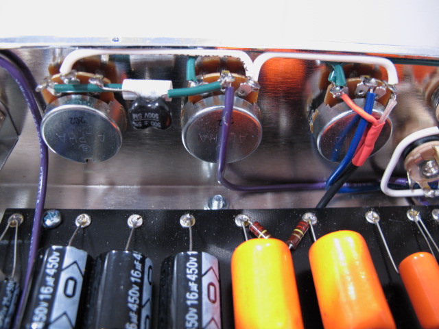

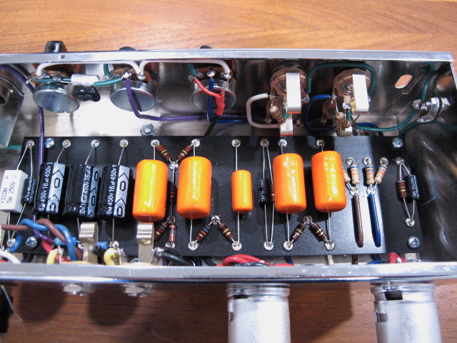

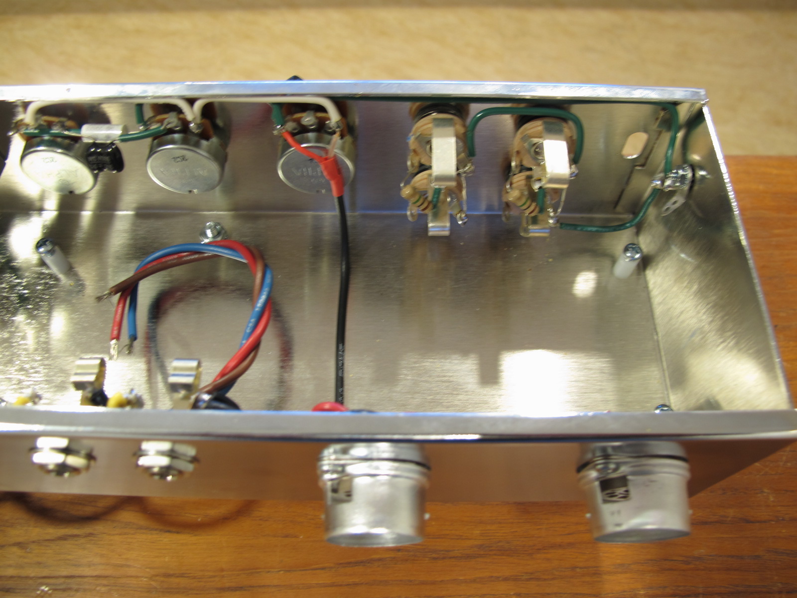

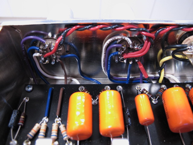

Some pictures of my Tweed are attached. The red wire at the volume control is the shield from the co-ax with heat shrink tubing on it. My wires to the 68K resistors are brown and blue at the tube socket end and brown, blue, white and purple at the input jack end.
