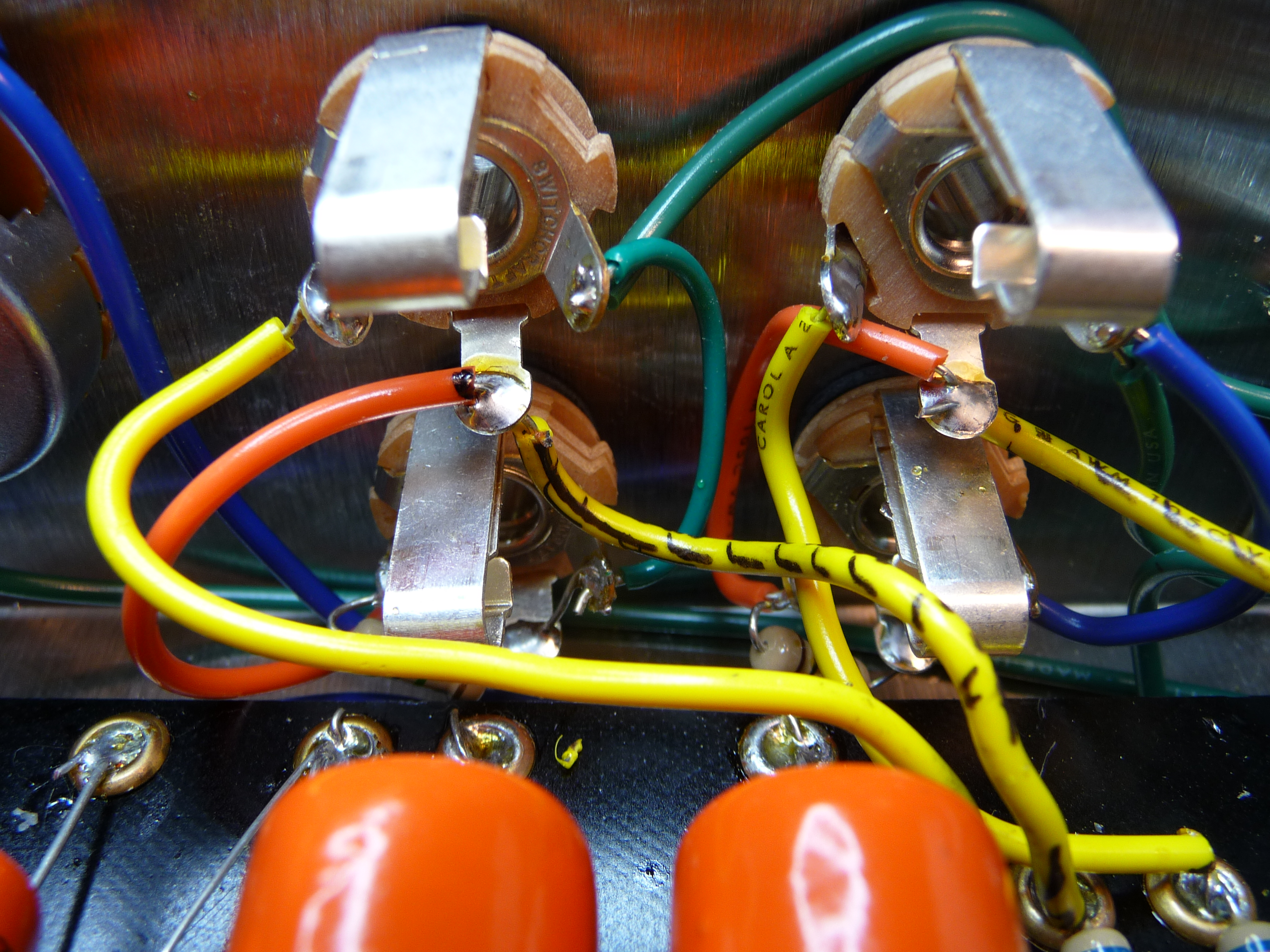

The very good news is that my Tweed rules! Pulled out the inputs and rewired them appropriately (my spatial relations abilities are not strong so I wasn't "seeing" the orientation of the inputs correctly). It is loud, sparkly, grungy. Neil comes through loud and clear, as does Hotel California. And the cleans are also quite good and hold for plenty of decibels. The amp is MUCH quieter than my Fender Pro Junior, I dare say quitter than Deluxe Reverb. Guess who's got some amps for sale!?
You were both right about that crazy input wiring. Strange things happened...none of them good. Just a good thing that my error wasn't in a "blow everything up" part of the amp. I've attached a picture of the finished product. Not "Olivia" quality, I must admit. I've taken lots of pictures of stages along the way. If anyone's interested, let me know. The pictures I found in the forum and sent to me by forum members were very helpful. The colour really helps.

Glad to hear your amp is working! It's good that you found the trouble and fixed it, too. That's extra added experience you wouldn't get if it worked the first time.
Your pictures look good. Having it work reliably and sounding great is the important thing. We can all learn a thing or two from Olivia, though. Even I had to go back and rewire a couple of things in my Tweed after seeing her pictures, and I've been building electronic projects for over 40 years.
