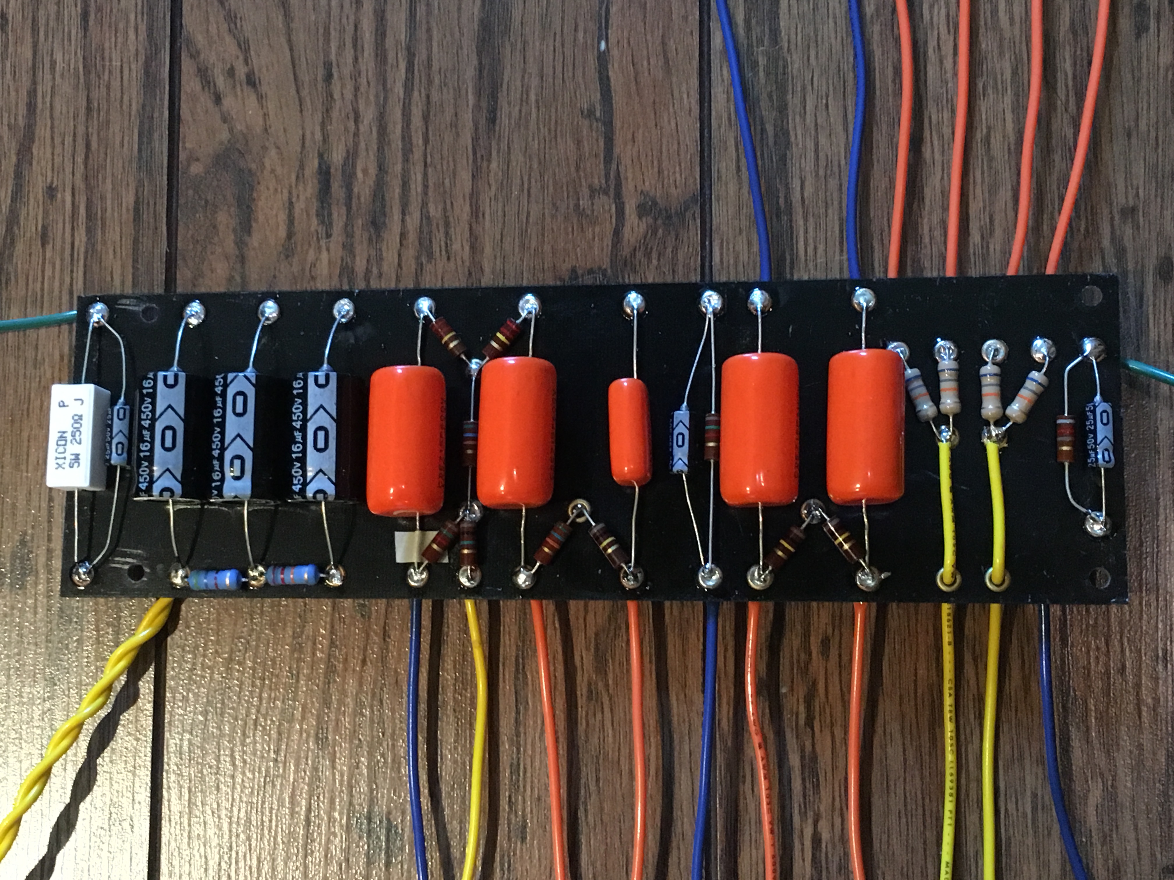

Well, so far so good, I think...
If you see any glaring errors, please let me know!

PostPosted: Sun Jun 25, 2017 4:33 pm
Joined: Thu Jun 22, 2017 8:49 am
I finished it up today, but sadly when I fired it up........nothing. Tubes all get warm/hot, pilot light is on.
However, when I take it off standby, I do hear a slight hum coming from my speaker cab, but no signal is going through, guitar or otherwise.
In all likelihood I'll take it to my amp tech tomorrow, as I lack the ability to diagnose any problems. Hopefully nothing too severe....lol.

PostPosted: Mon Jun 26, 2017 1:42 am
The build looks good!
But yes, there is supposed to be a shielded cable running from the top of the Normal volume control to pin 2 of V2. If that's missing, no wonder you don't have sound. The fact that you hear a bit of hum is a good sign that most of the amp is working, though.
You could temporarily use a piece of regular wire for the connection just to test the amp. You might get more hum with regular wire, but the amp should work. The shield on the shielded cable only connects to ground at the volume control end, so it's not necessary to pass the signal. It's just there to shield the inner conductor that runs from the pot to the tube.
If a piece of shielded cable didn't come with the kit, Stephen will send you some. But you could also cut up a regular stereo patch cord to get a piece.

PostPosted: Mon Jun 26, 2017 8:01 am
So early this morning, I ran a wire from the Normal Volume pot to pin-2 of v2 and the amp works like a charm, and sounds great! I played it using a LP through a 1x12 ext-cabinet with an old V30 and was enjoying every minute.
I turned on the amp a few minutes after I soldered the wire, and the amp was a bit noisy at idle, but when I shut my soldering-station off (plugged into the same circuit as the amp) the noise completely disappeared, and, all things considered, it's very quiet, and comparable to any other tube amp I've owned. That being said, how much will the coaxial-cable improve the noise levels? I'm not looking for a super quiet-recording jazz amp, but rather a traditional tweed deluxe. I don't want any "noise improvements" to make the amp too polite-sounding.
Here's a pic of the blue-wire, suspended across the top of the board (for easy removal).

PostPosted: Mon Jun 26, 2017 10:38 am
Fender didn't go overboard with some of the things that could be done to reduce noise, like neat heater wiring, star grounding and using shielded cable. Trinity's 5E3 layout does, however. Sounds like running that wire "out in space" as you have done is OK as far as noise goes. But if you ran it under the board the way the layout shows, without it being shielded, it could be a different story.
Glad you got the amp working. If you are happy with the way it sounds just leave the wire as it is. It's in a sensitive part of the circuit, though, and I would replace it with a shielded one. It won't change the tone of the amp. It will just make it more immune to picking up stray hum and noise which is a good thing.

PostPosted: Mon Jun 26, 2017 4:32 pm
Too bad you don't have nuts to secure the board. You should be able to get some at your local hardware store. They are quite common.
Thanks for your advice, Mitch, much appreciated.
I finished up the amp this morning, after getting some nuts to secure the chassis. Sounds great! Very impressed with the Trinity Amp Kit. Hopefully, a Marshall kit will be in the near future!
I ended-up snaking that wire under the board (before you said bad idea...lol) but put the shrink-tube around it...I don't notice anymore noise that when I had the blue-wire suspended above the board. Unlikely that I'll actually gig this amp, as it will lack the headroom, but maybe it would be noisier in some of the venues we play at with poor electric and lighting...I can always change it. I would like to get the coaxial-cable sent to me, in the event it's needed in the future though. I'll try and contact Stephen. Thanks again, Mitch. :thumbsup:
