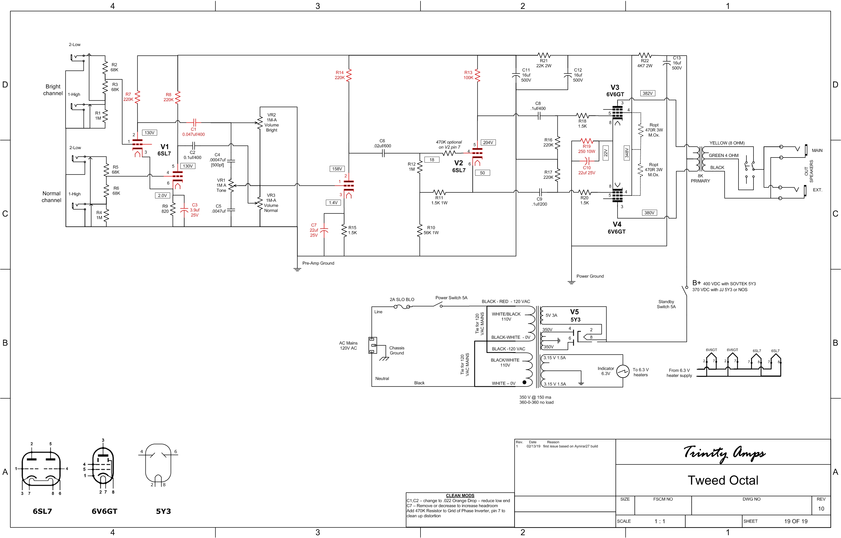

Let me know all the tweaks and I'll create a schematic and layour for it.

I did very little changes on the board, but did change some values around a bit. The ones I settled on for that clip were
Load Resistors: (similar to earlier octal models) to give the 6sl7's some more swing and overdive
R7, R8 and R14 bumped to 220k
R13 to 100k
Cathode bypass caps lowered these a little bit to tighten things up early on.
C3 3.9uf
C7 22uf
C10 22uf
C2 coupling cap on normal channel down to .047uf (may try this on bright channel instead) I'd like to have one channel better suited for my Les paul and another for my strat with a higher cap/less filtering
I also bumped the R19 250R resistor to 10 watts, but only because I like the look of the big wire wound resistors
another change I made was replacing the 1MEG grid leak resistor with a 1MEG pot, as a make shift pre PI master volume/farting out control, but I found with the tweaks I made some of the other parts of the amp, I preferred the pot to be totally open, so it is acting as if the resistor was in anyways. to make room for the pot, I removed the low bright input and corresponding 68k grid stopper.
in the clip you can see me reach for a control a couple times. each time is me turning up that 1 meg pot a little bit more

With the 6SL7s, and the other changes, could you do a voltage chart?
On the TripTop, with 6SL7s, we use 220K and 470K plate resistors.
What brand tubes did you use?
I will start a schematic.

First schematic for review. put coupling cap in v1 to bright channel.
need to fill in all DC voltages in boxes
