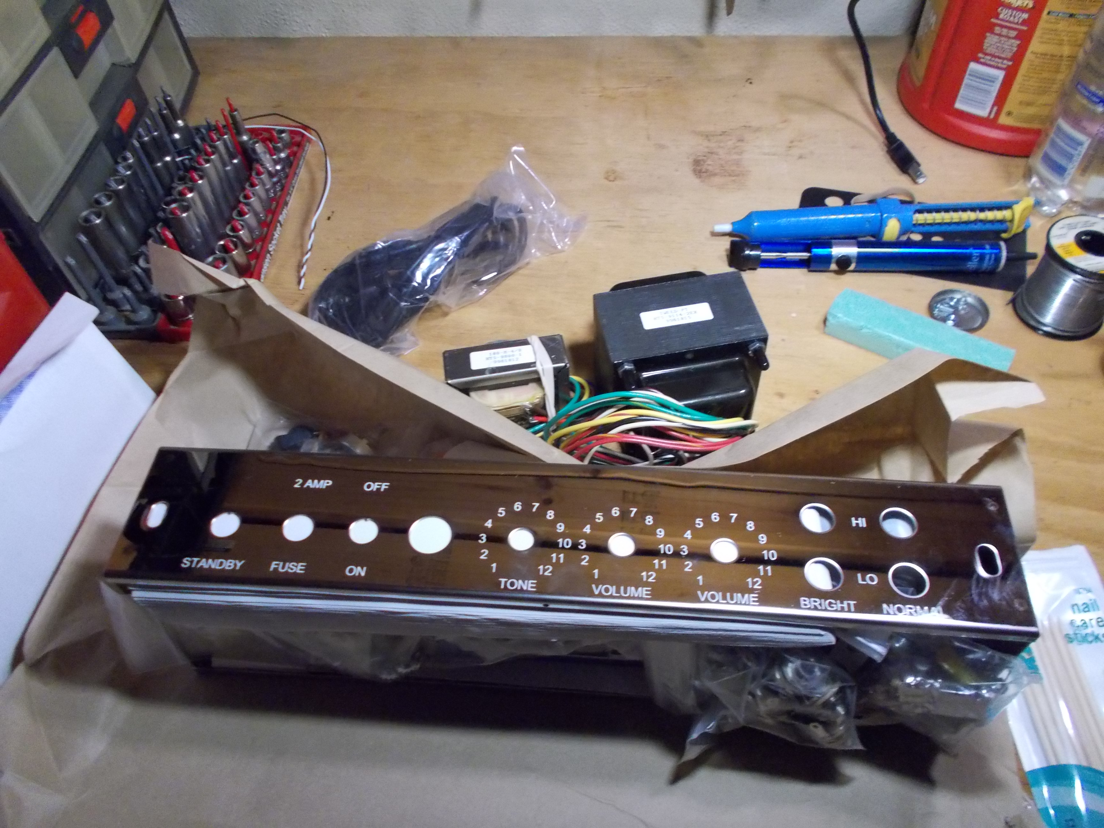

PostPosted: Sat Nov 21, 2020 12:19 am
The mounting holes on the front (control face) of the chassis are oblong which allow movement back and forth. You can get an idea if you look at picture of the Tramp kit on the website (the Tweed pic apparently shows an older version of the Tweed chassis). Based on what you're saying, you've ordered the kit but haven't received it yet. Pretty sure you'll figure out how it works when you get the kit.
