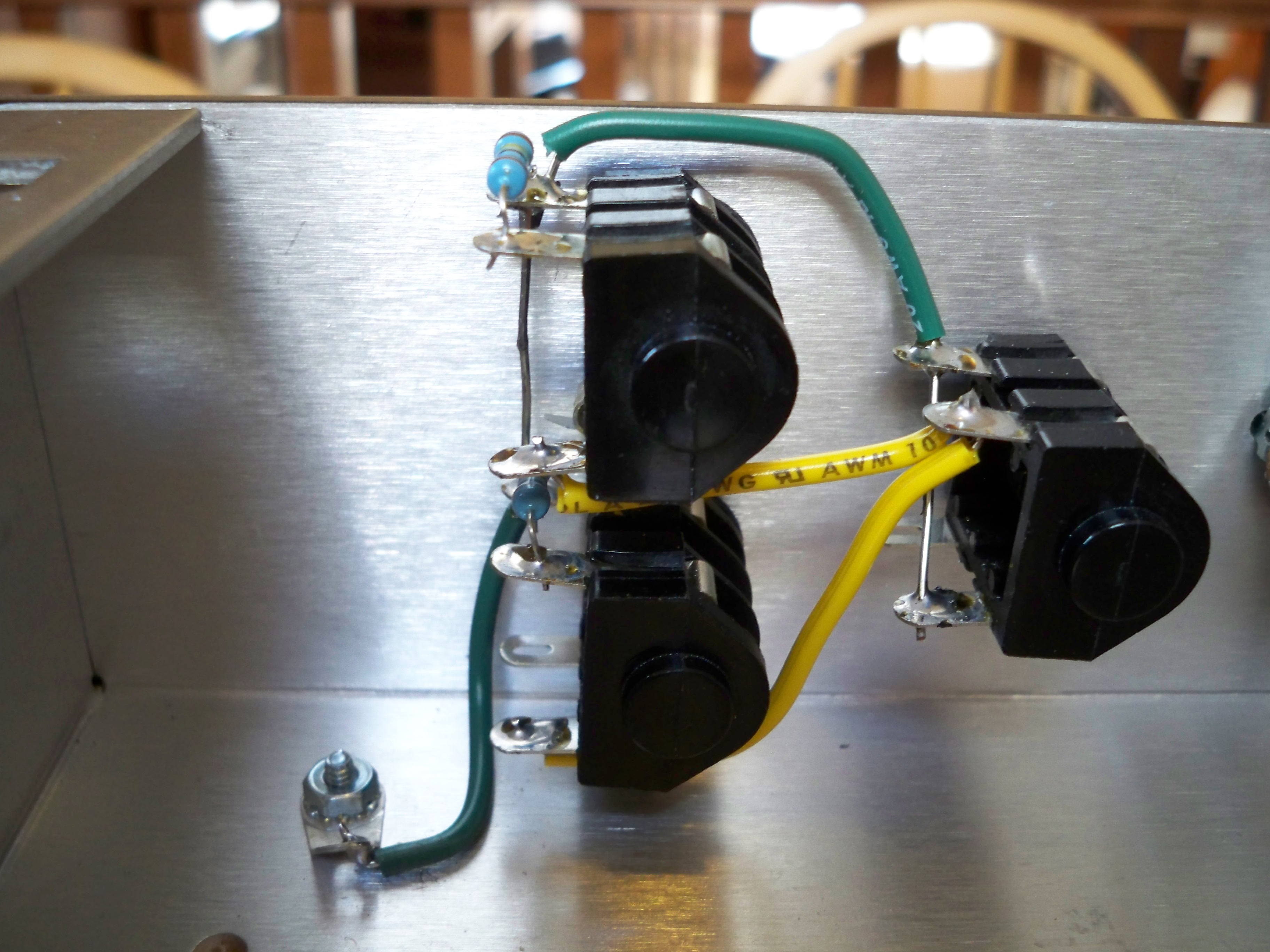

:D So far so good I think. Probably spent 12 hours so far. Time do do a layout and connection check before starting on the board.

:oops: Sorry for the lack of pics. I have been unsuccessful in uploading them. Exceeded the quota or something???
Figured people are looking at my lovely input jacks and thinking, 12 hours just to do that? What a dope. :rol
Hopefully I can post some more soon.

Roadstar wrote:
:oops:Figured people are looking at my lovely input jacks and thinking, 12 hours just to do that? What a dope. :rol
Yeah, I was thinking "lovely job...but 12 hours?" :rol
