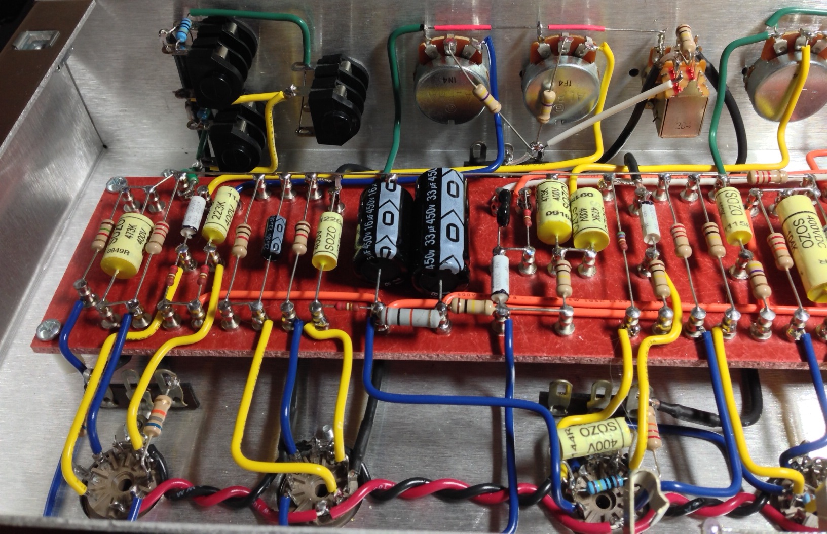

After unexpectedly moving I have finally found some time to start on the build. This is my first amp build so if you see anything goofy please let me know. I have built a couple pedals and am a profession luthier who has been looking to build an amp for the past 5 years. I'm pretty good with a soldiering iron and can get pretty anal on details.
Here is my current progress. I have all the tube sockets wired up and all the caps and resistors in. I'm pretty happy with how it's coming. Thanks a lot to zaphod for his build picks they have been very helpful.
I'll have some more time on Thursday to work on it. I can't wait.

I can't comment on how it goes together but I can say that is a very nice and professional looking build.
I'm about to embark on my 18 watt build and I sure hope it turns out as neat as yours is.
How many hours do you have in the build so far?

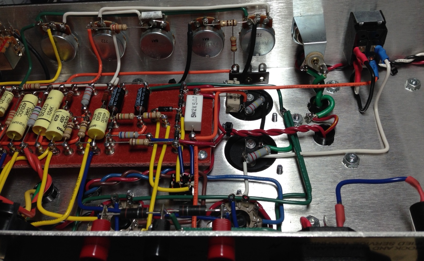

So I just finished the power up steps and it lives!!!! It sounds awesome. The cleans are so dynamic and rich. I love it!!! Only thing is the presence knob doesnt's seem to do any thing or maybe it's very subtle. I will get some pictures up soon. The other issue when you turn the Treble knob all the way up it cuts out. I figure it's just the pot is damaged or something.
Here are the numbers
V1-P1 144 P2 0 P3 1.157 P6 122 P7 0 P8 .95
V2-P1 169 P2 -15 P3 1.26 P6 98 P7 -17 P8 .749
V3-P1 263 P2 63 P3 68 P6 183 P7 0 P8 1.46
V4-P1 257 P2 68 P3 71 P6 253 P7 60 P8 71
V5-P1 0 P3 438 P4 403 P5 -42 P5 -42 P8 24
V6-P1 0 P3 437 P4 406 P5 -42 P5 -42 P8 20
Bias for tp1-19.6 and tp2 22 With 6v6's in it.
V2 pin 2 and 7 are negative not quite sure what that means.
Also on v5 and v6 pin8 are both in the twenties.
Any help would be greatly appreciated.

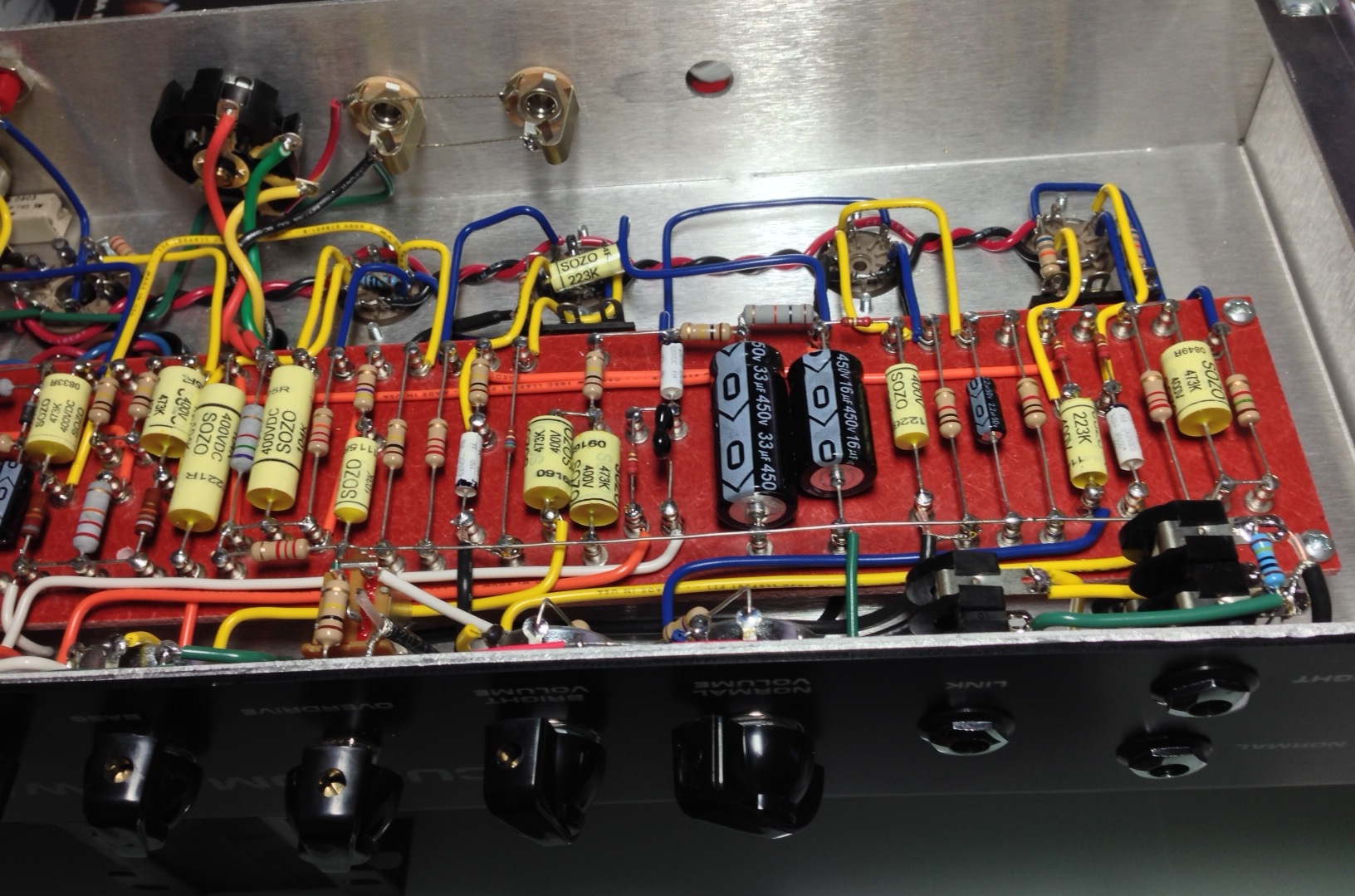

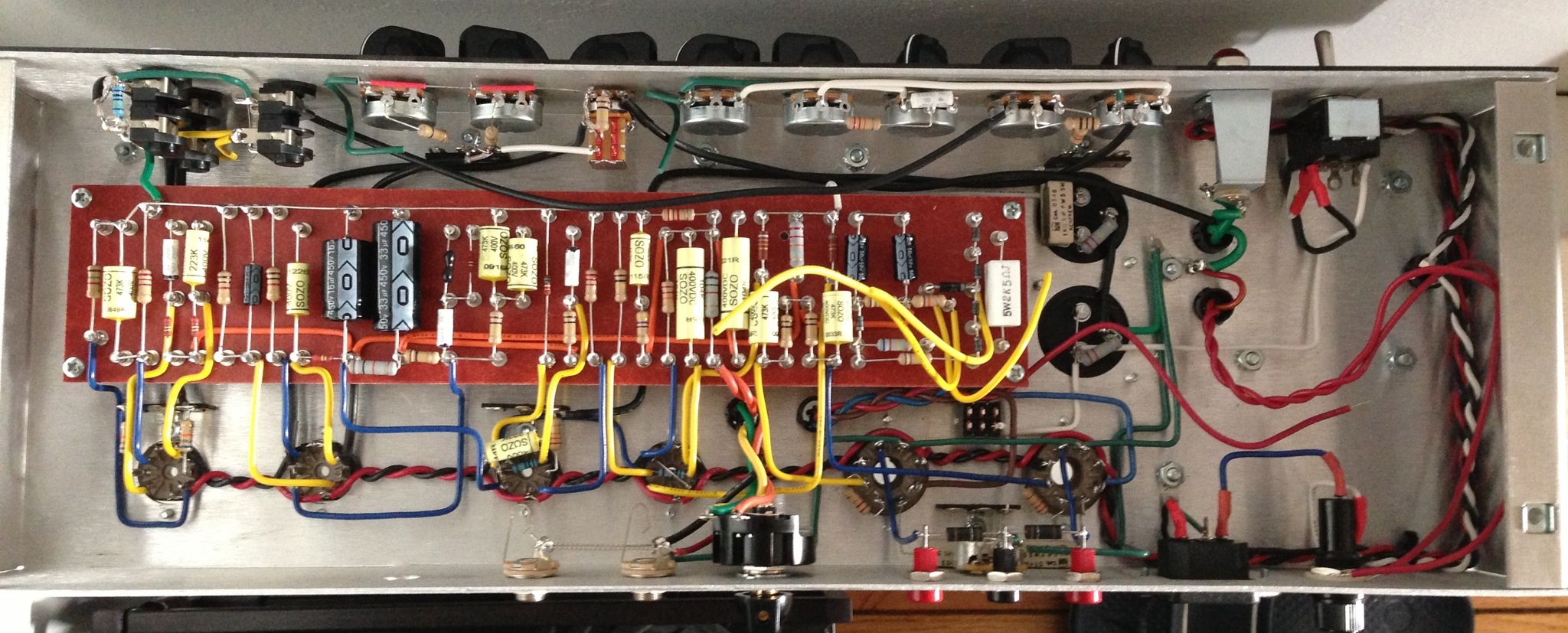

Quick update:
For the bias switch I have it switched towards the Power trannys that is the right position for 6v6's?
No problems at all with the overdrive it sounds great!!!
I retouched the connections for the presence control and I think it's working it's just subtle.

 Post subject: Re: New Triwatt build
PostPosted: Wed Oct 16, 2013 6:44 pm
Joined: Wed May 22, 2013 1:19 am
Did some more poking around and answered my own question. My bias switch was set for kt66's. With it switched the other way the bias range is 13-27ma. The V2 pin2 is .5 but the pin7 is still -12.5. Every thing looks good and seems to check out ok. Also for V5 and V6 pin8 are still high at 23.3 and 19.9.

PostPosted: Thu Oct 17, 2013 11:20 pm
Pins two and seven in 12AX7s typically have no DC component excepting the phase inverter. In this case everything seems to be fine and normal in your Amp.
I don't really know why you're getting -12 V on pin seven that's pretty strange because of feeding from the positive plate voltage. Could just be the measurement.
The presence control is subtle but check if it is wired correctly.
