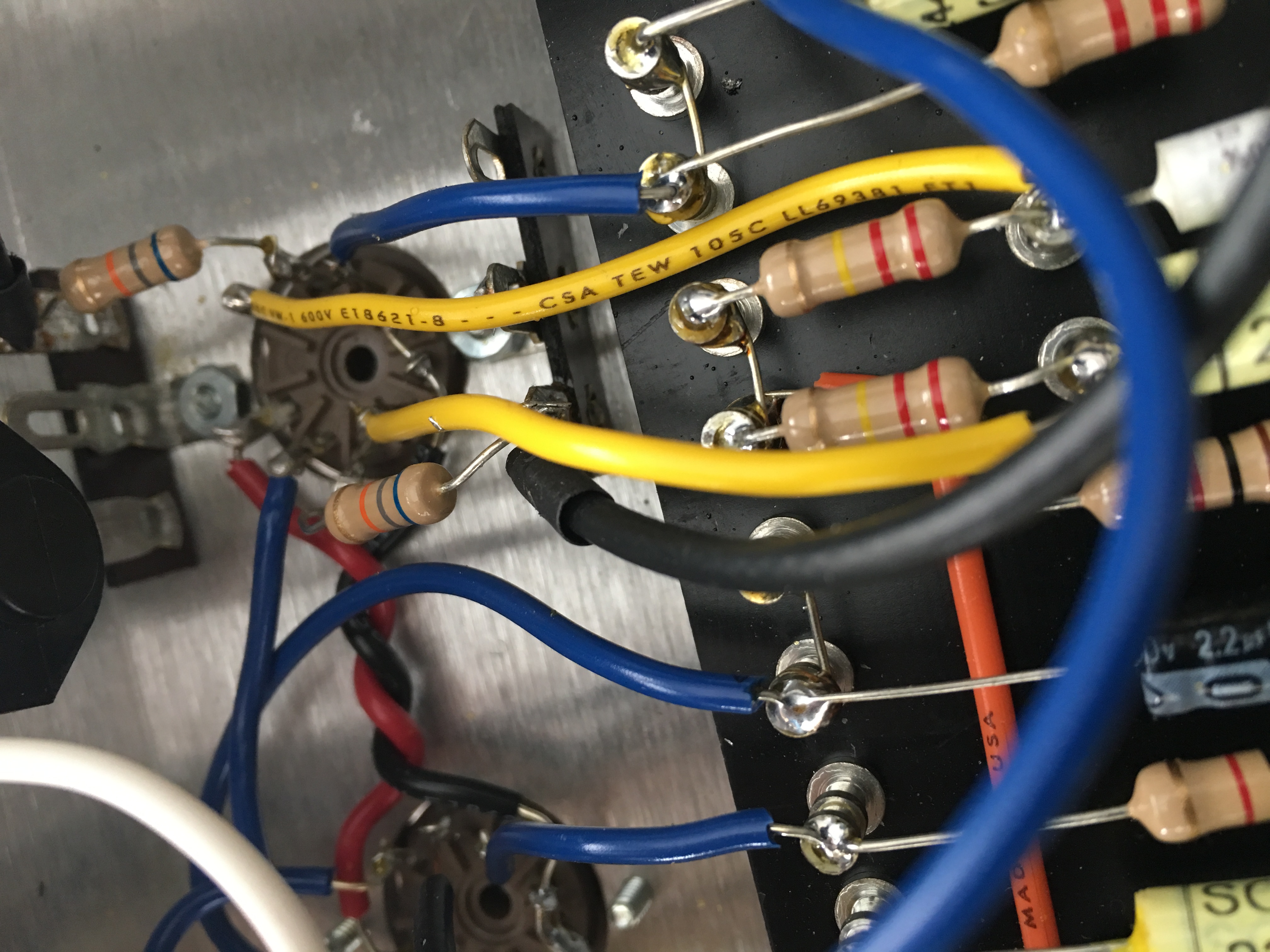

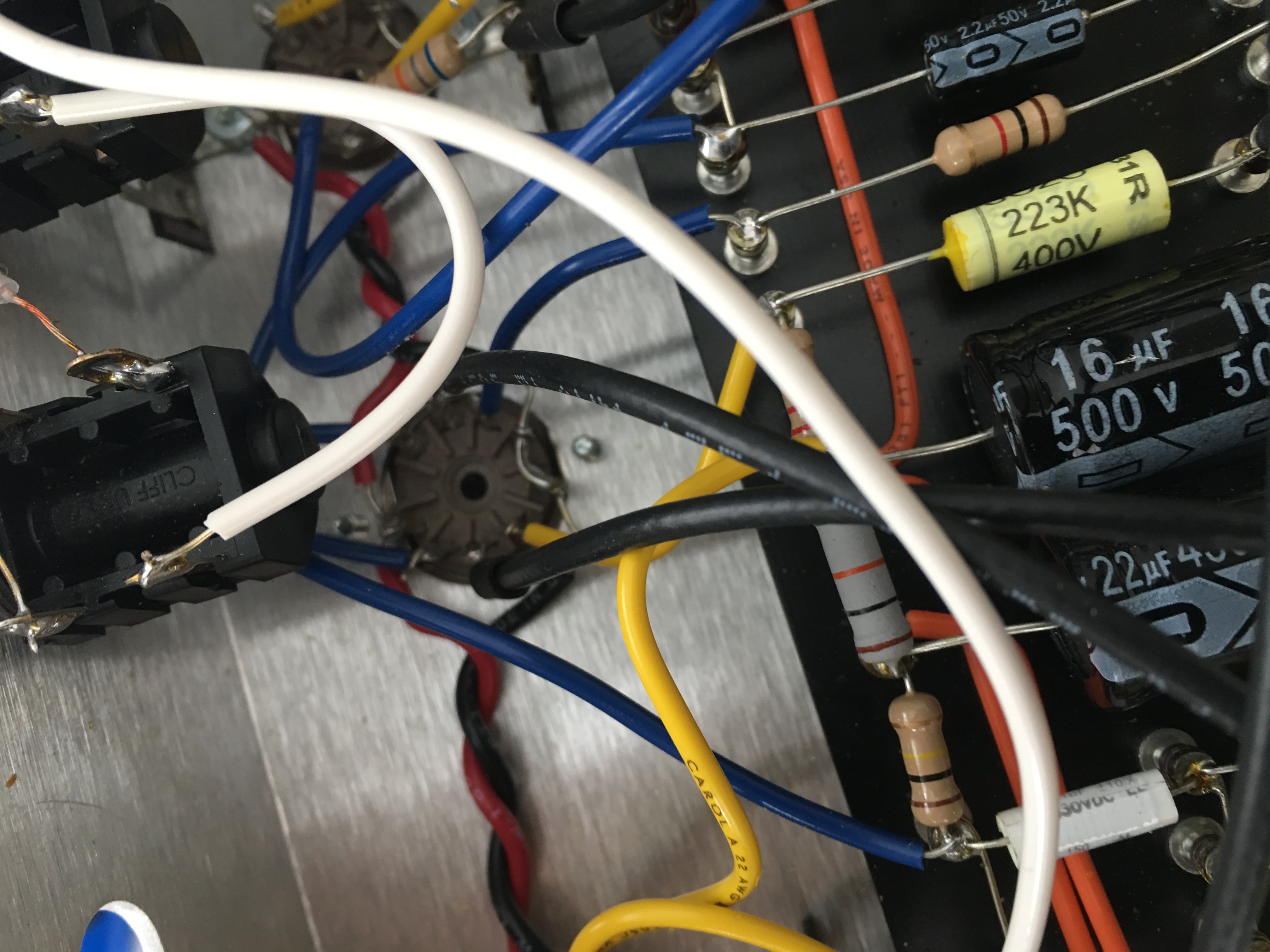

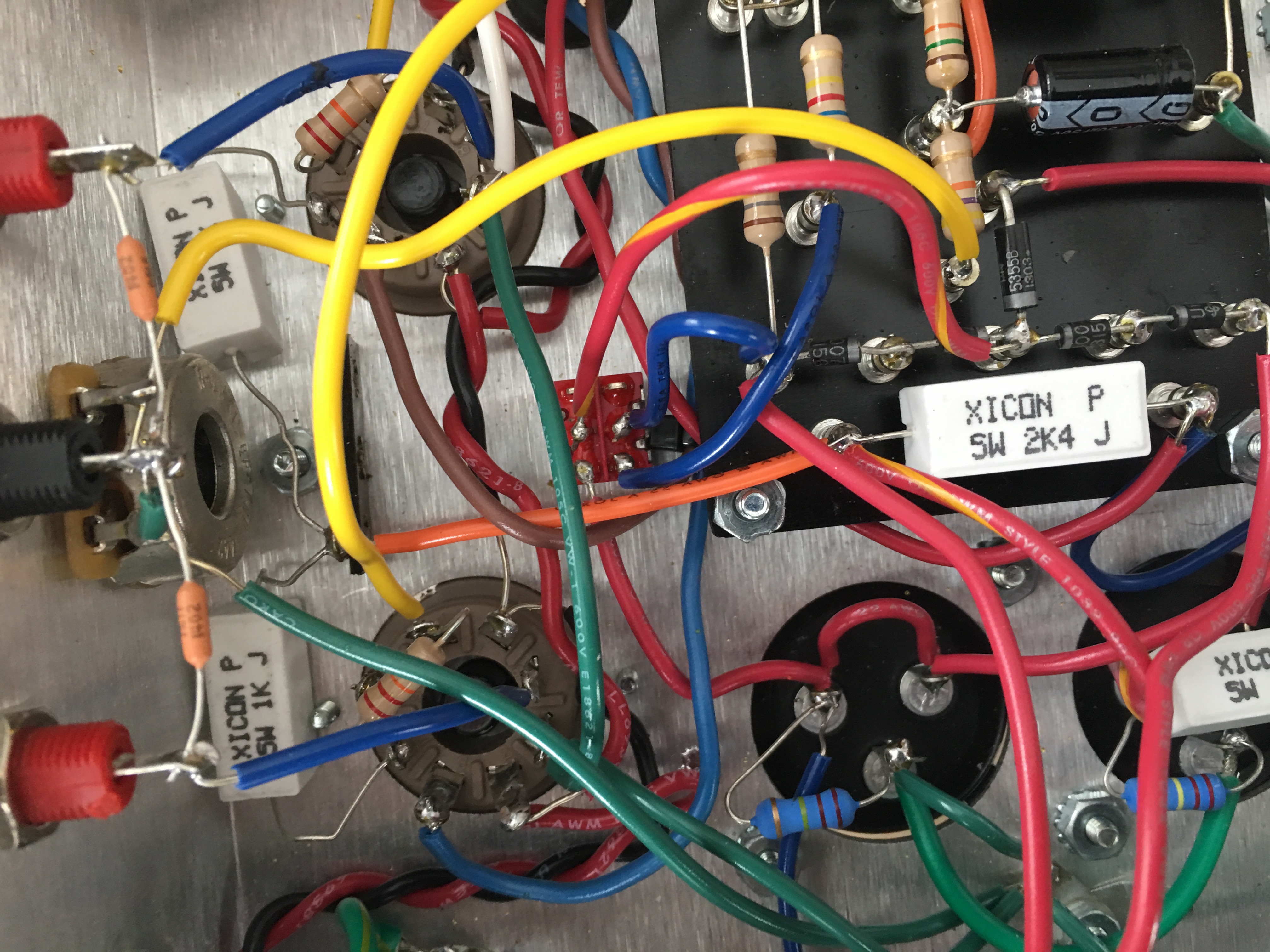

Good day here's some picture... sorry for the delay... I had someone triple check all the amps vs layout and schematic.
(Got the over drive problem solved... I had conected the wire from (V2 Pin2) to the OD jack on the same leg as the resistor...)
BUT having this made, I've try to connect the bridge (I had to use the blue wire over all the other connection...) but same result.
So it's now off again... and I can get pretty good sound out of my amp...(actually I love it... but I'm concern with not having the Bridge between pin 3 & 8 in V4)
Oh and same reading give or take 0.5 to 1 V... my 411 on V4 pin 6 is now 409 (2V is my biggest variation)
(Bought my kit in october 2016 so I have layout rev:18 & sche Rev:11)
(so my wires from from V2 to V3 are inverted... switch them and no differences they are now back as my layout rev:18)
File comment: Close up of V4

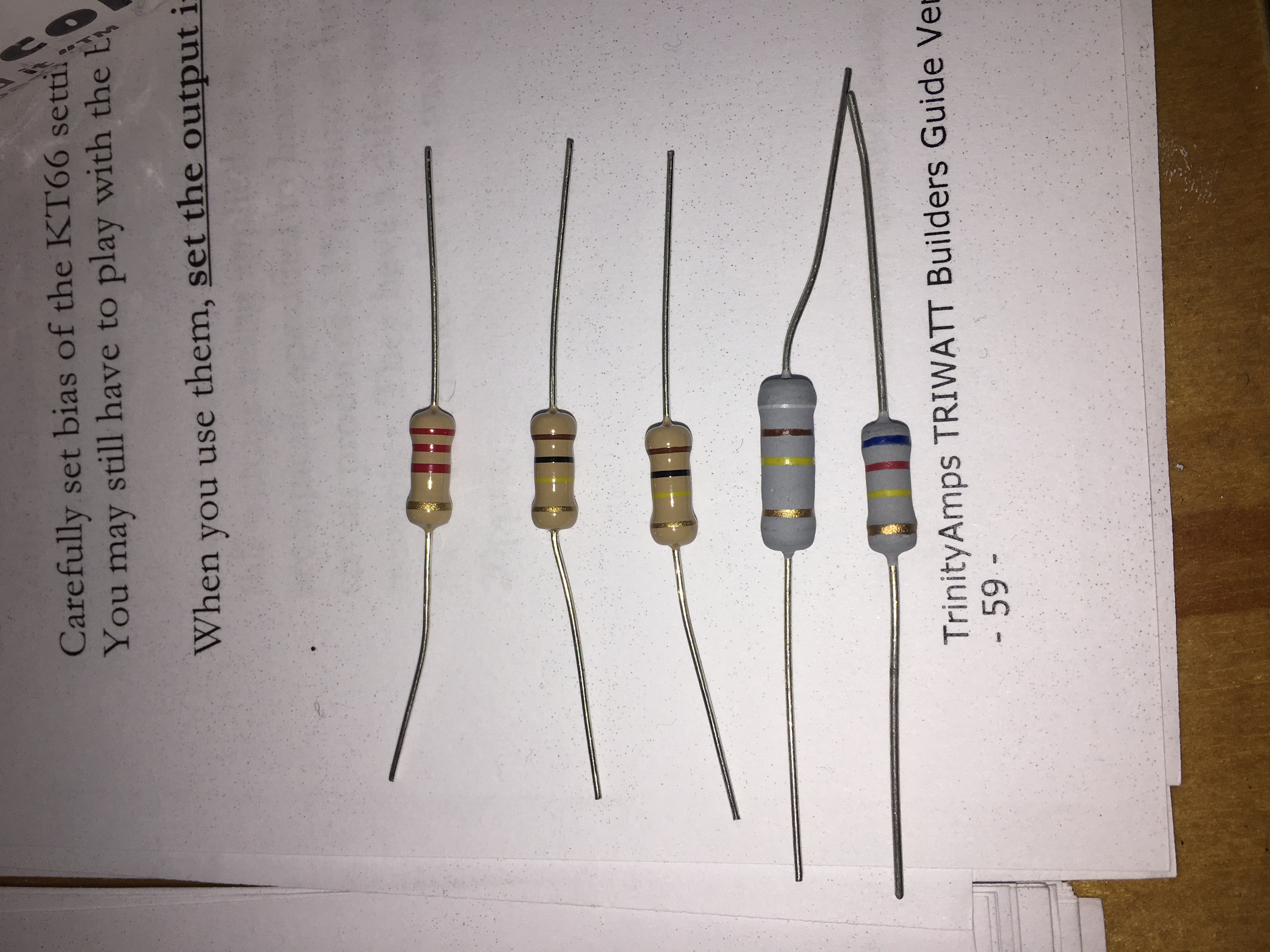

File comment: extra parts... can't find where they go...
PostPosted: Sun Jan 08, 2017 7:09 pm
V4 is the phase inverter that feeds signals to the power tubes. The connection between pins 3 and 8 is necessary for proper operation of the phase inverter. Put it back in place. The amp can't work at full power unless the phase inverter is working properly so both output tubes can drive the transformer.
