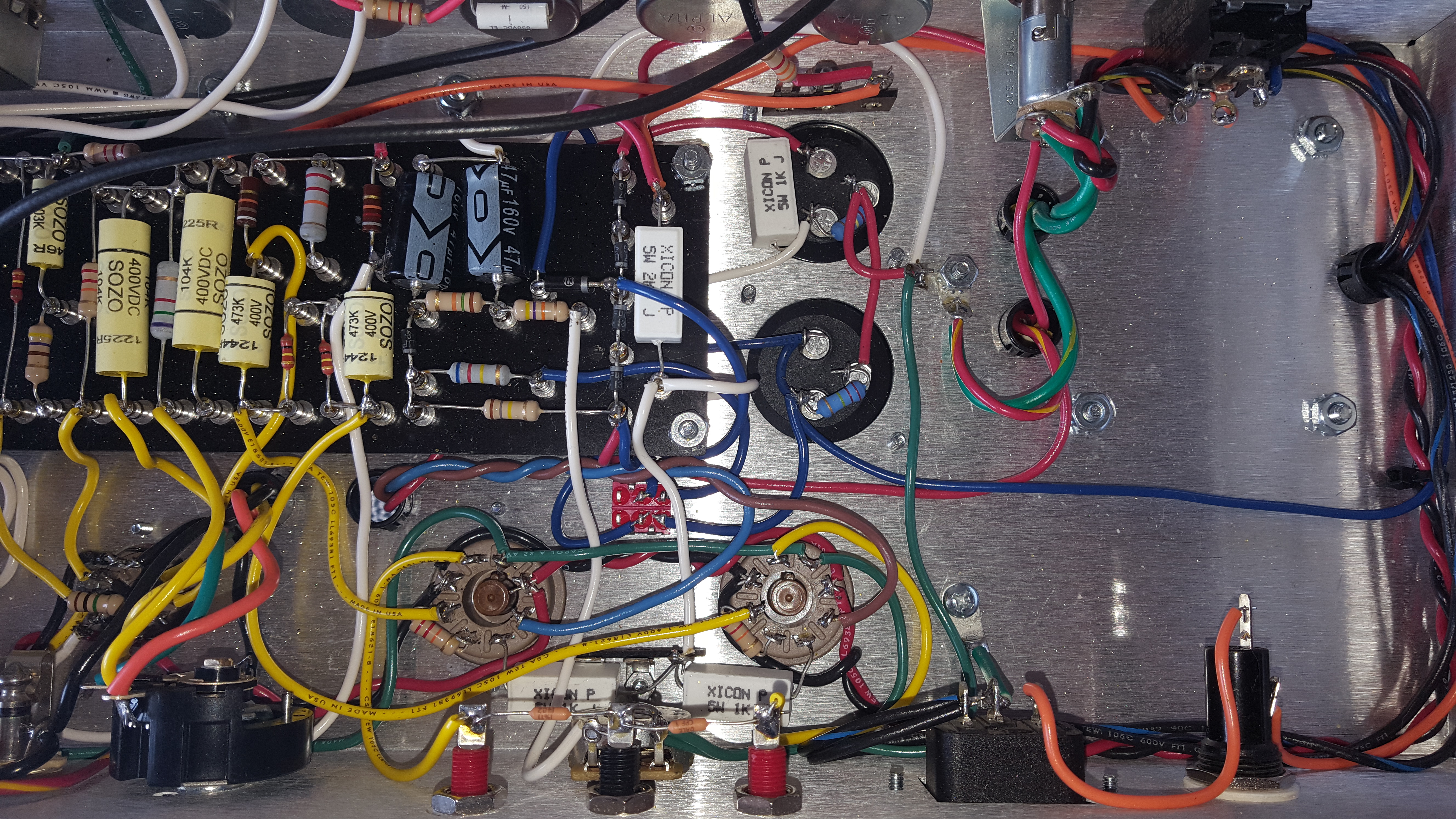

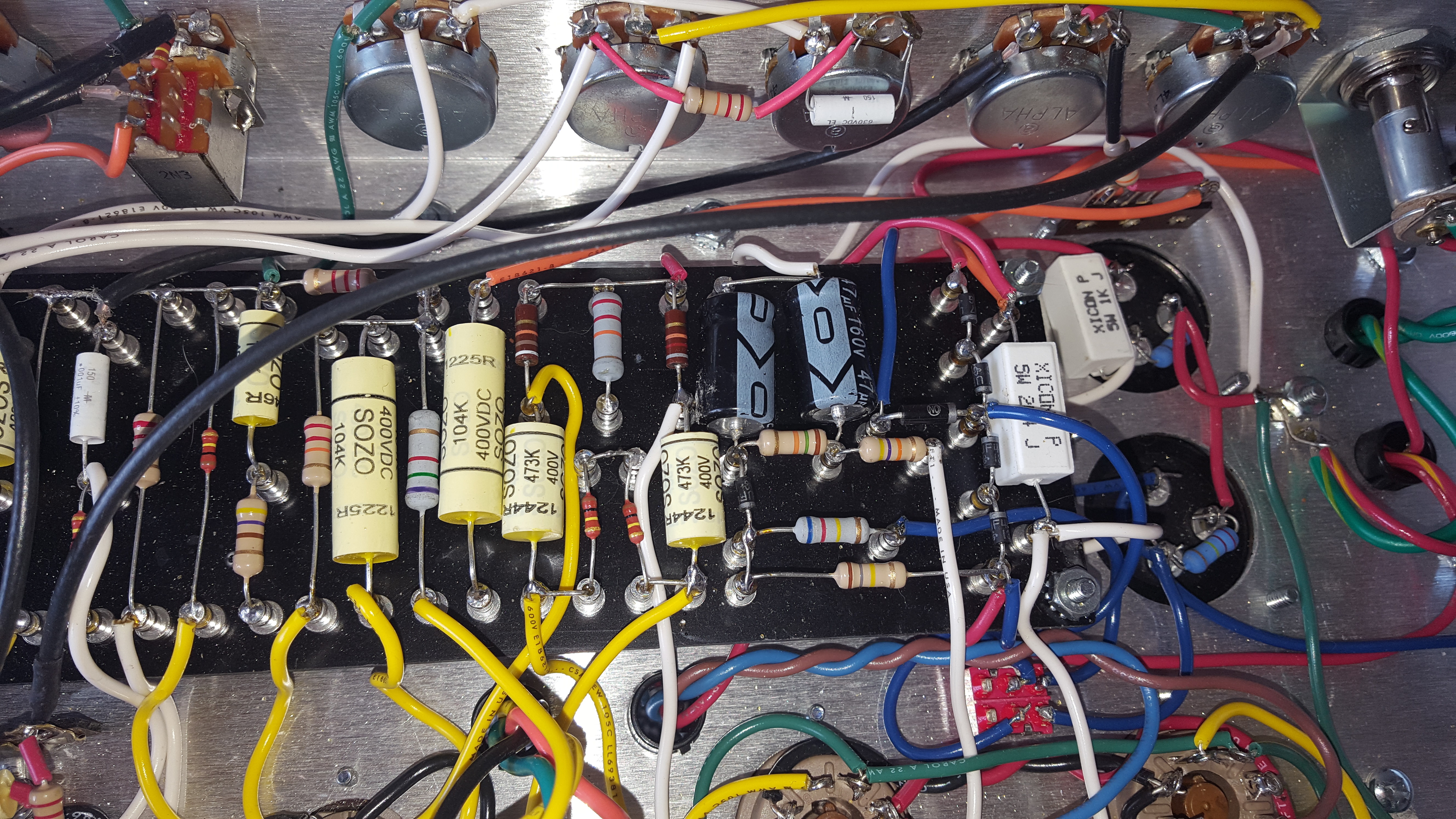

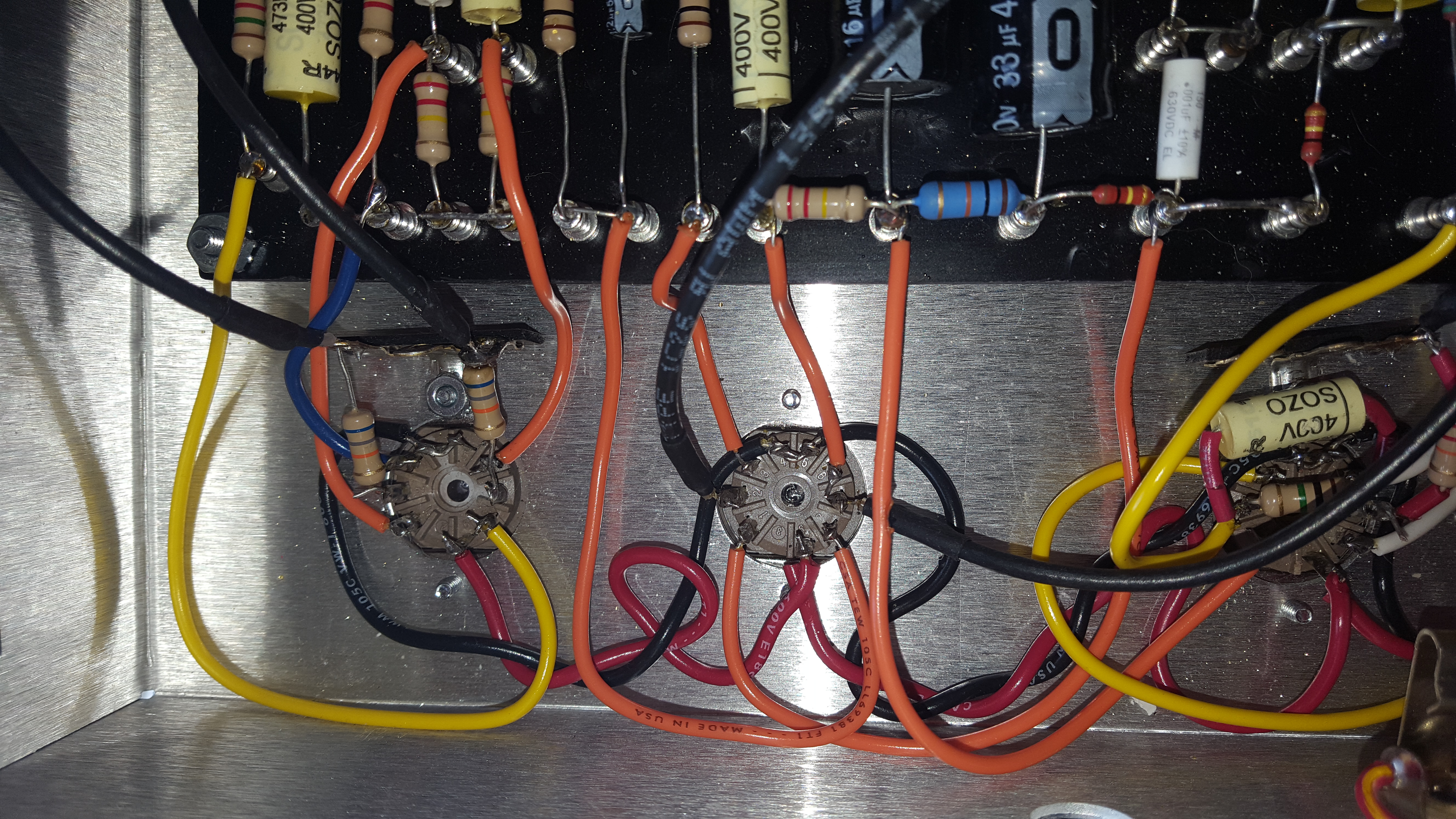

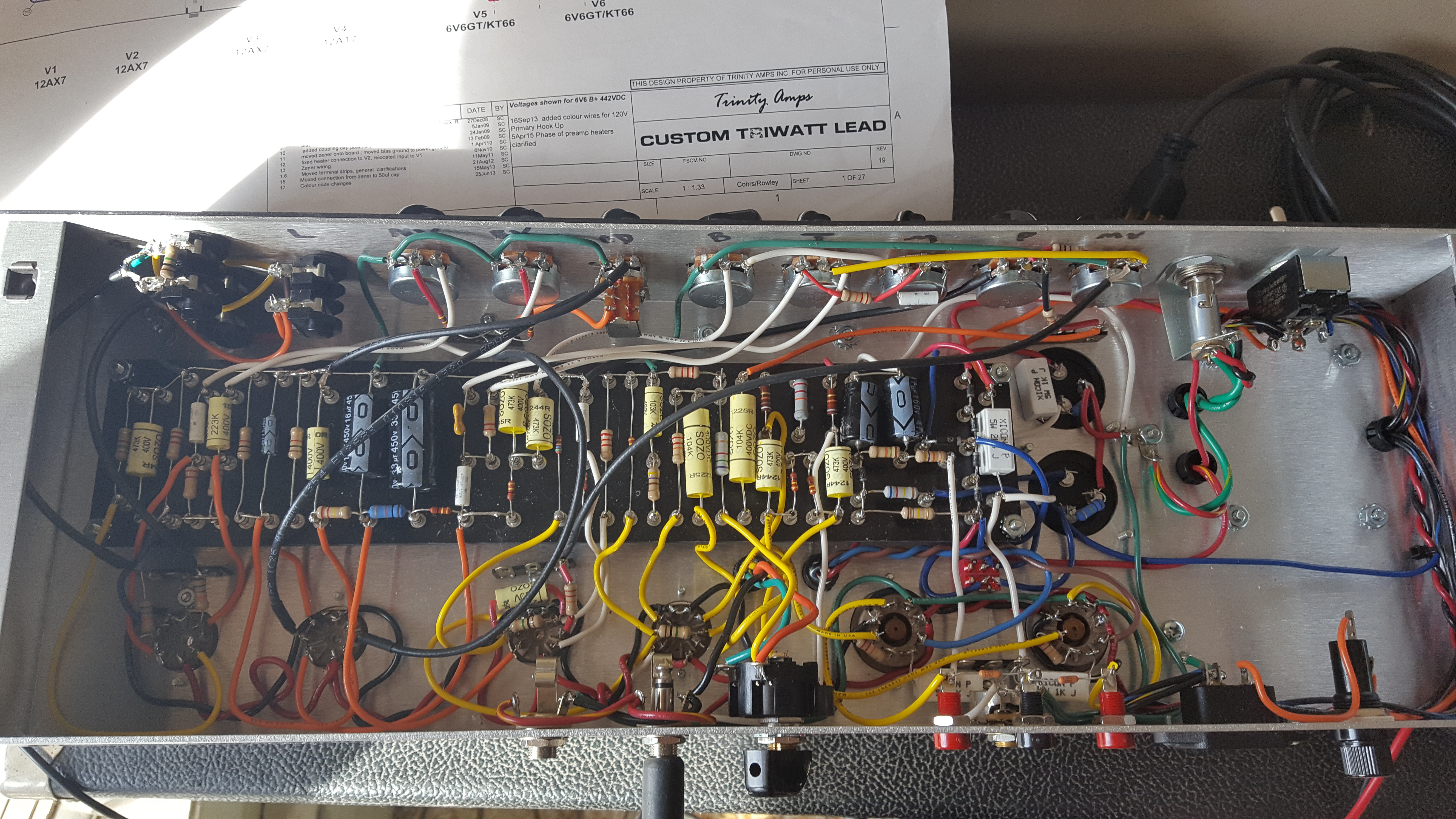

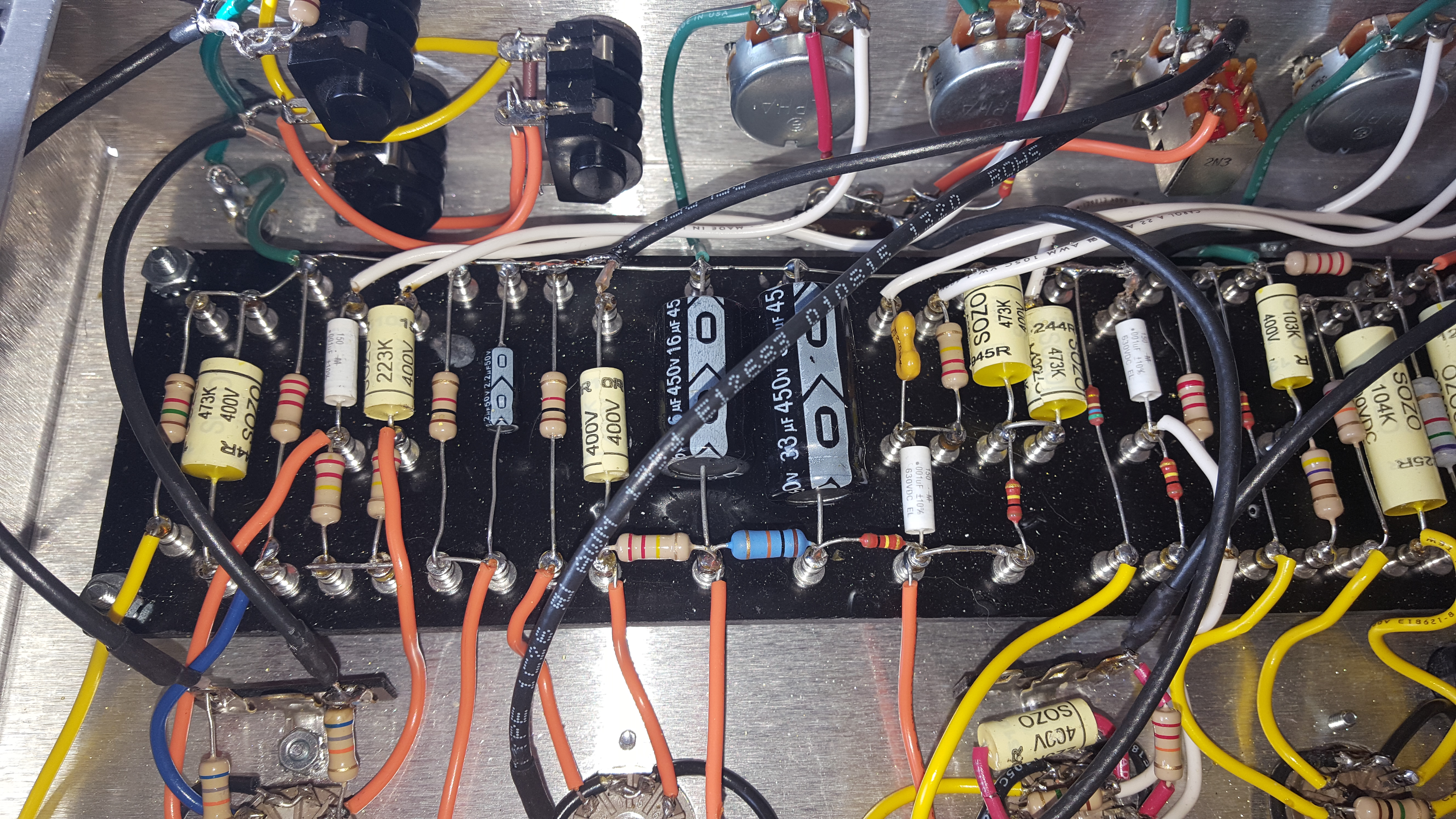

I know its hard to tell where the components are soldered on the tube sockets. I have checked all the connections over and over again. Everything is where it is supposed to be.
Thank you for your help!
