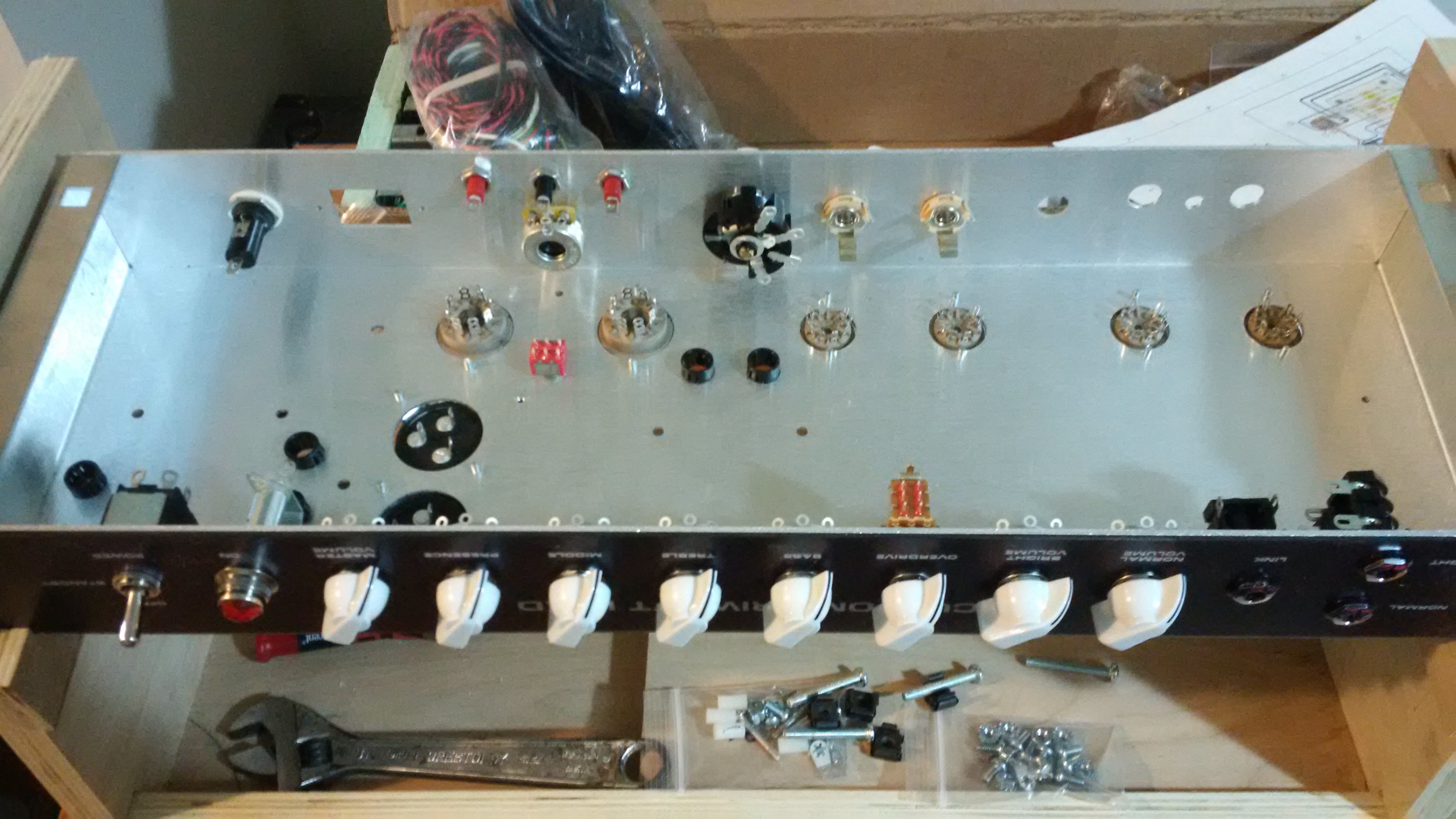

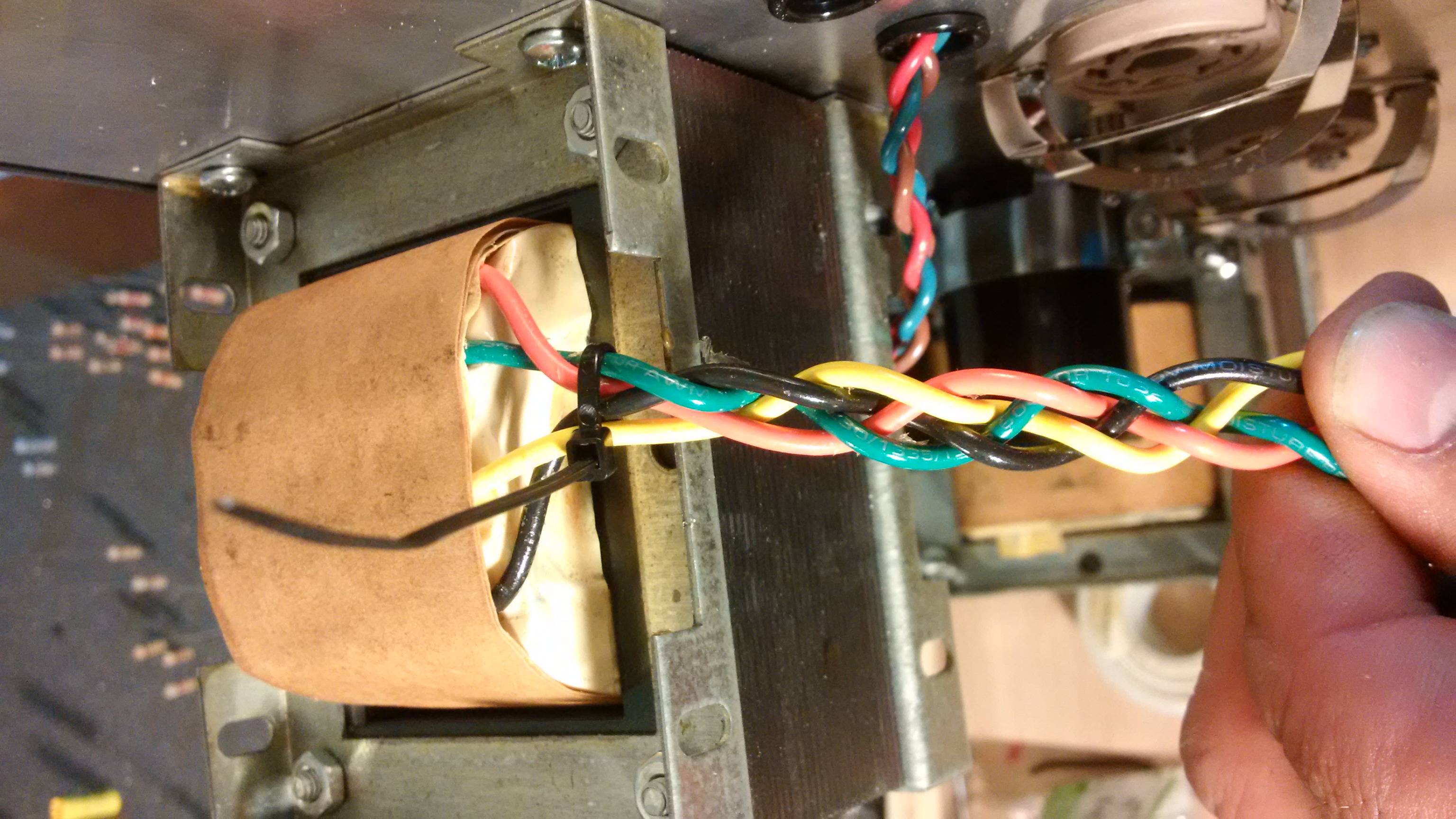

Some pics so far
 Post subject: Re: triwatt build
PostPosted: Sun May 13, 2018 9:02 am
Looks good so far. Didn't check the values on the board tho.

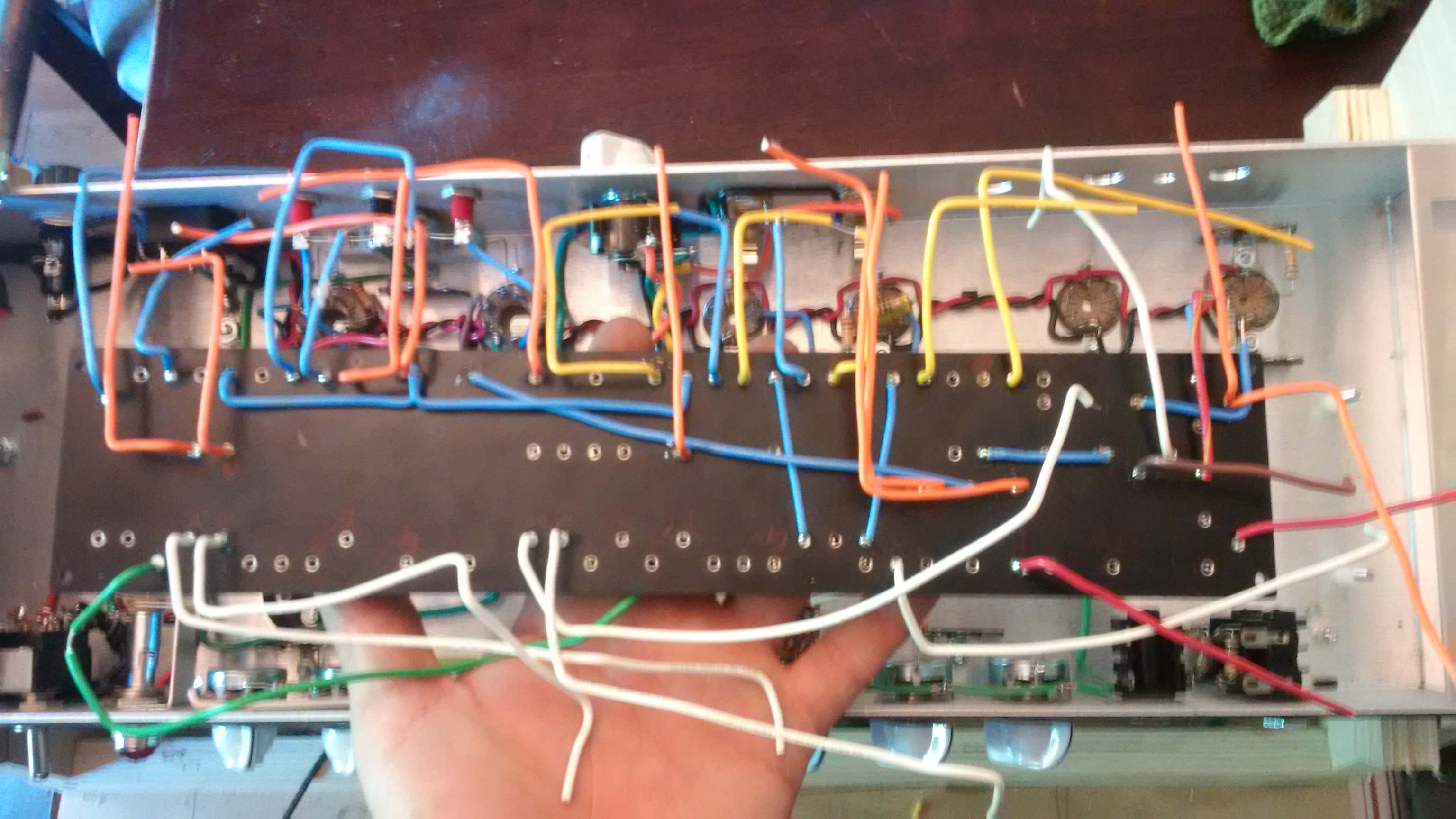

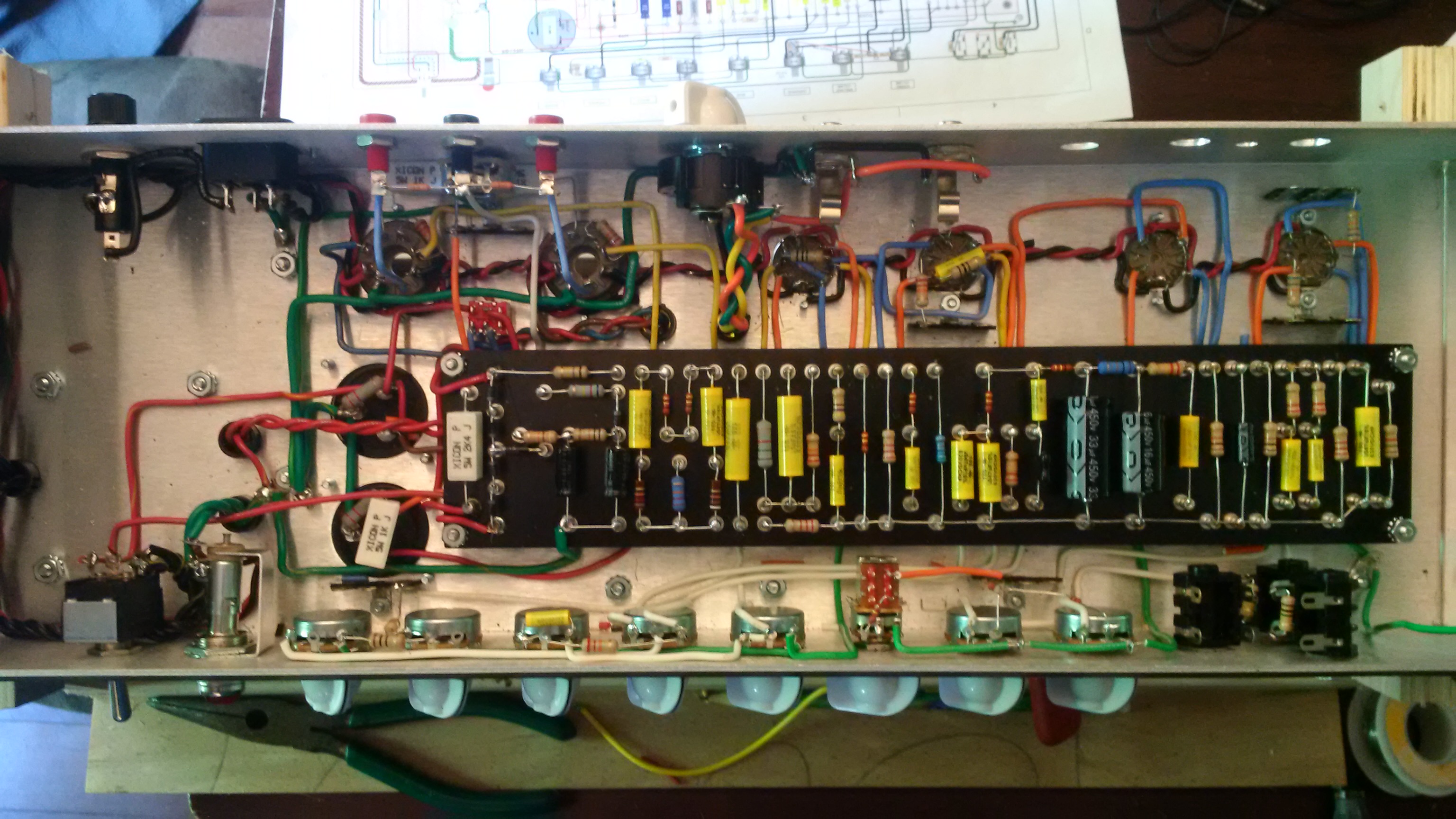

Had some time today
PostPosted: Sun May 20, 2018 11:10 am
Nice work so far!! Keep it up!!

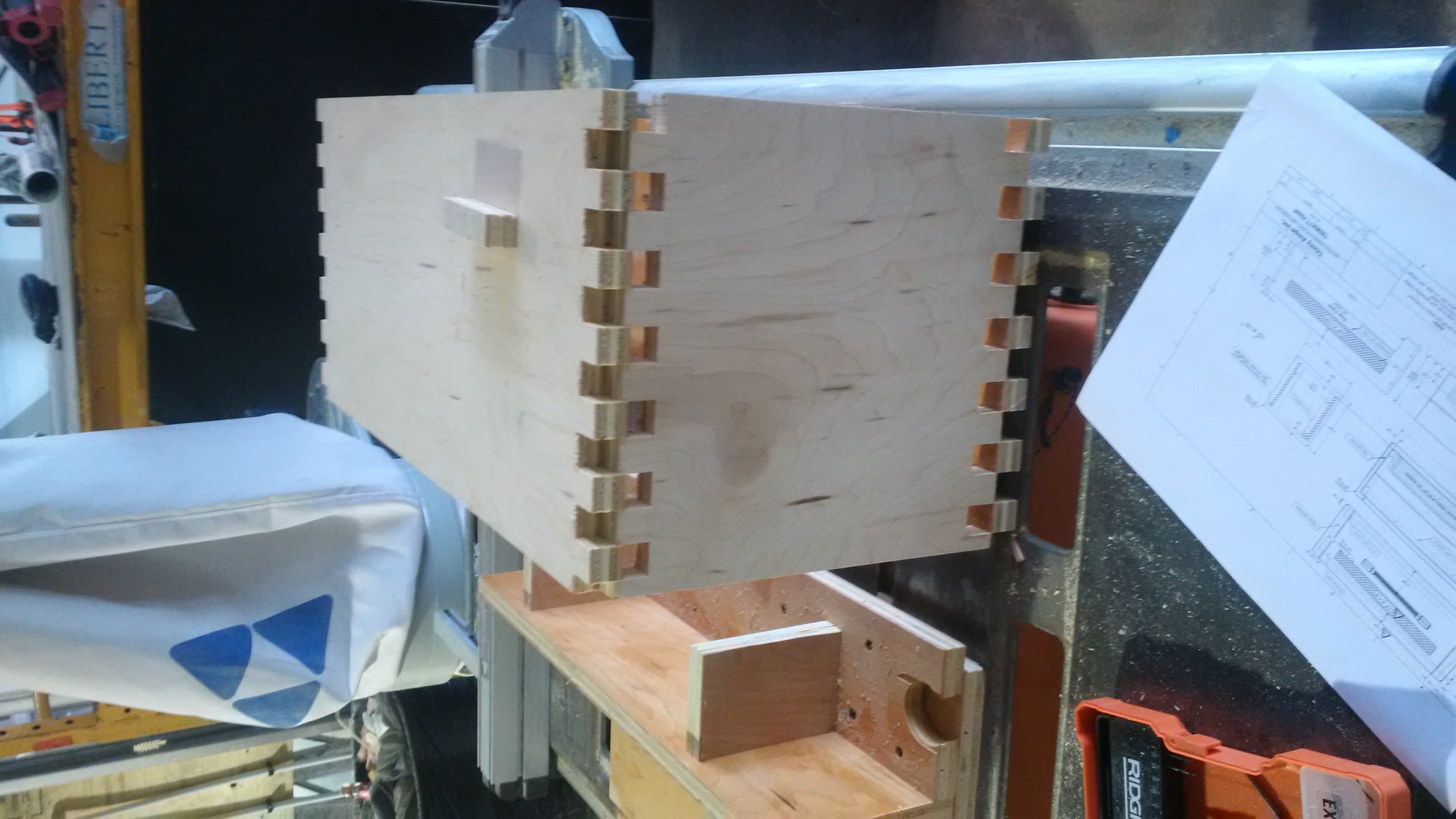

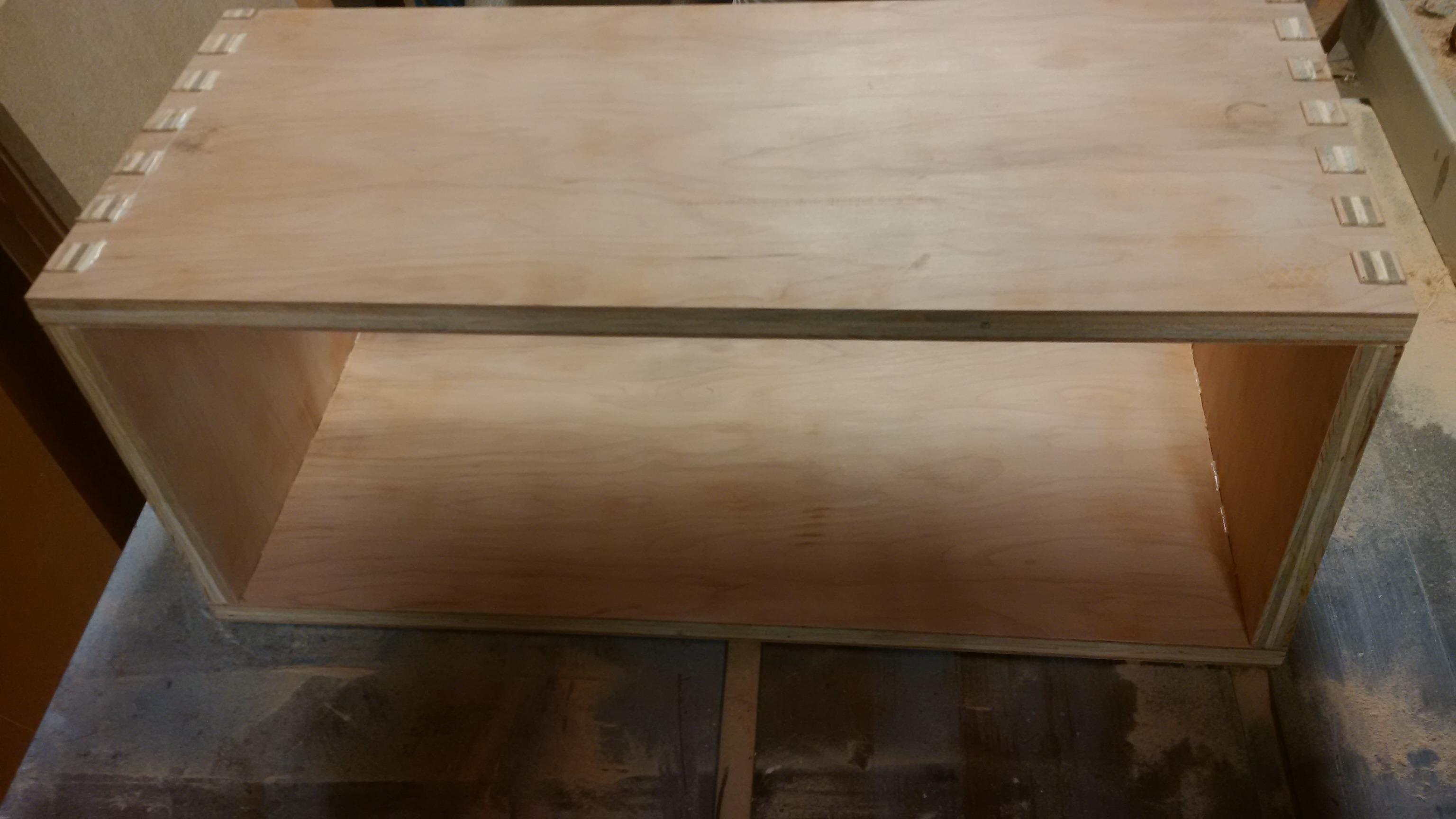

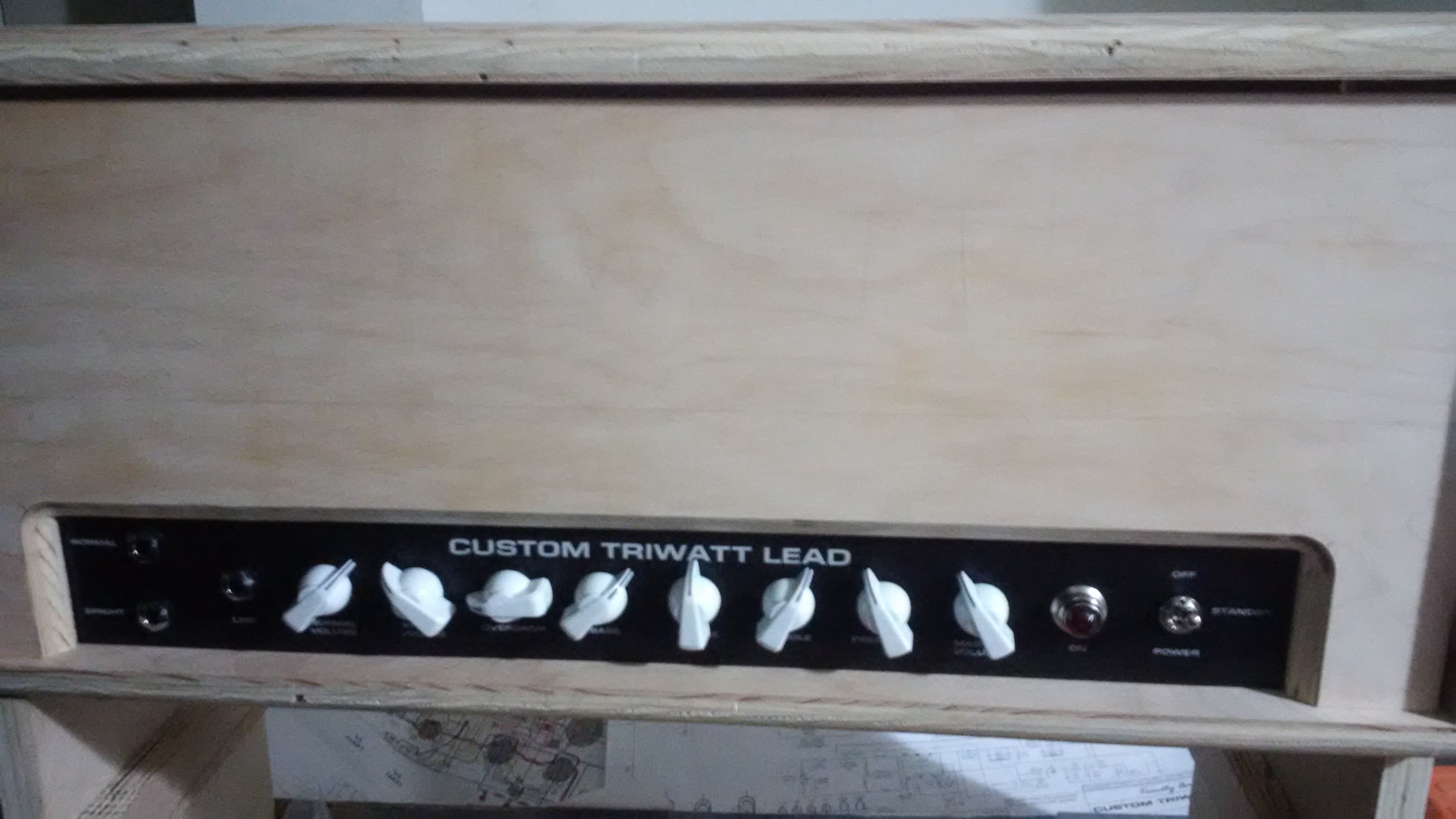

Getting closer
