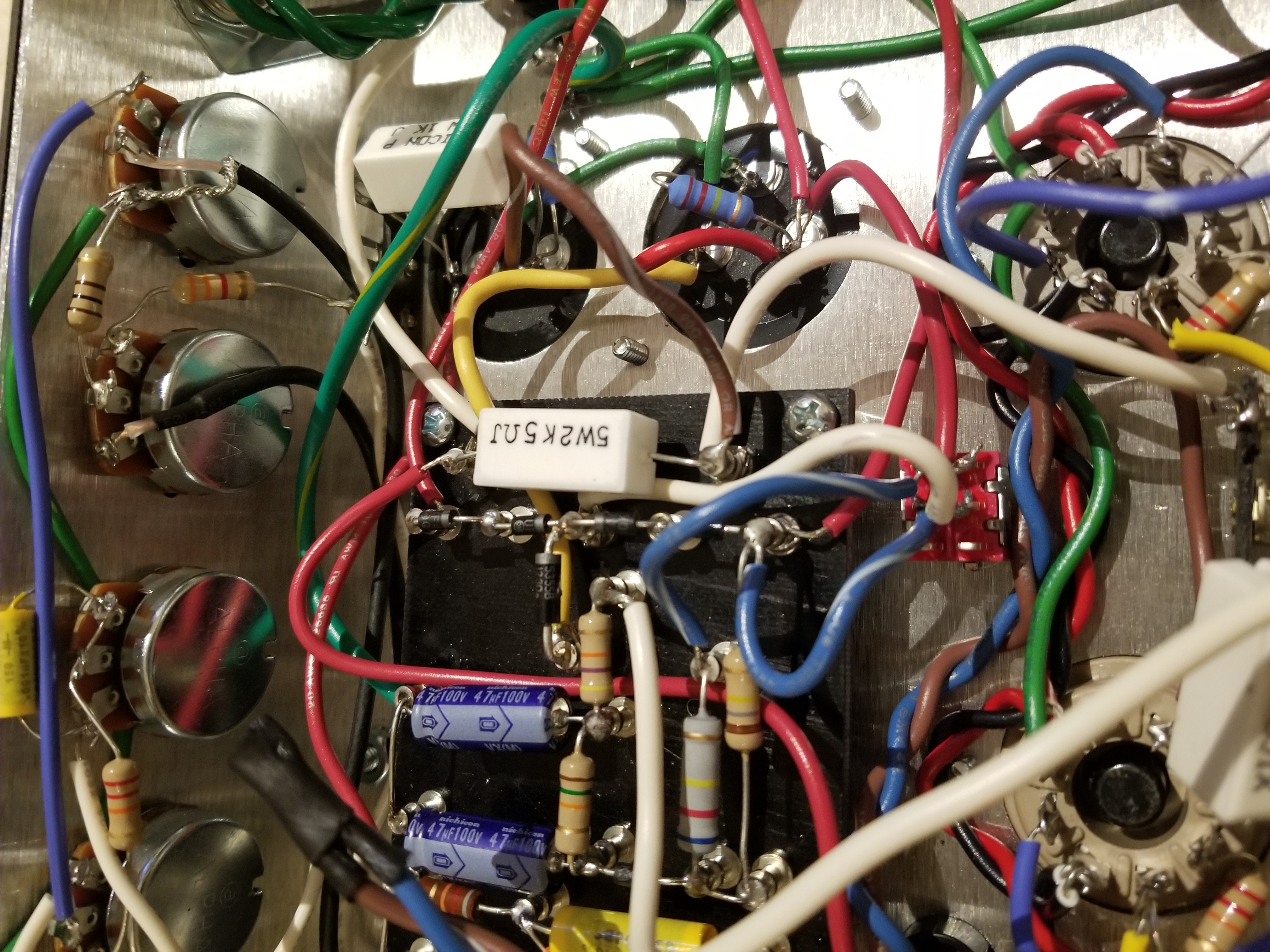

Two quick questions for you guys. When engaging the OD I get quite a bit volume jump, is that the case for you guys?
More importantly, I'm confused with the bias switch. I'm running JJ 6V6S and I'm a little lost with which way to put the bias switch. Looking from the top of the chassis down at the switch, its pointing towards the preamp tubes and I measure 20mv bias and 470v on the plates. Switch it towards the caps I get 30+mv and 440v on the plates. Does this sound right / look right in the pic. I've gone through the wiring and nothing is jumping out at me.

Matt - i read through those and got some info from stephen and it makes more sense. With that knowledge took the amp put it on 6v6 which gave me the right plate voltage and turned the bias pot a hair (no longer short to ground) and blew the fuse. Seems like i got a wire off in there somewhere....now gotta chase it.

The bias switch layout had me scratching my head for a while. When looking down into the chassis, the "wired" side of the switch is the KT66 side. This allows 2 things...the B+ can bypass the Zener diode since it has a pathy through the switch (i.e. the Zener is shorted), and 2) it engages a parallel resistor (R44) for the bias supply. The no-connection side is 6V6, so when this side is selected the B+ has no where to go except through the Zener, which drops the voltage, and R44 is not added in the circuit.
Therefore, from the outside of the chassis, the handle of the switch will be towards the OT when in KT66 mode, and towards the PT in 6V6 mode.
