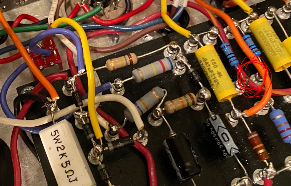

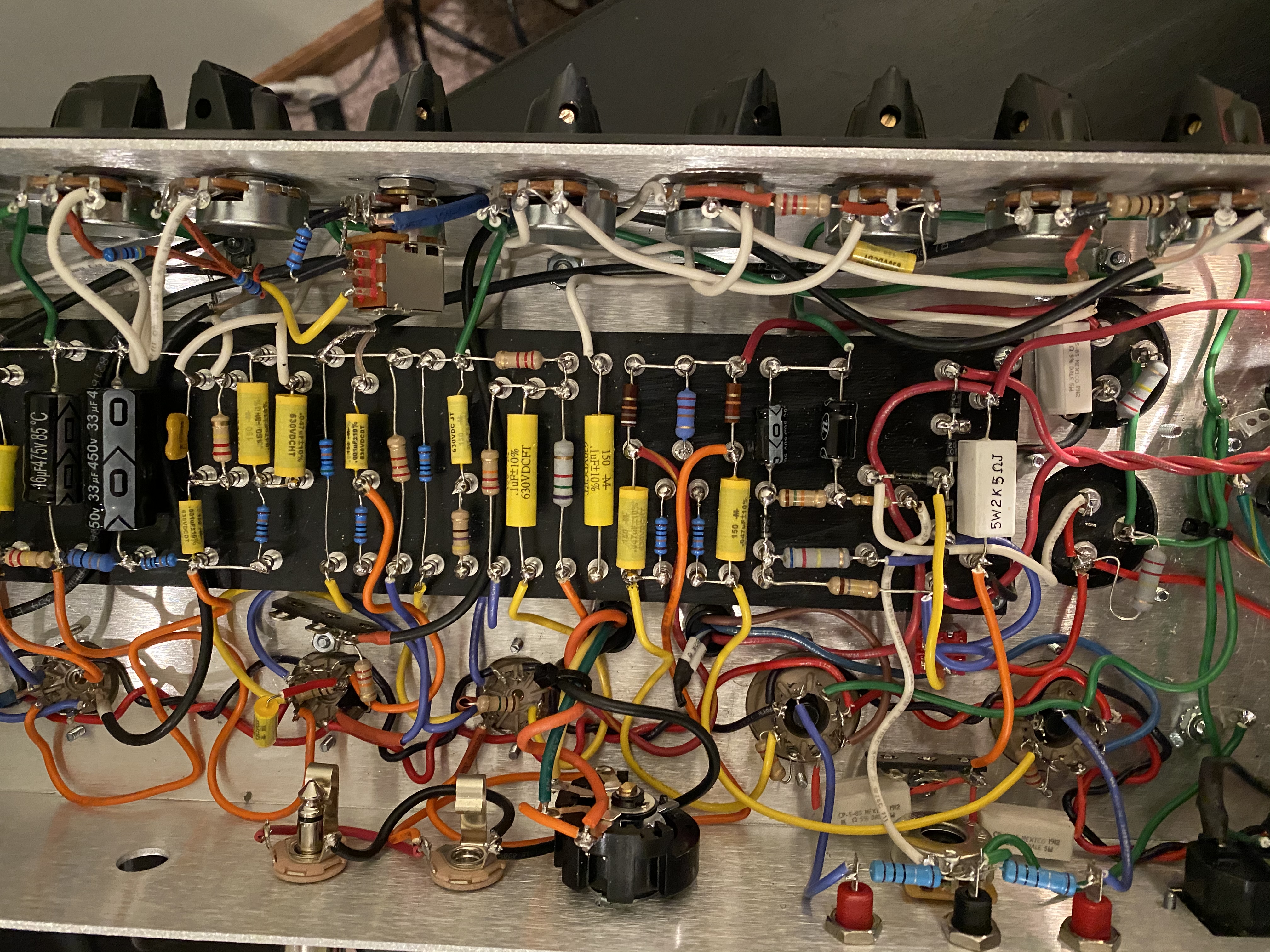

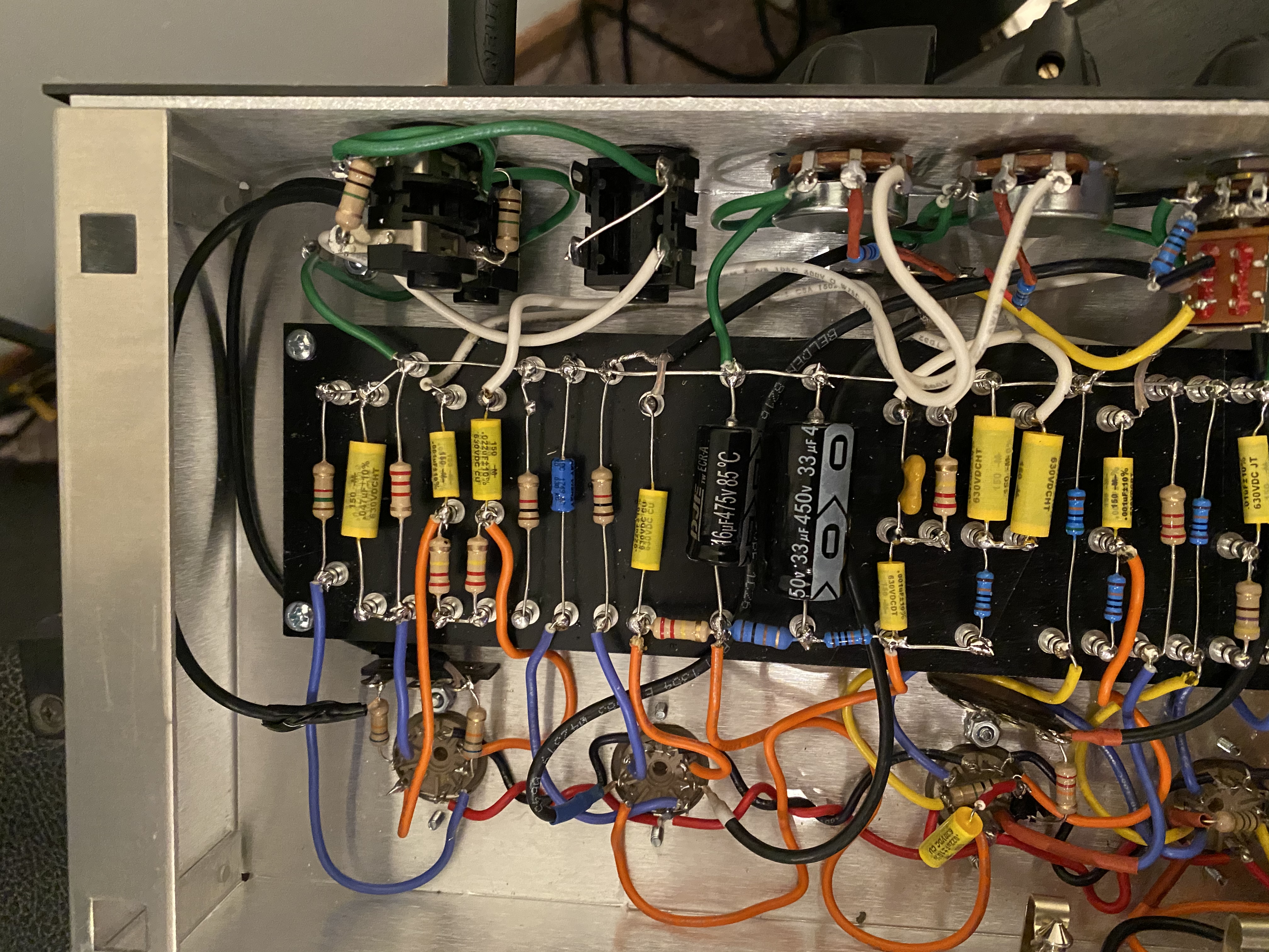

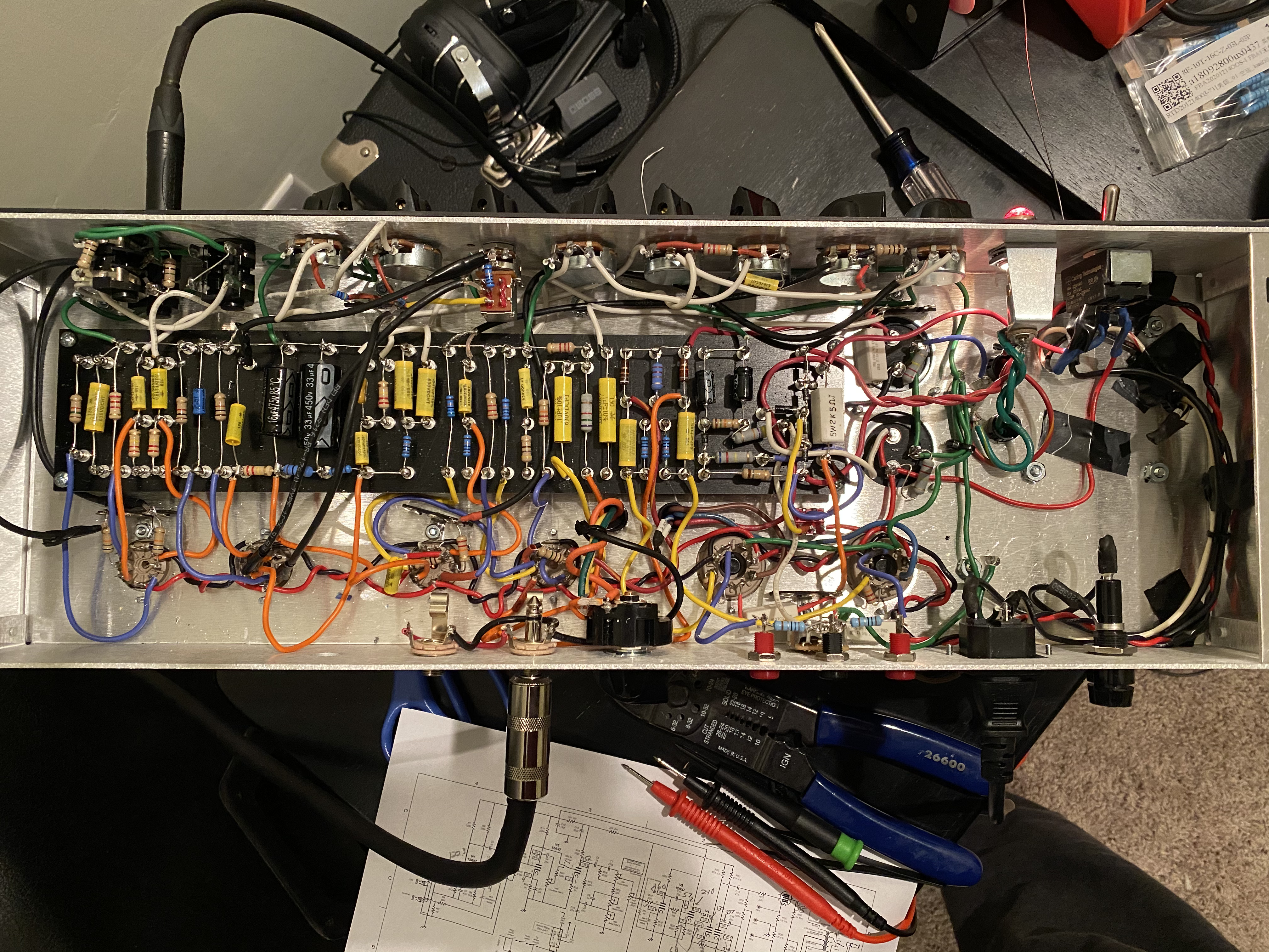

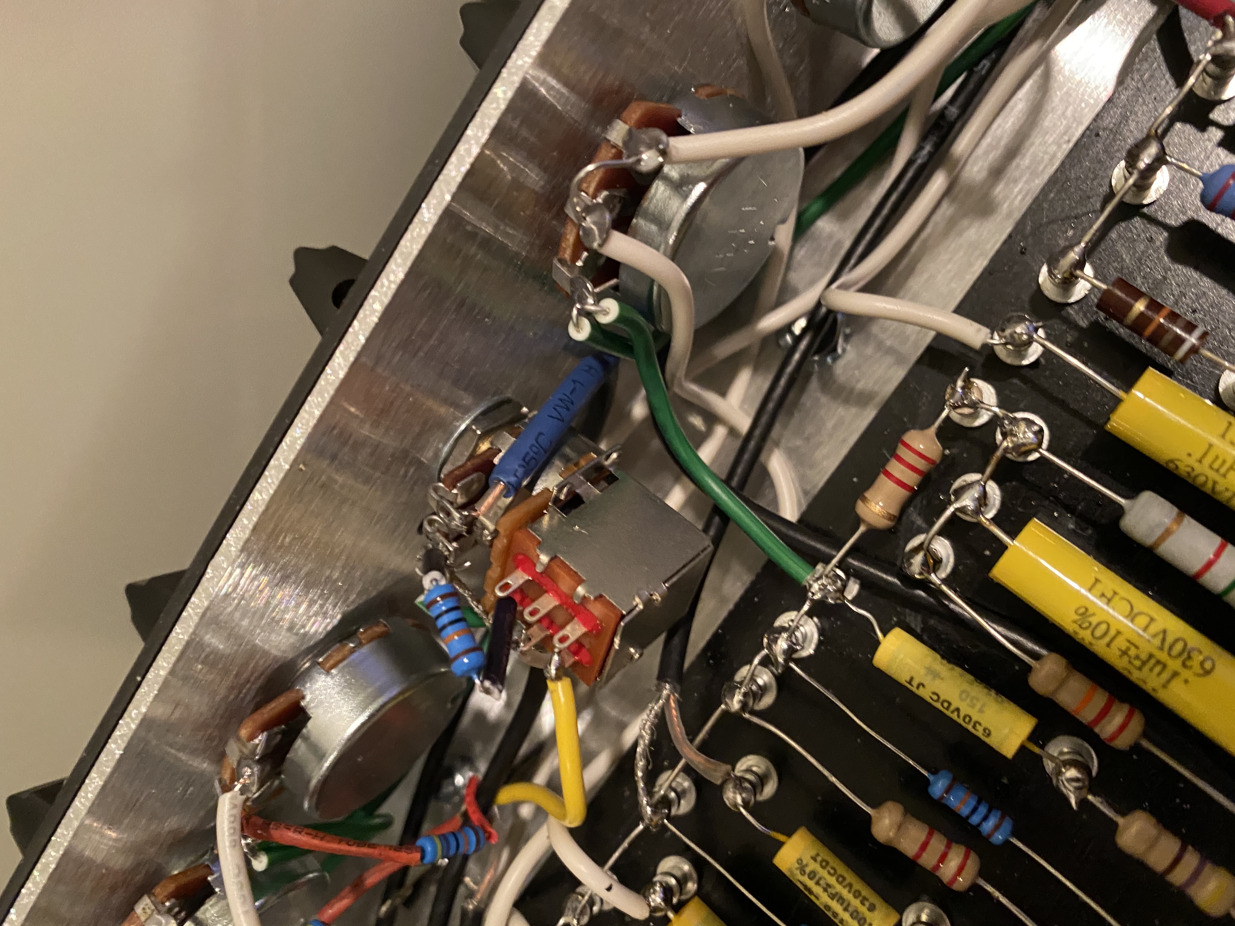

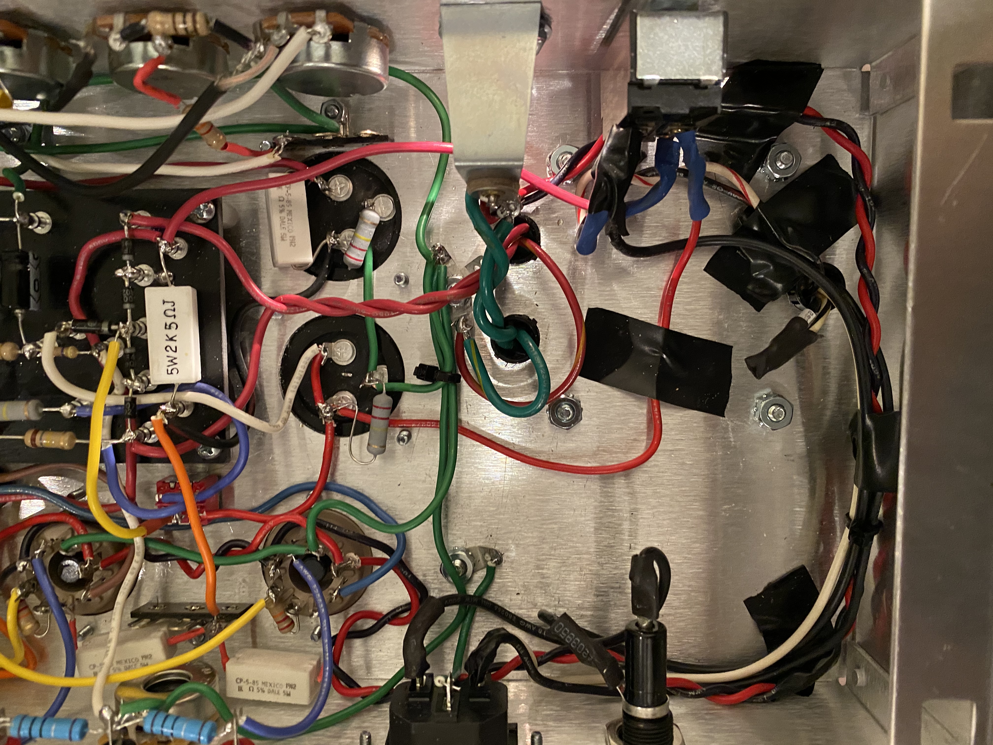

I finished up the wiring and adjusted the bias, but I am now not getting any sound coming from the amp when plugged in. The pilot light is on, the tubes are glowing, but no noise from the jack. Any thoughts on how to track down the issue?

So I messed with the resistors on between the bias test points and got some sound. Now it appears my overdrive switch is causing problems.

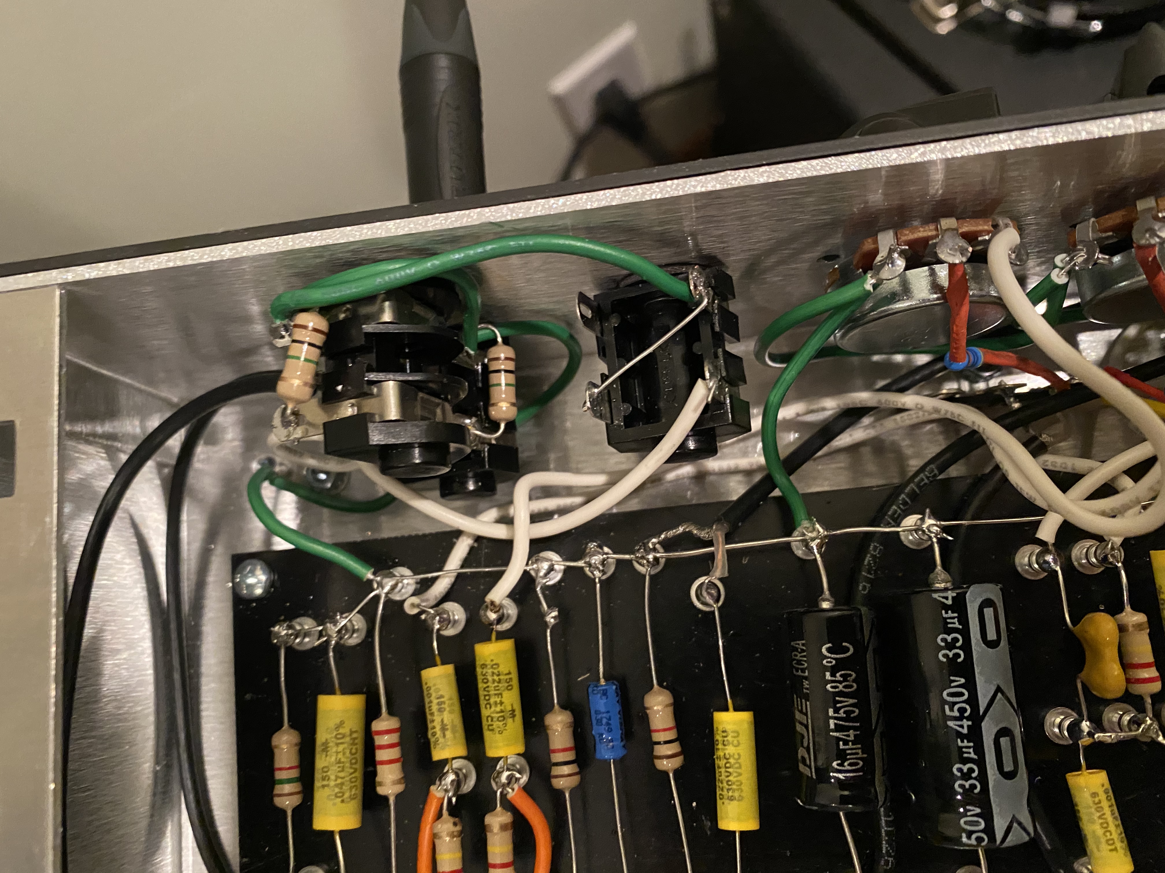

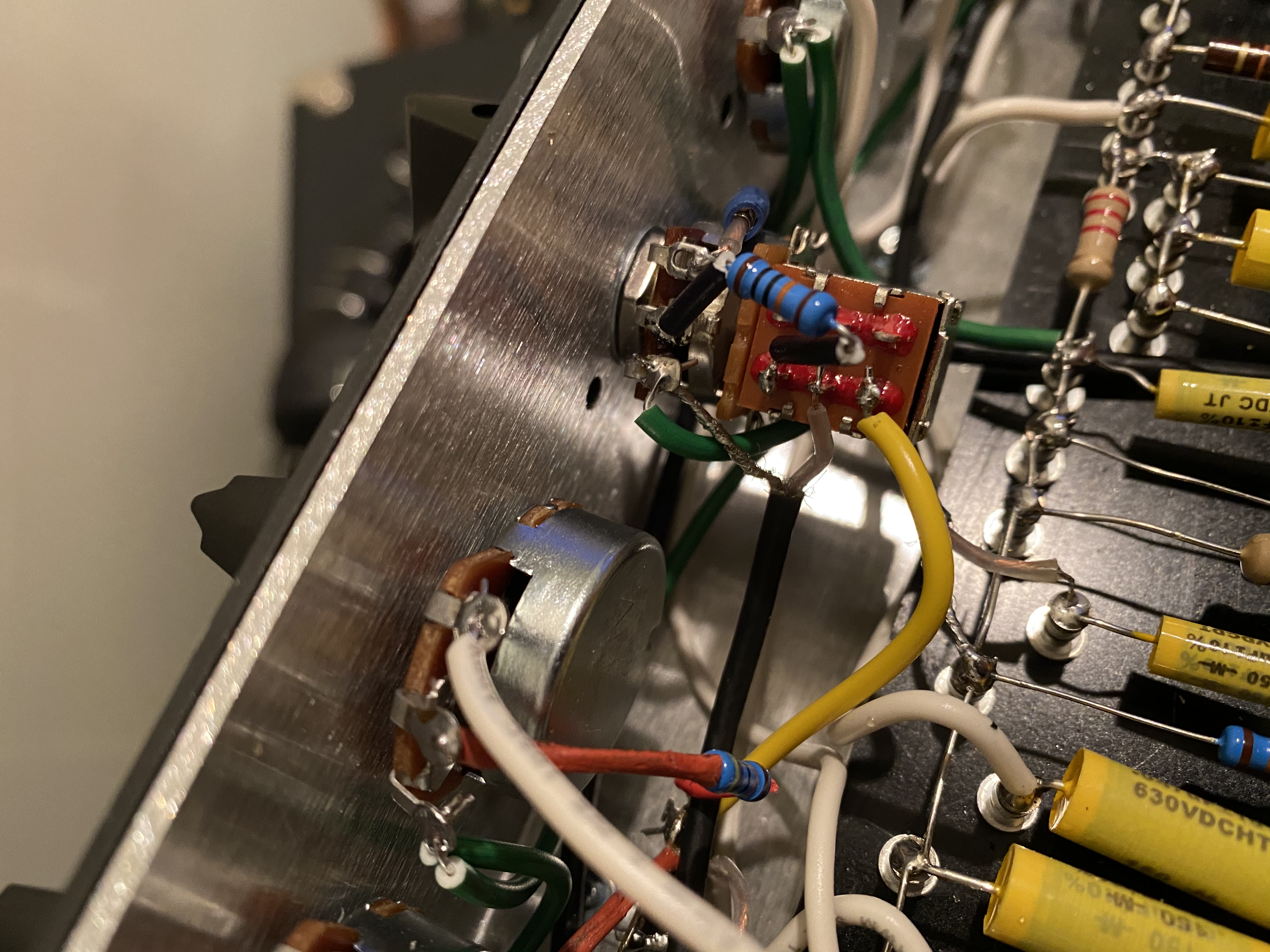

Is it wired incorrectly?

As far as I can see, the OD switch seems to be wired correctly.
What makes you think the OD switch is the issue?
Also, I would strongly advise you to check all connections.
- Use a digital or printed copy of the lay-out and mark every wire that is in your build. Check them one by one and mark them if they're present. Make sure all wires correspond with the lay-out and none of them have been forgotten. You should be able to tell that right away when you have finished marking the lay-out. Don't forget the jumper wires! They are often overlooked.
- Next, check als solder joints for connectivity. Some of them look to be cold joints but I could be mistaken. Check with a multimeter for connectivity.
- Next, measure all voltages as mentioned in the voltage chart in the manual and post them to this thread. This will give us a better Idea of the problem.
Do you get a proper bias reading on the test points?
Looking forward to your response!

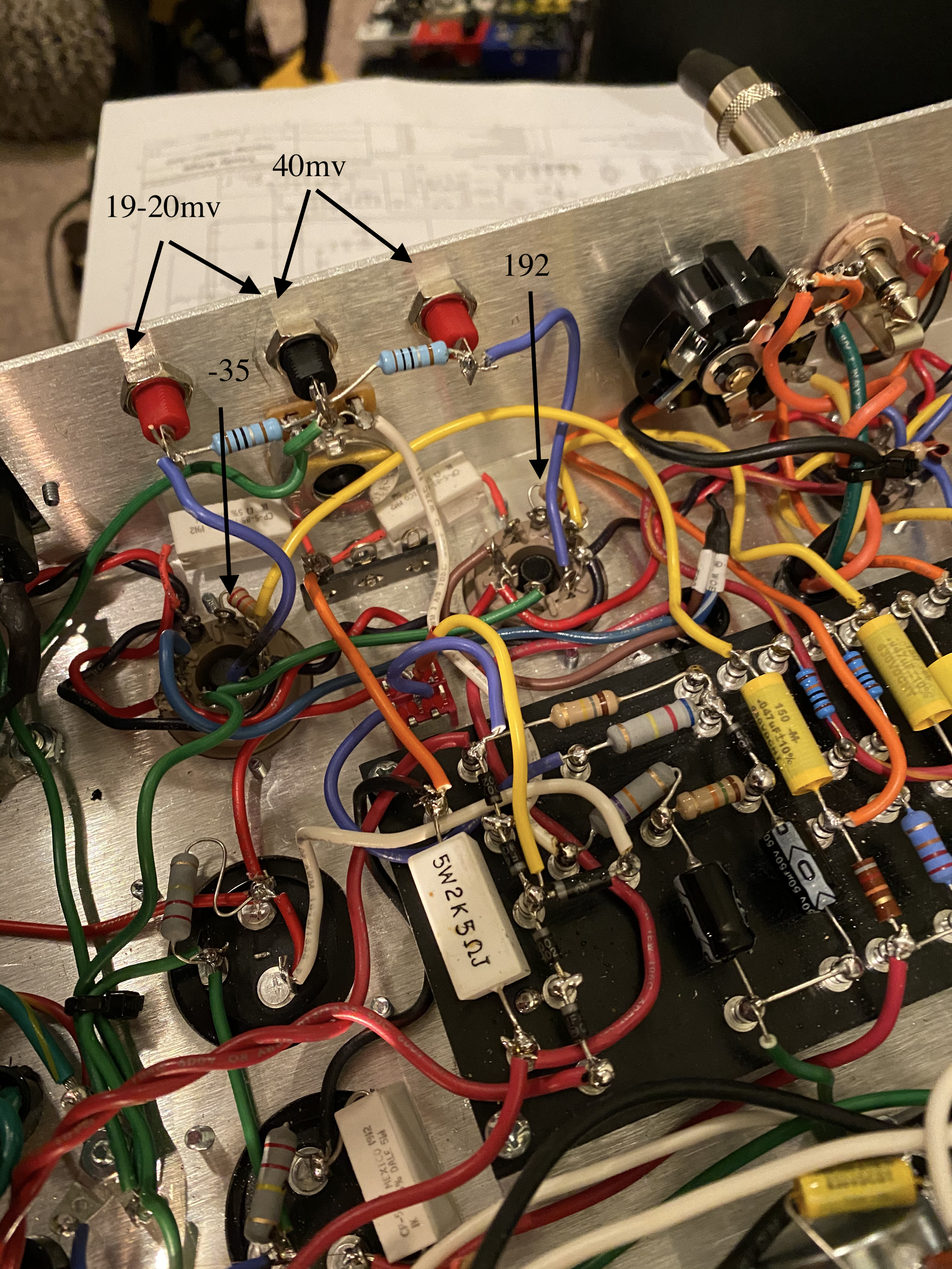

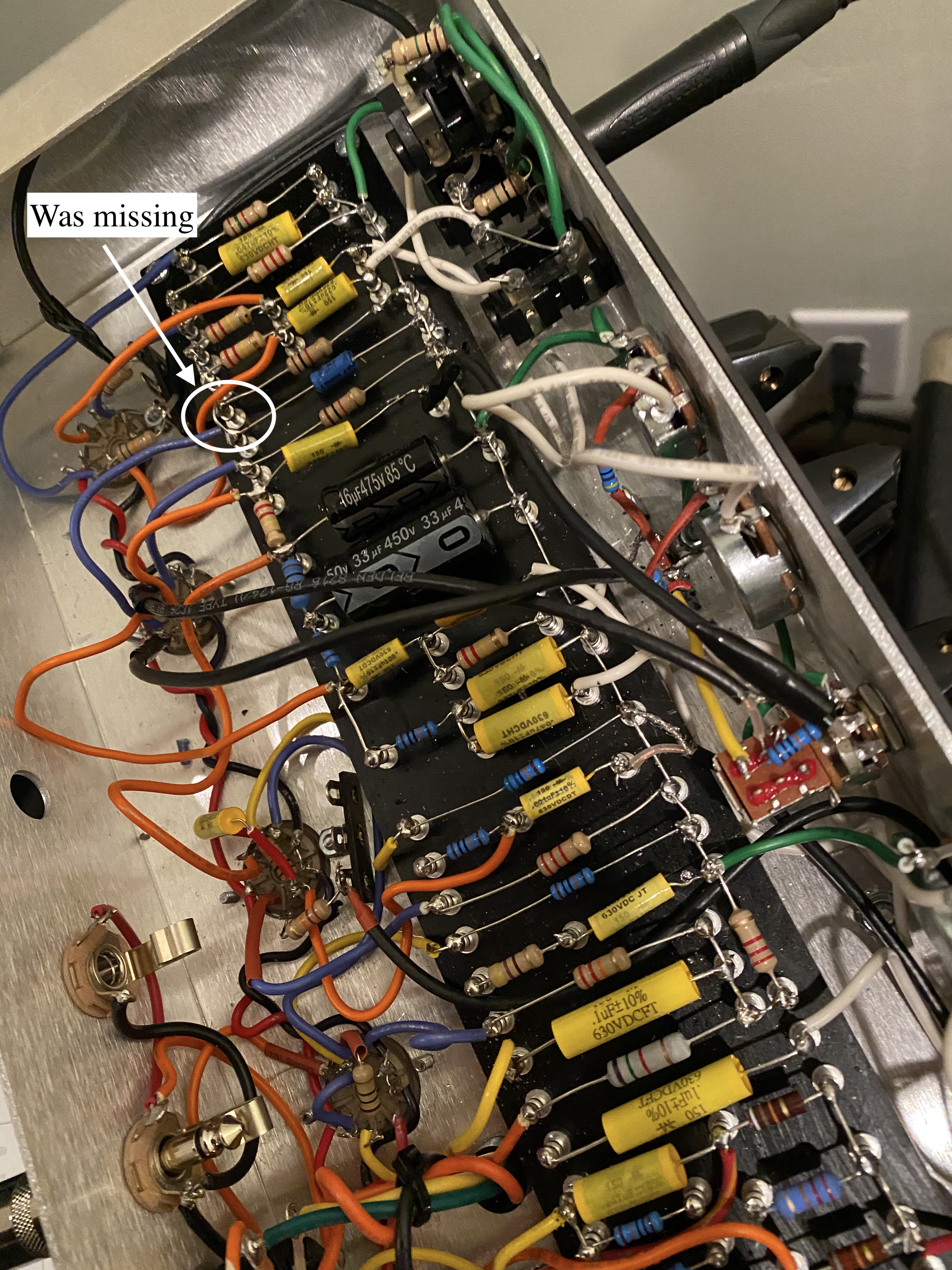

Of course, when I went back to verify the voltages, I found that I missed the jumper between the 1k and the 2uf. I put that in and the OD started working. It was squealing at high levels though, so perhaps something is still up. The new pin 6 and pin 8 voltages are 6=89 and 8=.65
My bias is a bit off though as I can get 19-20 on the Test points closer to V6, but the other Test points are in the 40s. Pin 5 on V5 is reading at 192 when it should be (-35), so I wonder if that is what is causing it.

Great! Good to hear that you found the missing jumper.
That would have definetly been the problem causing your problem regarding the OD.
Now, to be honest, I had missed that reading of V5 pin 5 in your previous post.
You are absolutely right though, that is way off.
It is quite strange that one power tubes shows the right values while the other is off.
This is indicating that most of the circuit is correct or else you would also be getting wrongful values on V6.
I then checked the schematics to find out were such a difference could come from and I noticed the two resistors R28 and R29. You HT3 voltage is going through both of these resistors and they are "drained" (or biased) by the wire going to your bias circuit. There is a jumper wire between R28 and R29 which makes sure that both of these connections (which eventually go to pin 5 on V5 and V6) are being biassed. When that jumper is missing, only V6 is getting biassed correctly since V5 is not "seeing" the bias circuit. That must be causing your problem, because V6 is giving you correct readings.
I finally checked your images and noticed that the jumper wire is indeed missing.
Please see the attachment for verification.
I bet soldering in the jumper wire will solve the issue.

Just to make sure, it's V5 now that isn't giving you a bias reading, right?
Because that is also the tube that has gotten the incorrect voltages because of the missing jumper.
Have you got some spare tubes to try? You might want to check that first.
Secondly, check all wires on the two power tube sockets, the blue wires going from those sockets to the bias circuit and the connections on the bias circuit itself.
It is very hard to see on the pictures but some connections seem to lack solder, but I could be mistaken.
First try out a new tube. Might solve the issue already.
By the way, out of curiosity are you using the 6V6 tubes?
So I swapped out the tubes and now I am not getting bias reading on the V6. So I will order a new tube and hopefully that fixes it.
