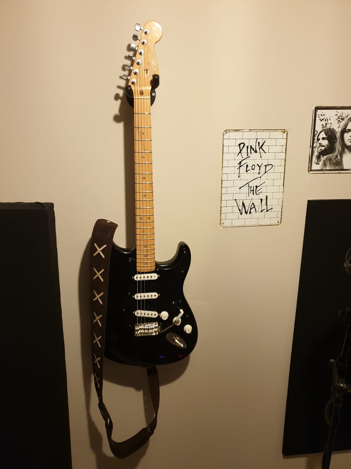

As promised (although a little later than planned*): The Thin Ice - Pink Floyd solo.
Of course I used the Triwatt for that wonderful sound.
Effects Chain: Seymour Duncan SSL-5, Effectrode PC-2A, Buffalo FX NOS BC239C Ram's head, Buffalo FX Power Booster, Vintage EHX Electric Mistress (1979).
Delay and reverb added in the mix. I also mastered this one just to showcase the studio tone you are able to get with the amp.
*Perhaps a little off topic, but the reason that it was recorded a little later than planned was because I repainted my guitar with nitrocellulose lacquer. That takes ages to dry!
Still, the result is way better than I could have hoped for. Added a picture as attachment. Just for the die hard Gilmour fans on this forum (which I know there are).

Another excellent clip showing off the Triwatt! Your black Strat looks great, too!
