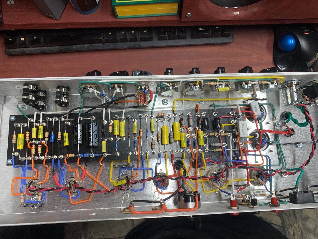

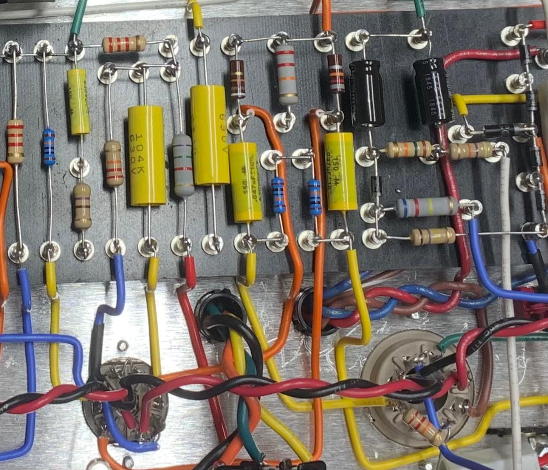

PostPosted: Thu Mar 03, 2022 3:22 pm
Posts: 181
Those voltages aren't too far off, and if the amp sounds good then its probably ok.
The plate resistors for V4 are carbon comp, and typically drift more (usually upwards) than carbon film with age. An 89k reading for an 82k-banded CC resistor isn't that unusual.
Can you provide a close up of V4? Did you double-check the resistor value mounted on the socket between pin 2 and 7?
Also a close-up of the PI section of the board...where you have the 91k and 82K resistors. Are they swapped?
What is your B+ voltage (measure power tube pin 3)? Is it pretty close to the layout (~440)?

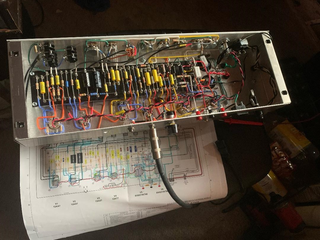

Attached is a cropped picture I had from a little earlier in the build state, without all of the shielded coax installed. I definitely have the 82K and 91K resistors in the right spots, but it jumps out at me now that the tolerance bands are not the same, with the 82K having a silver band designating a 10% tolerance instead of the 5% noted in the parts list. I hadn't taken note of that detail when I was testing components, and now that 89K reading makes more sense.
I can understand in todays world with part shortages running rampant that Stephen may have had to substitute the wider tolerance in.
As far as double checking the 1 meg across V4, I checked everything before starting the build, and then one again before soldering the components in. So I am very confident in the value of each resistor.
I would have to pull the head back apart to check B+, as I checked it at initial power up and it was near 450v, but that was before biasing, and I did not check again after I set the bias. Once I make the feet for the head, I have to remove the bottom panel and drill the holes to install them, so I will double check B+ on both power tubes at that time.

Thanks for the extra pic...everything looks right based on the layout/schematic.
I think that you should be ok. I've seen some build guides where if you were +/- 30% you are still ok (just checked...the Triwatt builder's guide says 50%...page 44). My guess is that with the 82K plate resistor actually reading at 89k, that could explain some of the differences. The only really "weird" thing is the higher reading on pin 6, but even then you are only "off" by 14%. What was the reading of the 91K resistor?
Again, if it is sounding good to your ears, you are probably "close enough". To answer your question, I wouldn't worry about it.
