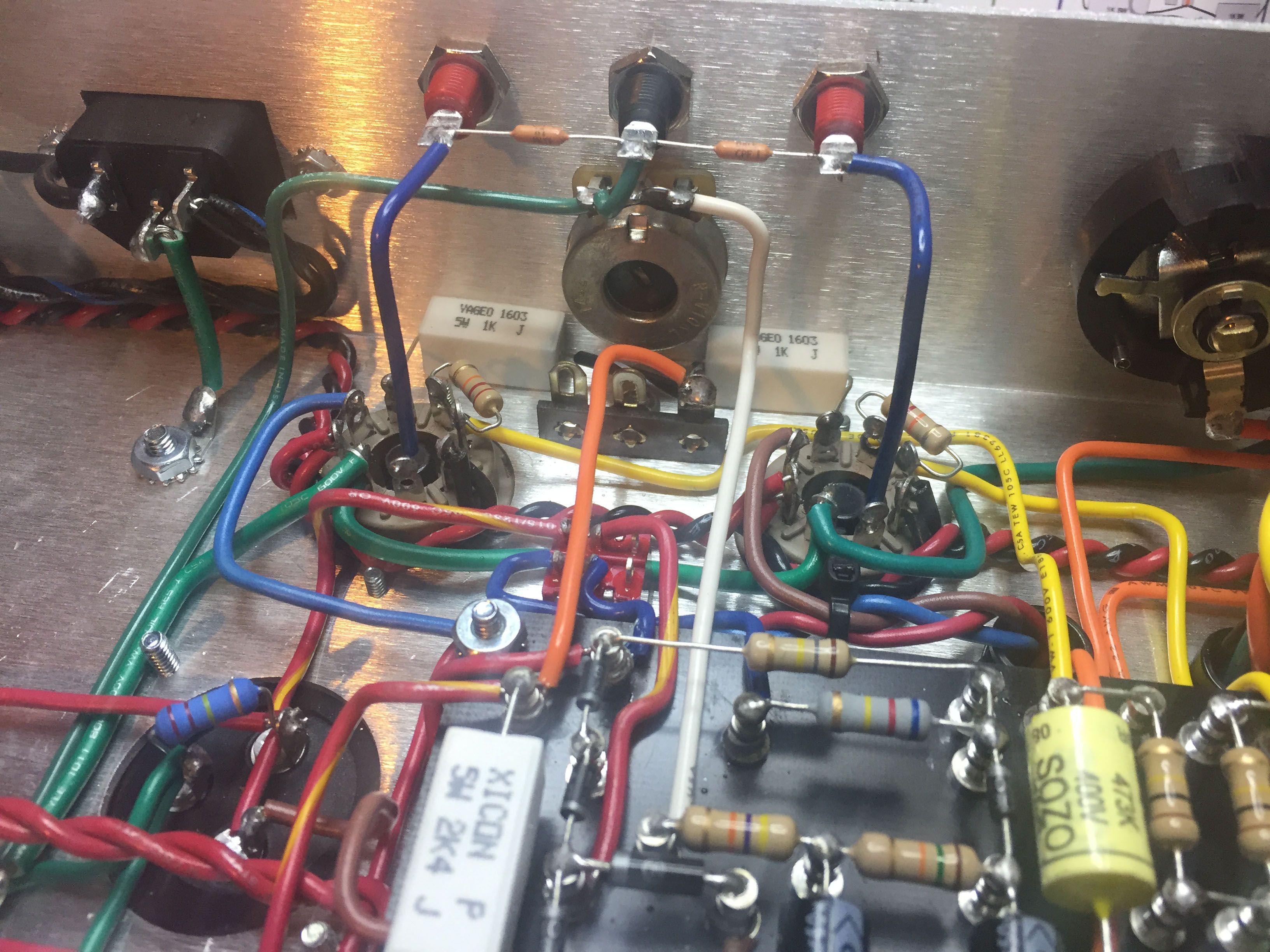

Please check the impedance switch is wired correctly. or bypass it and go direct to an output jack .
There should be a variable negative bias voltage so check for that.Power tubes dont have to be in for that.
Check your ground on the bias circuit and power tubes.

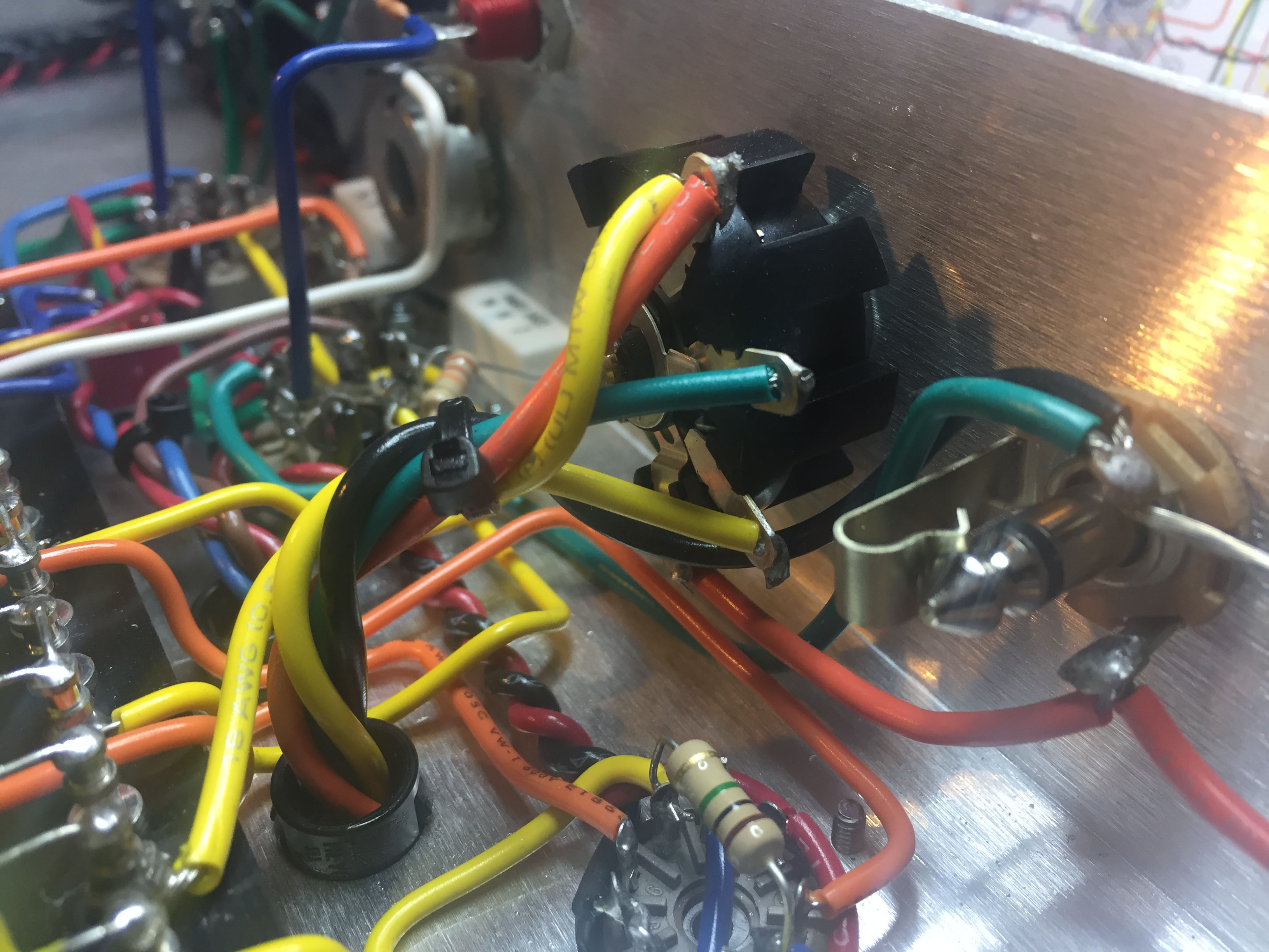

I'll have to splice one of them, I left it too short. I've checked the impedance switch, and the bias circuit, haven't identified any wiring issues.
Impedance Switch Wiring,
Orange 16 Ohm tap, also to board (Yellow cutt-off)
Green 8 Ohm tap
Yellow 4 Ohm tap
Output tap to output jack tips

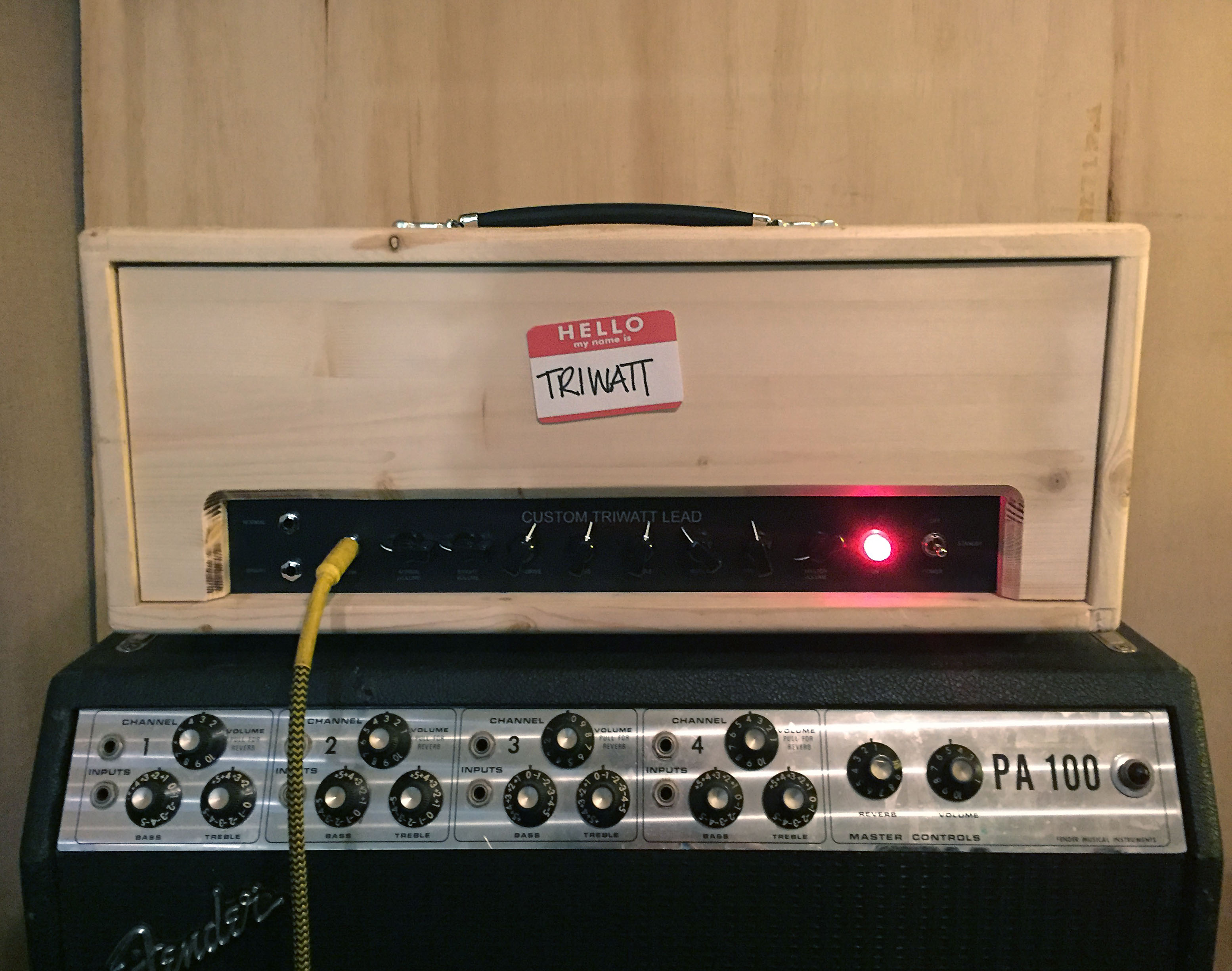

Temporary name plate...
